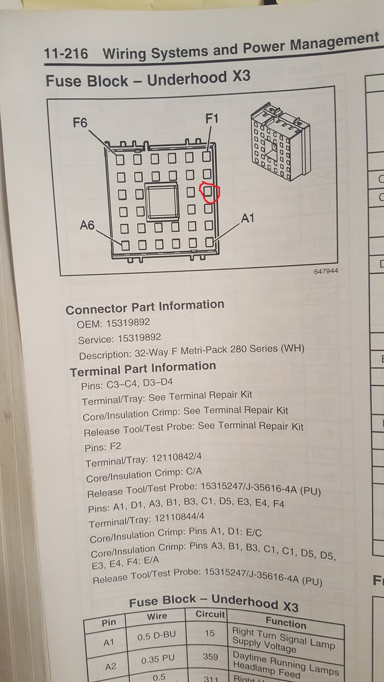

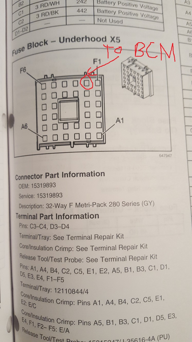

Do you know the pin readout for the F/L turn signal from the headlight harness at the fusebox? Thinking I could test continuity on that one.(I dont have Chiltons access any longer)
The first picture is the white plug, and the circled pin runs directly to your left turn signal bulb. The second picture is the gray plug, and that pin runs to the BCM connector. Both wires are light blue in color.

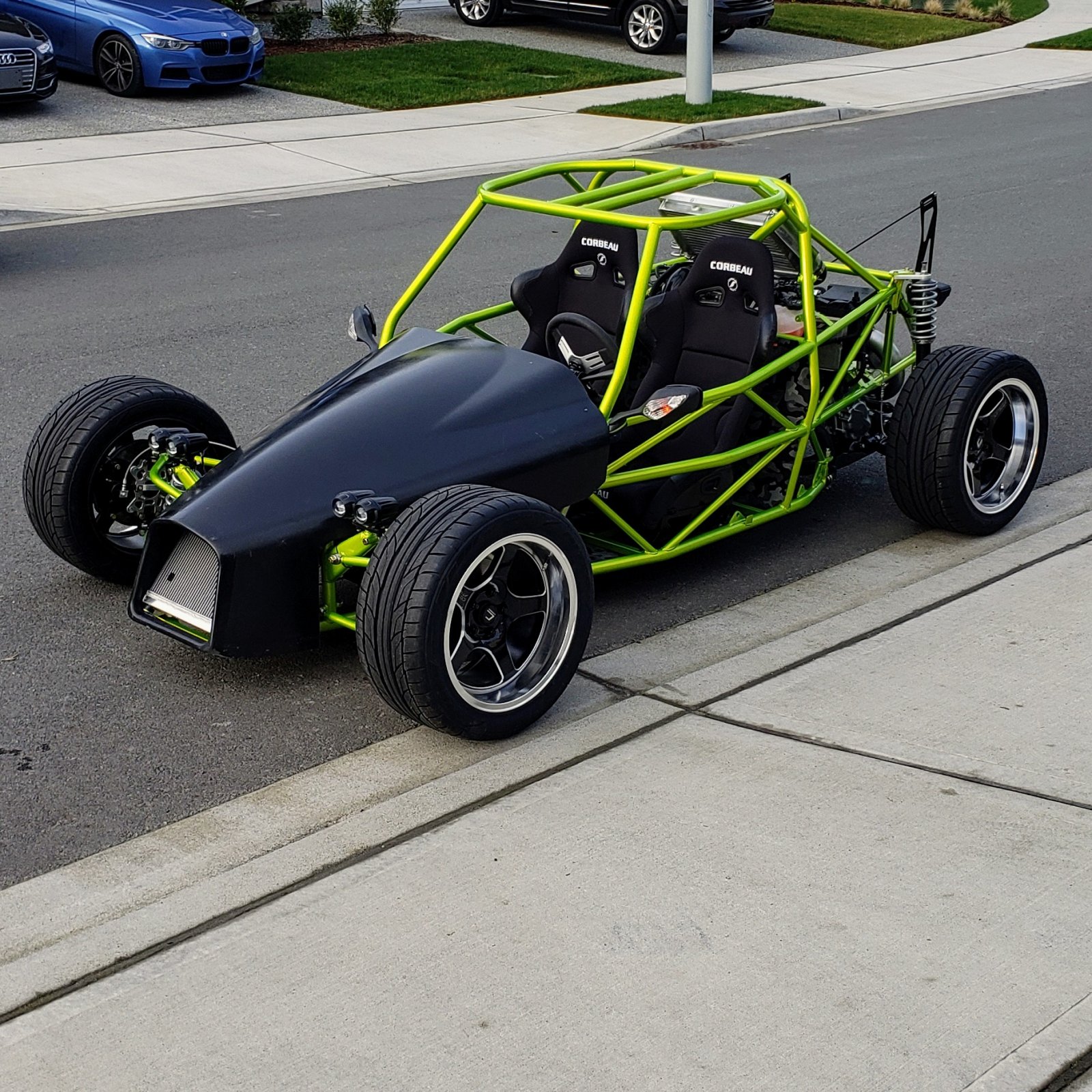

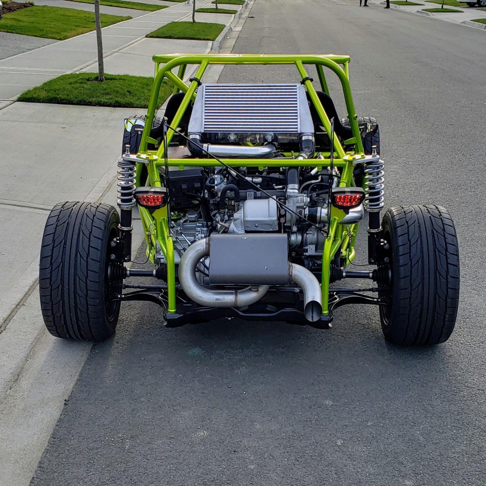

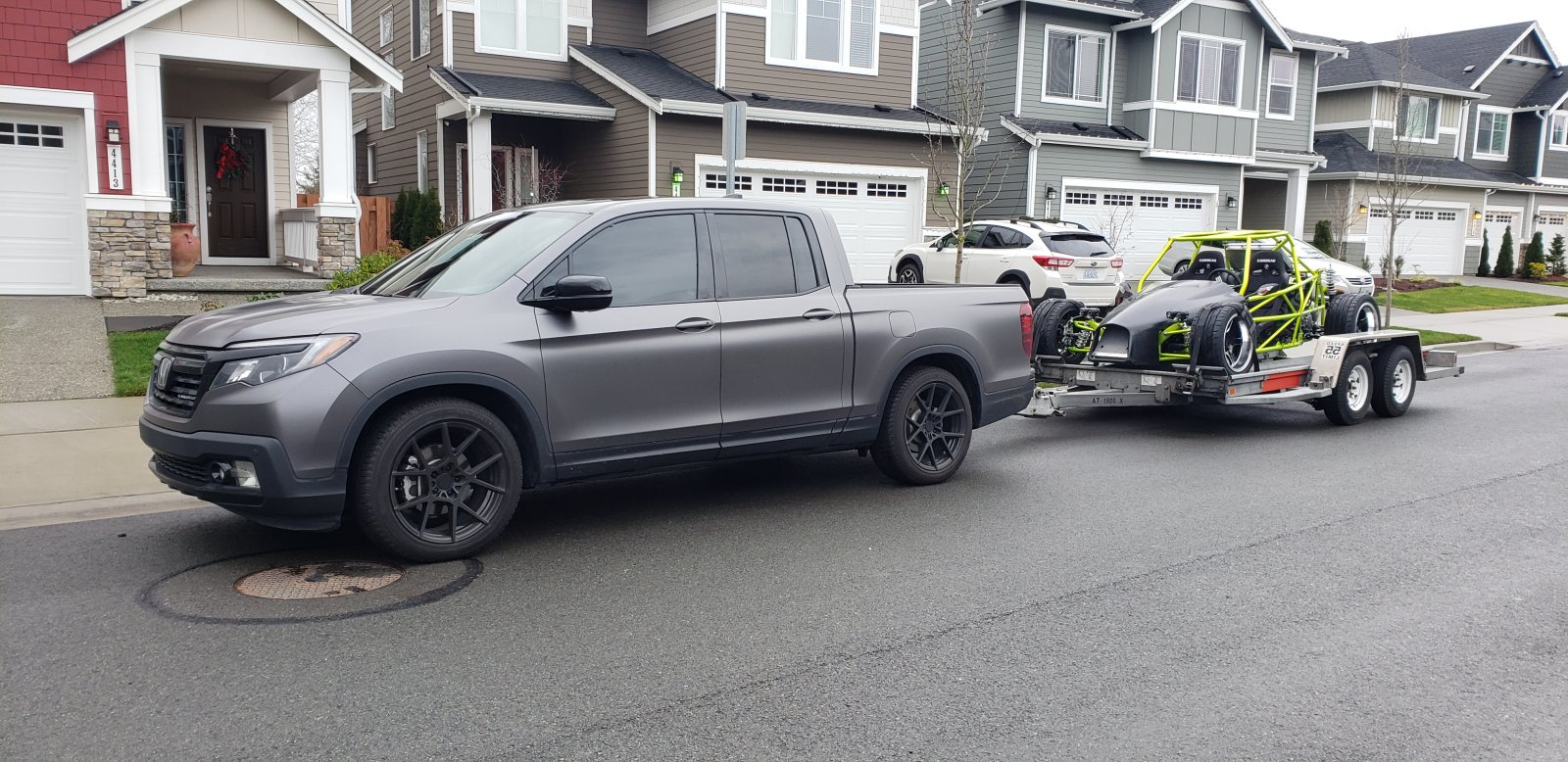

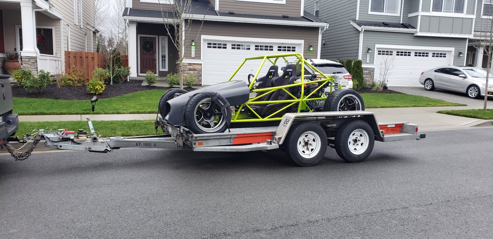

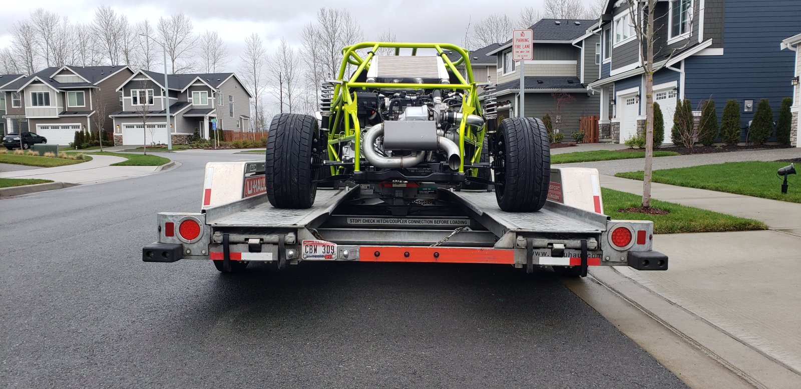

One step closer. Had to get it weighed before registering it. I will update everyone on WA process but based on what the Exocet guys do there isn't much to it. Might be done on Wednesday when the DMV opens back up.
1560 minus the side panels, taillights, spoiler and some other small items. My guess will be right at 1600.
View attachment 6681View attachment 6682View attachment 6683View attachment 6684
Man you have been grinding over the holidays! Can’t wait to see your wrap on the car.

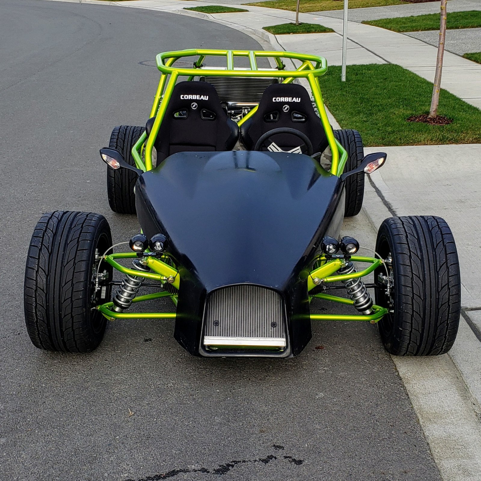

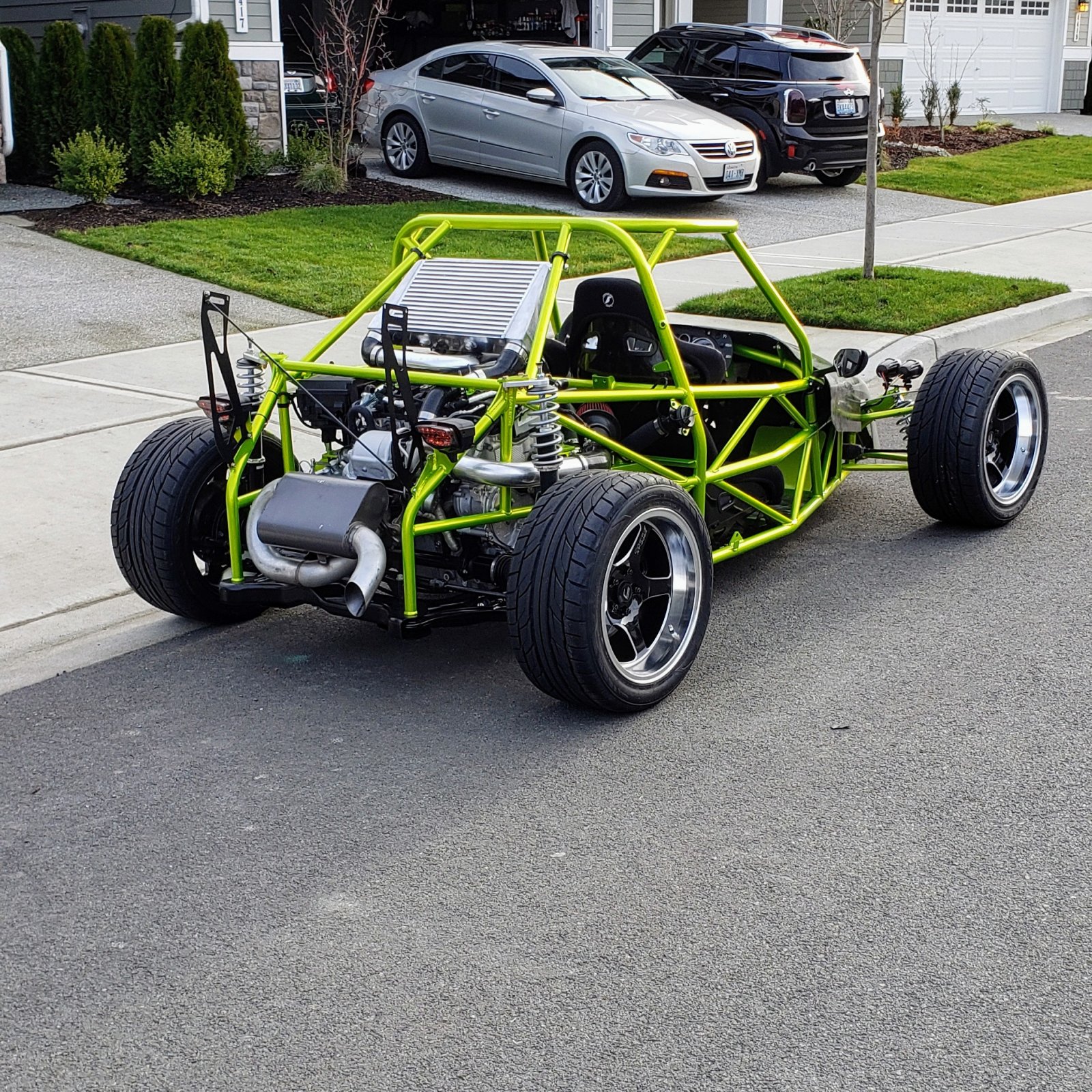

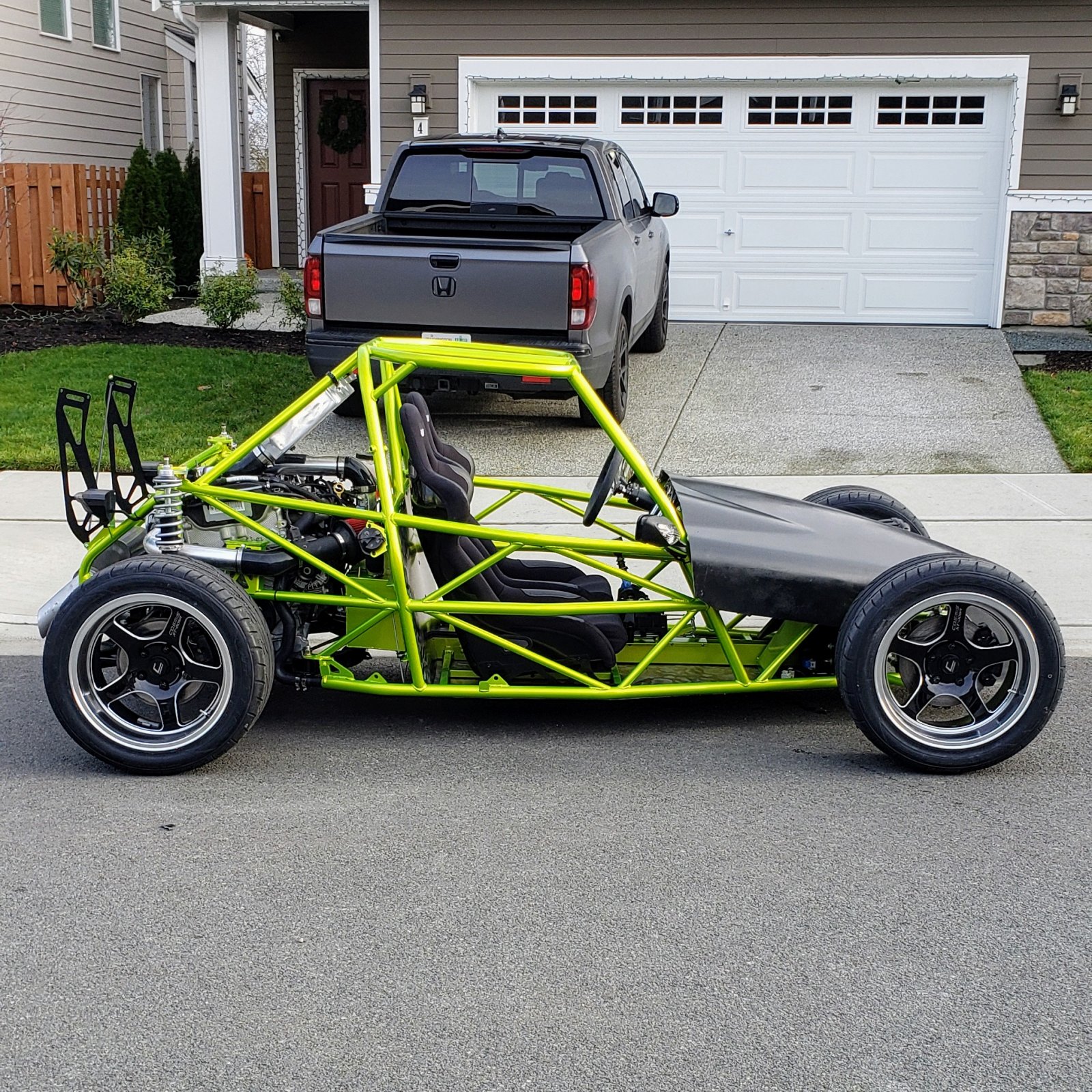

Inching closer to completing this and getting road worthy. This week it will be wrap the hood and mount side panels, parking brake, windshield and seat belts. Should have it registered Monday....
@SliderR1 Sliderthanks for the housings, love the taillights!

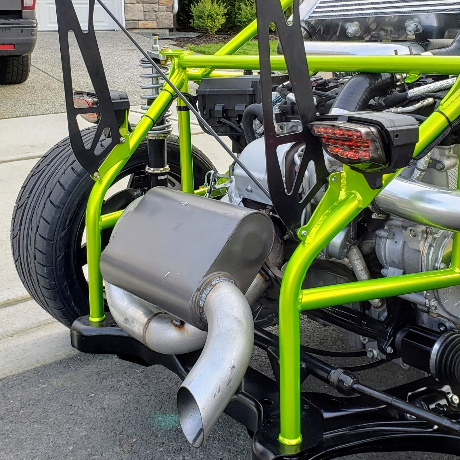

Went back through your blog and im sure i missed it... would you be willing to post up a picture of your rear tire-to-strut clearance? Also, what strut you ordered?
IDRVSLO
I will post a picture with the measurement tonight. I went with the DF supplied coilover.
