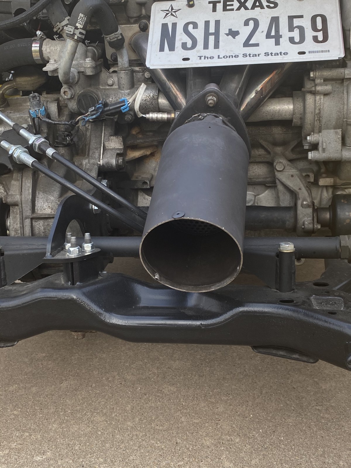

V1 It's very loud
Ghostknife
Glad to know it isn't just me then. I put the old cast iron exhaust manifold on and it made no difference so it's not the ZZP header. It's just loud, very loud. I don't know if I should pack the pipe with steel wool or something. I wish I was a welder so I could build an exhaust with more length/bends and add some resonators to it. I'm sure it would cost a small fortune having someone do it for me.

How hard is it to get a quieter muffler?? There are dozens (conservative count, lol) to choose from that will fit.

Ecotecs might not be very unique but the location and available space for a muffler in the Goblin is fairly unique...

These have more room than a VW dune buggy with their rear engine, and if a bigger muffler was needed there, the pipe from the header was extended further to the side of the car and then curved into the larger muffler, which also extended further to the opposite side.
A Goblin has more room to the rear of its mid-located engine, and similar methods to the above dune buggy example can be used. Just need to be creative....

Sounds like you're describing a whole new exhaust system instead of just a simple muffler replacement...
Some of the ideas put forth have their merits, but let's all keep in mind @PHENDERSON doesn't have a welder. So I'm assuming the solution he is looking for wouldn't involve fabrication and welding together pipes and mufflers.
Exhaust inserts, which reduce noise, also impede exhaust flow - but this may be his option if no welding can be done. So it becomes a trade off for low dBs versus less 'fun factor', but still being able to DIY a quieter exhaust.. :confused:

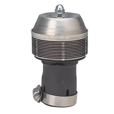

I'm sure a generic bolt in silencer plug could be bought and installed easily to accommodate this. I might just get on for the cruising around the neighborhood stuff, then take it out when you want performance.
JINX: That's the same insert I suggested in post #10.
