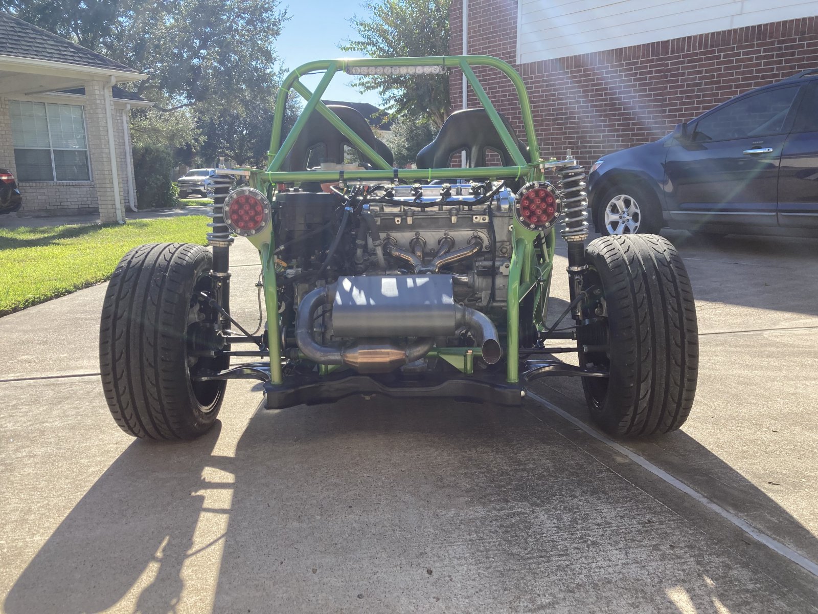

Well, this is what I came up with. Purchased some pre-bent tubing, muffler, and resonator off Amazon. Chopped up the pipe to fit and used clamps to hold everything together. It all is connected to the original DF supplied exhaust. Looks silly but will make the neighbors happy until I troubleshoot everything and then I can simply remove it and have the original setup still in place.

Woah, that's like $100 in band clamps alone!

It wasn't cheap. $50 in band clamps, $130 in pre-bent tubing, $35 for the resonator, and $45 for the Thrush muffler...not to mention about 4 hours of labor. I already have the worst lawn on the block, I don't need to add noisiest

What you came up with was very creative. It would be interesting to hear yours now compared to how it was before.
I can't tell from the picture, did you add a support to your exhaust system? If not you might want to consider it. There's quite a bit more weight now that's all hanging on the header and the studs in the head.
Statically, the weight would be ok. Once your driving though, forces are being applied to the exhaust in all directions and multiplied when you hit bumps, turns, etc. Especially the up and down motion.
For the DF supplied exhaust and something else I'm looking into doing, I've considered building a bolt in crossbar mounting bracket that runs between the two lower wing mounts on the chassis. From there options abound on how to support the exhaust, depending on muffler selection and exhaust routing. (Cradles, J hooks with isolators, etc)

The weight has me concerned as well. I have a NS goblin and the 2" exhaust with a DF added Cat. When I first got it, it was very loud and was not happy with it. Idle in neutral is still pretty loud. Once I put a few hundred miles on it, the sound mellowed out and also once in gear is more quiet. From the looks of your tires, it looks like you have not driven much yet. You can give it time to see if it mellows out to your liking or get the 2" exhaust that is much quieter than the 2.5 and 3" I have heard.

I've driven about 3 blocks. Still troubleshooting. I wanted to make it quiet so I don't worry about letting it just run in my driveway. I plan on removing the extra stuff once everything is in working order.
The weight concern is a great point. I looked and I can add some straps on both sides connected to the wing uprights. It will add to the silly factor but take stress off the manifold bolts.
