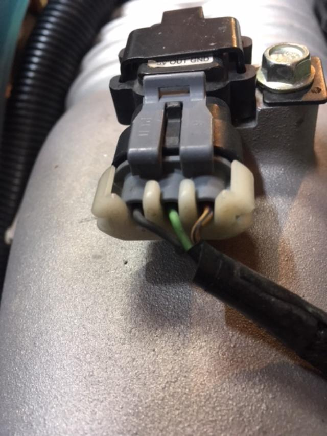

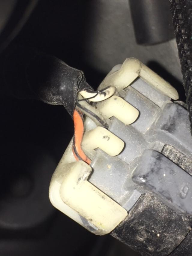

The plug on the supercharger has orange\bl stripe, white, gray w\bl stripe. Above oil filter is orange w\bl stripe, green, ava gray w\bl stripe.
Quite certain your connectors are backwards. This is our car and the verified by the wiring diagram.
This first one is SIPS (Supercharger Inlet Pressure Sensor)
23356
This is the BARO sensor (the sensor that is does not have a hose on it). Mounted above the oil filter.
23357

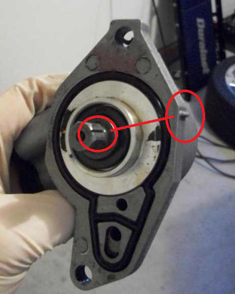

P0017 is a cam sensor and crank sensor correlation issue. Did you remove the cam sensor housing at all? I just had this issue with mine after not clocking it correctly when reinstalling it.
jaredthenav
Yes, I had to replace that gasket... How do I clock it correctly? Thanks!
jaredthenav
Thanks for checking. I'll switch them and see where that takes us. Best community on the internet!
jaredthenav
I reversed the two baro sensor plugs and the engine is idling much better. I'll reclock the cam sensor this weekend. Thanks a lot for the help.

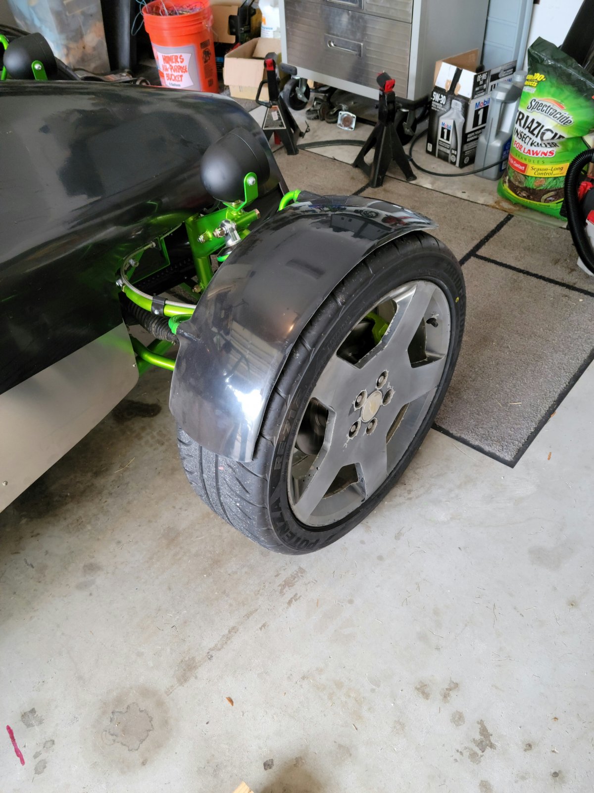

Spent the weekend reclocking the cam position sensor, cutting holes in the hood for the naca ducts, and cutting the front fenders back. My wife also took her first lap around the neighborhood and seemed to enjoy it. And for the first time I took it on the main road and got it up to about 50. And at that speed it started aggressively swerving bank and forth. I didn't have a lot of confidence in my eye ball and 2x4 alignment... So found a guy who will do a custom alignment for me. And today ordered the BC coil overs for the rear. So next week I'll get a temp tag to go get it weighed, hopefully get the assignment done, and get the paperwork off to the pensacola inspection office to get a VIN and hopefully not get slapped with the sand rail label that some folks in Florida have had to deal with. In the home stretch!

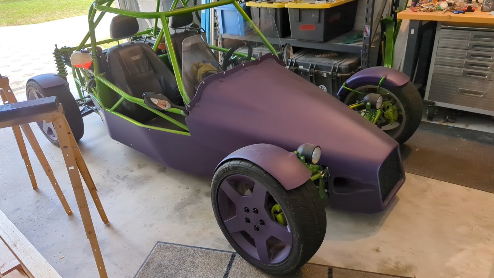

Well I've posted a lot of other places on the forum as I've had questions, but evidently not here on my build log for some time. I ended up Plasti-dipping the fiberglass and wheels (and made some comments in that thread) plum purple. For my Christmas present this year I got the dual pass endplate, phenolic spacer, new laminova core gaskets, the ZZP oversized idler pulley, and a 2.9 pulley, so I put those on back in January. It was my first time taking apart the intake, so I spent a bit of time carefully cleaning the laminova cores, and replaced the PCV valve (which was not working). I also cobbled together all of the parts to add the Option B tank (last year I got an extra radiator overflow tank off of Rockauto; it looks like they are no longer stocked) and bleeder. I successfully tapped the intake and put in the barbed elbow. The only thing I was missing was the little plastic insert for the 1/4" line to restrict the fluid movement. ZZP wouldn't sell just that part, but OTTP does (it was backordered, but I went ahead an ordered it and after about a month it showed up at the house). Initially I just zip tied the overflow tank behind the passenger side (until we took at trip to Red Oak and visited Adam and the shop and brought some parts home with me...to include the reverse tank bracket for the passenger side. I'm not crazy about the placement because it interferes with the dip stick (Cat V Portworks makes a flexible dipstick for the LSJ that is on my "to buy" list). Also, the outlet makes the plumbing very wonky. I am planning on experimenting with some aluminum tanks to see how that works). Once that was all put back together, I realized my intercooler pump wasn't working. I was a little surprised as this was one of the first parts I replaced after I bought my donor. But I used the excuse to get the ZZP high capacity pump. I installed that, and it still didn't work...You should always troubleshoot before blindly buying parts!. Some fun with the multimeter indicated that all was good with the wiring (to include the polarity of the plug, evidently a common Cobalt SS/SC issue), and finally I pulled the relay and discovered that was fried. Fortunately the AC relay right next to it is the exact same part number, so swapped them and voila! Functional intercooler system!

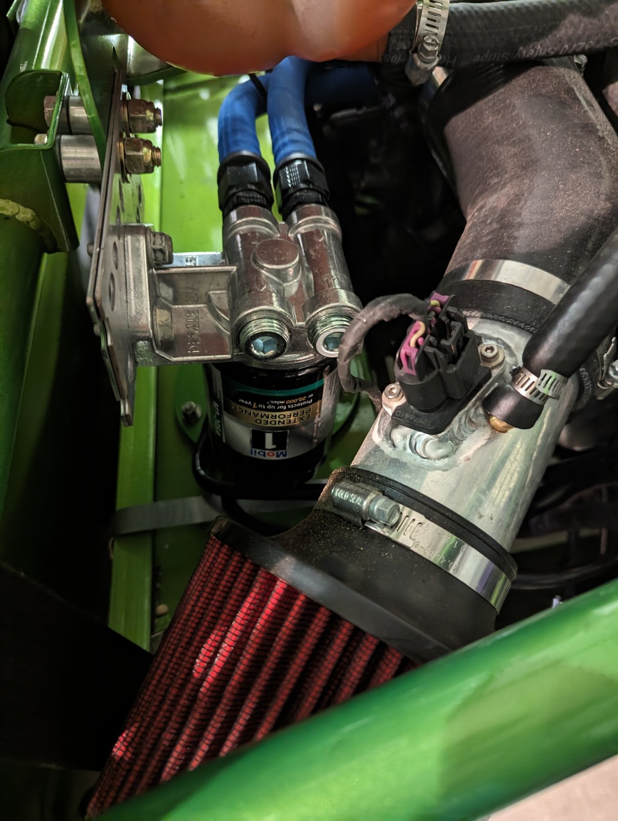

Backing up a bit, before I put the intake back in, I decided to install the Oil filter relocation parts in. I had ordered those way back when, thanks to the tip from Desert Sasquatch. I figured out where I was going to put the filter mount, and figured out some hose lengths. I had to make some oil lines from the filter adapter (AN fittings) to the filter mount (NPT fittings). A local speed shop helped me out and the end result turned out pretty good.

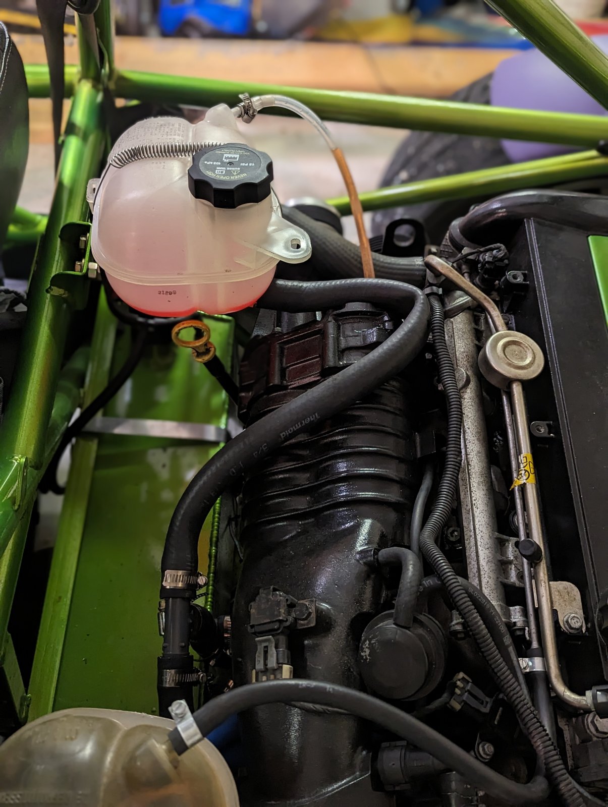

When I finally put it all back together, with the phenolic spacer, the supercharger now rubs a little on the radiator overflow bracket. An issue I still need to work. But the stock serpentine belt seemed to work great with the 2.9 pulley, oversized idler pulley, and phenolic spacer (I also replaced the oil in the supercharger while it was out; I was going to replace the coupler, but the old one looked like new, so sent that back to Amazon).

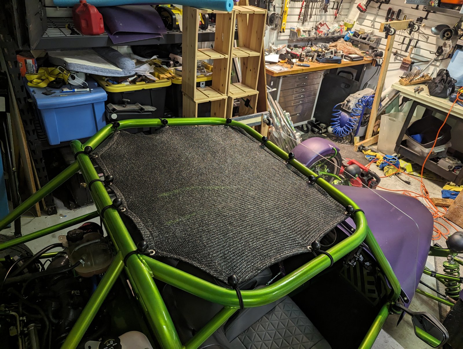

Finally, I convinced my sister in law to lend her sewing skills to the project. She sewed up the really sweet sunshade for the halo out of 80% outdoor sunshade material. I put some grommets in, and used little ball bungee loops to attach and I'm really happy with the result. Very quick to put on and off.

The sun shade turned out nice, maybe make a few more and sell them to other builders?
Check your engine oil pressure. Adding a remote oil filter and plumbing can sometimes reduce it by 5-10 PSI. You'll want to sure your idle pressure is good - as compared to a 'stock' oil filter system.
Does anyone know what their LSJ idle pressure is reading?
I had thought about that. A stand-alone oil pressure gauge is on my to-do list, as is an oil accumulator (I blew the engine in my STi back in the day and don't want to do that again). But it seems that oil pressure is not generally the LSJ's achilles heel.
As with almost all Ecotecs in a long RH turn the oil in the oil pan accumulates in the LH side of the pan, away from the oil pump pick up - LSJ, LNF, LAP, etc. doesn't matter what engine. Depending upon how much lateral G is occurring, it is possible to oil starve the engine. Read through @Justinreed7 build log, he experienced some pretty severe oil starvation in his original LSJ while tracking his car and ended up adding a dry sump system to his new 2.1L engine. Yeah, probably overkill for 98% of the rest of us, but oil starvation is possible if the oil level is even slightly low, but still within tolerance with track driving. An oil accumulator, plumbed in correctly, is good insurance to help prevent oil starvation in almost all expected conditions. I've got one waiting for my Goblin on the shelf, when I get to that point someday. :cool:

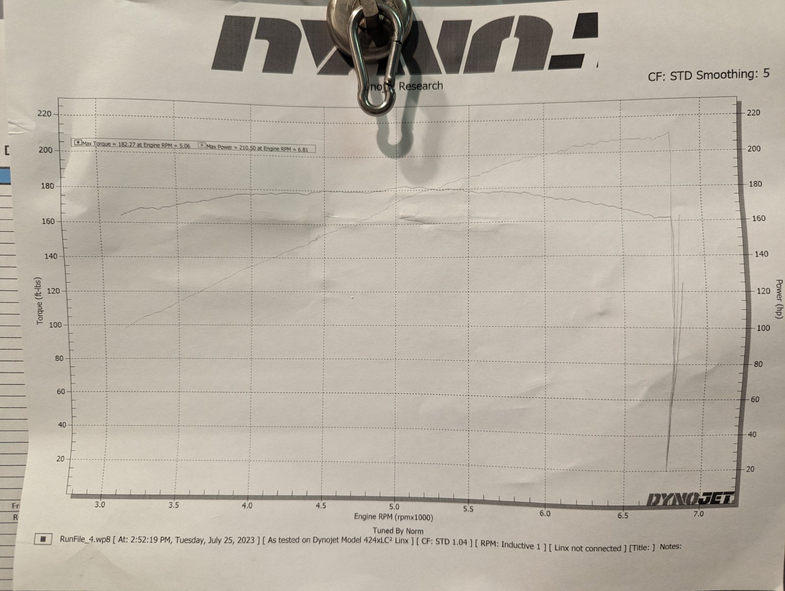

Finding someone local proved more difficult than anticipated. I finally found Tuned by Norm in Houma Louisiana who agreed to give it a shot. A 4.5 hour drive away. So I ordered the Fuel Injector Connection Split Spray 630s. Mitch at Tuned by Norm did a solid job with the tune and I'm happy with the result.

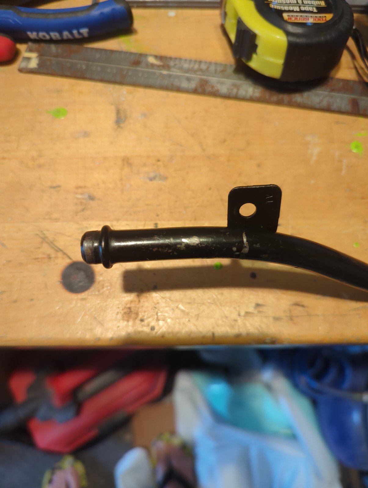

Anyone know if this is what the end of the dip stick tube on an LSJ is supposed to look like? Obviously it needs a gasket but I'm trying to figure out if the tip broke off in the oil pan. I'm about to order the Cat V flexible tube, but want to be sure I don't need to fish anything out if the opening or the sump.
