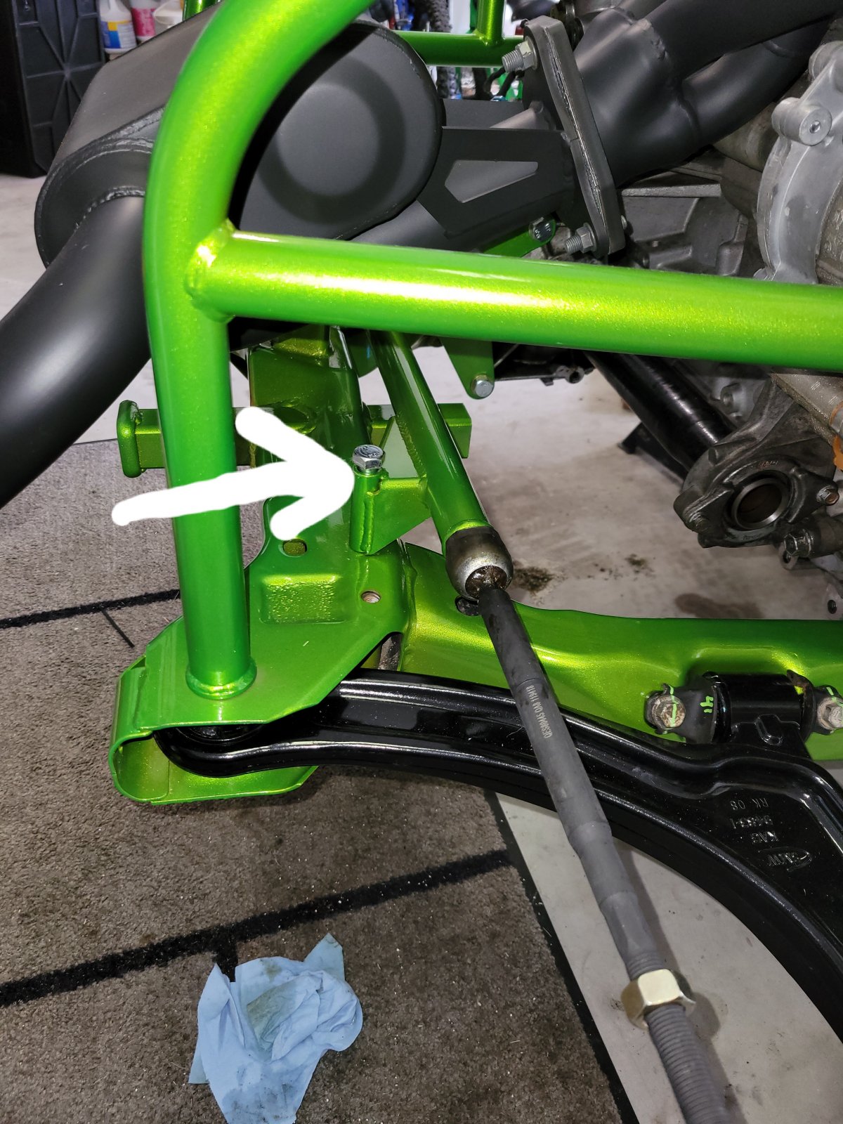

Anyone know what this bolt is supposed to be torqued to? Also, confirm I have the bar on correctly?

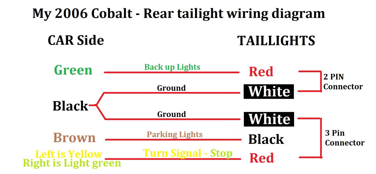

While waiting for my second batch of parts to come back from the powder coater, doing some little things. I can't seem to find instructions for the DF kit lights; specifically tail lights, side mirror, and eventually headlights. Can anyone point me in the right direction?

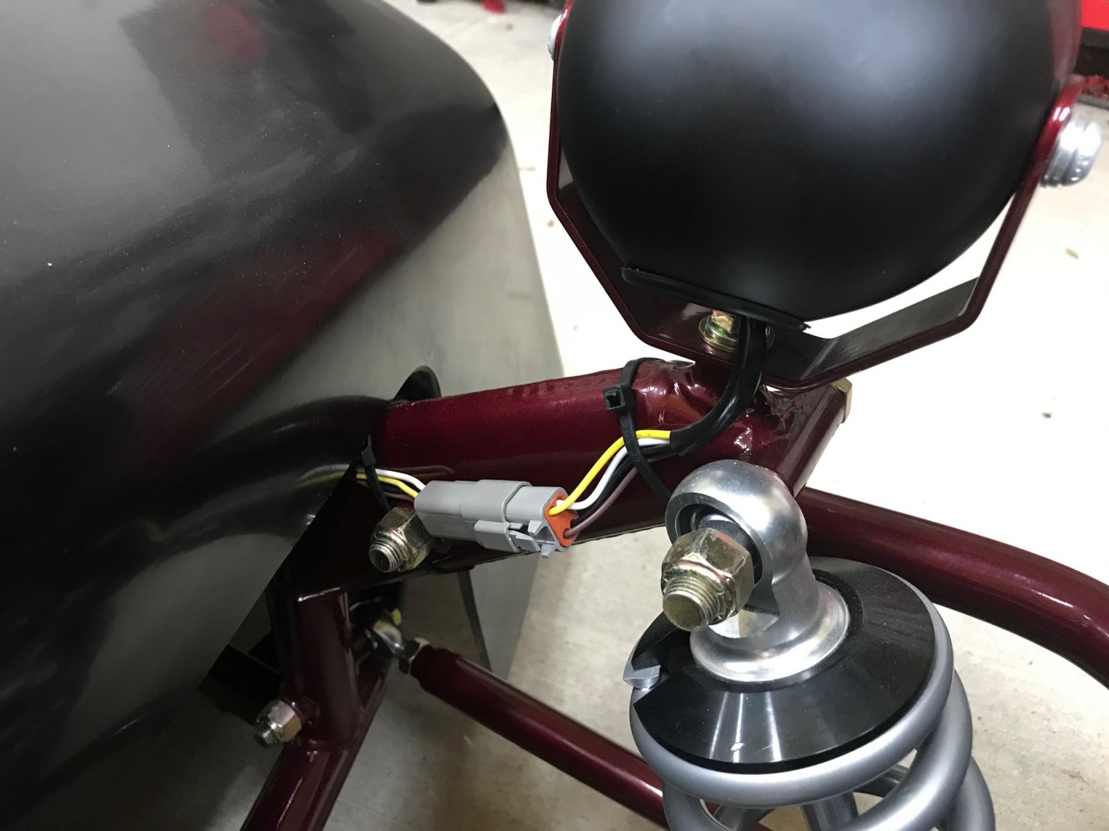

CaptFrank2001
I soldered the ends on first. Then pushed the ends thru the waterproof rubber piece (orange). Then pushed the pins into the housing (they lock in place). And lastly inserted the little lock they supply. No need for the crimper.

You can also look here.
jaredthenav
Ok, I think I've got most of this. I'm just using the DF supplied lights. If I'm reading this ok, no resistors needed, just wire to wire... I'm adding plugs, the only difference. What about the light blue cruise control wire? I see that if adding a center brand light, it is split, with a 100ohm resistor going to ground and the other to the center brand light. But without that, what do I do with the light blue wire if I want to use the cruise control? Do I still need to add the resistor and wire it to ground?
If you don't plan on using a third brake light, just run the light blue wire to a resistor, then to ground. At least, that's how I understood it.
I don't think the early models that use push button brake switches need the resistor to use cruise control. I would try without it first. You will need all four brake and clutch switches operational.
