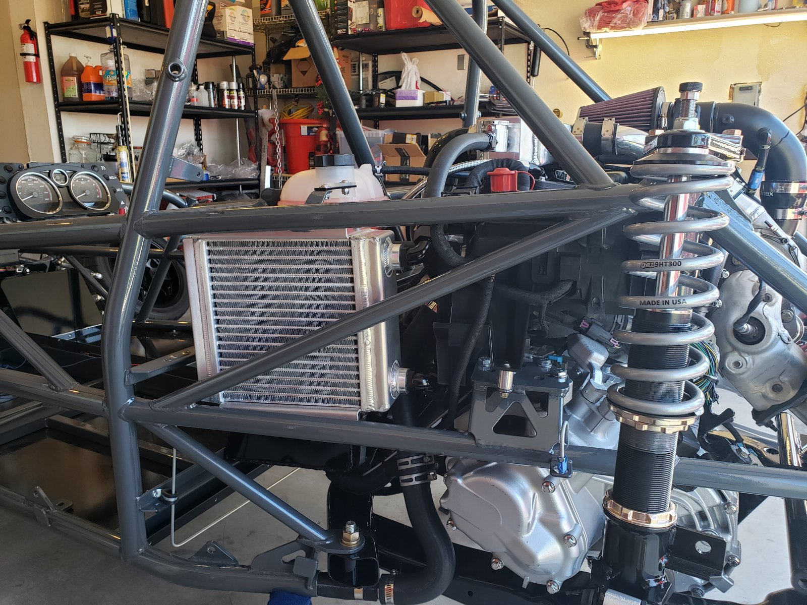

Yes My heat exchanger has a fan but it is really loud and would be nice to not have it on all the time. I'm hoping with the addition of these scoops I wont need to run the fan anymore. I plan on borrowing your design . Is there anything you would do differently if you were to build them again? Here is how my heat exchanger is.

I would not change them. If I add a remote oil cooler it will be in the same location as your intercooler.
If you make it out of thinner aluminum you my be able to fab it in your garage.
when I was driving down the road at 50 I stuck my hand in front of it. There was a good flow into it.
