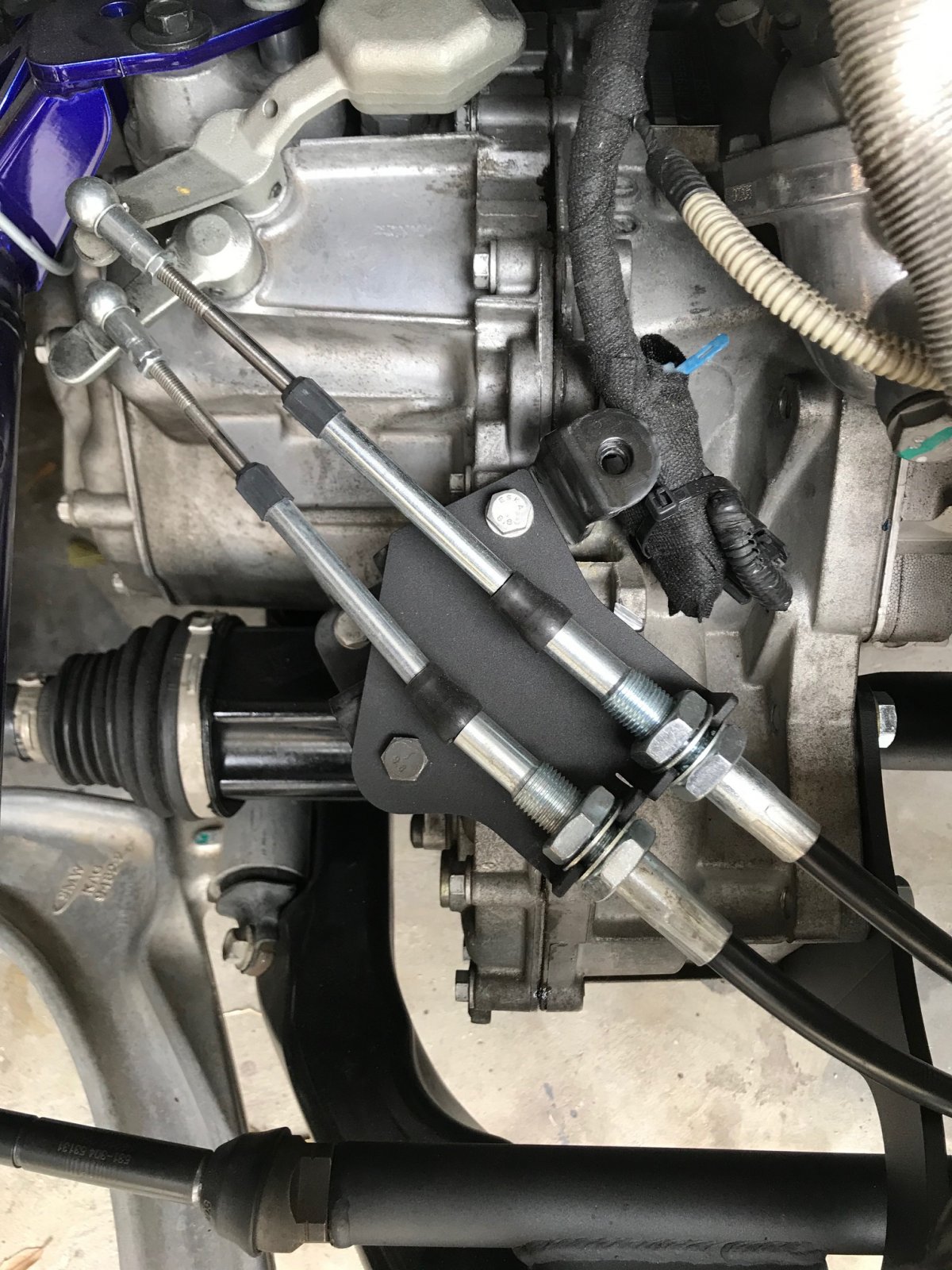

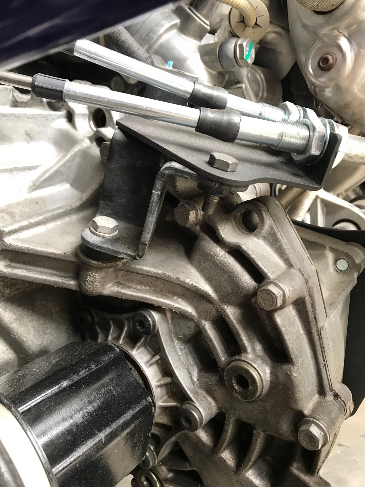

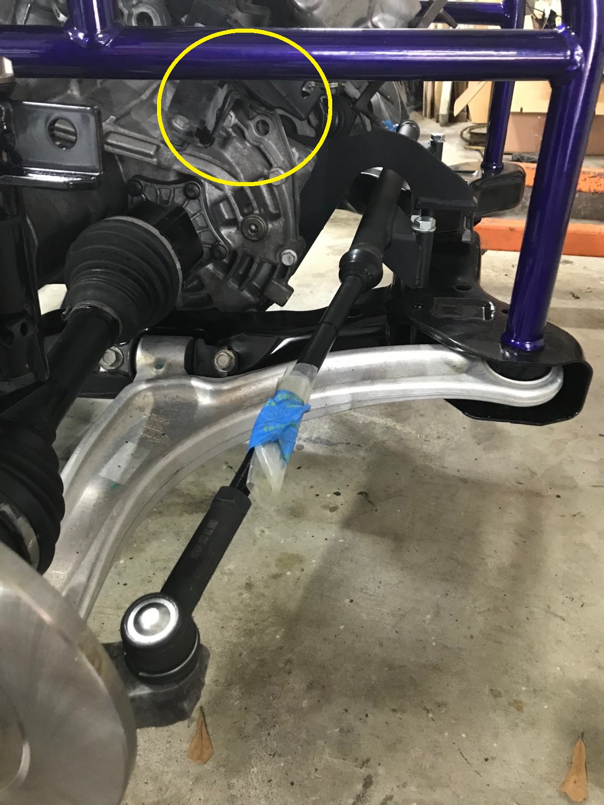

I was thinking "what's next?" last night after my first start, and my mind wandered to the mounting plate for the shift cables in the rear. Could I ask for a closer picture of the area circled?

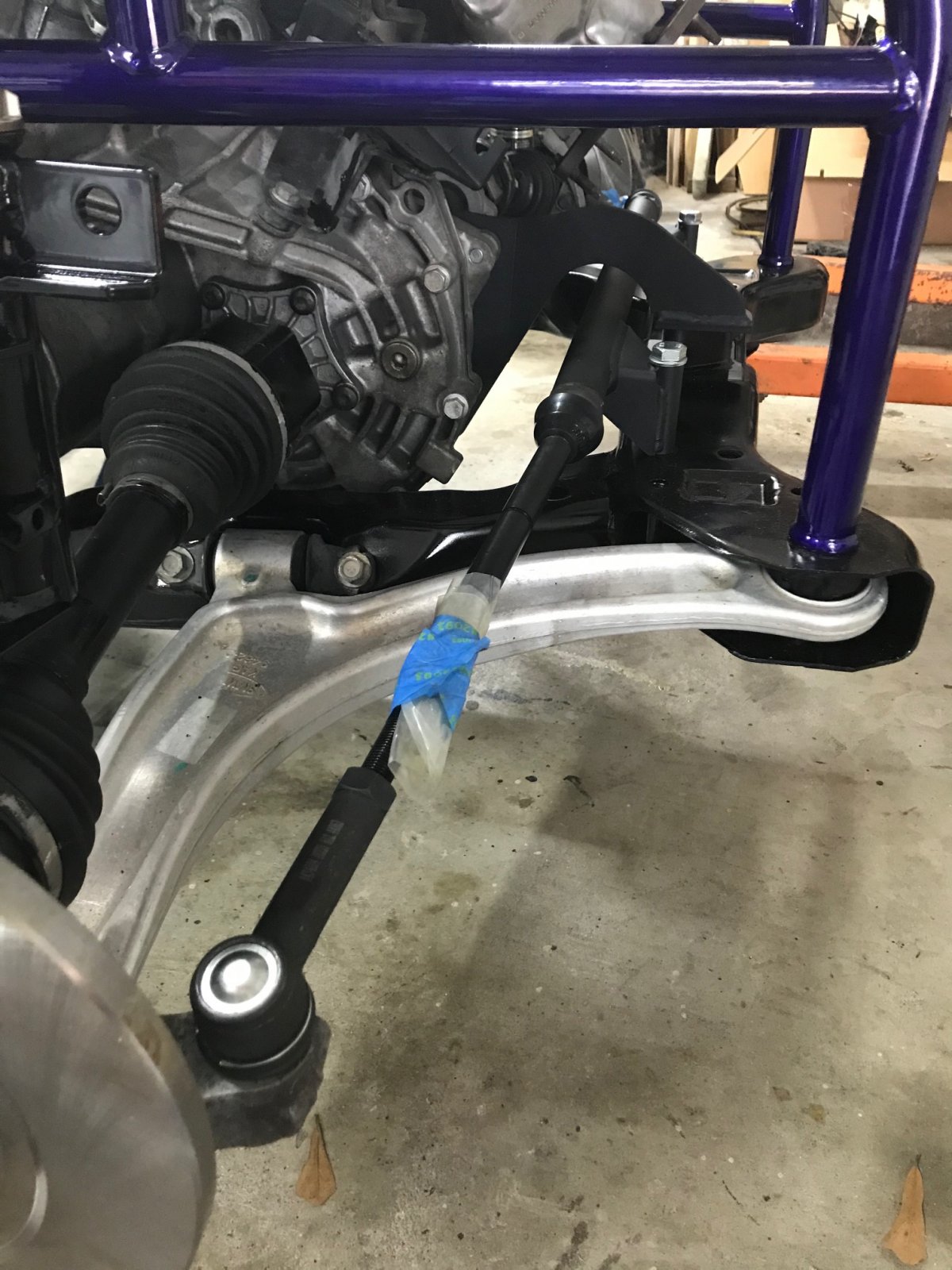

Jeremy, you have no idea how bad I felt for you the last few days. There are plenty of knowledgeable people here on the forum for sure. And many others like me who were still sitting here also trying to problem solve it for you. Most of us just sat and let all those others offer advice. But, I can tell you, I checked hourly and read every post of yours. You are gonna be SO **** proud when done!!!!! Emotional investment on your part has been through the roof.
So, the LEAST I can do for you today is share these pics. Glad I can finally help today!!!!!! :)

View attachment 15029View attachment 15030
DF redesigned the shifter cable bracket to decrease the angle of the cable. Nice.

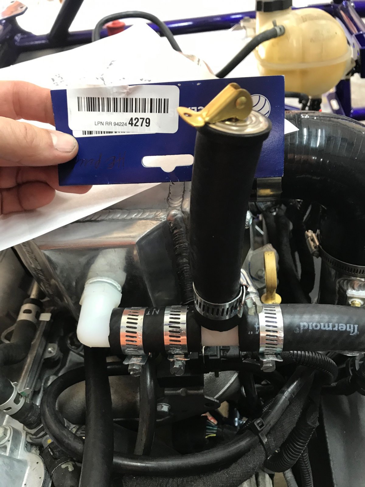

I finished up all the water lines on my intercooler. I saw a few different plugs and solutions that others have done for the fill port. I found a clean cheap solution on Amazon. See pic below.

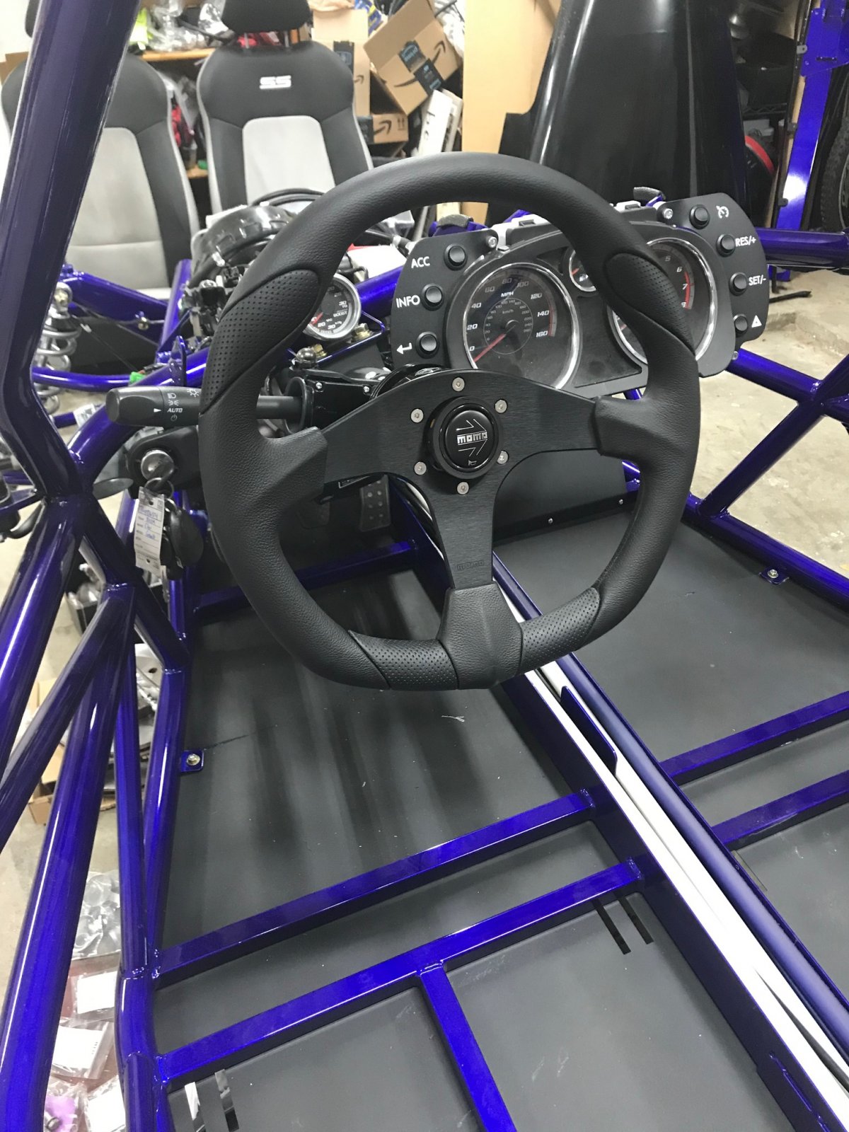

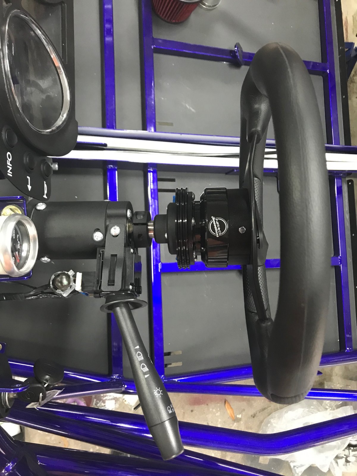

Steering wheel and quick release done.

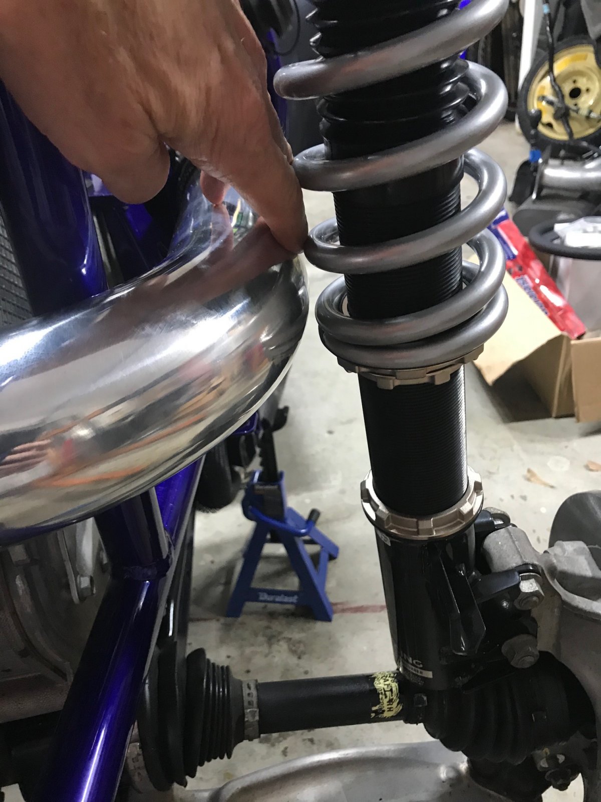

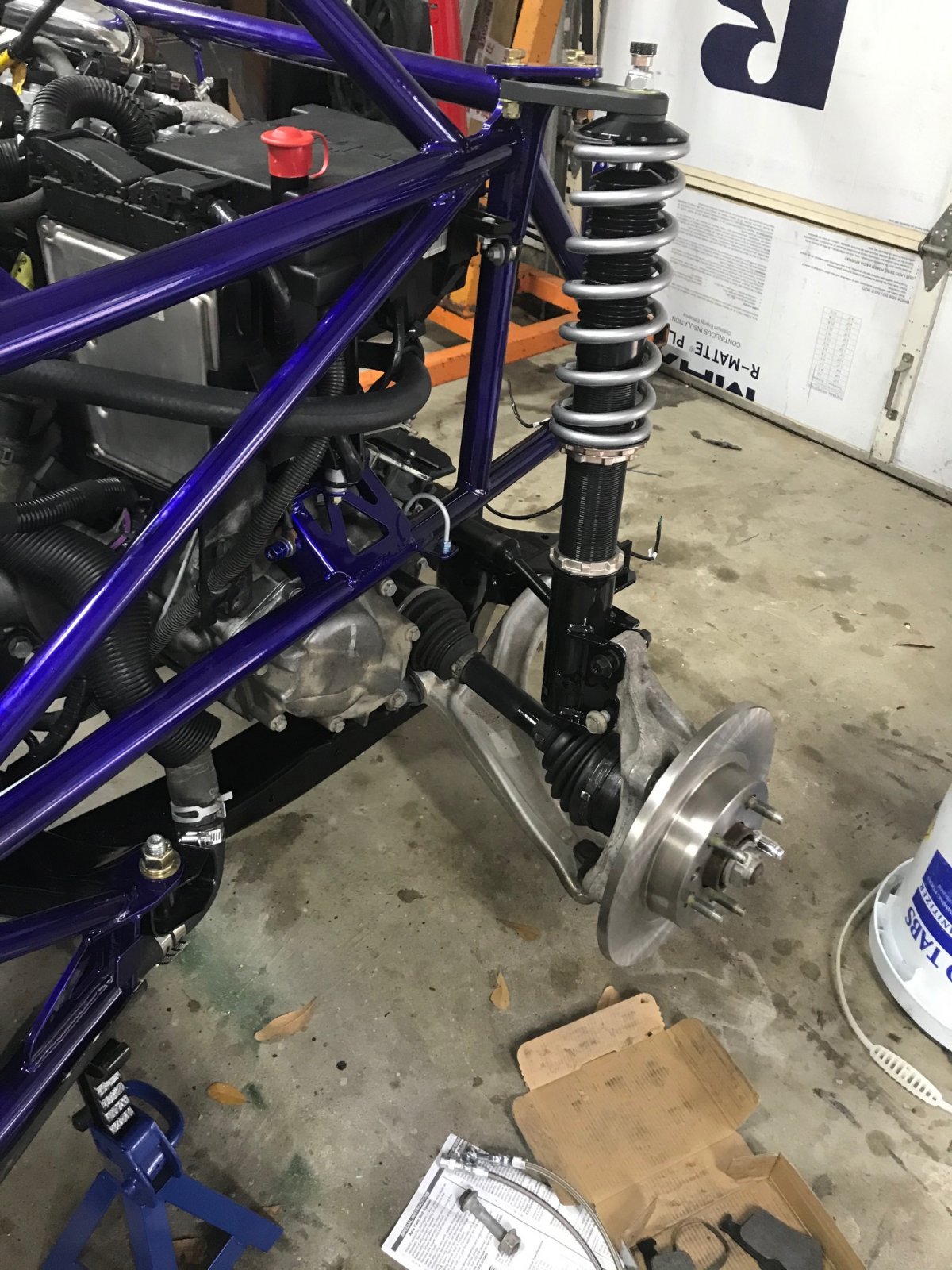

Rear toe link hardware installed, not tightened.
Rear suspension installed, not tightened. Man the clearance with the inlet pipe on the driver side is TIGHT! I may try to cut the pipe and move it in another 1/4".

Back in March, you made the quoted post ... I searched Amazon up and down, and I cannot find that type of fill port on there anywhere. Help a brother out with a link?
Thank you!

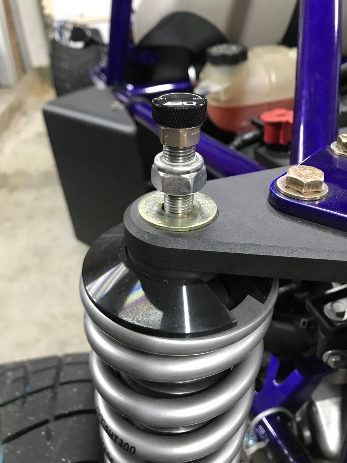

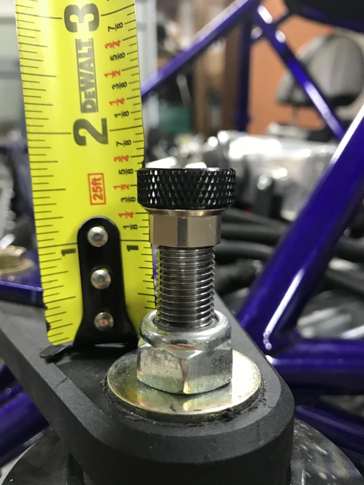

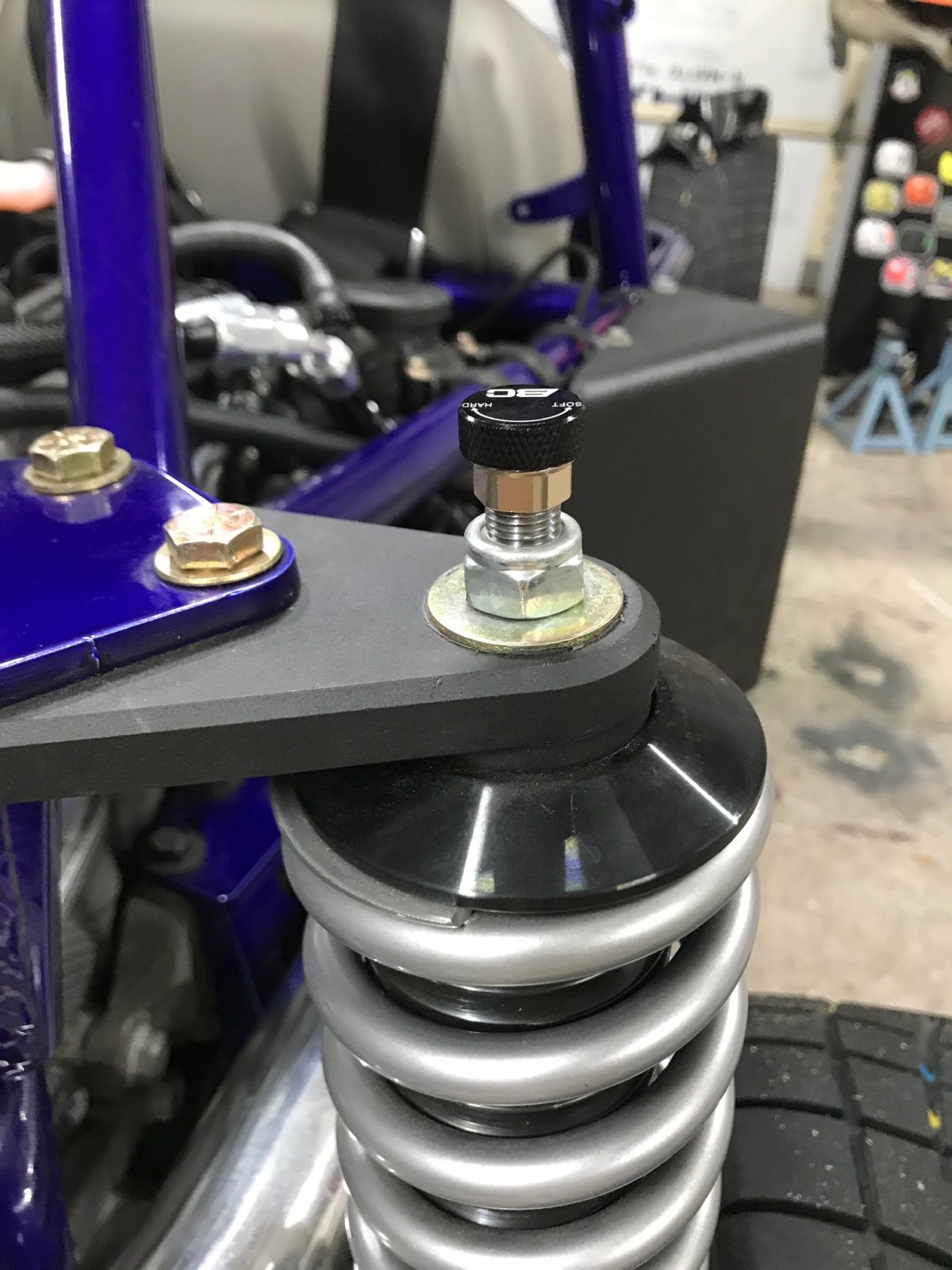

When I installed the rear shocks, I tightened them both on top. I thought. They were both the same length on top. I have over 200 plus miles on it.
Last night, I went over several small speed bumps. Real slowly of course. When I got home, I saw the top nut up away from the plate about 1/4". Red flag! Well, it turns out that I did not originally tighten them enough to get the rod seated on it's shoulder on the underside. Maybe the powder coating had something to do with it. There are probably some pics out there with them installed correctly, but it is a small detail that can be overlooked easily. The pic with the tape measure shows it completely tightened correctly.

I'd also be willing to bet it was the powdercoat that caused the issue. I didn't have mine coated and they seated right up.
