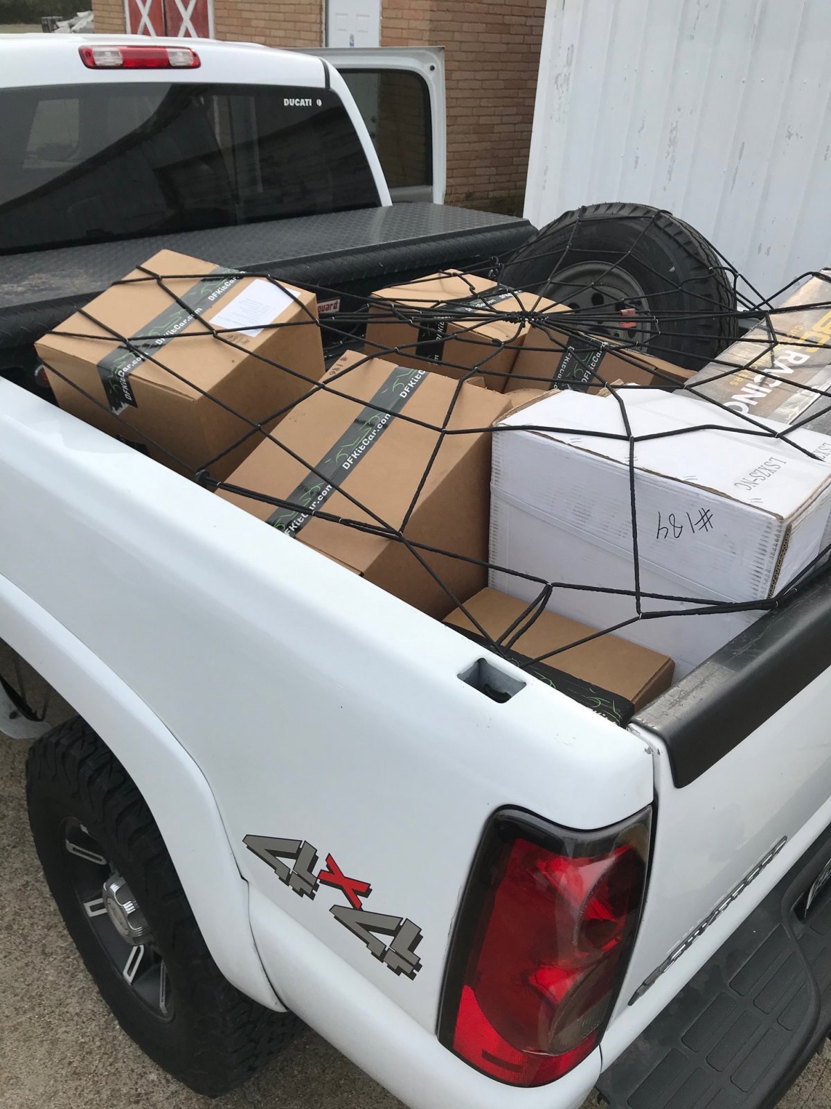

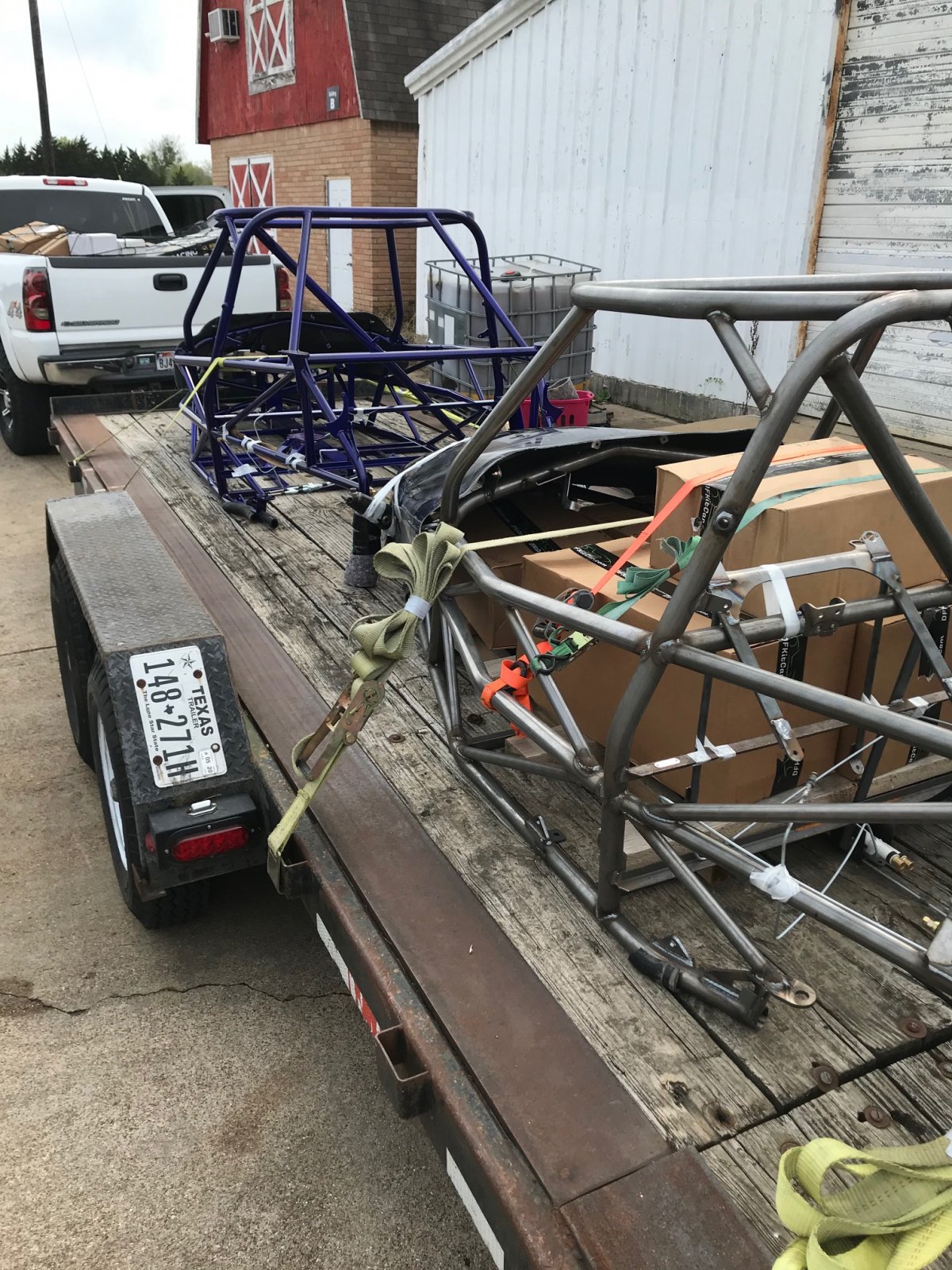

Moving day. As in from the factory to the house!

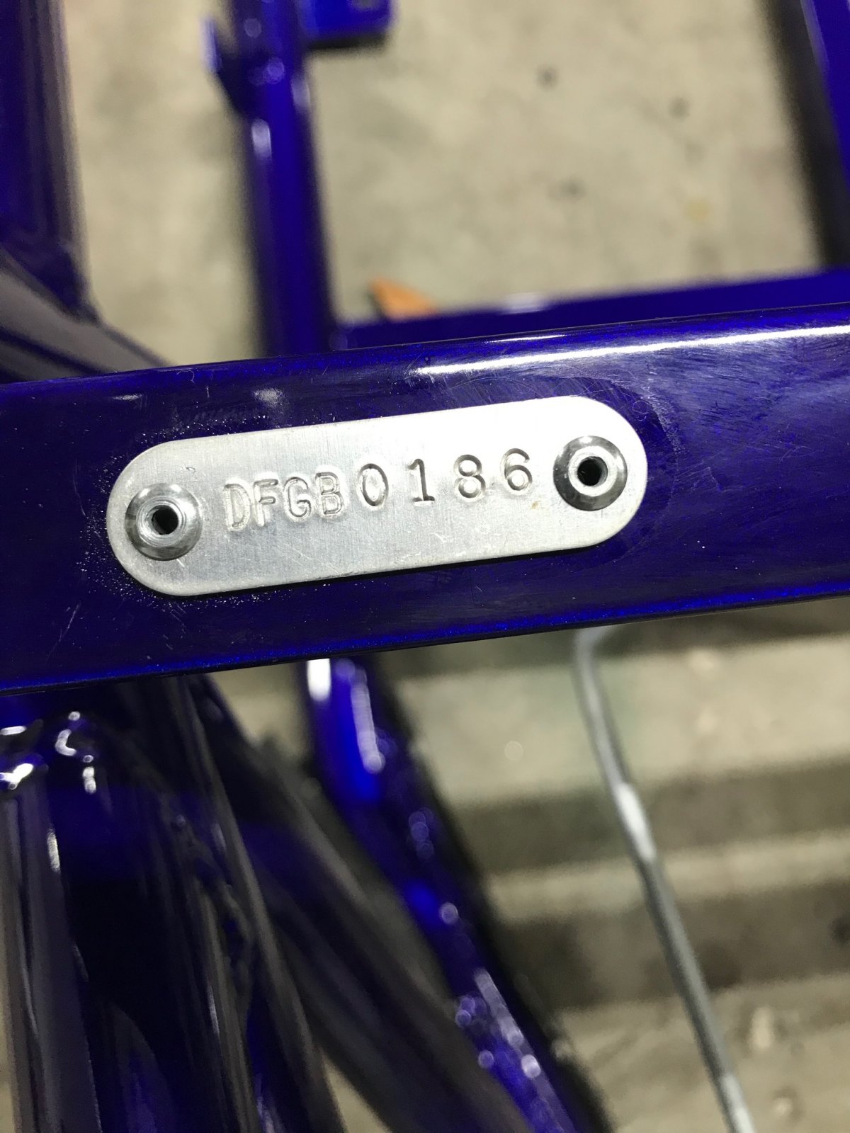

Drove up to Red Oak Texas from Houston with my son and Rttoys. Frames #186 and #184.
Adam, Lonnie and his wife were gracious enough to let us hang around for a while, crawl around their finished Goblins, and just shoot the bull.

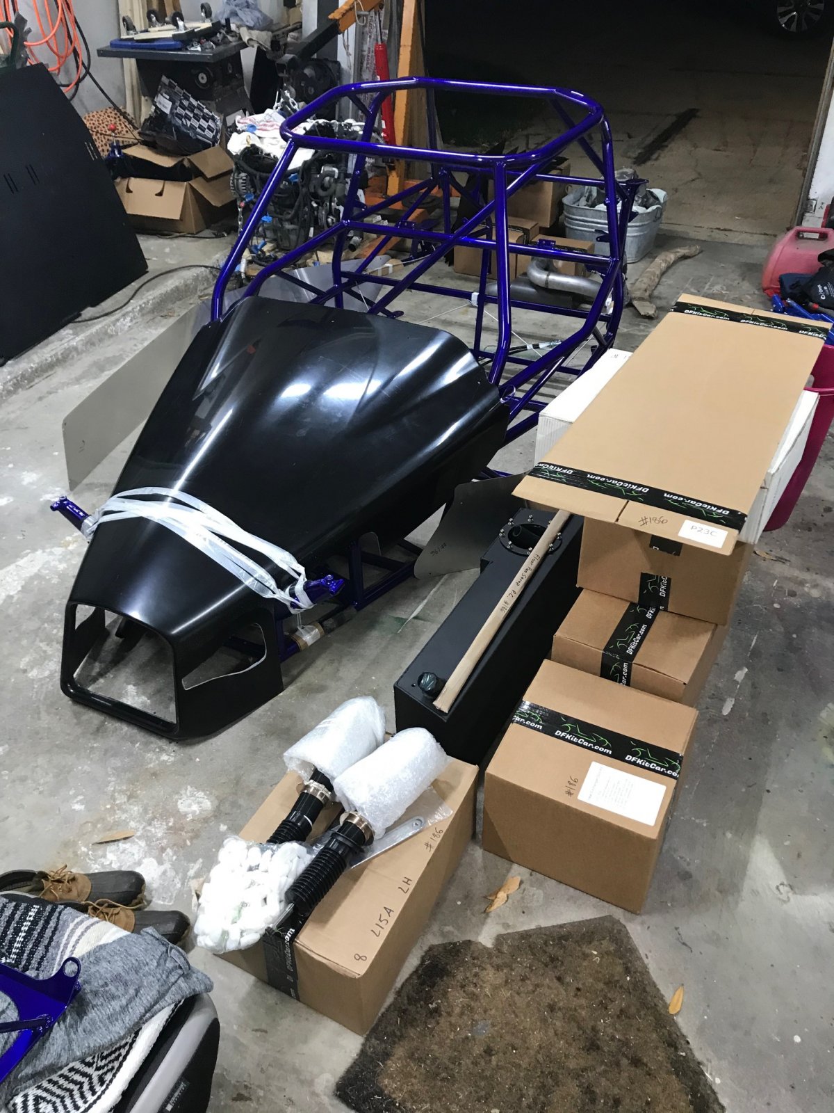

Let the building begin!!!!

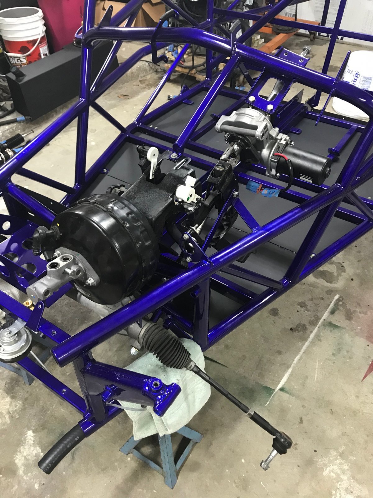

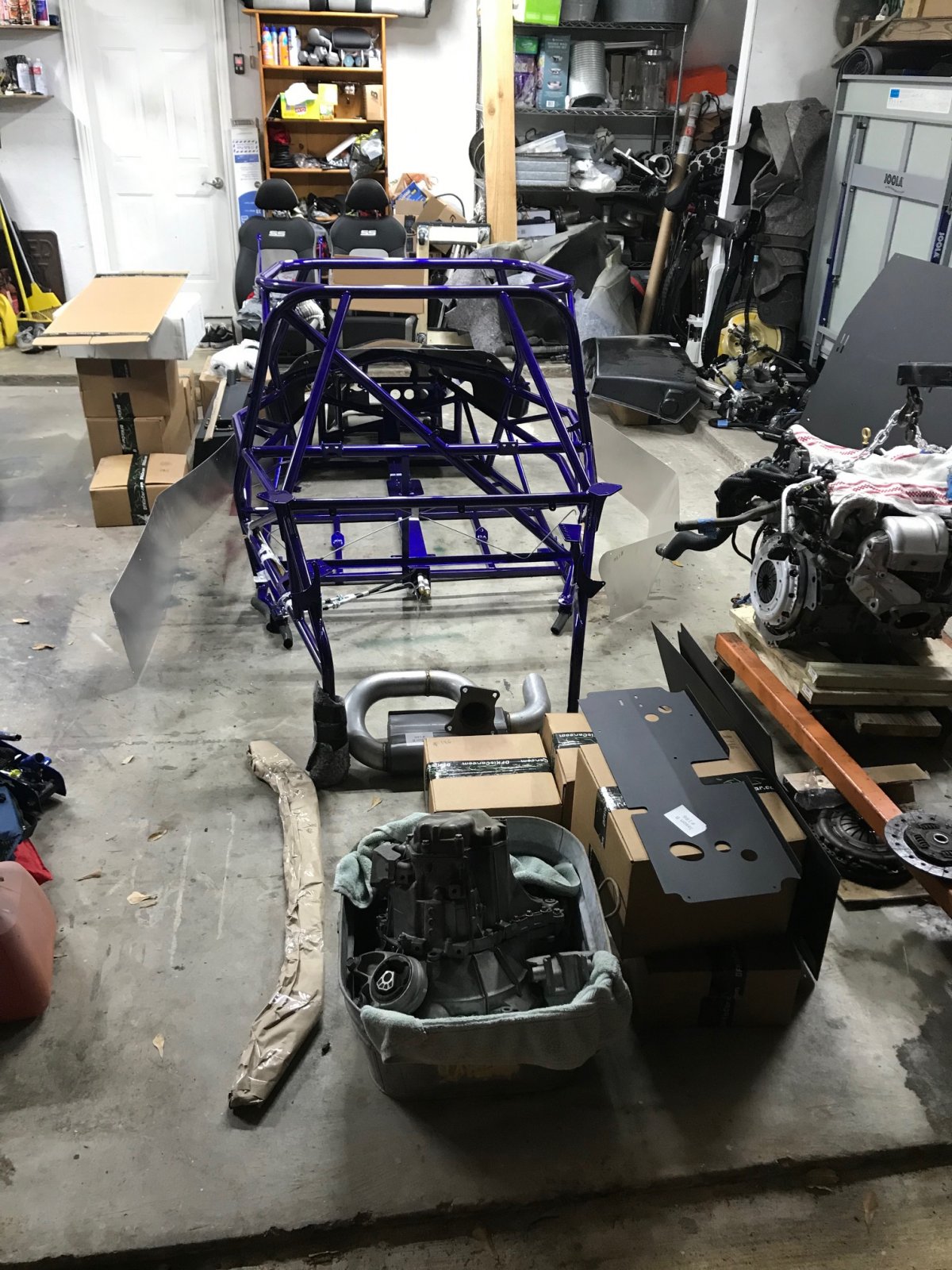

Fun to be back watching the videos, setting down the I-Pad, and turning a wrench. Got some of the simple stuff done today.
Also, re-installed my intake plenum and valve cover on the engine as well. The air/oil separator still needs one more hose to complete it.
Still have to get the transmission back on. I was one of the "victims" of Lonnie's offer to upgrade to the LSD. I would never live it down if I did a one-wheel burnout around you guys..... The shame!!!!!..... :)

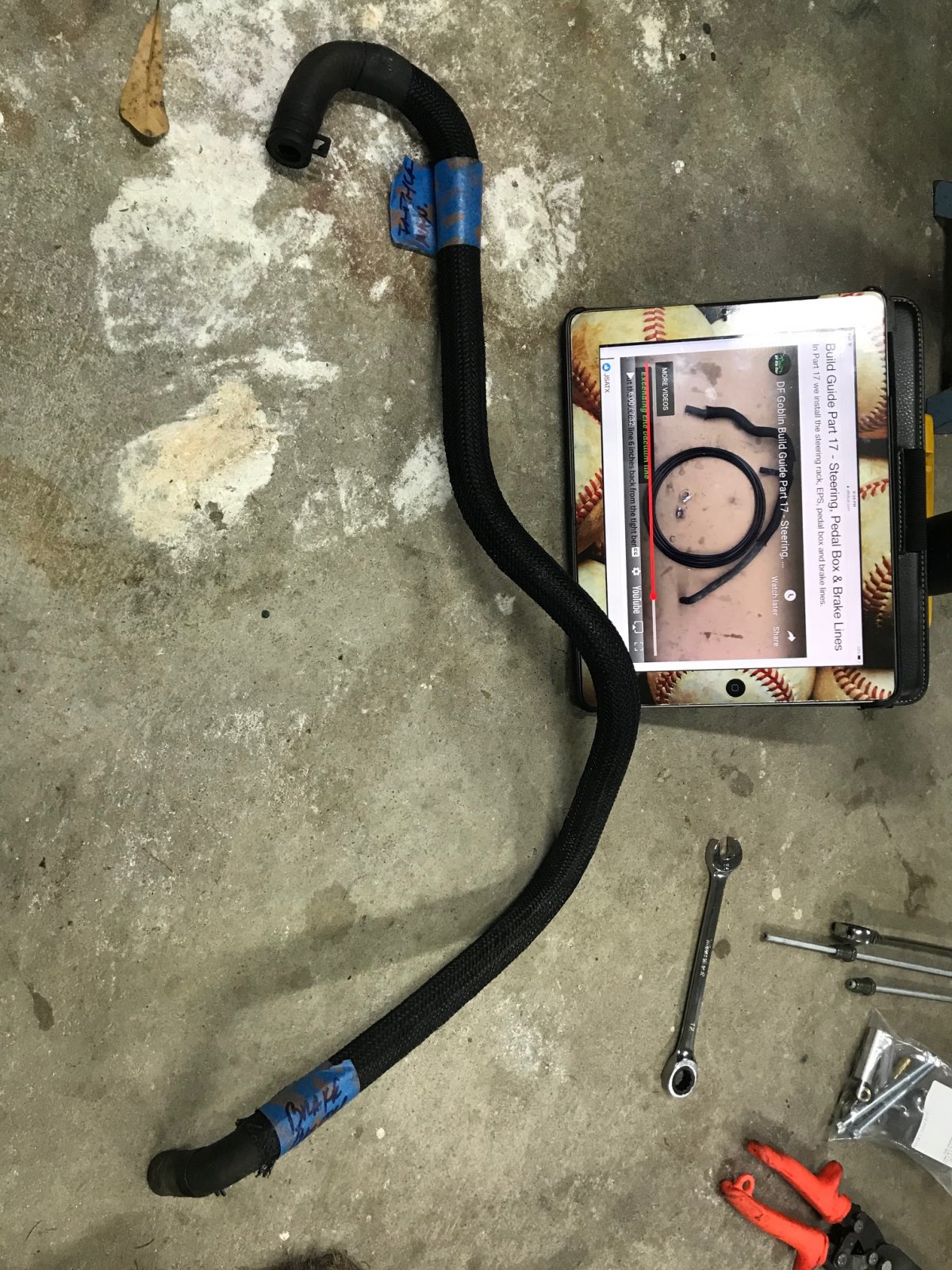

2009 SS/TC. My brake booster line is a little different than in the video. Mine has a 180 deg. bend on the left end (top in pic). Do I still make the cuts from the right end (bottom in pic) as shown in video #17, 6:00 minutes into it?
ARk:D Can you tell me the length of the first cut from the end of the hose? The hose in the video has an extra bend that mine does not have.
The first piece cut I assume gets used later for (?). I know the second piece 2" long goes on the brake booster.
Thanks!
Not really, tbh. I just forged ahead because I'm one of the "lucky" ones that had to dismantle two donors so I have extras laying around.

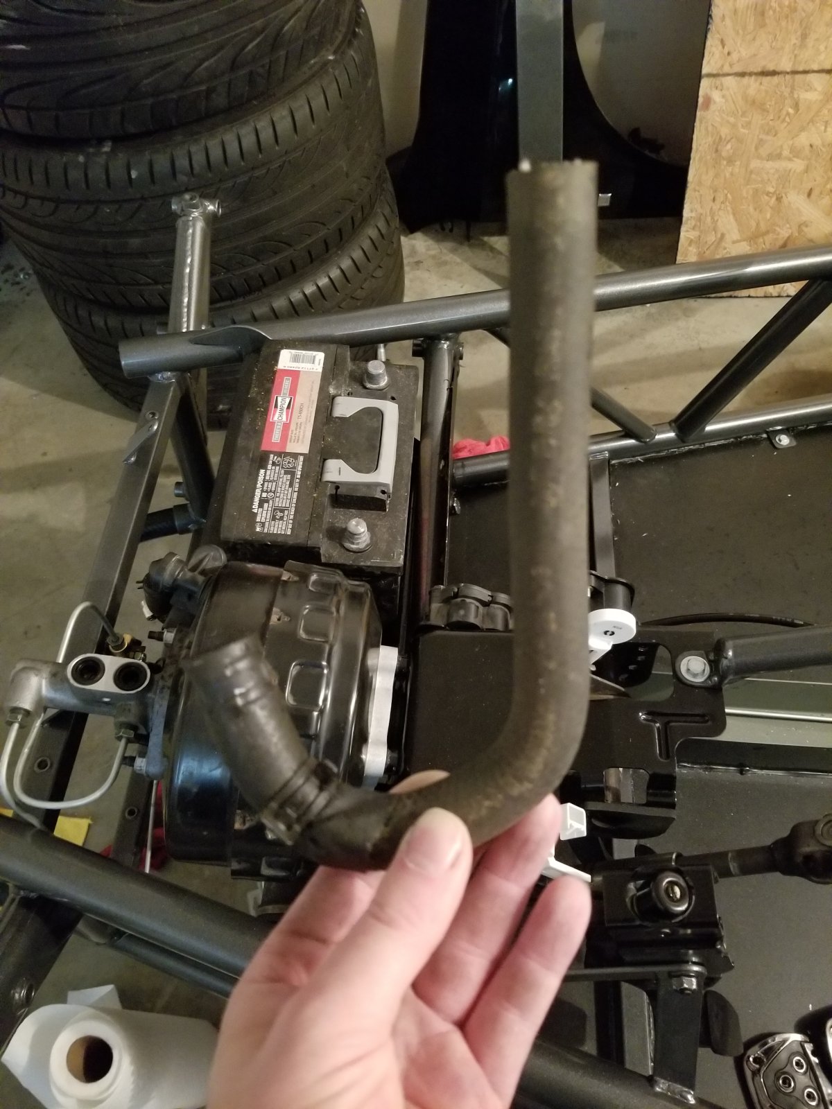

Here is what I have:

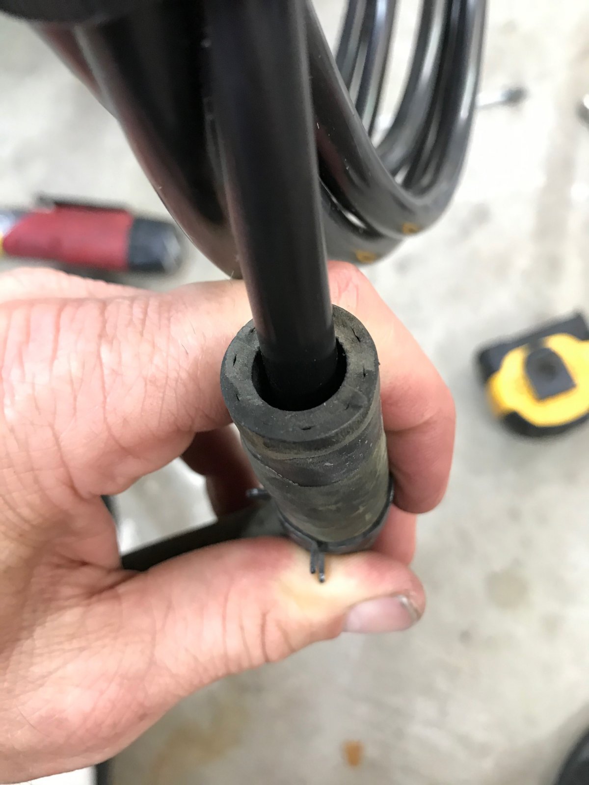

So is this the right size tubing for the vacuum to the brake booster??? A hose clamp is going to squeeze it down enough to make an air tight seal? It just does not look right.
Anyone?
