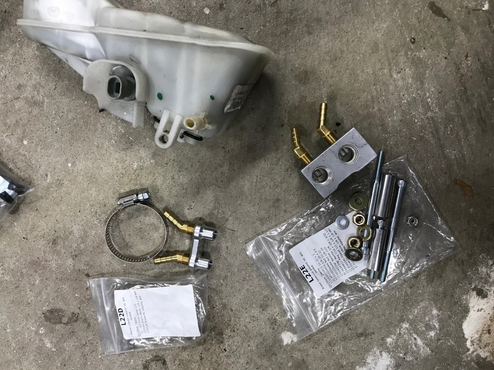

I have the latest version of the brake reservoir remote mount hardware. Does anyone have any pics of it all connected, installed, mounted?
I did not get any hose to run from the reservoir to the master cylinder. Looks like 1/4" rubber hose from the size of the barbs. But not any rubber hose works with brake fluid, correct? The hoses are low pressure? Or vacuum?
Mounting location?

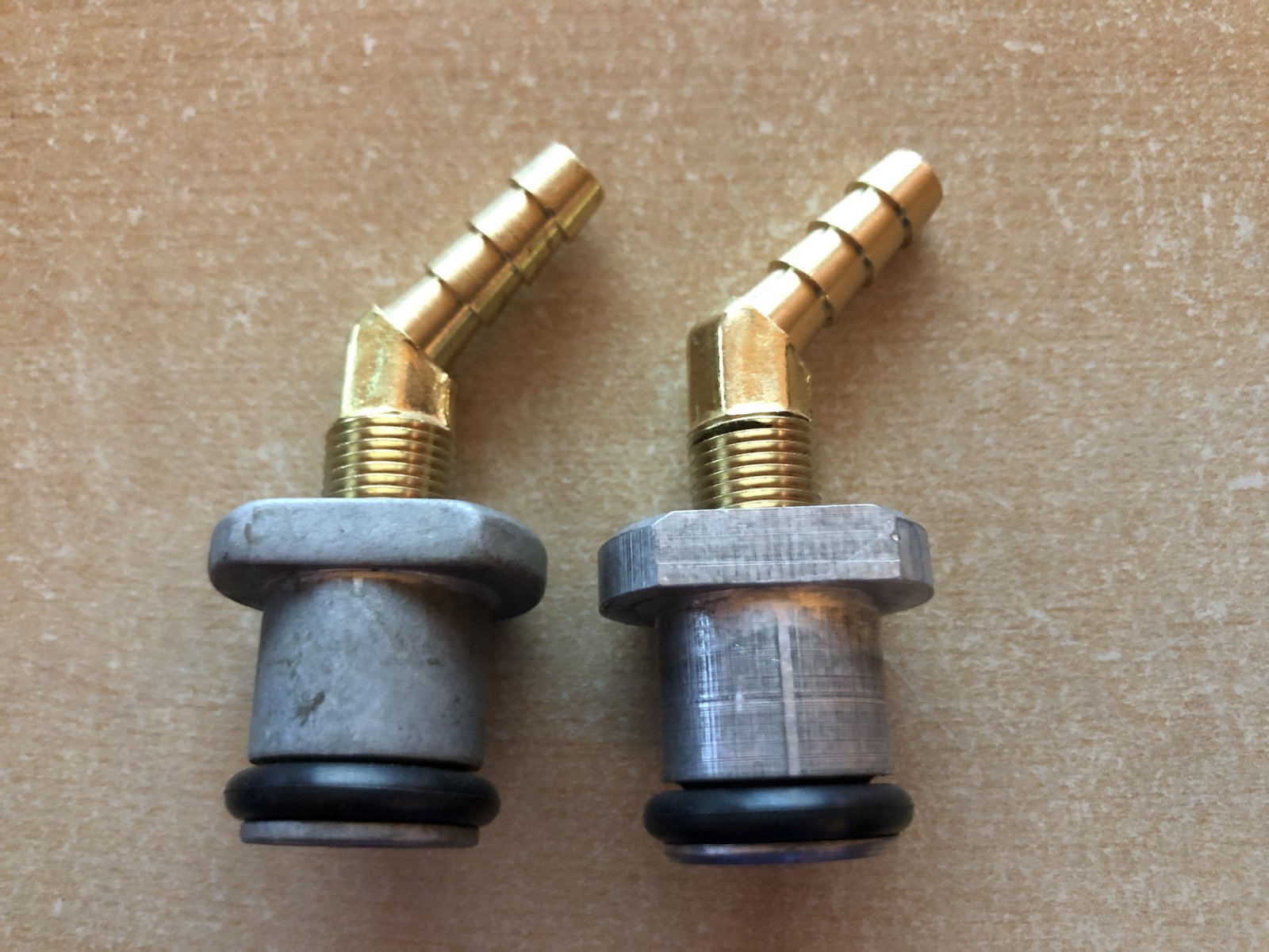

Has anyone actually used the brass 45 degree fittings in your picture? If so, can you provide pictures of the finished install? I ask myself why would they go with the 45 degree fittings? They actually seem to angle away from both sides of the install. Master cylinder points 45 upwards and the reservoir points 45 downwards. The 90 degree fittings seems like they would work way better.
Waterdriver
So if I'm seeing the new part's correctly, the brake reservoir tank mounting block, the 45's are coming out the side instead of the bottom. Which would make sense, giving the lines a little more room to get around the pedal box and make it's way to the master cylinder.
But at the master cylinder, I would think 90's would be in order to help alleviate entrapment of air in the line.
My kit had 90 degree

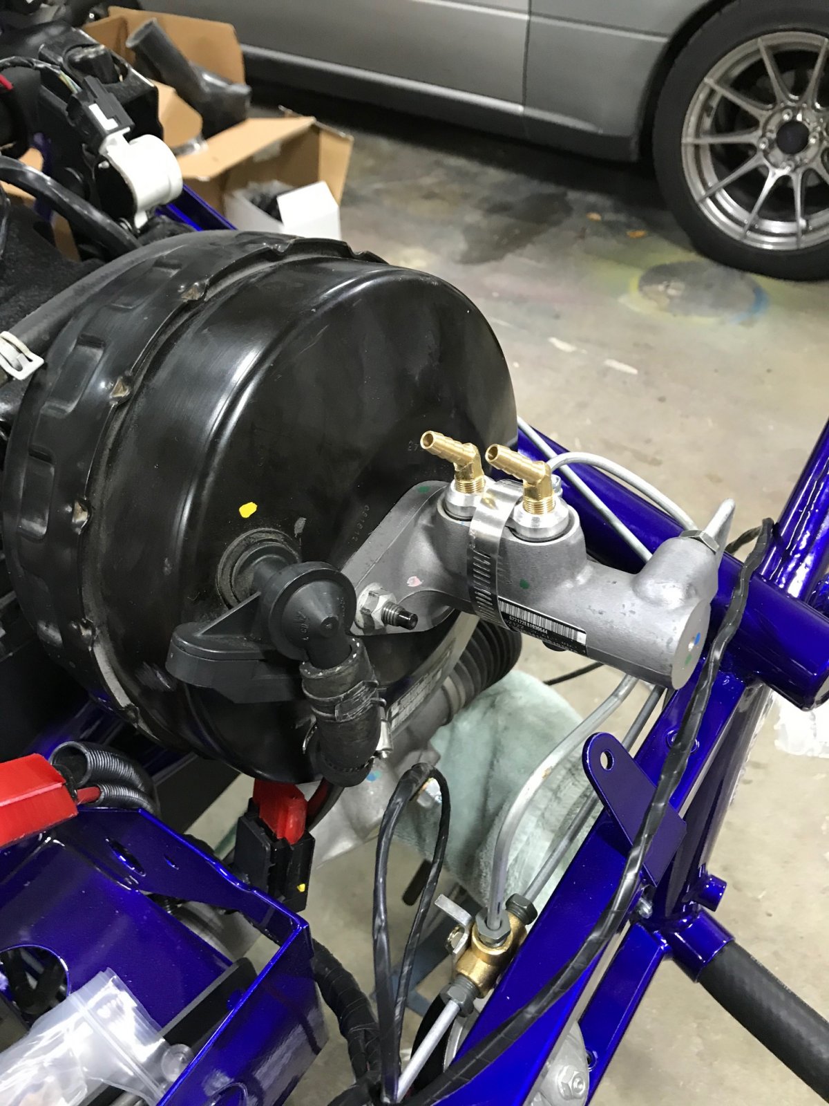

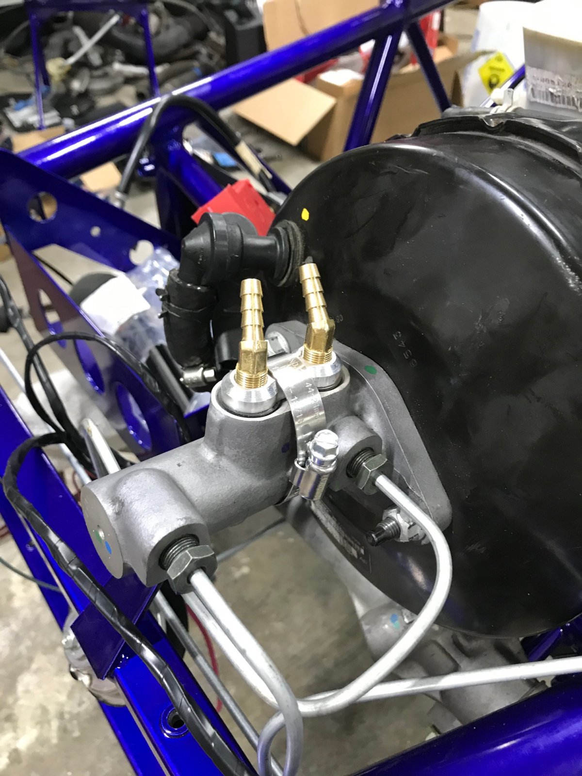

Here's what mine look like, not fully installed, but you can see what I'm describing:

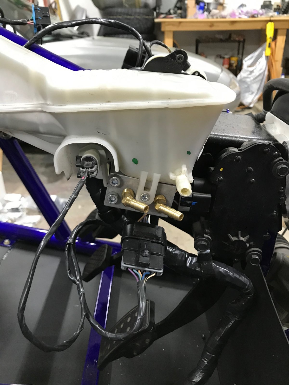

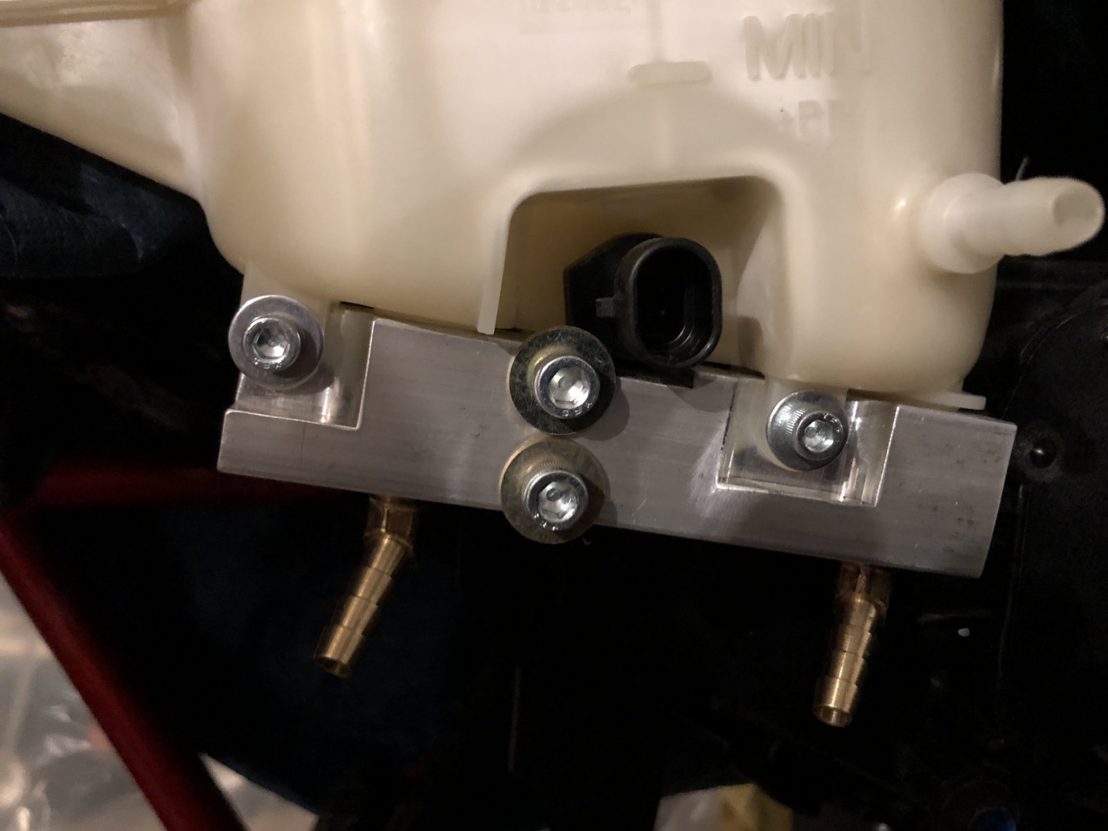

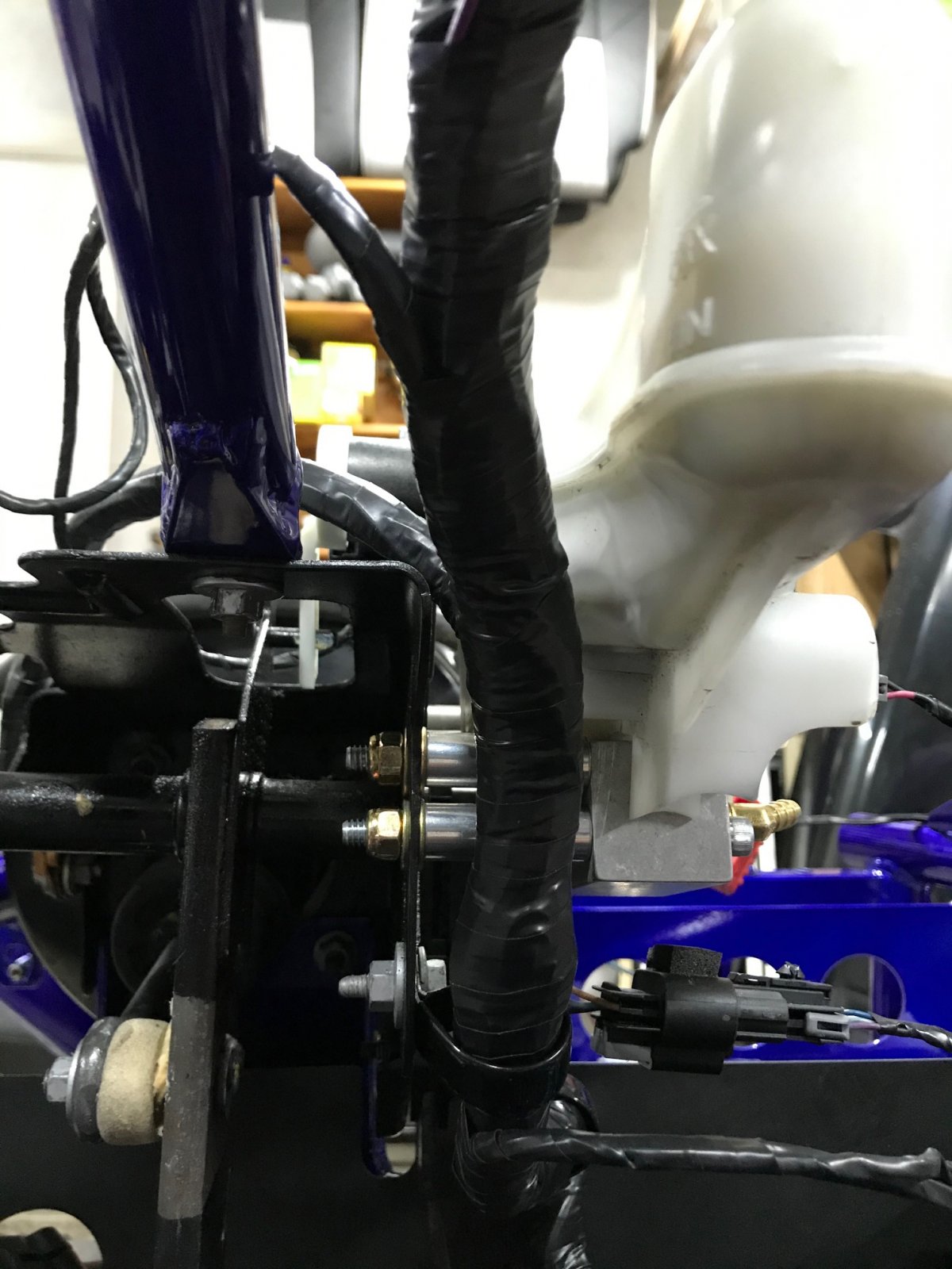

So I could not wait. Here are all the parts mounted as I think Lonnie designed. Minus the plastic hoses to connect the fittings, of course. Waterdriver says the plastic air hose will do the connecting. Since it sounds like such a tight fit, and there were no hose clamps in the hardware kit, I assume that it will just be a friction tight fit.
Comments, anyone? Missed any detail?
Thanks!

That looks correct. Use two lengths of the Nylon tubing we sent with the kit.
Wet the inside of the hose and the brass barbed fitting with brake fluid or a small amount of tire wet.
Push the hose as far as you easily can by hand. While continuing to push, move the hose side to side and and up and down and around and around. No twisting. The object is to slightly flex the hose right at the end of the barb. Take your time and don't get too aggressive.
As the hose flexes the barbs and pushing will keep the hose from retreating, so the opposite side for the hose will be forced farther onto the brass fitting. When you flex the opposite direction the barbs will hold and force the other side farther on. So as you move around and around it will work its way farther on.
You don't need to be super aggressive or you will end up kinking you tubing. The kinks won't hurt anything but they are not necessary.

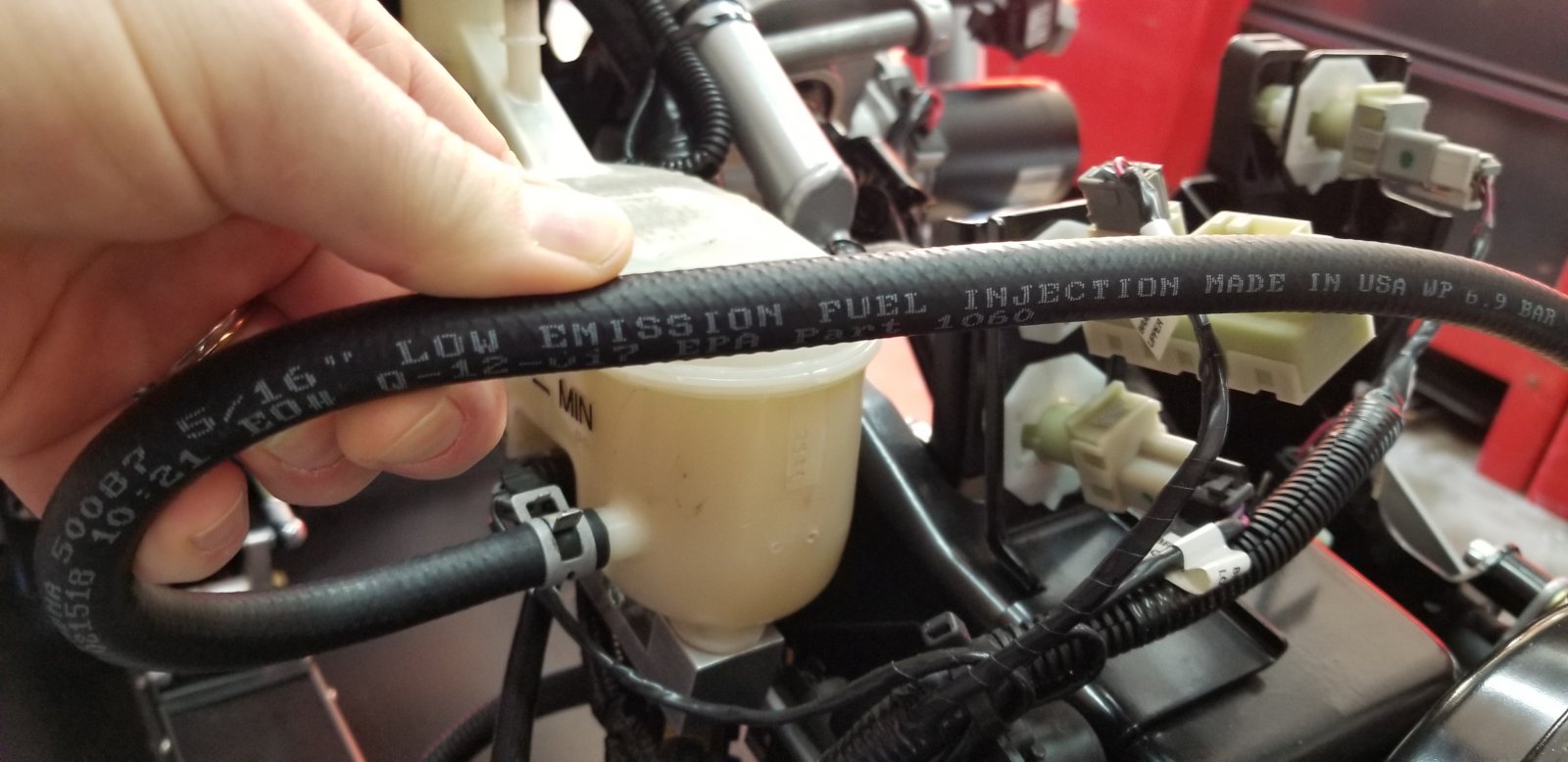

Waterdriver: What hose did you use for the clutch master to the relocated brake fluid reservoir? It is larger hose diameter. 5/16" rubber hose looks like it fits well.
@Waterdriver
Lonny: What hose do I use for the clutch master to the relocated brake fluid reservoir? It is larger hose diameter. 5/16" rubber hose looks like it fits well.
@Lonny

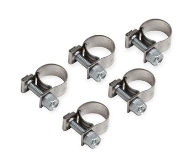

We used the original hose from the donor and cut it in half. We extended it using a piece of the black nylon 12. You will need to put clamps on both ends of the extension. We were able to reuse some spring clamps from our donor.
Fuel line clamps will work well also. Don't use the regular hose clamps, they tend to pinch.
