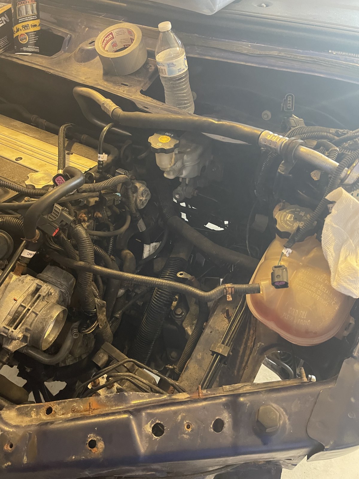

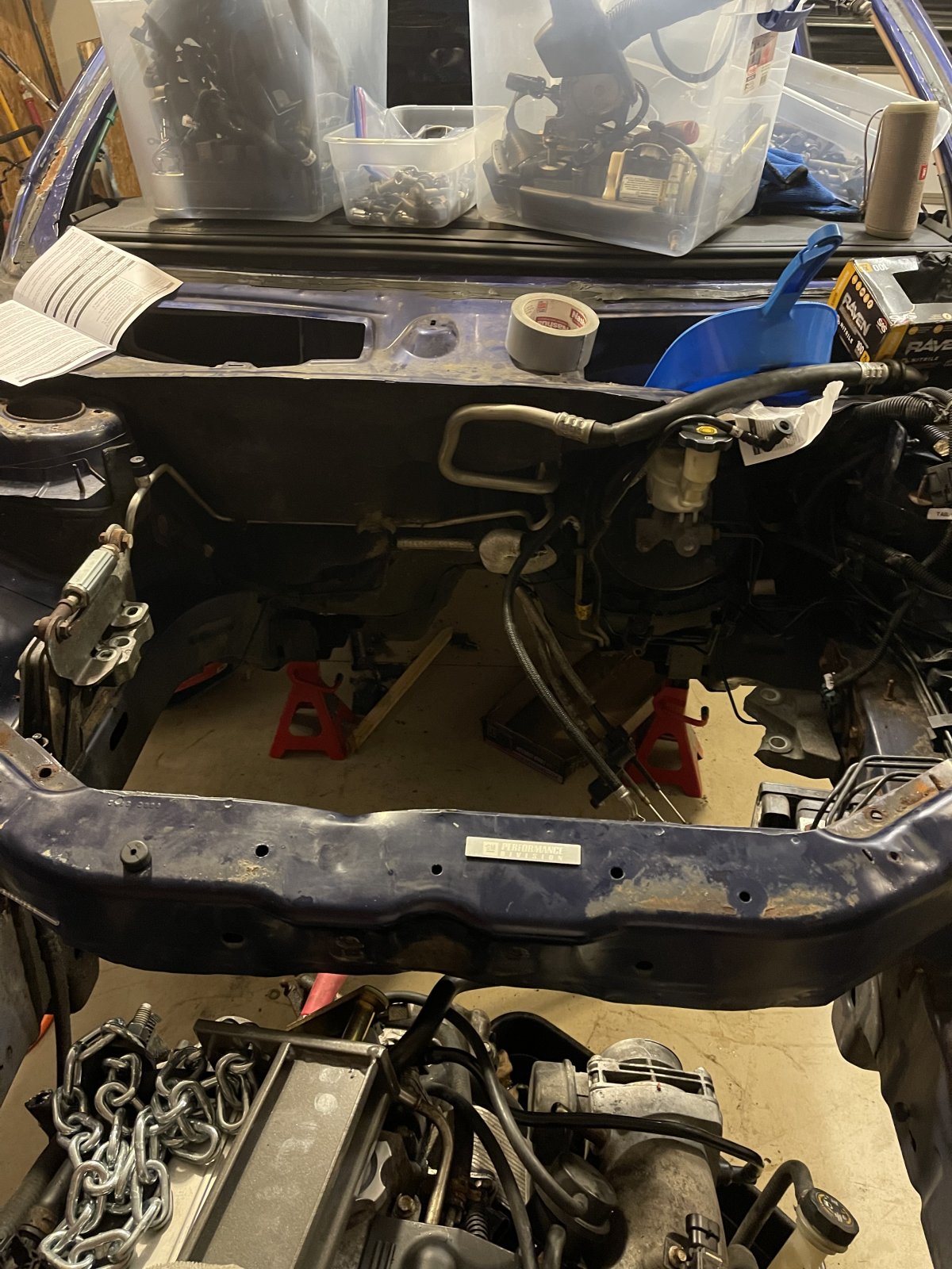

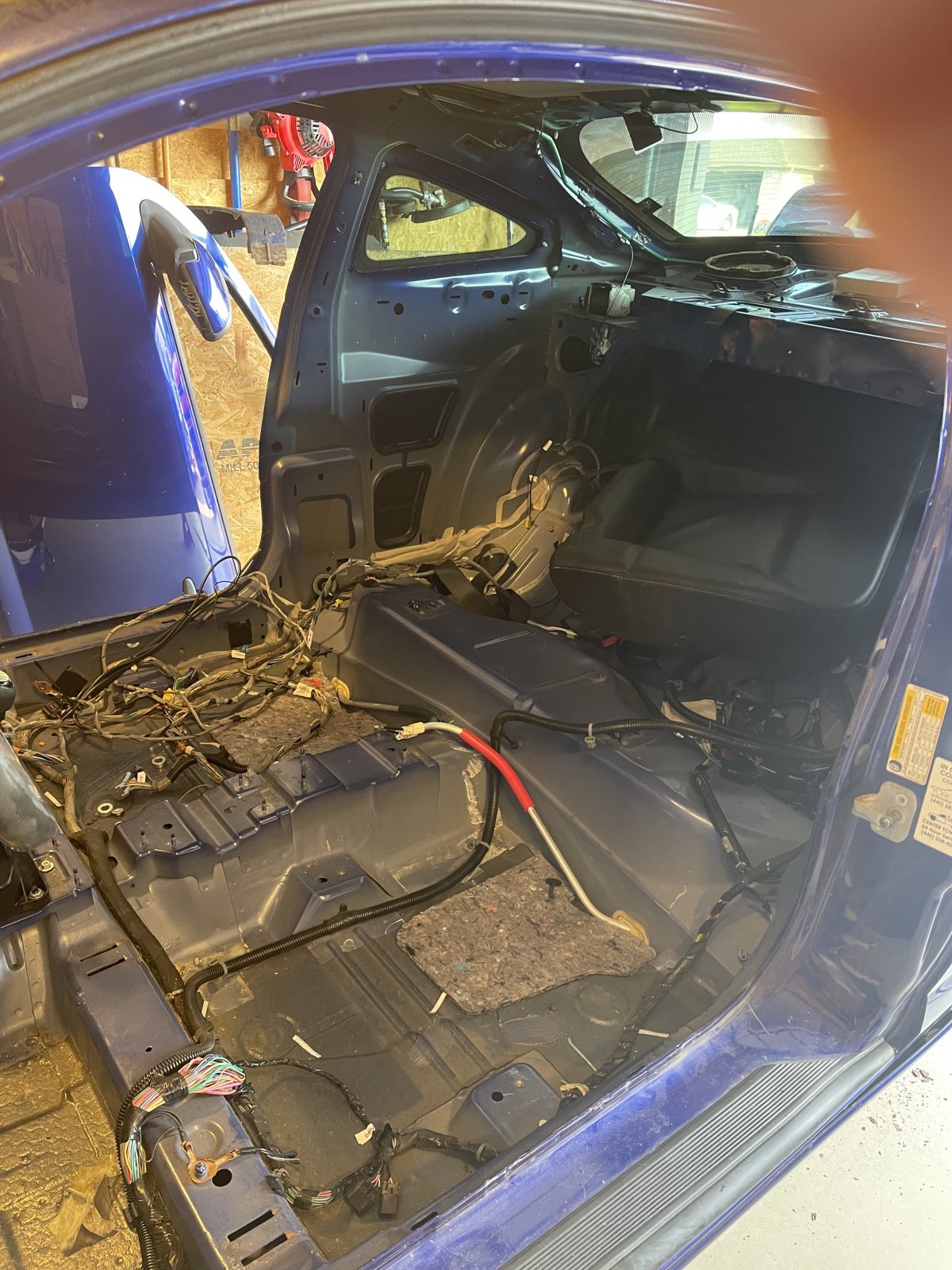

Seats out, all rear wiring disconnected and labeled. BCM, ECM removed. Got the donor on jack stands and wheels off. Debating if I want to drop the tank, kinda want to make sure I have all the parts from it in case the new fuel pump doesn’t have something needed. Got the engine bay fuse box out, the video was helpful. Did not see any leaks after running up to temp, but after pulling the passenger side wheel and wheel cover found that there is an oil leak. I am assuming timing cover/front main seal. Hopefully nothing more than that.

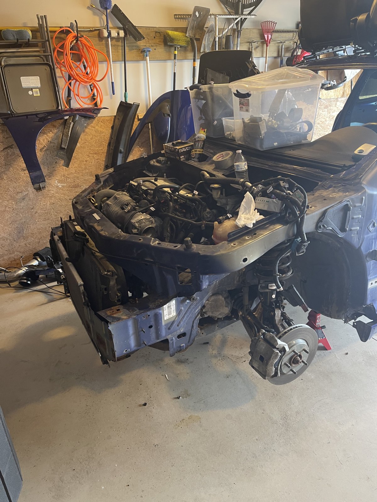

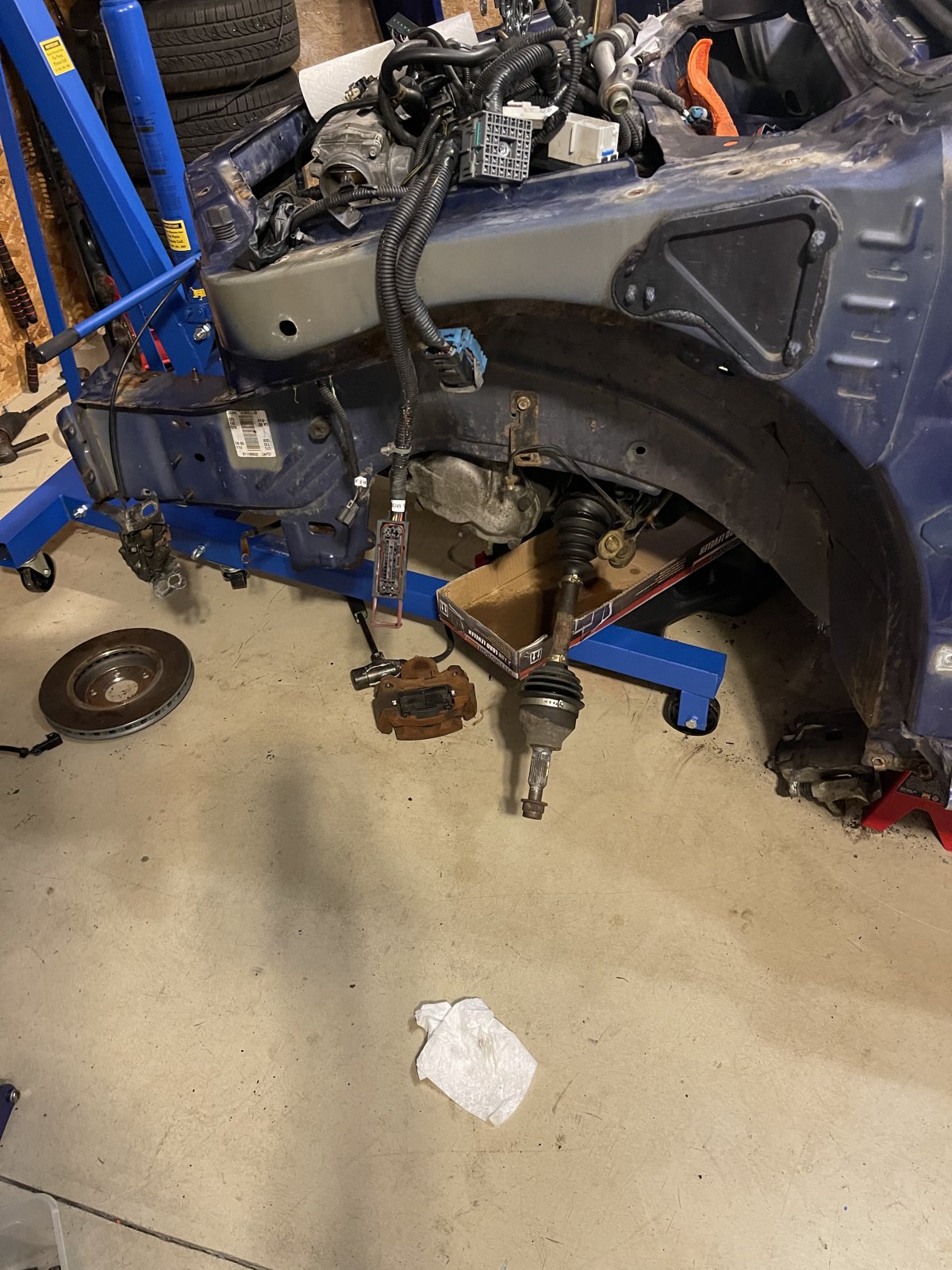

Front suspension, brakes and subframe removed. Engine hoist is set up, planning to drop the engine tomorrow. Positive, I have made back $330 selling parts on Facebook.

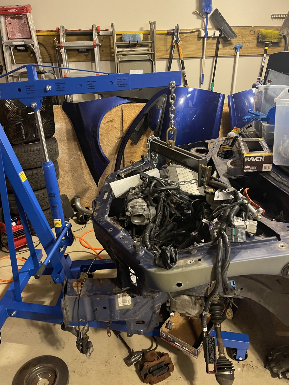

jayrolls
Tear down day -5

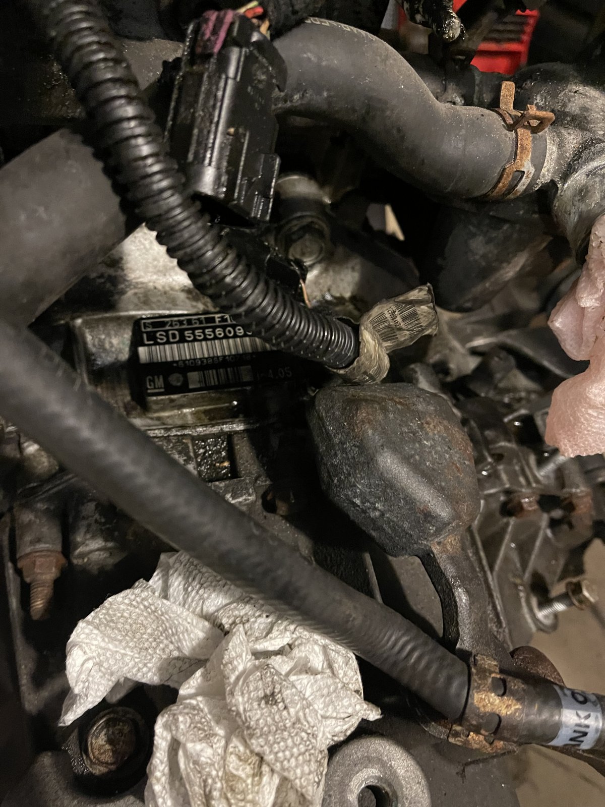

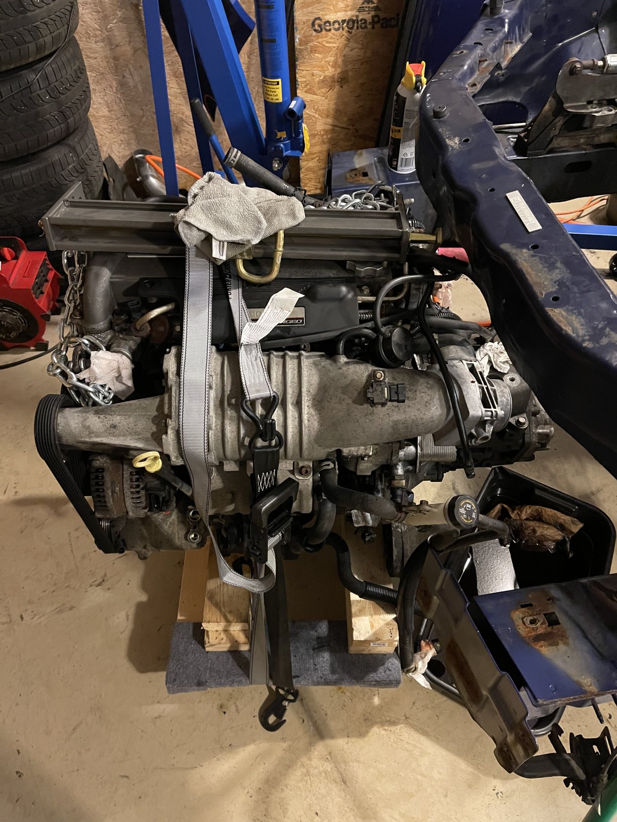

Engine is out, engine harness removed, did my best labeling everything. Note to self, should have printed out the layout of sensors, I knew what most items were, but a couple of sensors I wasn’t sure. CV shafts looks good, some surface rust but I think they will clean up. There was some metal shavings on the trans drain plug, hopefully not a big concern. Looks like I have the LSD transmission, I think that is a good thing. Won’t be able to work on donor tomorrow, but that will give me a chance to make sure I am ready to remove the dash and the harness. Hoping to get rid of the donor early next week and see what I can get for scrap.

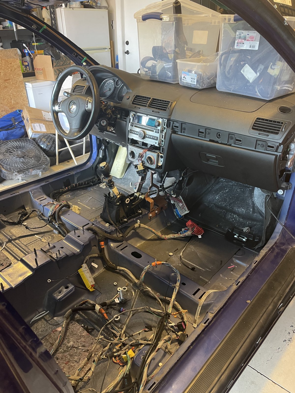

jayrolls
Tear down day -6

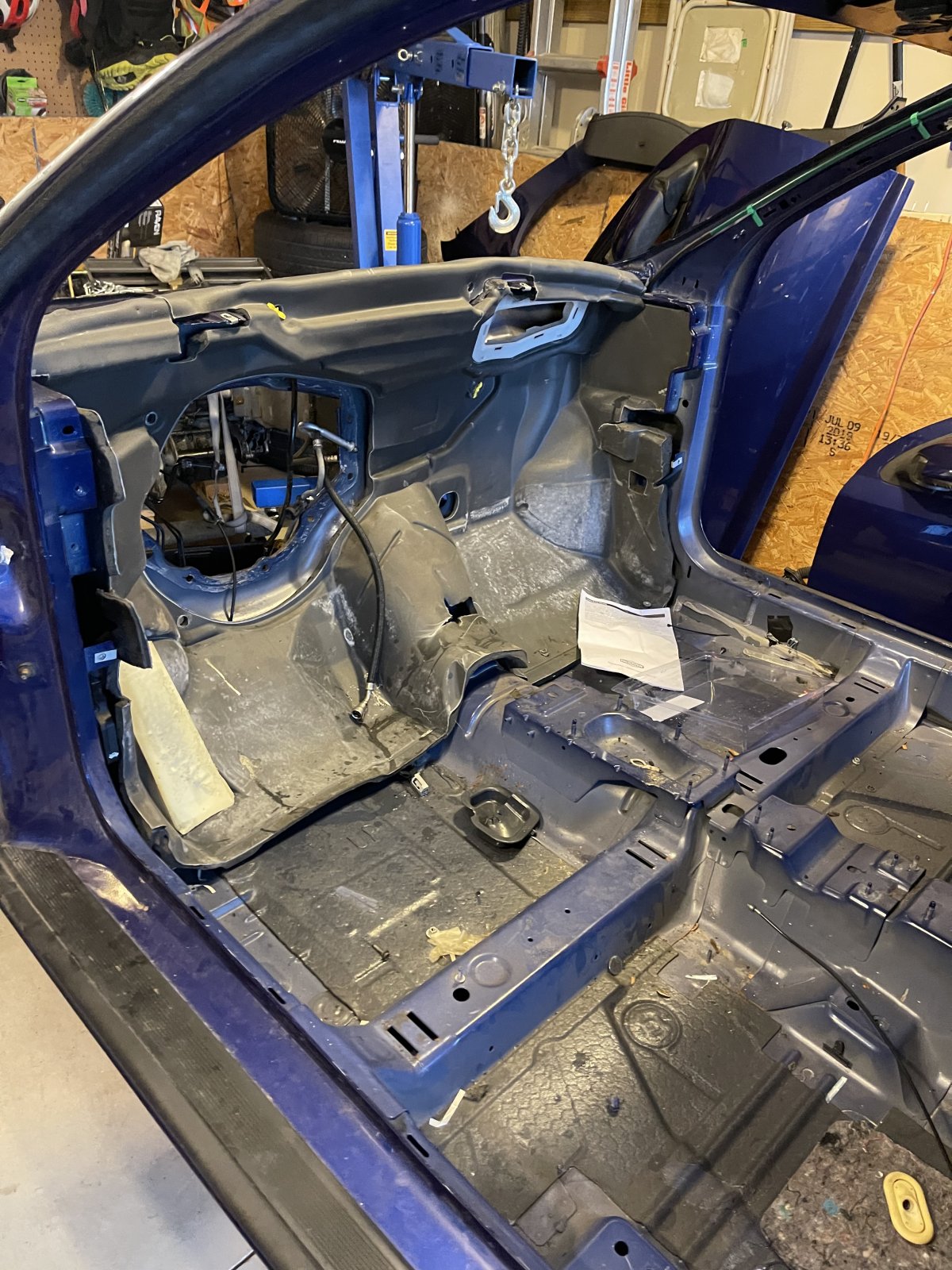

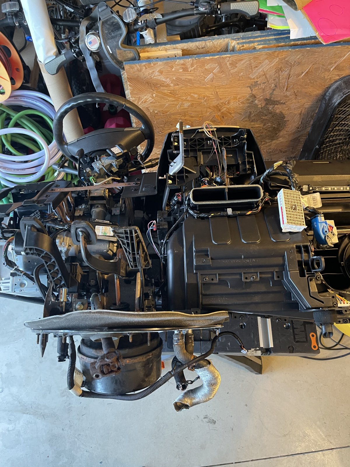

Shifter was really hard to get out. The back left didn’t corner did not want to come up off one of the bolts. Had to cut the bolt off. Then it pulled out no problem. Dash removed, that took some work. The dash was a little heavier than I was thinking. Wiring harness removed. Time to watch the dash disassembly video. See how that goes tomorrow.

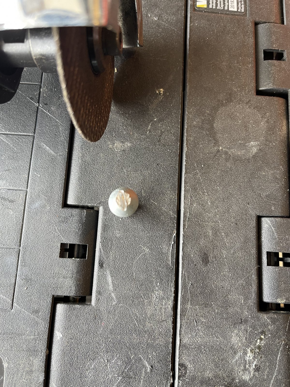

Tore the dash apart. Lonnys video was spot on, made the process very straight forward. Cutting a slot for a flat head in the tamper bolt with die grinder worked like butter and made the removal a breeze.

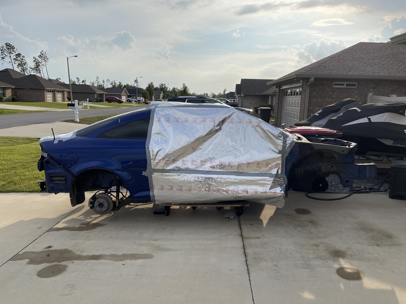

Going to build a larger furniture dolly to put the donor on and get it out of the garage. I feel that I have removed all of the required parts.

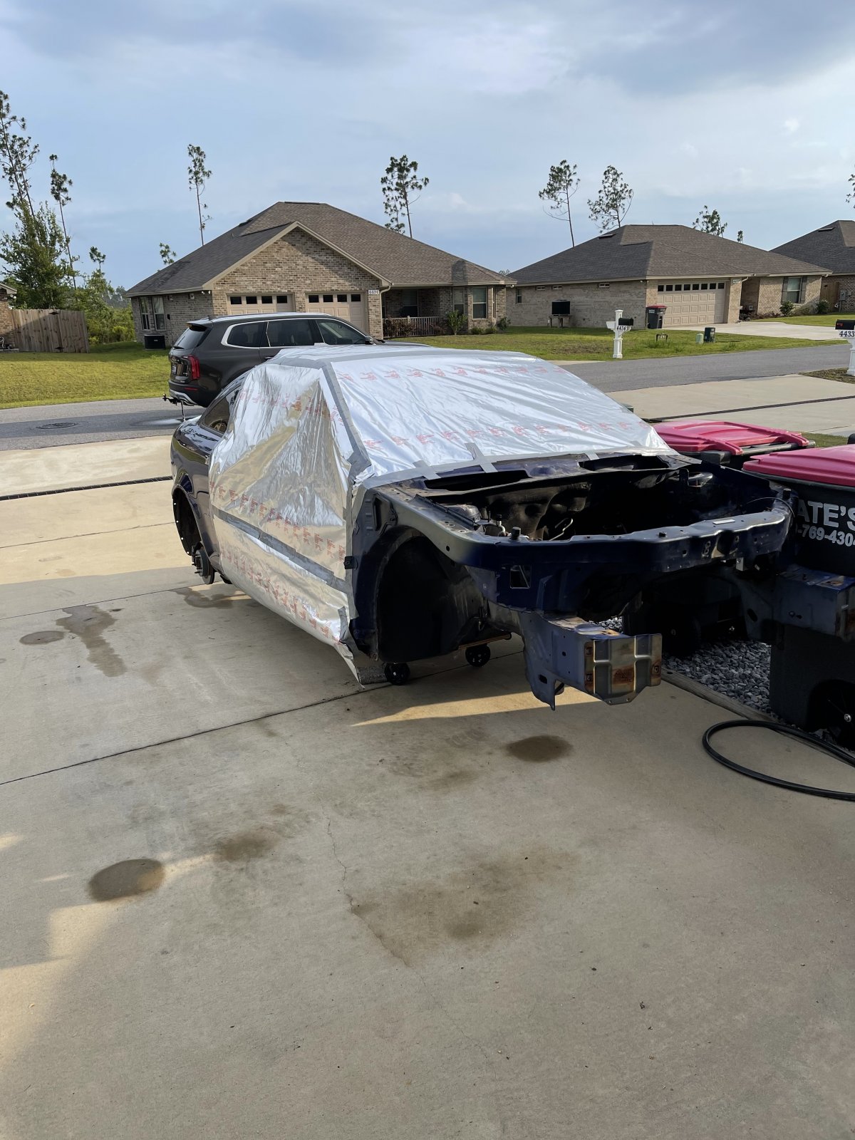

I have removed about everything that is called for. I even removed the VIN after taking plenty of pics,
that show it. Is there any reason to keep the donor?

The rear axle beam occasionally holds some value with people. The guy who bought mine was doing a LS->SS conversion on his girlfriend's Cobalt. Worth trying to sell maybe if your budget is tight or you have the patience for it.
jayrolls
I’m not patient enough to hold on to it, nor do I have the room. Lol

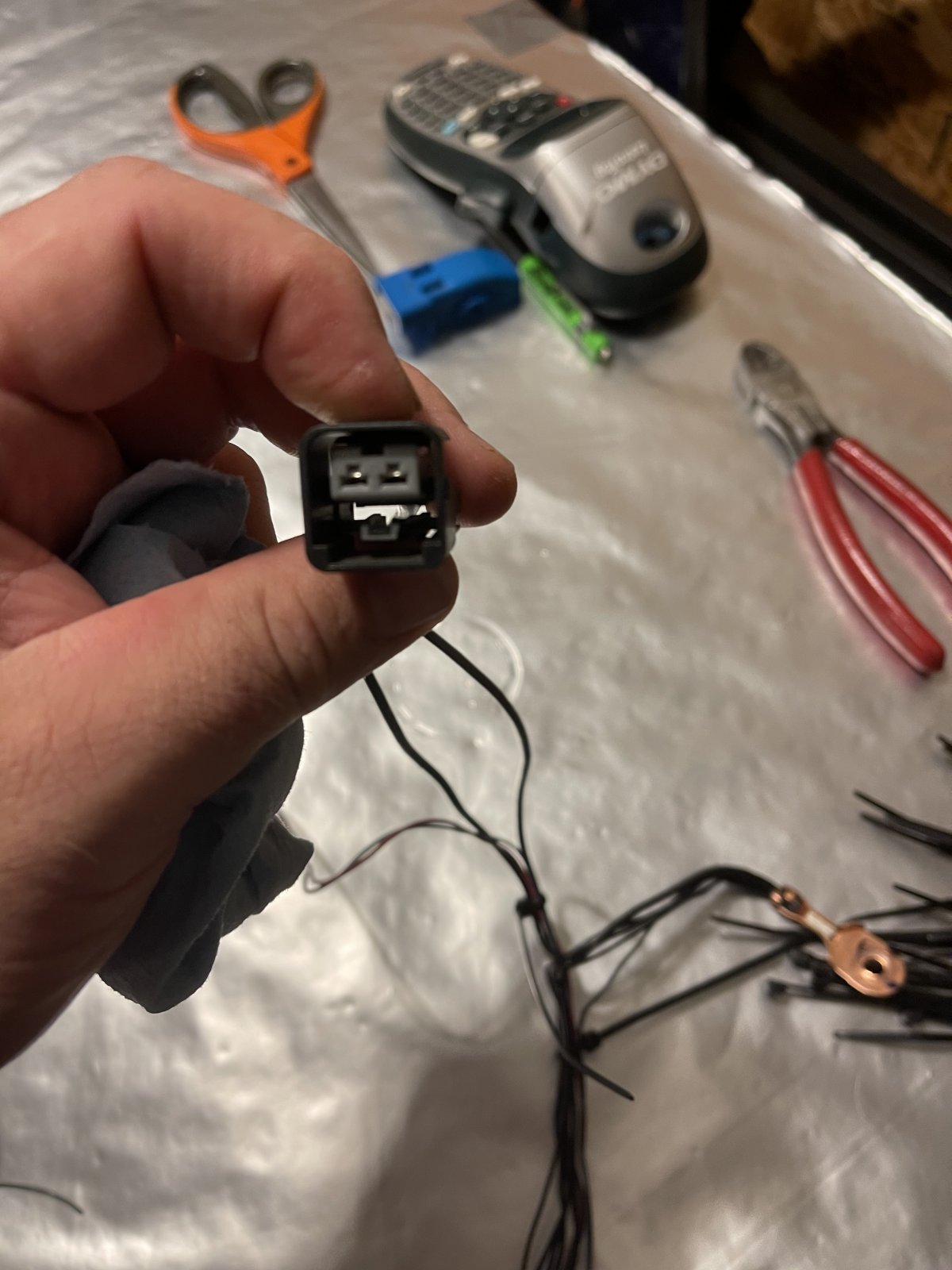

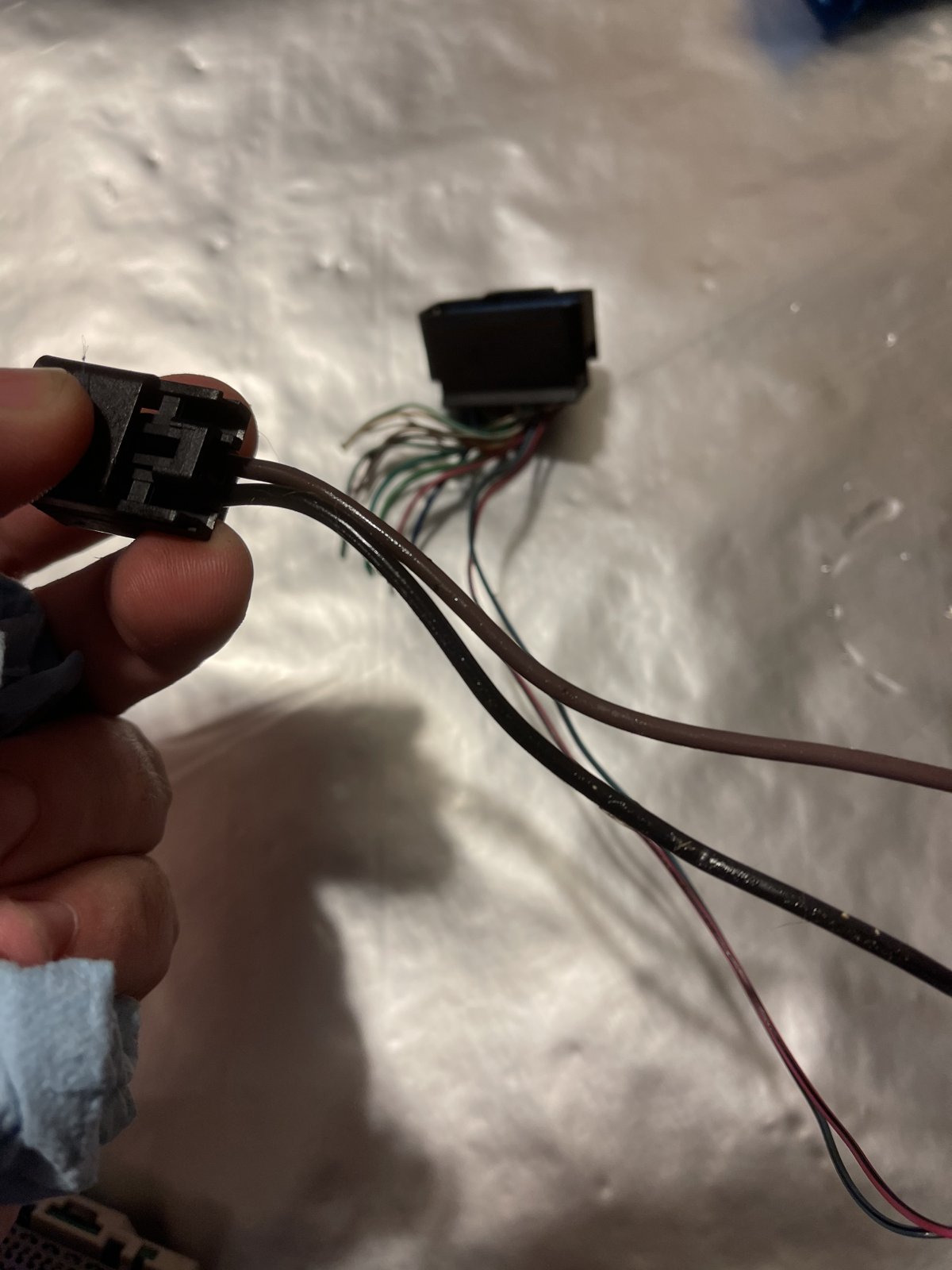

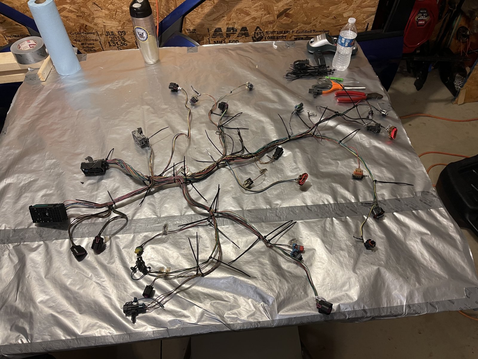

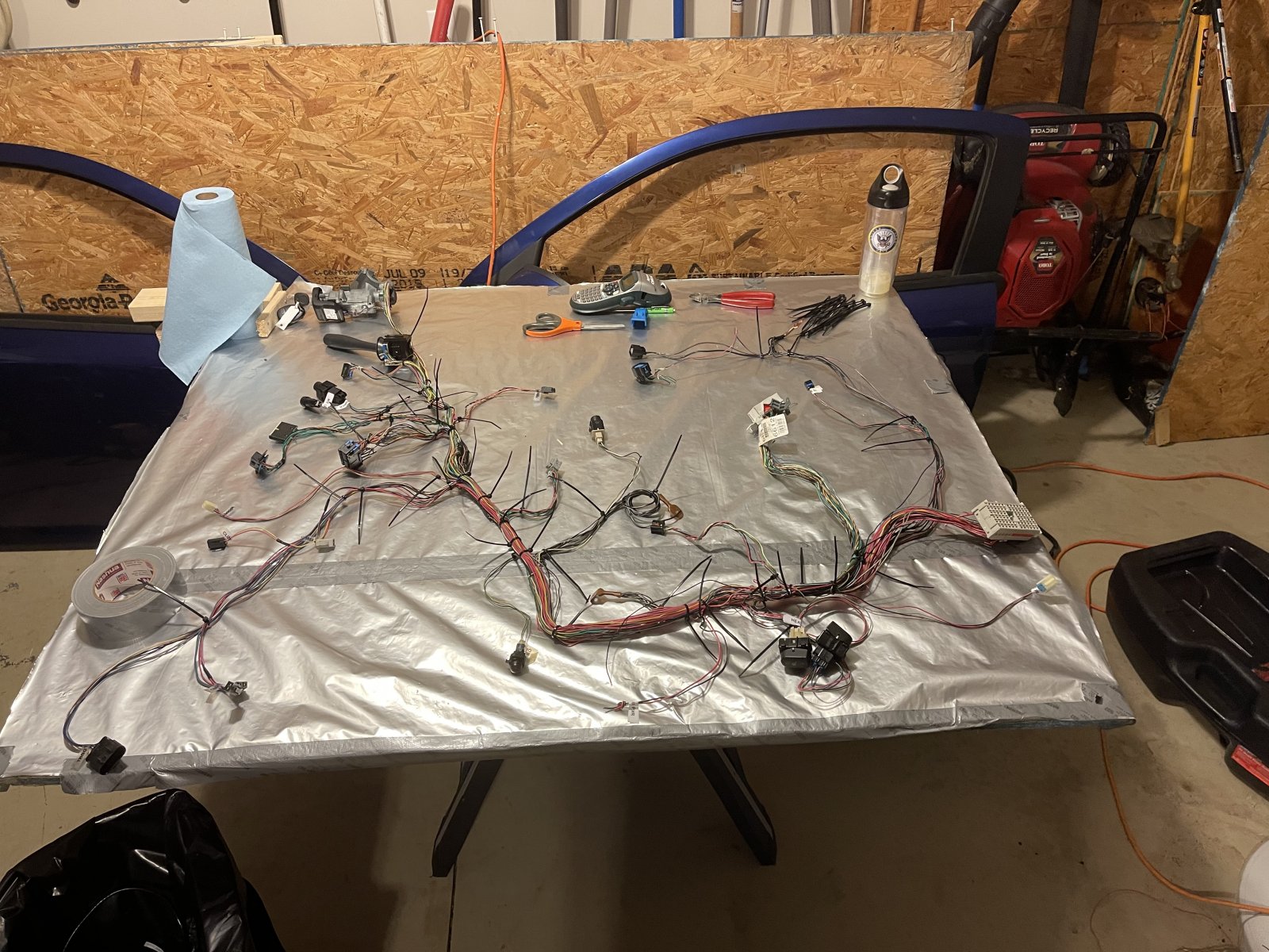

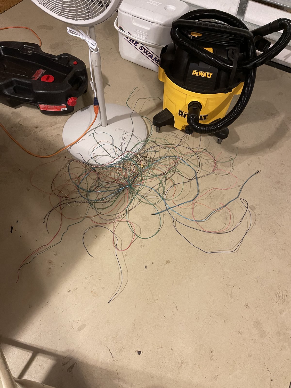

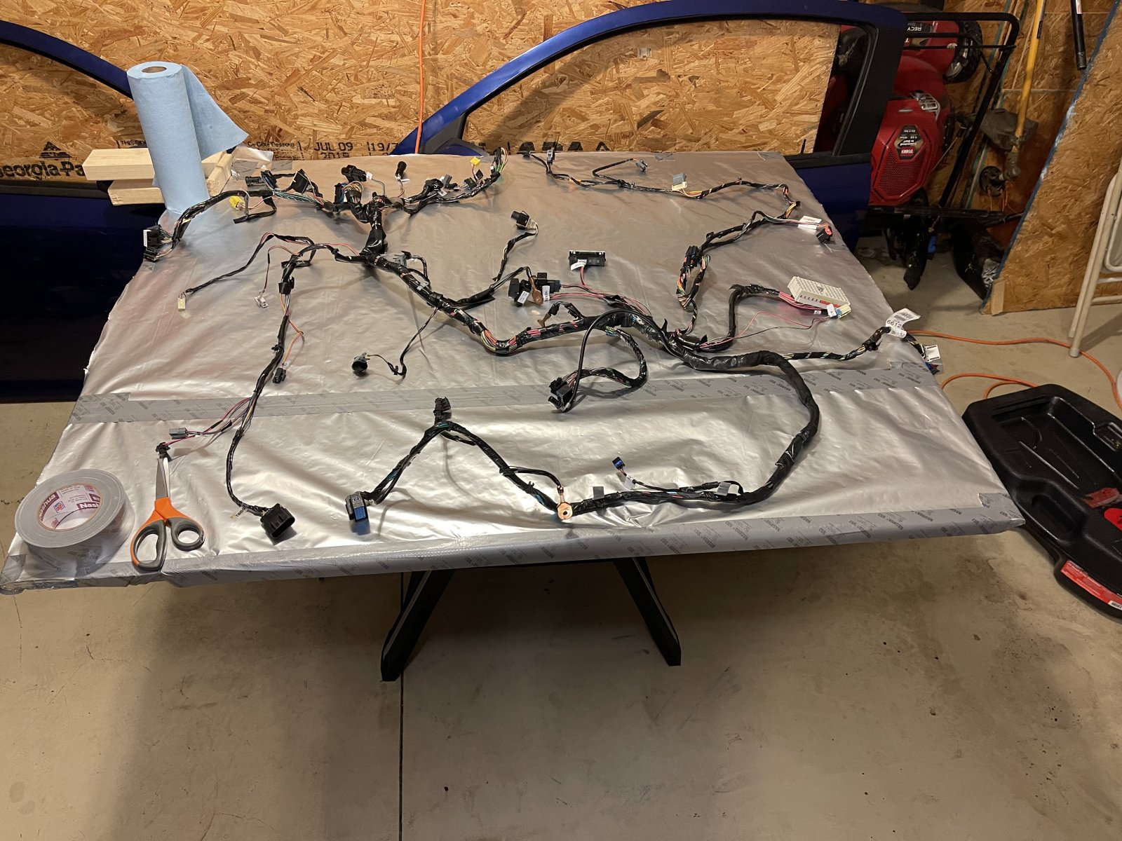

Dash wiring harness day -1

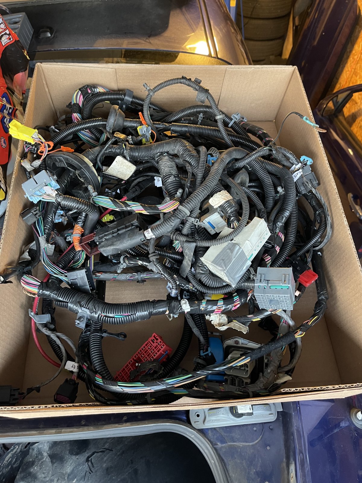

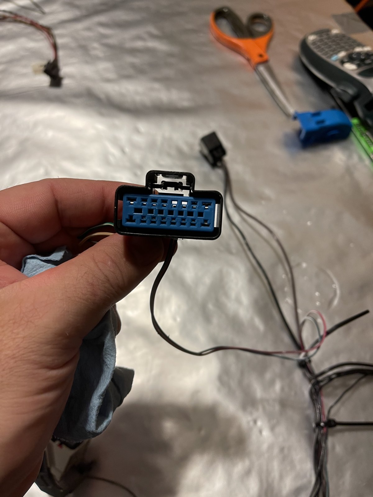

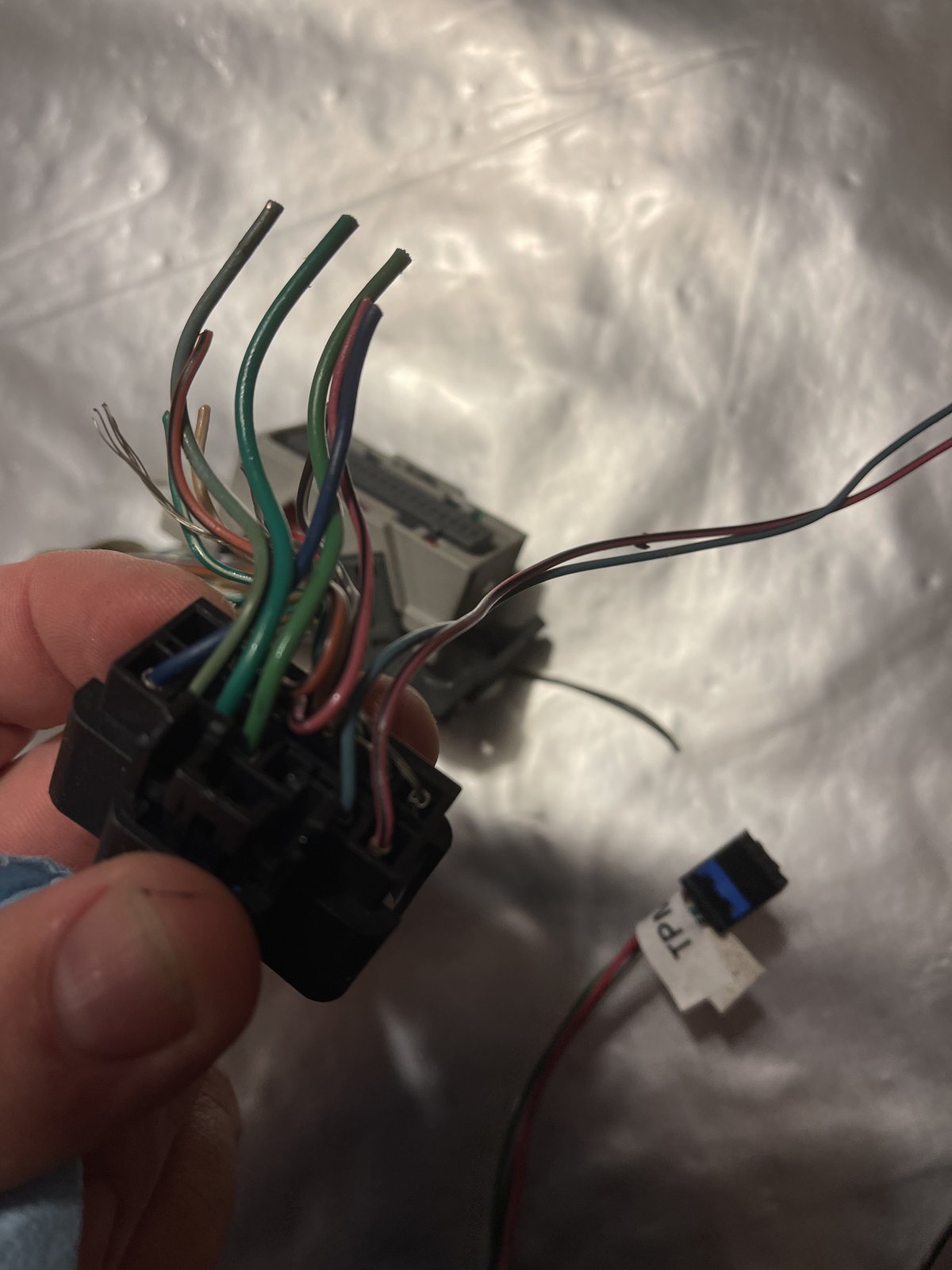

Got almost the entire harness thinned out. Have two connectors left that I am not sure about. The first is image 4 black multi plug That a lot of radio wires went too. It has a a teal and burgundy colored wire that I am not sure where they go. And the other image 6 is a two wire plug, thick black and brown wire. The black I know is a ground and the brown is going to the large BCM plug. Trying to look in ALLDATA, hopefully I get it figured out. Donor had heated seats, I plan on keeping that feature.

jayrolls
Figured out the connector in image 6, it’s the blower motor. Should be good to remove that brown wire going to the BCM plug. The black multi plug had the foil wrapped wires going to it. But haven’t been able to figure it out yet.
jayrolls
Wires figured out. Harness is finished for now. Looks like your suppose to wait to tape it all back up until you test fit it. On to the next harness.

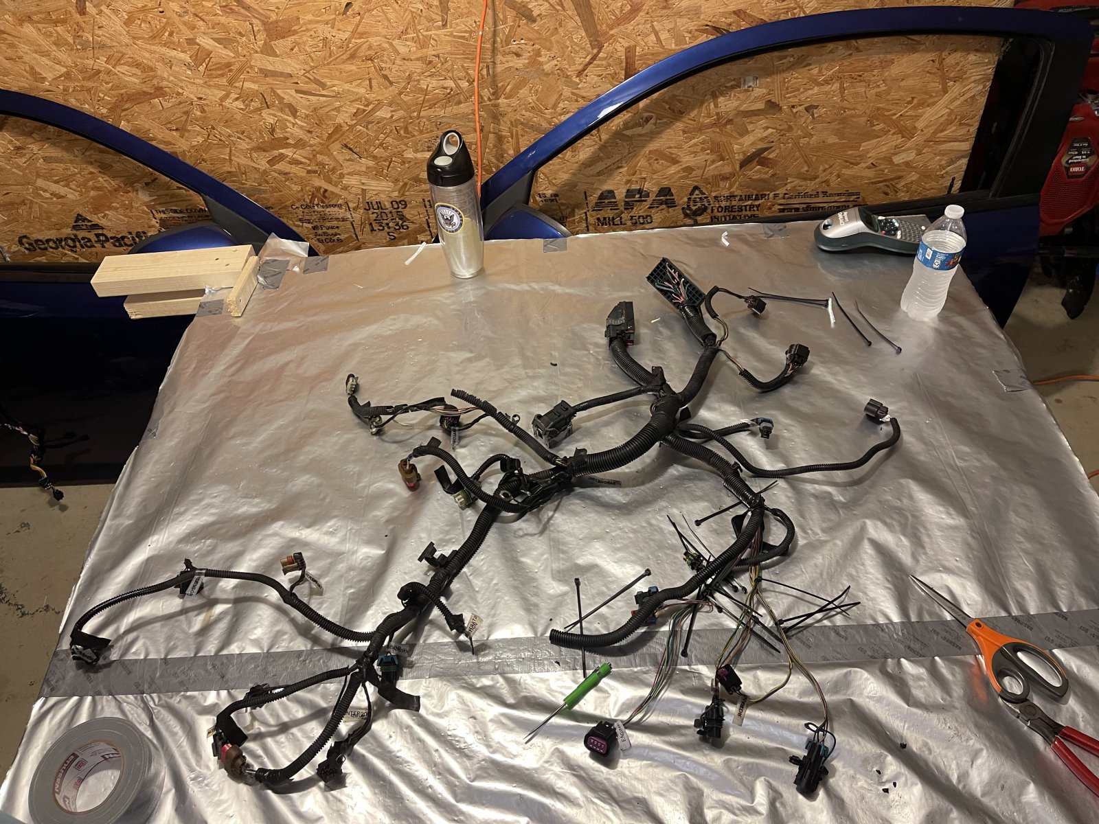

Engine harness day -1
Got all the tape and cable wrap removed from the engine harness. I think the a/c wires are the only thing that need to come out. Then I will be ready to re-wrap it.
