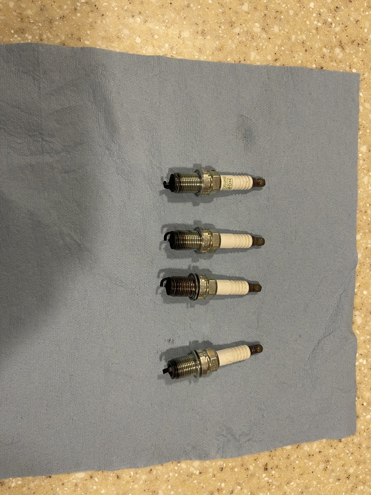

Checked made sure the coils where in the correct cylinder. Pulled the plugs they are pretty gas fouled. And looking at the threads in the plugs, it looks like one might have been blowing by. Going to get new plugs and try again. Hopefully that will help. Also need to get help with what to start trying to adjust on the tune. I know the 3.0 pulley and 60# injectors would need to be tuned, but didn’t think it would be so far off to start with. New at this whole tuning ideal.

Ya. 60# injectors makes a big difference. I still don’t have mine completely sorted out yet, running a 2.9 pulley though.
