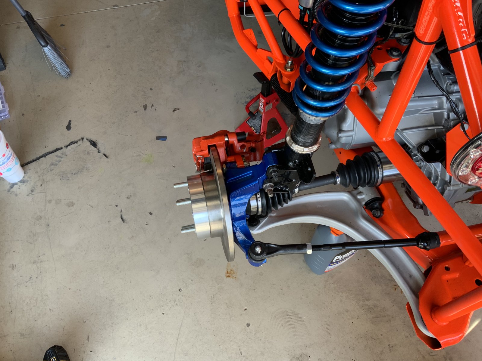

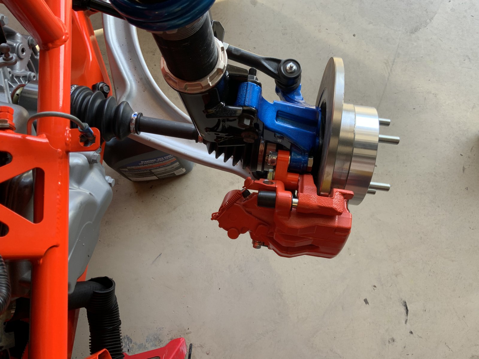

Got the rear brakes installed, still need to run the brake lines and the ebrake cables. Had to add an extra washer between the knuckle and the adapter to have the correct spacing around the rotor. Installed the spacers to make sure everything fit. Looked like I will have to pull the spacers back off and trim about 1/16th - 1/8th off the stud. There is plenty of space before the threads start so should be good.

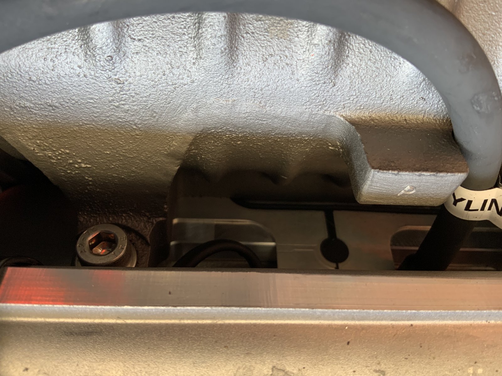

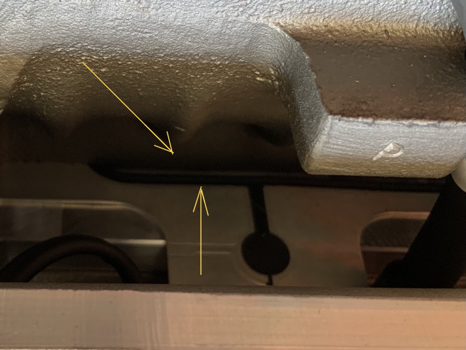

Smoke machine on order. Should get here Friday. Want to confirm what I found while inspecting today. It looks like I have a problem with the way the gasket is lined up below the supercharger. In the picture you can see part of the rubber gasket that should be making a seal. I believe I have found a major intake leak. I pulled and inspected the fresh set of plugs I installed yesterday. the threads looked good on all of them this time so I do think that one was a little loose.
Goal for the weekend, smoke the intake. Pull supercharger and replace gasket. Install 42# injectors and GM stage 2 tune. Start engine again and hope that she is happier.

Couldn’t take it any longer. Still waiting on the smoke machine to get here but I knew the gasket was wrong. Wife helped we pulled the supercharger and installed the gasket correctly. Running a million times better. Still plan to install the 42# injectors.

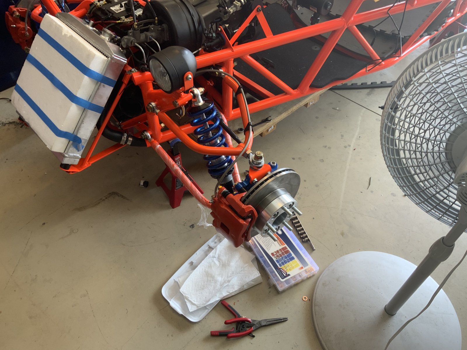

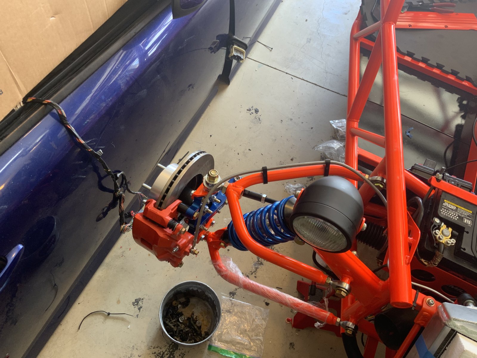

Finished installing the front brakes and plumbed the rear. Been struggling with bleeding the system. Think I have it wiped now. Found a leak at the input line at the front brake tee and passenger side flex line to solid line. Now just need my pedal assistant to help me finish up.
