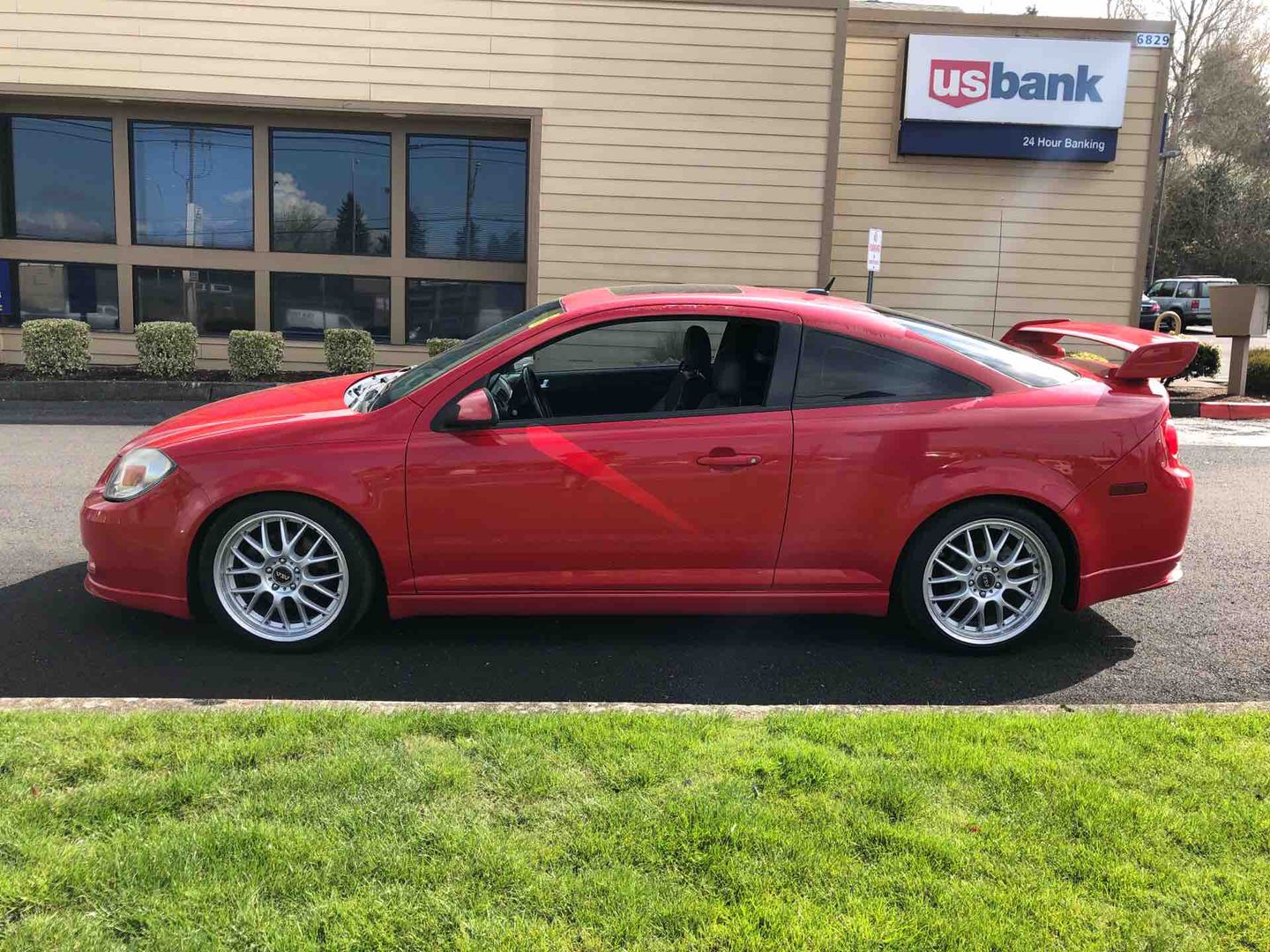

Hello all,
I got the word today that my frame will be #160, probably sent out in July. I've had the doner a few weeks now and have been driving it. It's an 06 supercharged SS. The cobalt seems to be in good shape mechanically. There's a bunch of exhaust leaks, but I don't care as I don't need those parts, and the interior is shot, body panels loose, paint is wrecked and so on. It has been lowered though, so I'm concerned as to how the previous owner lowered it (cut springs probably?). I may need to get some stock cobalt suspension parts later. I'm planning on using the wheels, although I wouldn't mind getting a little taller tire on them.

Don't sweat the suspension issue. The kit comes with new fronts and there is a coilovers upgrade for the rear (donor front). You'll find you will need to replace most of the suspension components anyways (bushing, etc).

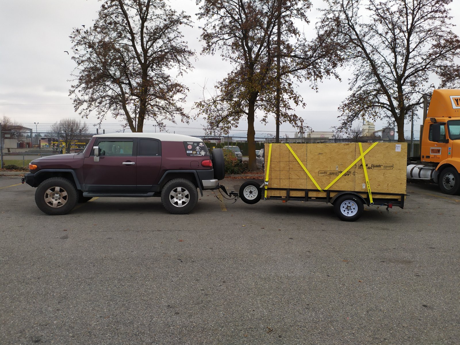

I picked up my frame on November 13th in Spokane. I wanted to mention to anyone hauling their extended frame crate with a Lowes 5' x 10' trailer, it will fit with about an inch in width to spare, and will stick out the back about 2 inches. You'll need to fold the ramp all the way forward to haul it.
I'll do what I can on this project through the winter, but I don't think I can get it to rolling and still fit through my shop doors. Does anyone know the total width of a Goblin with tires?

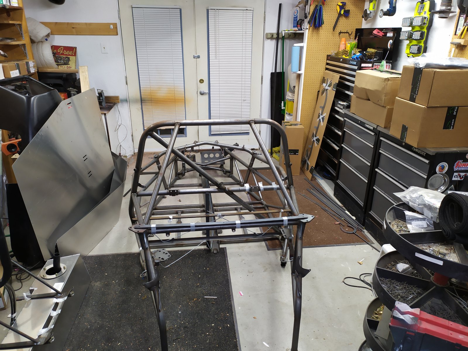

Jeff, I saw in another thread that you were considering getting silicon heater hose with a smaller outside diameter to pull through your frame. Did you end up doing that? I'm having a hell of a time getting my heater hose pulled, even with DF's little drill tool...
Shoot me an image of the lube you are using on the hose.
Oldchevyguy
I had no problem pulling the supplied hose through. I used lots of tire wet, and an electric winch. I used the slug method, but if I had to do it again, would use the newer method of drilling the two holes and threading the rope through the hole a clamping it.
I used a pullzit electric winch, but a ATV winch is similar. Even a come a long would work too.
I don't want to take over this thread, but ... it's just standard Tire Wet. This brand:
Damaged the nylon strap on the puller tool, also ... it wound a little funny on my first attempt and ended up frayed a bit on the one edge so it's looking worse for wear now. I'll attempt the method mentioned by Oldchevyguy in the last post, tomorrow.
Waterdriver
If you haven't already, pre-wet the inside of the chassis tube with a rag liberally wetted down with Tire Wet. Pass trimmer line through the chassis tube and tie the rag to the middle of that line. Pull it back and forth a couple of times, wetting the rag each time.
Before doing the above, the hose kept getting stuck at about the first bend in the chassis tube, if pulling the hose from the front to the back of the frame.
Good luck!
JeffInWA
I tried the trimmer line/mini paint roller/tire wet thing, and also heated up the hose as much as my shop heater would do (hanged it in front of the heater for about an hour). The furthest I ever got was to the first bend, so I just bought the silicone hose instead.
Easily pulled 7/8" ID hose through one side, then sent it through the other side without any lube at all, and by simply pushing it - no rope necessary. I had to order some adapter couplers to mate it to the other tubing, but I think it will look good this way. Also I have some large shrink tubing for where the tubing exits the frame to keep water out of the frame. I'll post some pictures when the couplers get here.
I don't expect that 7/8" tubing will make a big difference in cooling. Guess I'm going to find out.
Thanks for the response. I'd be going the same route, had I not had success yesterday pulling my hoses. Thank God that's done. -.-;;
