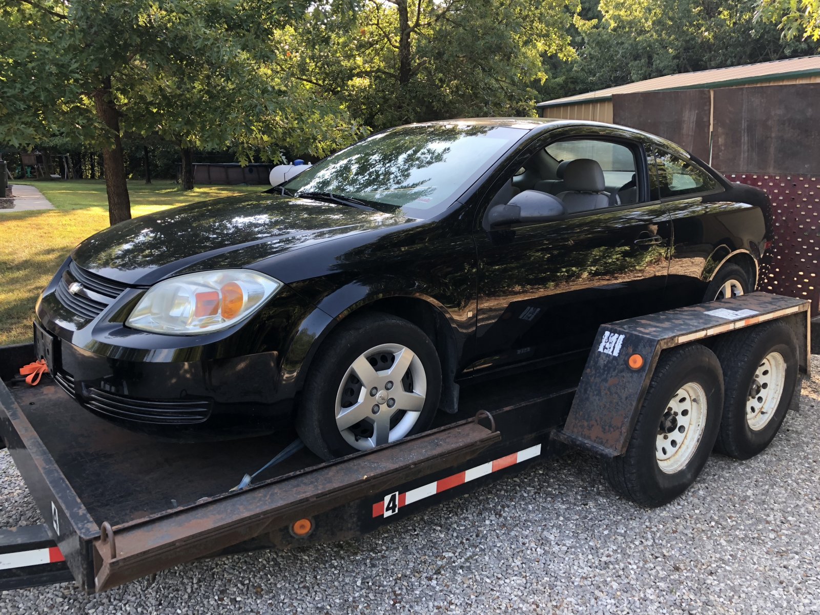

You live, you learn, I guess.... I saw someone else here refer to this type of learning as an "educational tax" LOL... My chassis is supposed to be ready for pick up next weekend so I have that to look forward to. I already got the junk title back from the state on my second donor so as soon as I can get it into the local shop to get the AC evacuated, I'll start tearing it down.

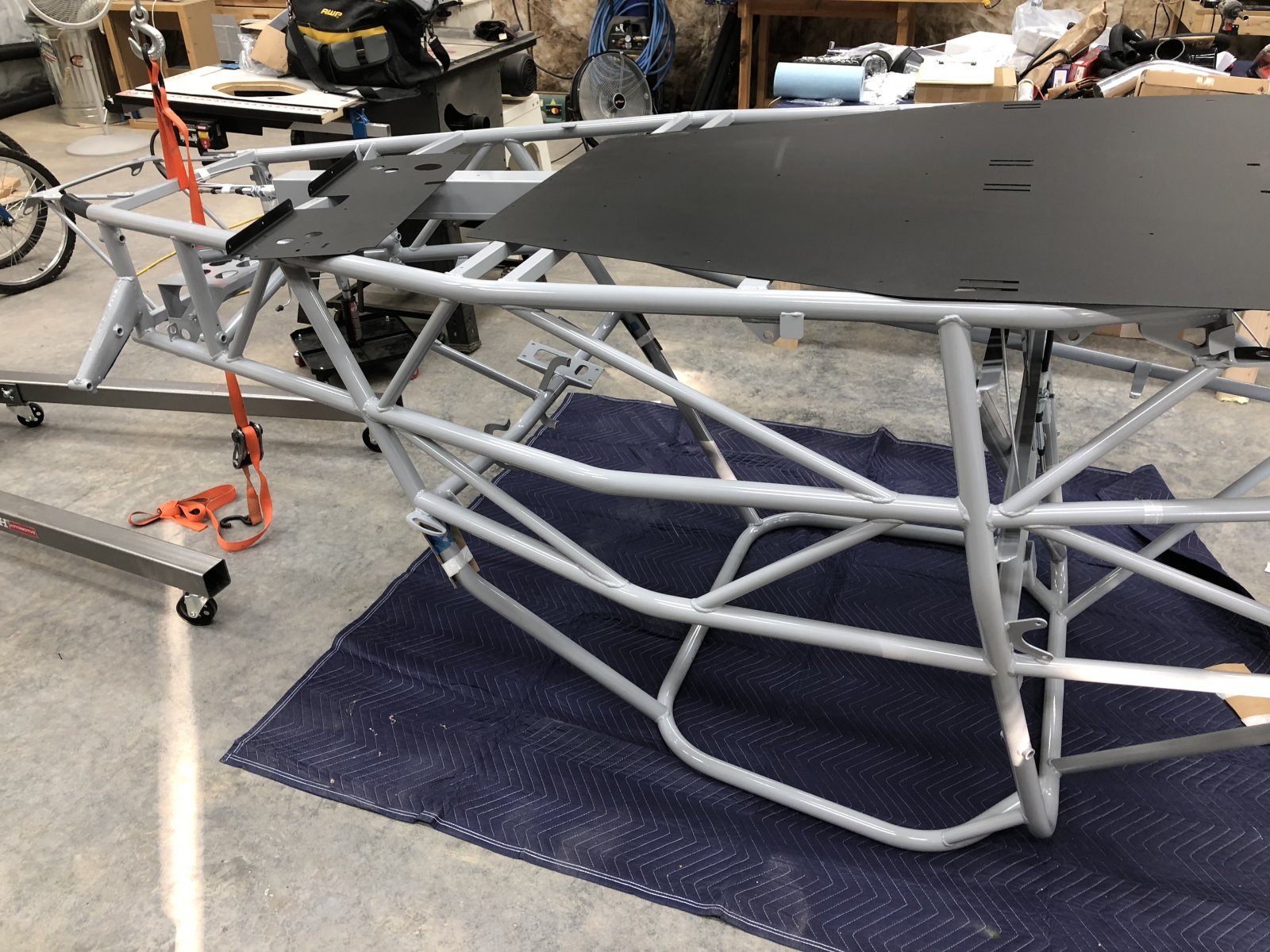

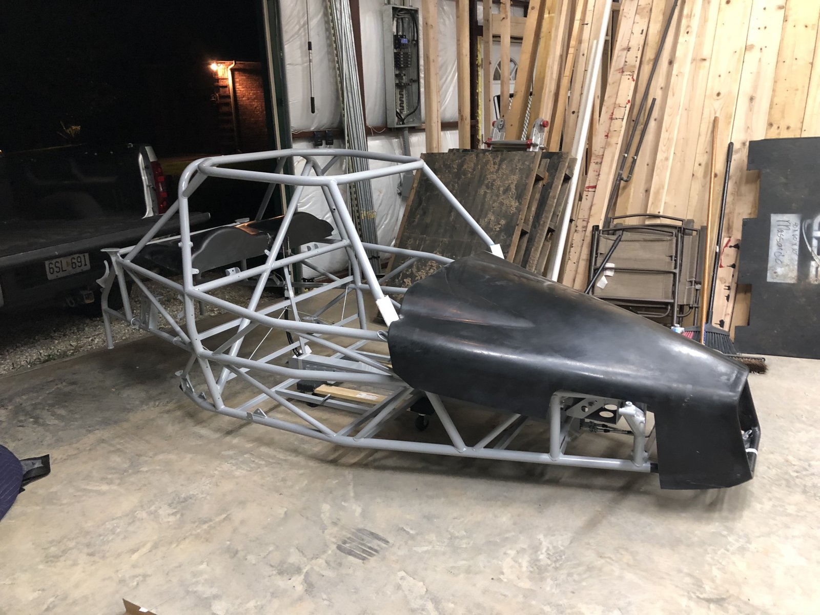

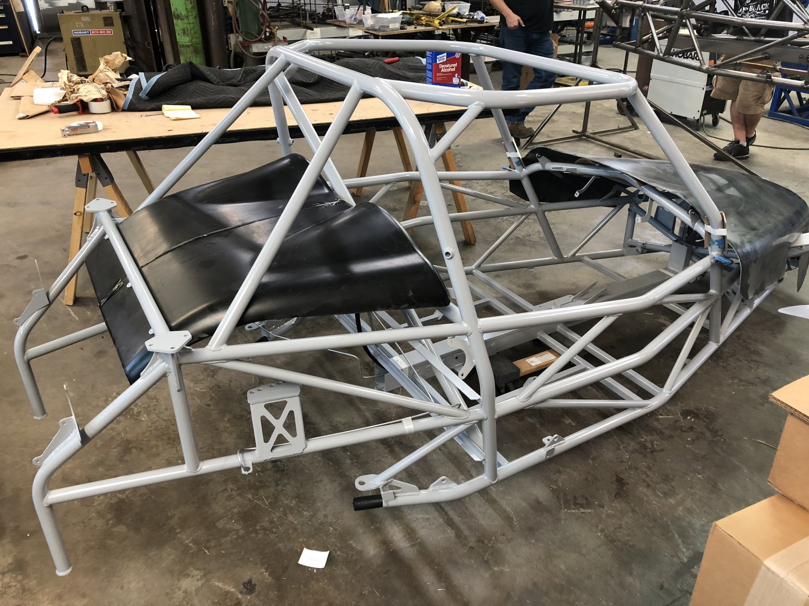

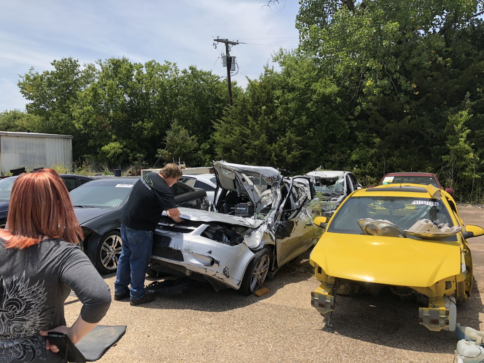

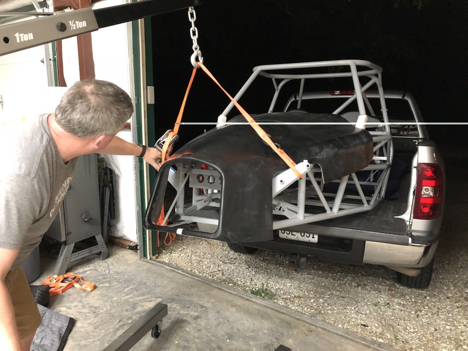

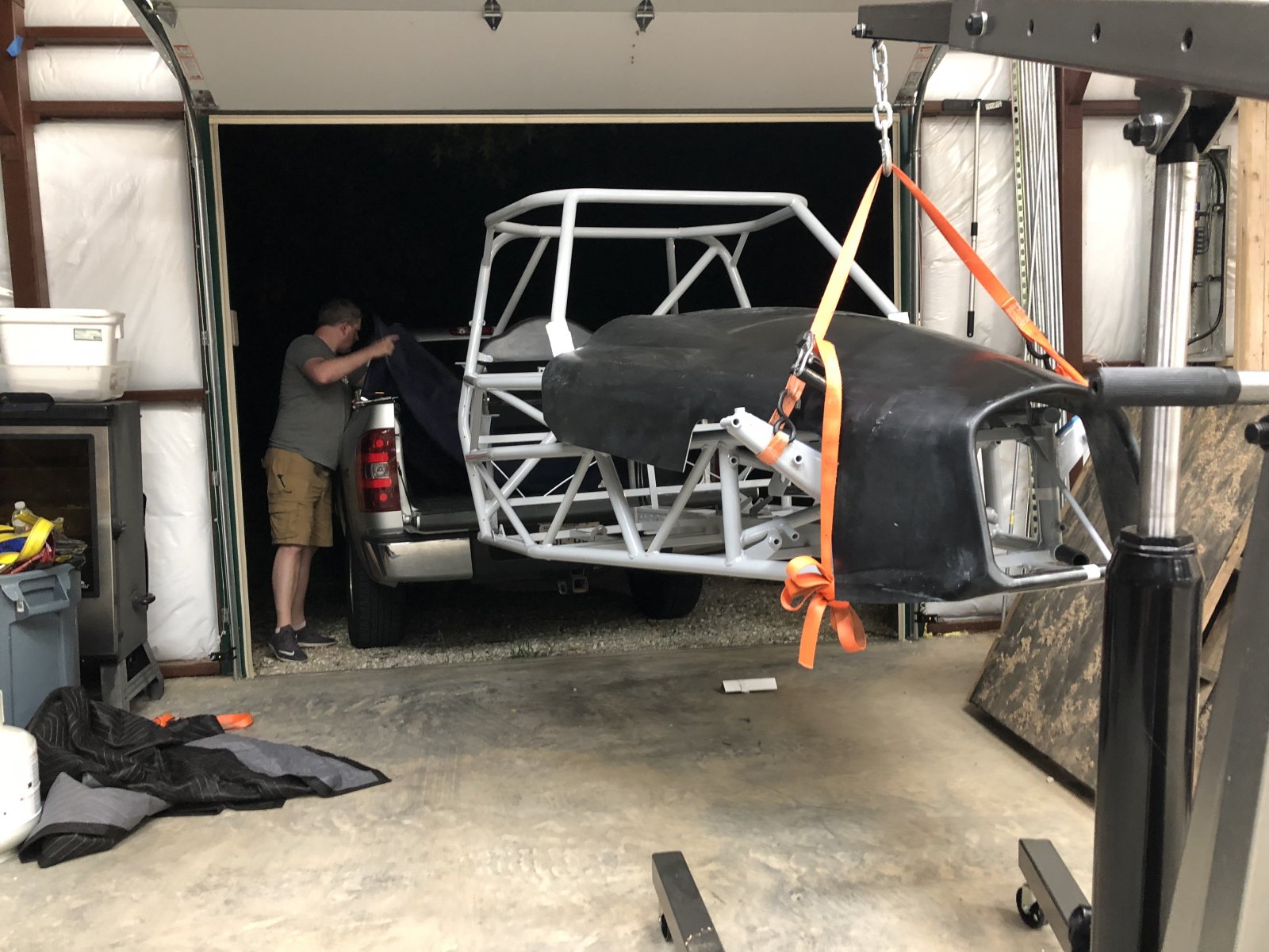

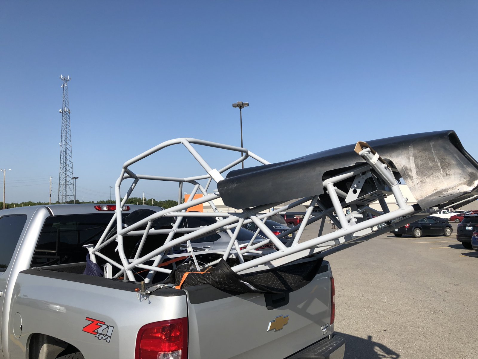

Whew... today was a long day. Made the trek from Southwest Missouri to Adam and Lonny’s shop to pick up my kit. It was great to meet the guys and get a ride in Lonny’s goblin.

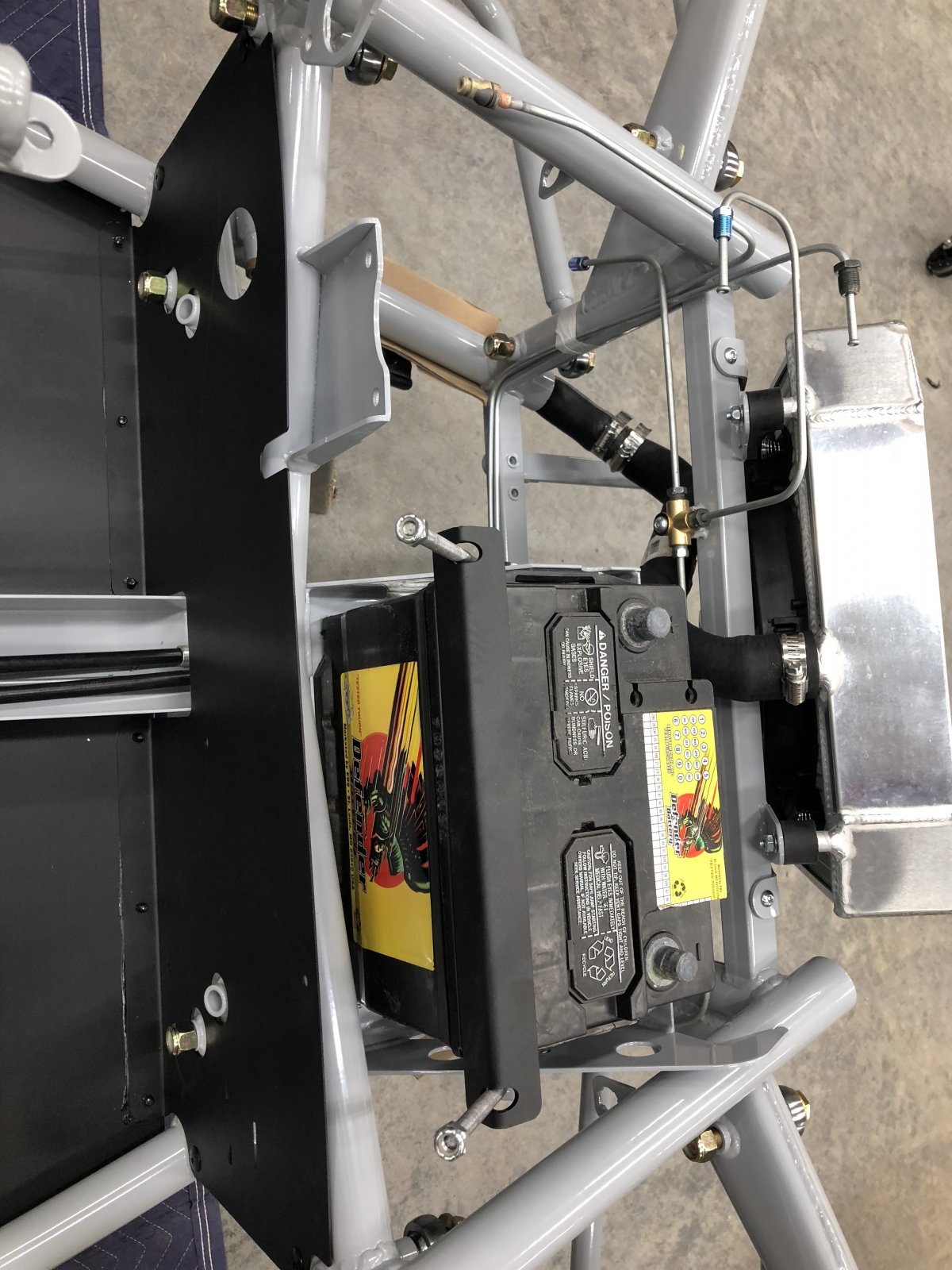

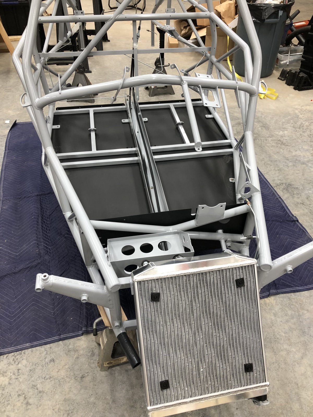

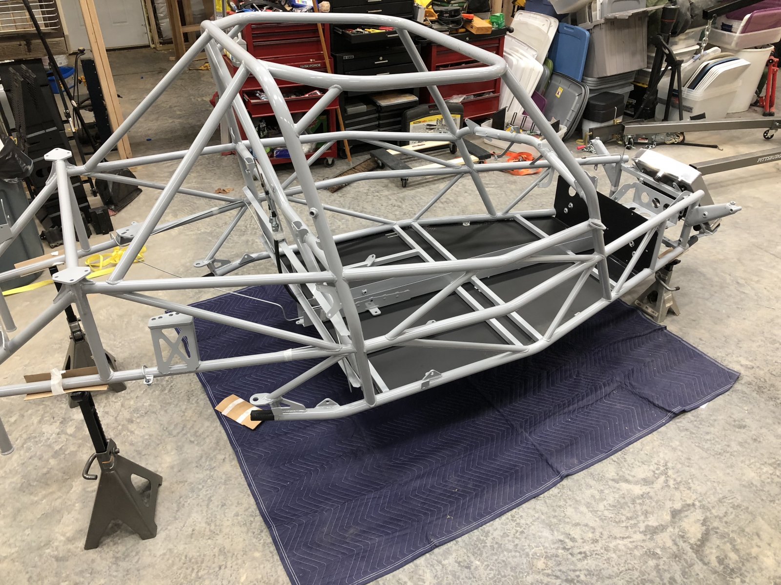

Got a few bits done tonight. I have an appointment with a local shop to get the AC evac'ed on Friday morning so I'm trying to do some stuff in the mean time.
Entry Hours: 3
Total Hours: 3 (I'm restarting my total timer since I had to change donors)
Completed Activities:
Floor plan and front bulkhead installed
Front uprights assembled
Control arms prepped
Planned Activities:
Install brake tees and lines
Finish radiator hose connections
Install fuel tank
fullsizeoutput_e17.jpeg SIdh4JMhS9GzAoiDAGySzg.jpg nyKC9LWASEWfygJJ4OdCow.jpg I4q8OCA4QWSyX++jxcJdqg.jpg fullsizeoutput_e14.jpeg

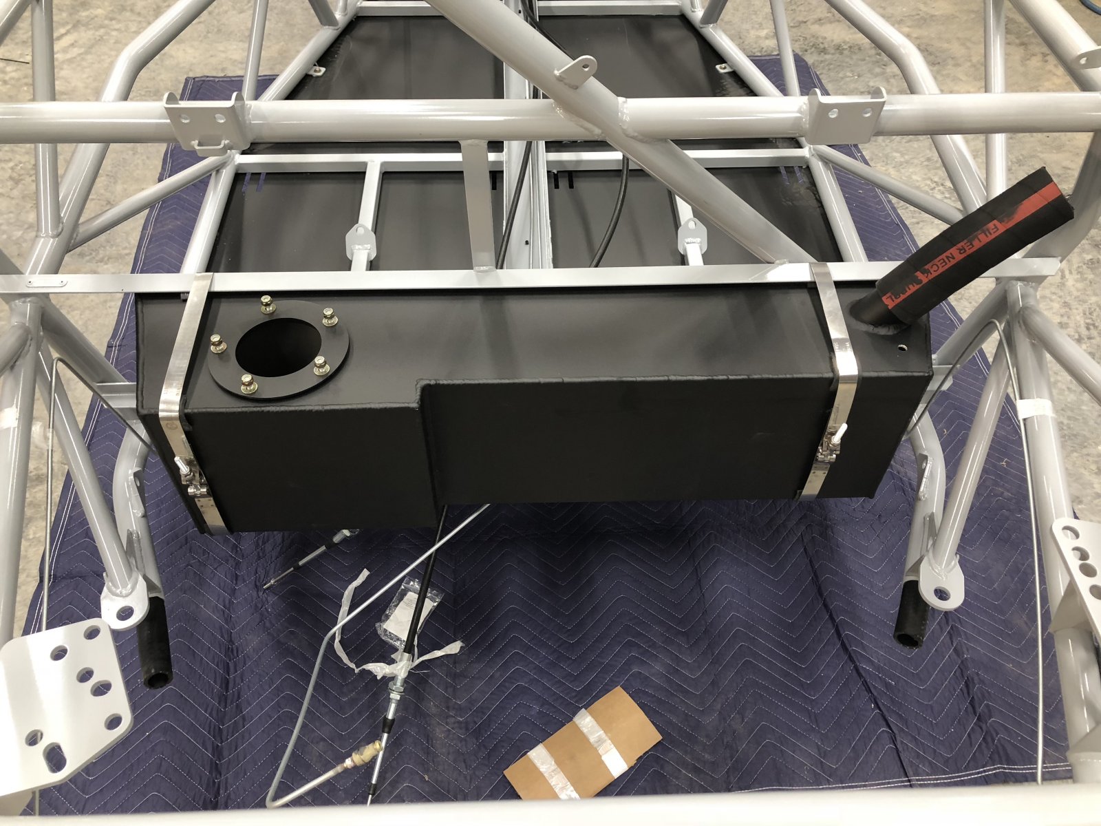

Entry Hours: 2.5
Total Hours: 5.5
Install fuel tank

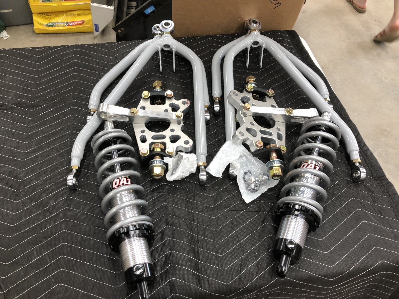

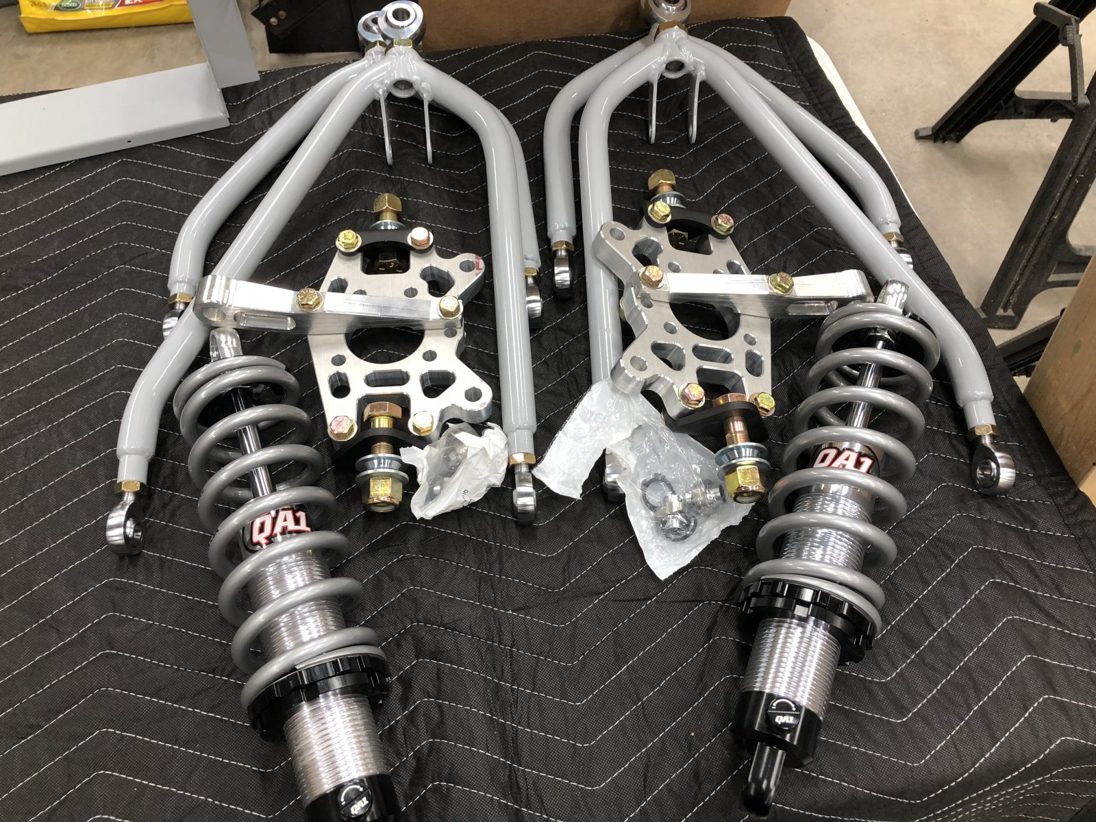

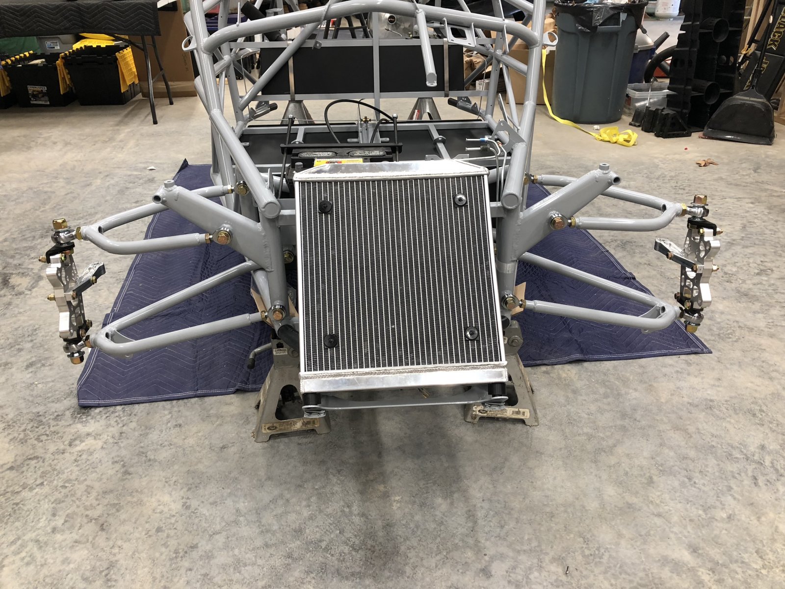

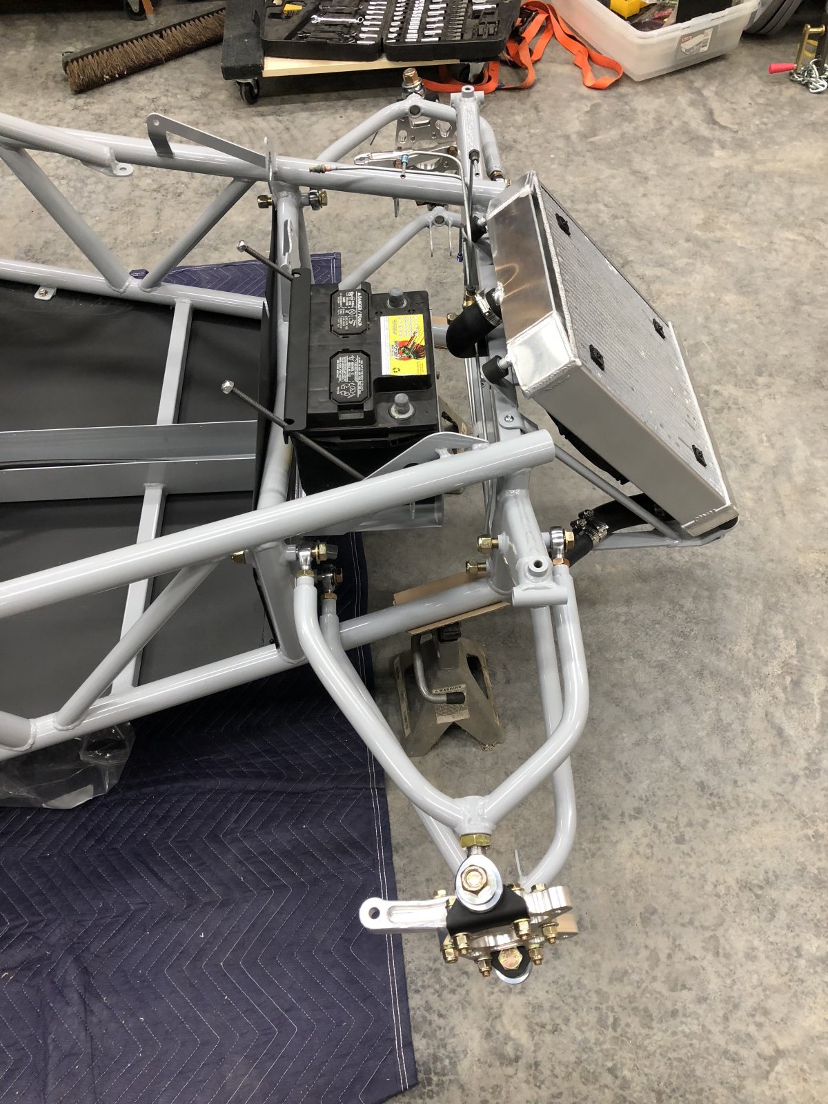

mocked up the front suspension. I'm glad I decided to do this, I realized I had assembled the uprights backwards
Planned Activities:
Degrease/pressure wash donor engine
ttJq9QyJQNCLQ8rikZ4Qkw.jpg Aak85I4SSA+vYZFGoEJHlw.jpg 8iAfVd1nSmOYYoD+Sl5IgA.jpg T88CG2A2QEux7c943yUWQg.jpg
I did the same thing when installing my front brake lines. I pointed them down too. They actually point to the rear of the car.
Easy to fix. Just something that stuck out. Looks good.

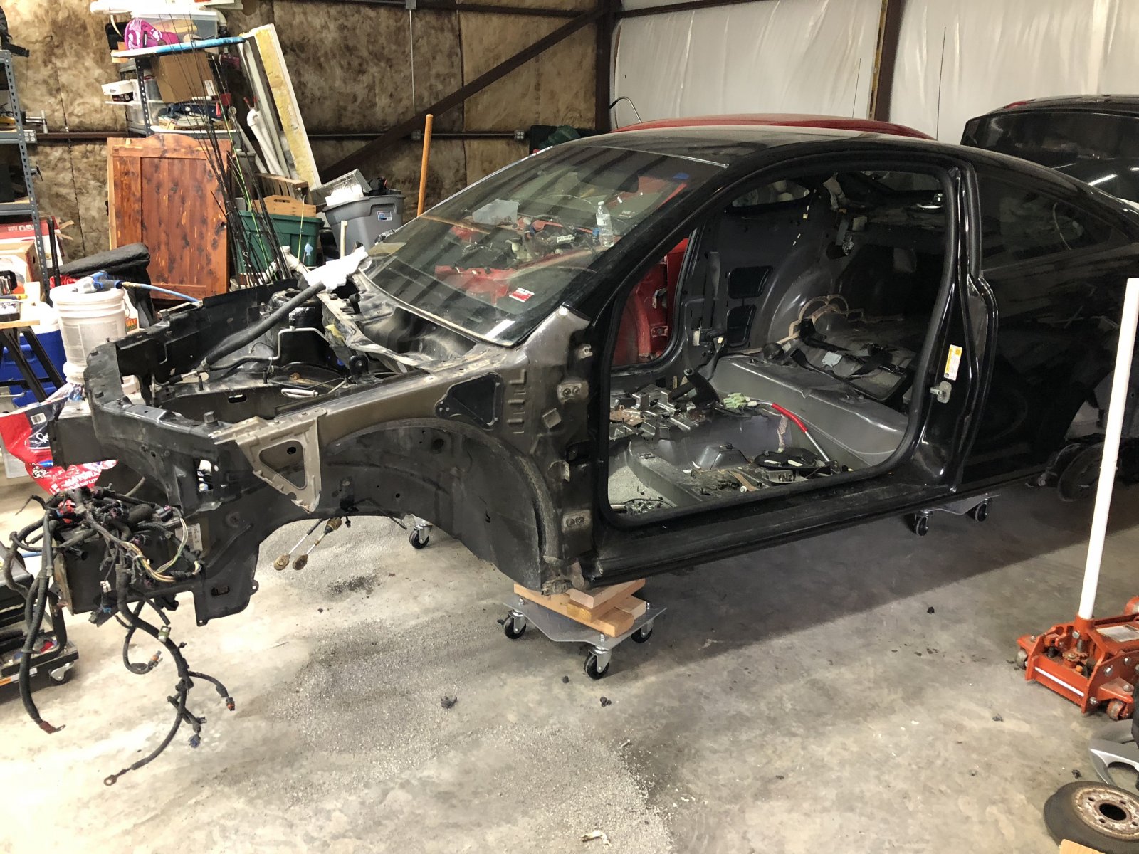

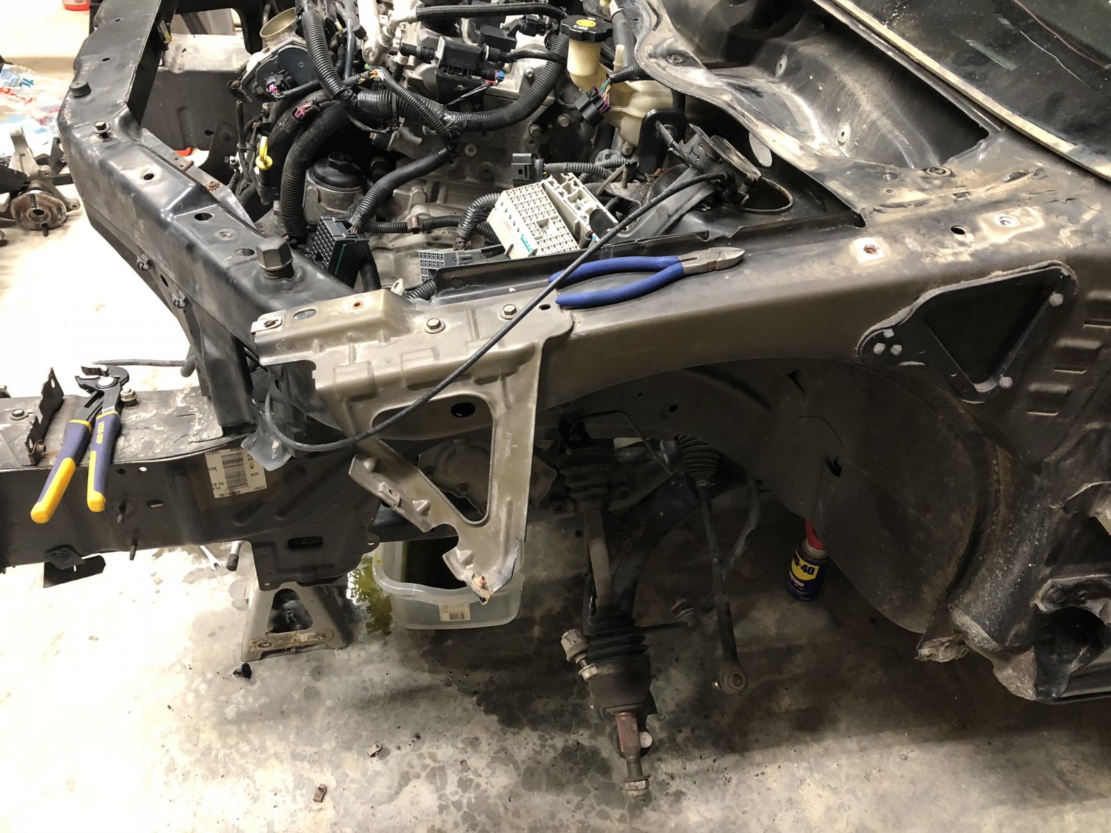

Entry Hours: 5
Total Hours: 10.5
Got AC evac'ed at local shop

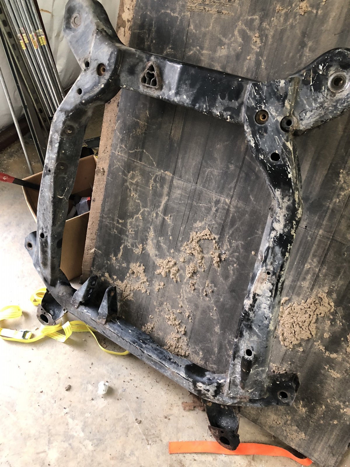

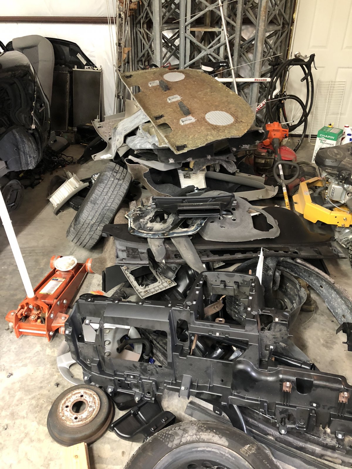

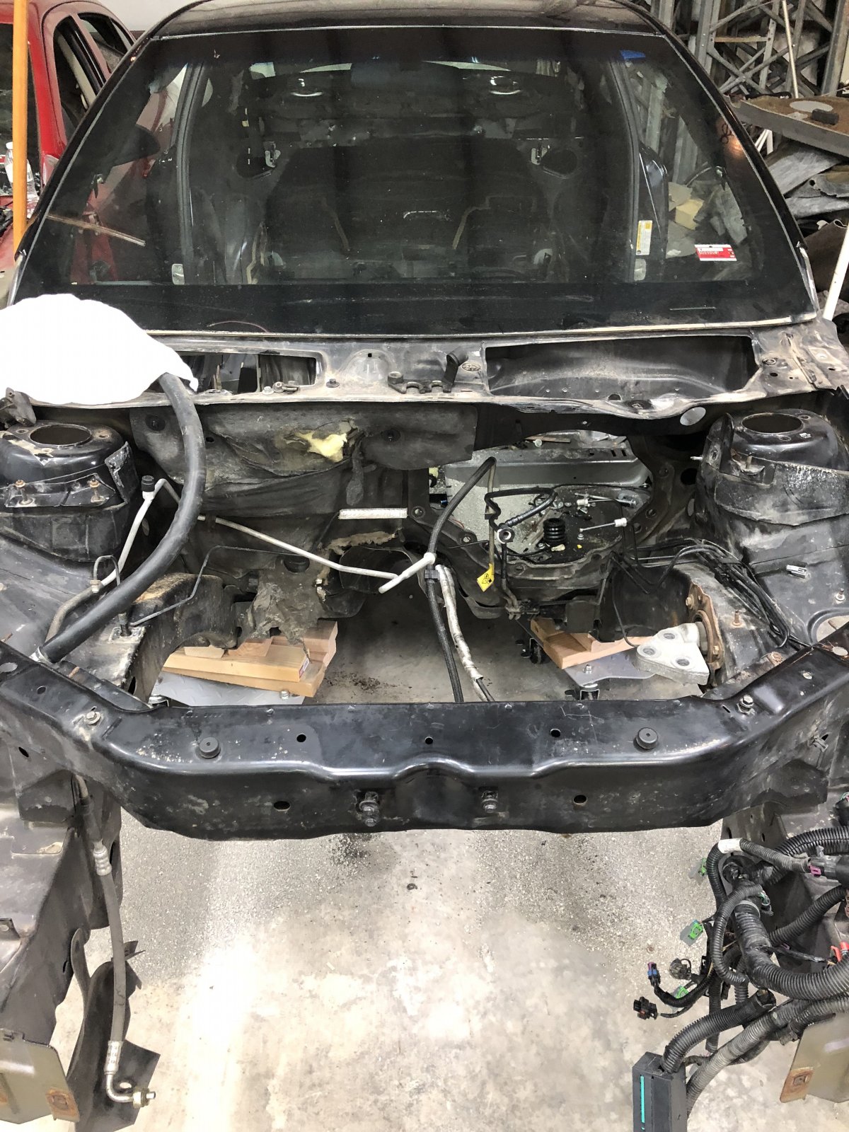

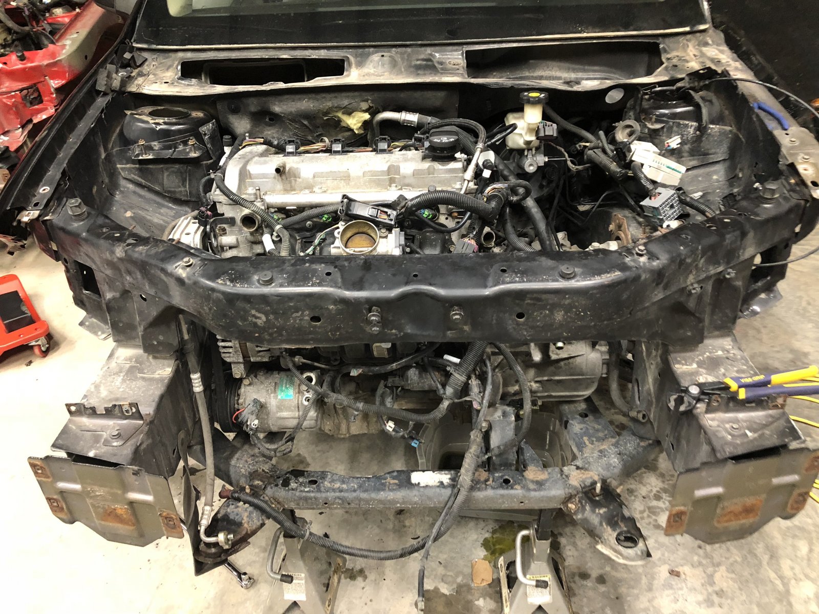

Began stripping the donor. We got all the frontend stuff off, radiator, AC, computer, etc. We would have had the engine out but the bolts for the subframe are being a *****. We broke a couple sockets, a ratchet, and a couple adapters trying to get them loose.
Planned Activities:
I'm going to get some different impact sockets tomorrow morning and see if we can get the subframe bolts out.
Once the engine is out, strip the dash and interior
XcIAeIkDRJWNCES0JmN1AA.jpg YIvh%rtPSh2uOZkEq+wstQ.jpg yAhMs3b4R4G2qPksQF2Y0g.jpg

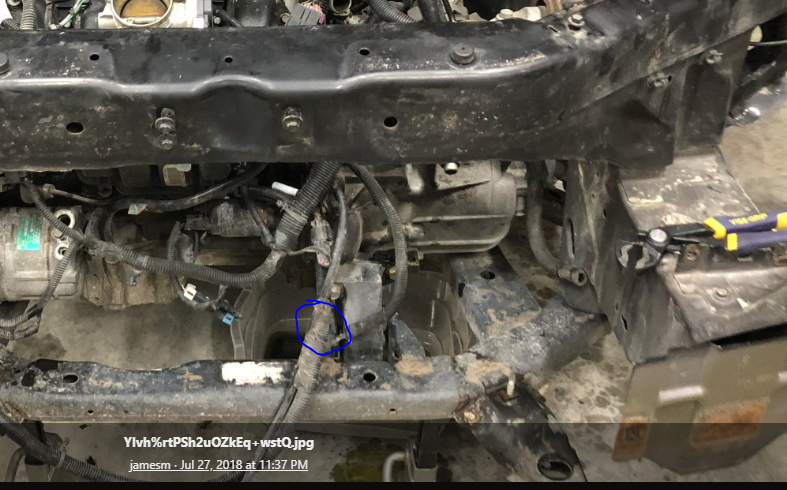

Don't do like I did, try and take off the welded nut on the subframe when I should have been trying to take off the bolt. The mount in the front is the one I'm talking about. You can also just take off the engine mount and leave it attached to the subframe for now. But you are probably having issues with other larger bolts.
jennam
Then one that’s giving us trouble is the large bolts that goes through the rear of the control arm and up into the frame.

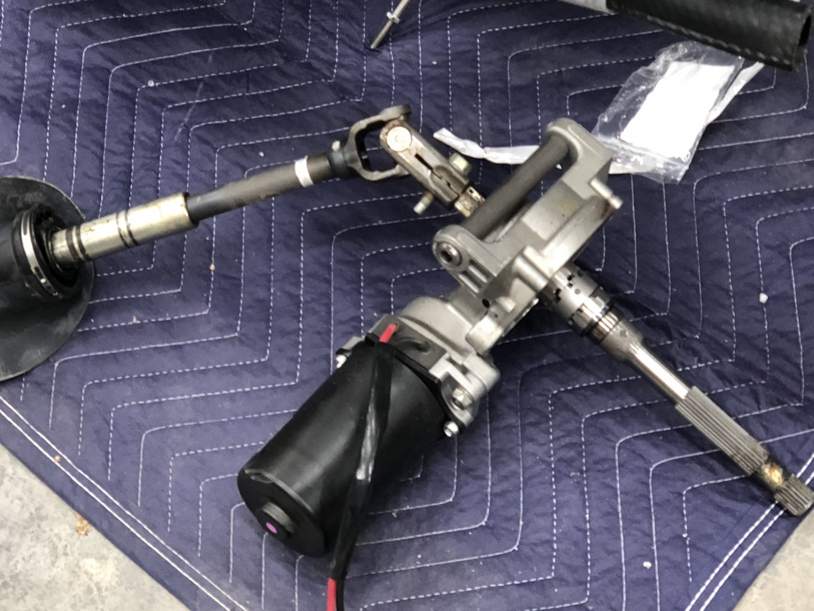

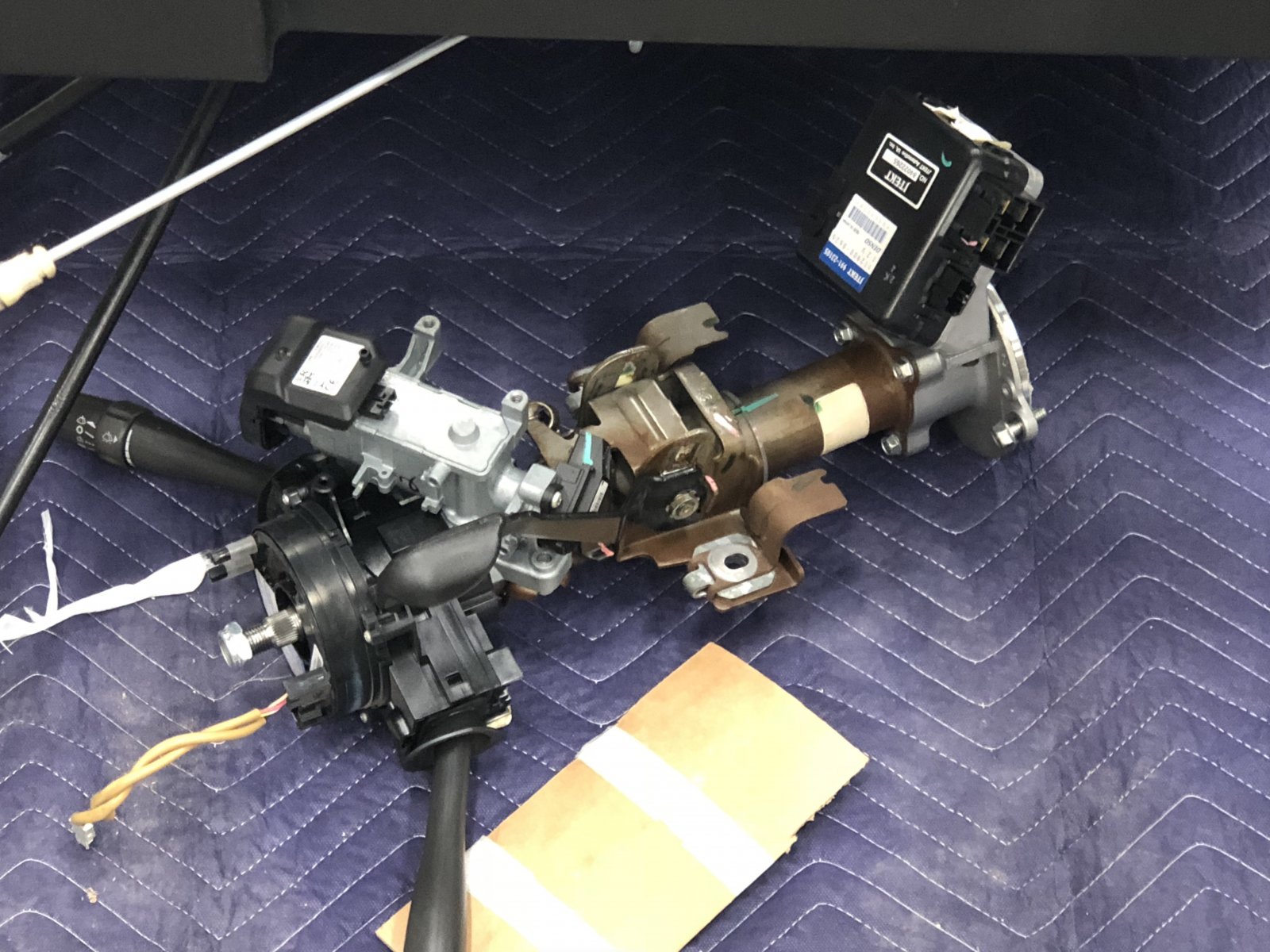

Entry Hours: 6
Total Hours: 16.5

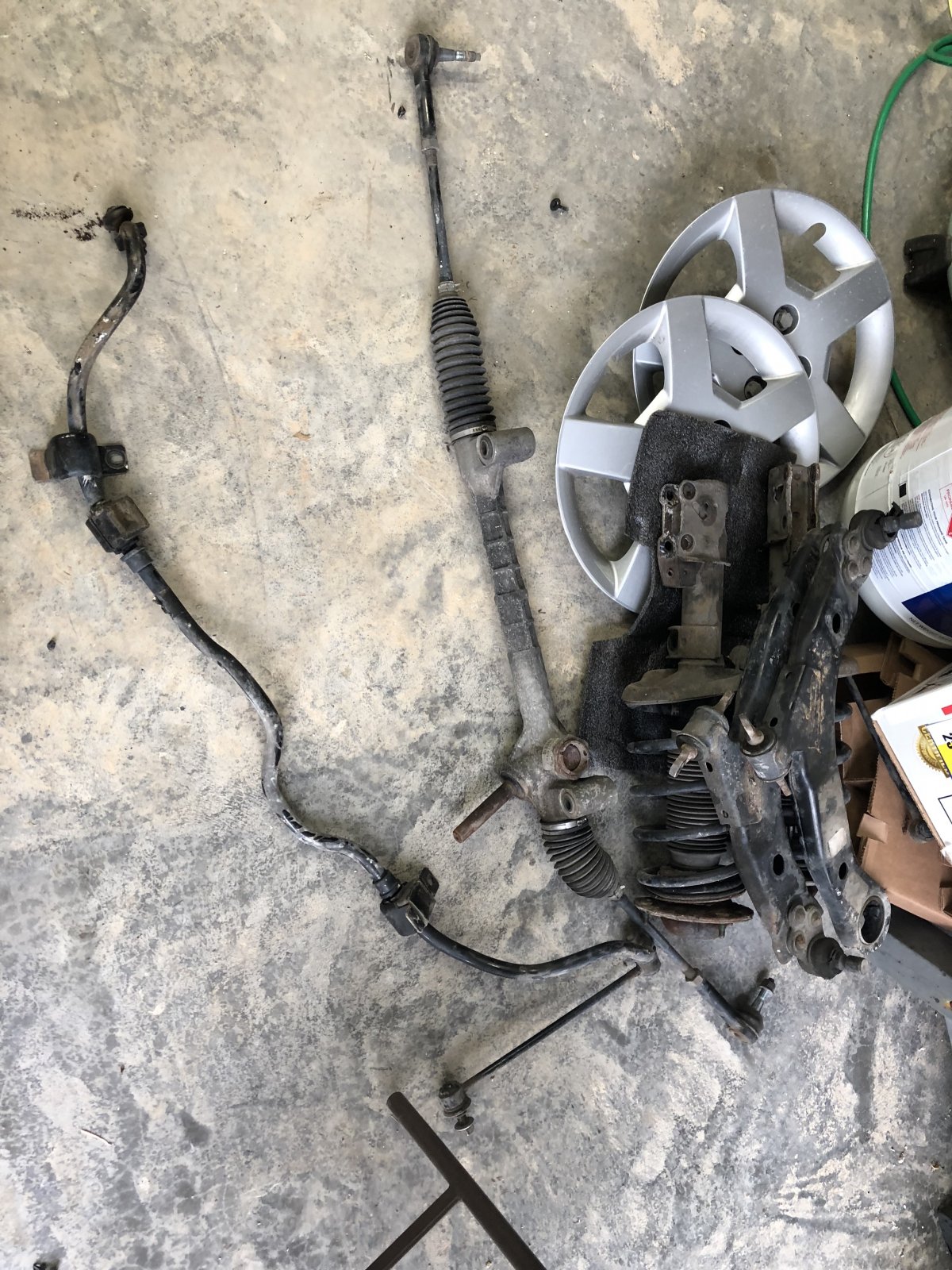

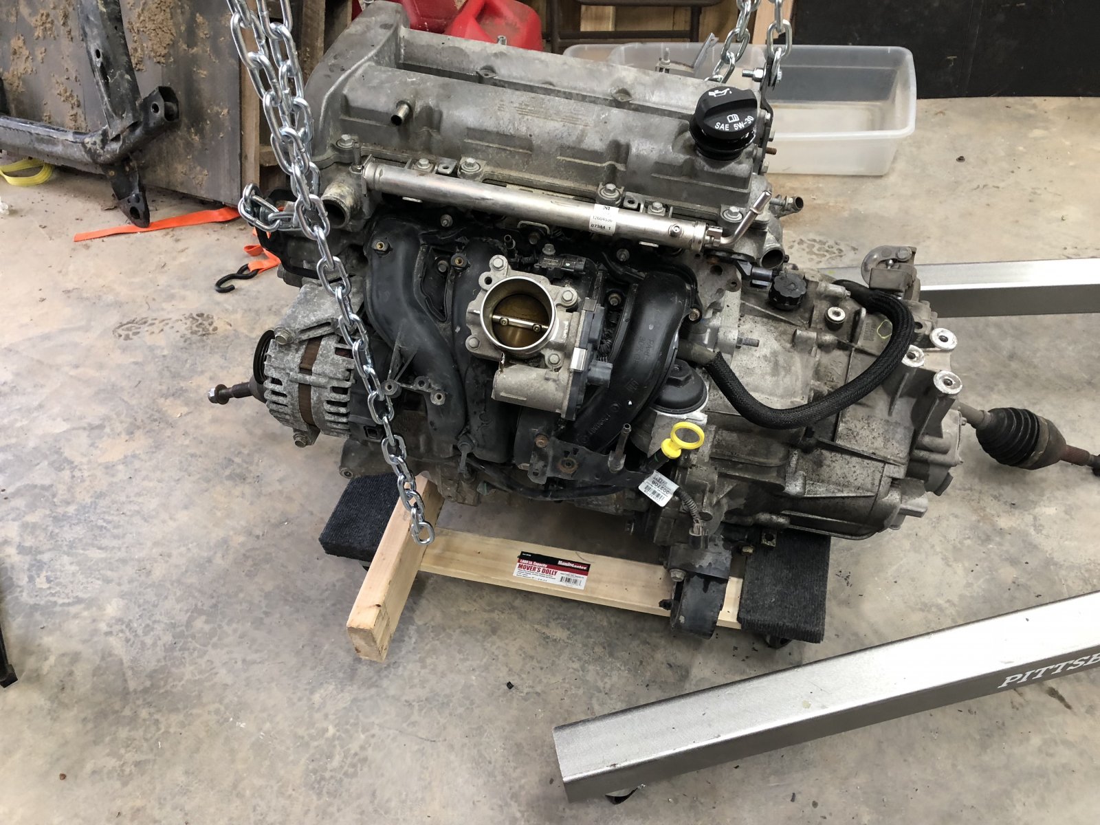

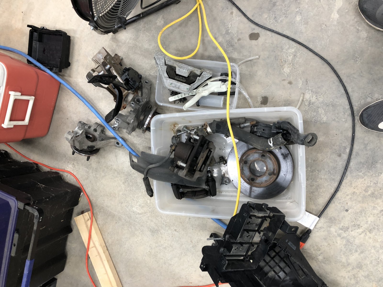

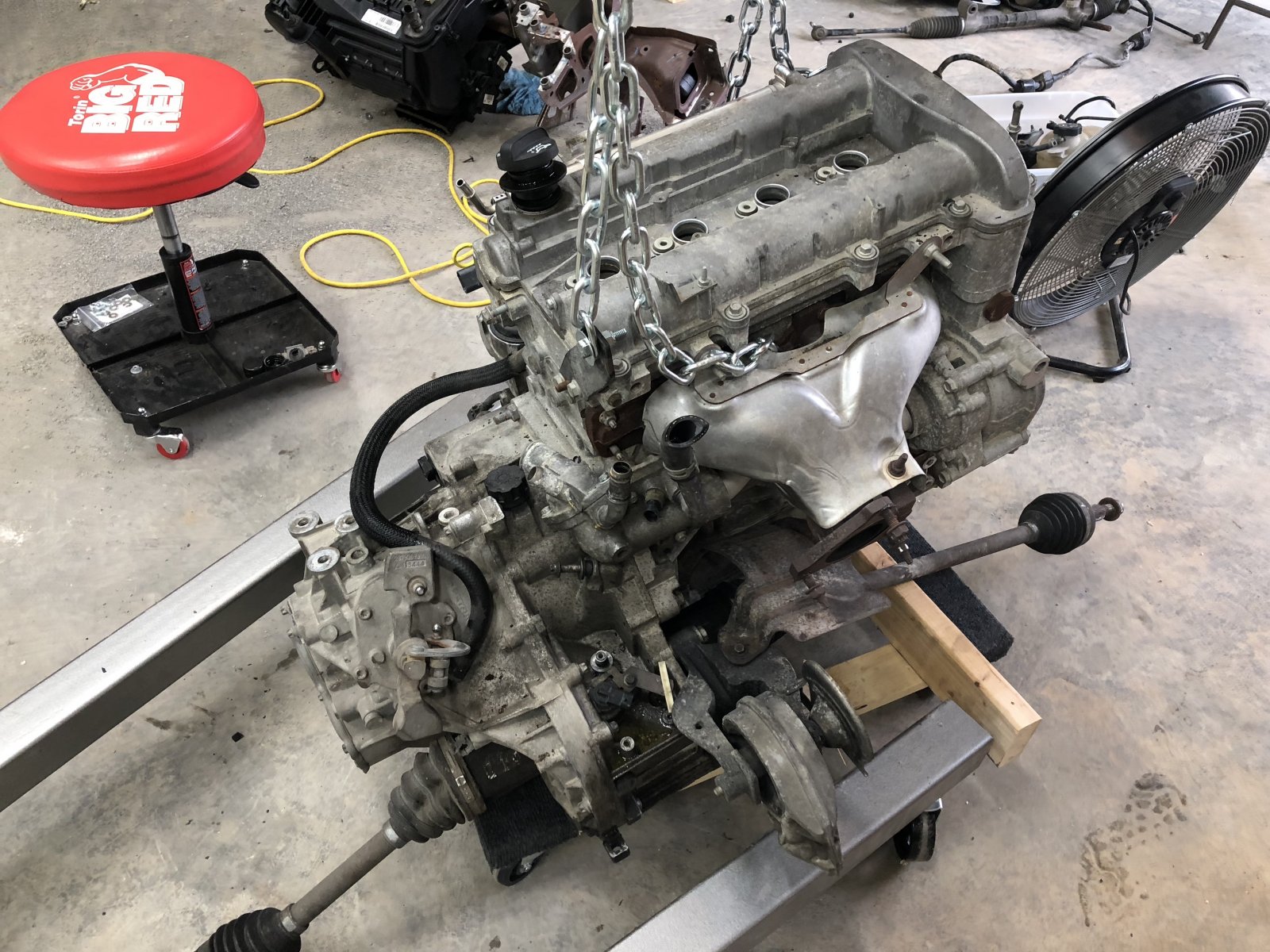

Finished stripping donor
Removed wiring harness from engine
Planned Activities:
Clean/prep/paint donor parts
uIM053GLS+SXTva6ZohIcg.jpg Mcuye5ETTEyavOsilf91rw.jpg %qvH+40LQfWNwOPpKb7o7w.jpg Ty2qRCjxScqO3cHbTTJyug.jpg CfGutU1iS0iMDO74SGIIxQ.jpg 76nMZWW5Qx6vOYg6ecVXIg.jpg cerin2i+Rjqnt2iYcw94JQ.jpg YZHzi7N6TmC6G3HnQrq1aQ.jpg A3FgKySwSFWTpPUwitm4aA.jpg 6SX6AK25Rq6cGb6lvpZ5Kw.jpg

I'm going to have to buy a few more replacement parts than I was expecting. We ended up having to cut one of the rear frame bolts with a saw because the bolt has rusted to the bushing sleeve.
