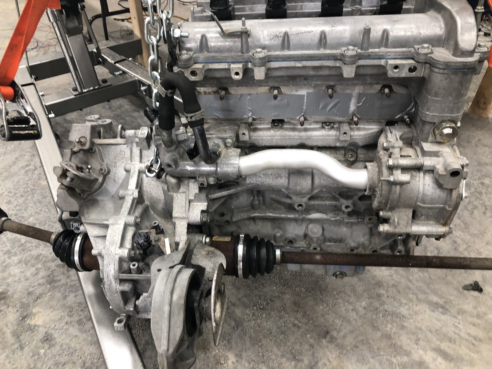

Finished video 12, 13, and most of 14
Replaced clutch kit
Replaced timing set
degreased and pressure washed engine and transmission

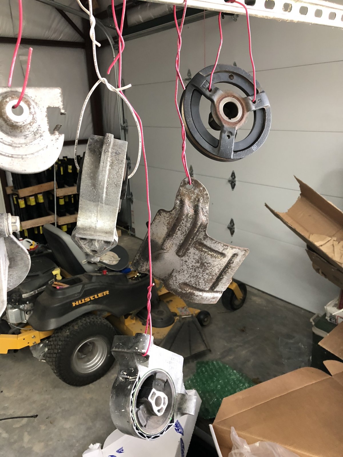

Drb0n6M9QSe2yrlPVuf6Ug.jpg HoqatasRS1uSkIO%JJRqog.jpg 8NORDDEnQEuI1EBY9AqDkA.jpg

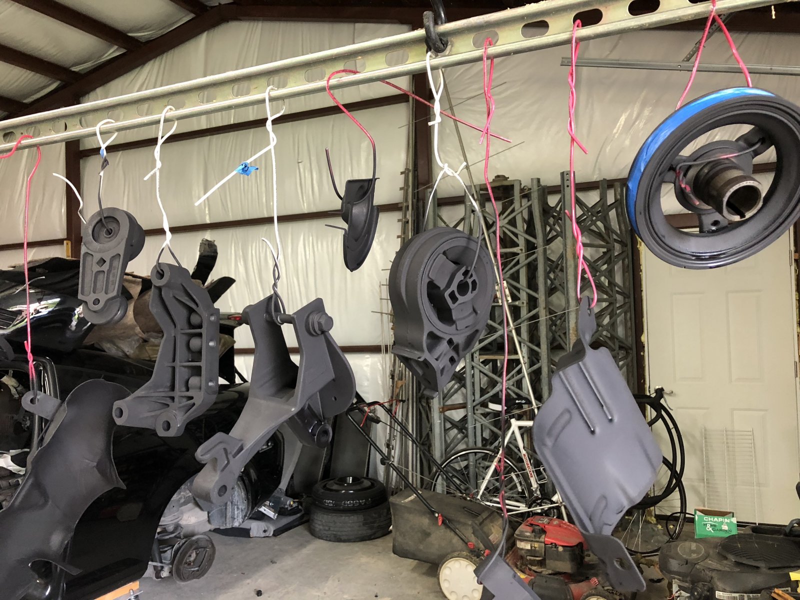

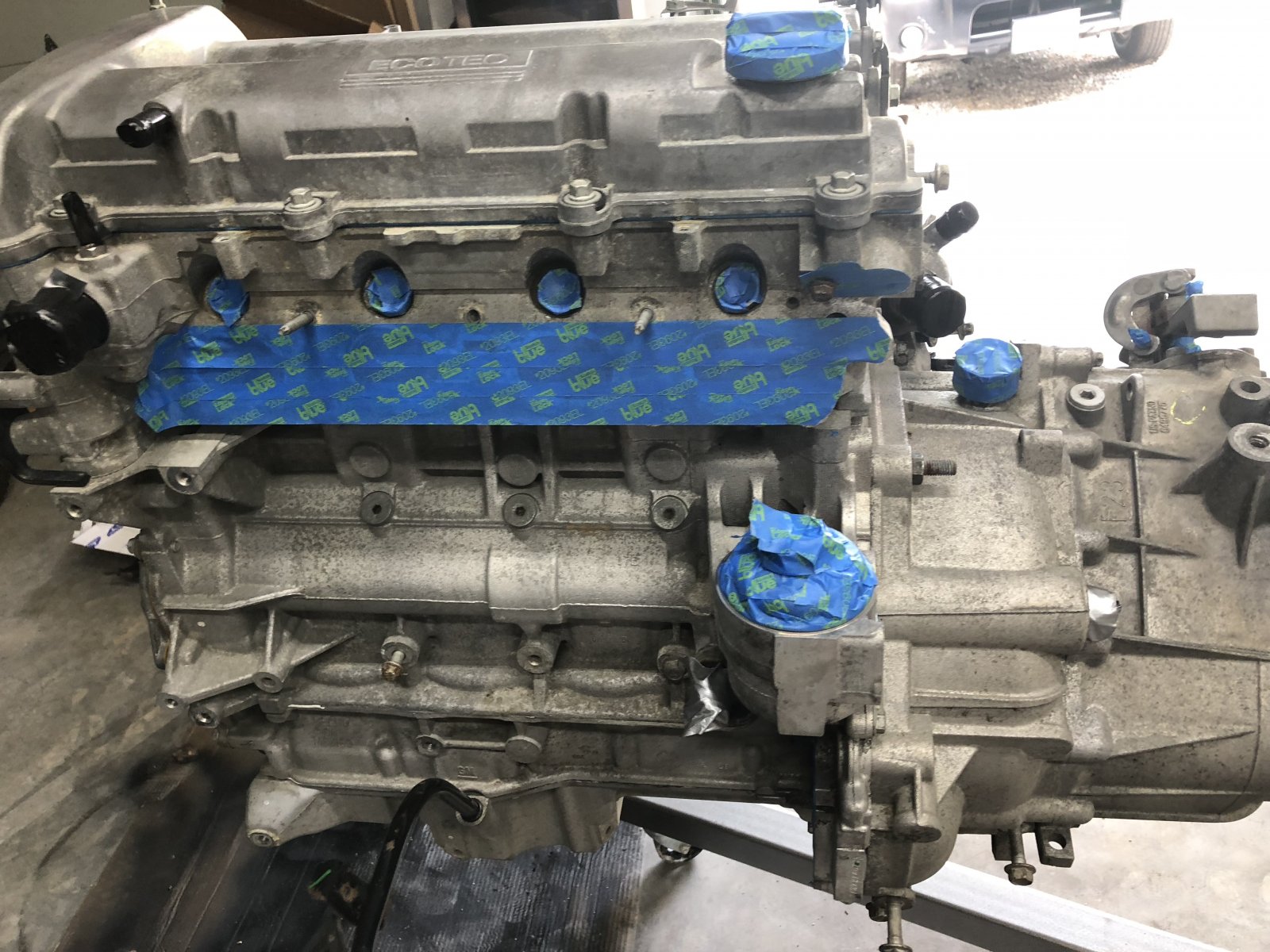

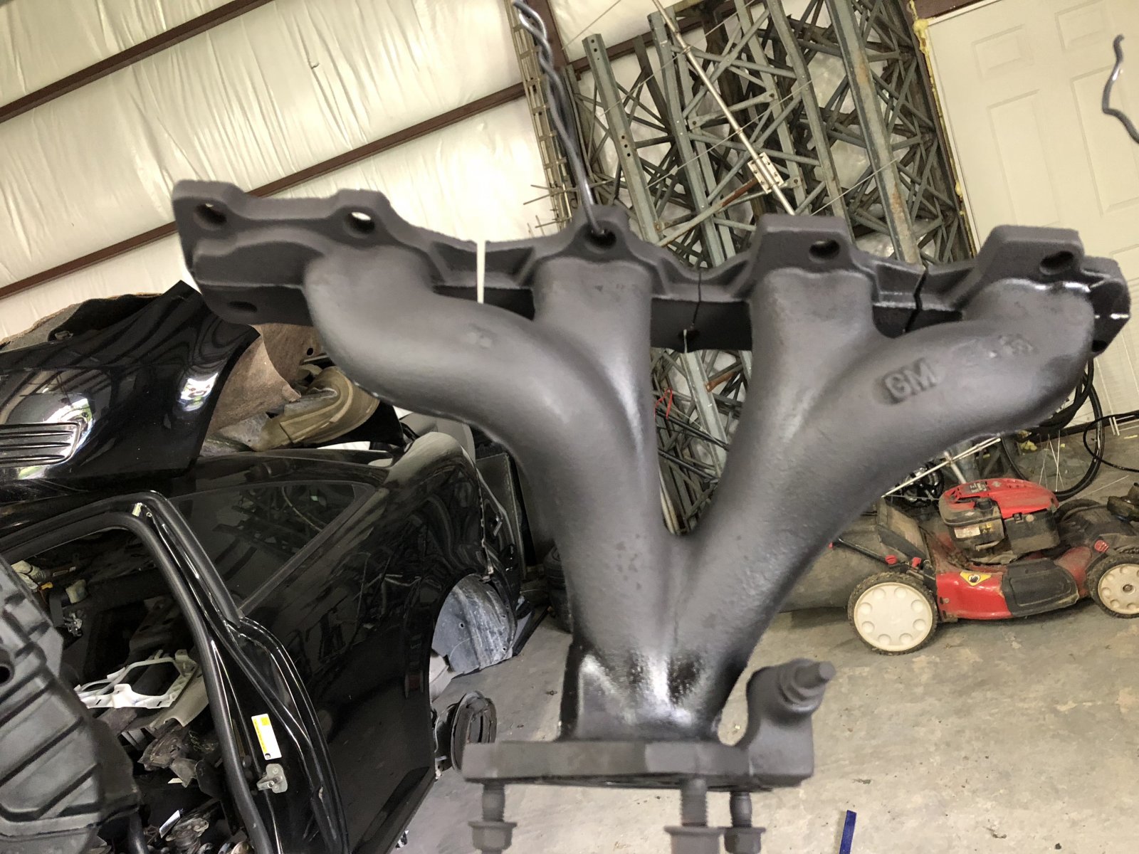

Completed Activities:

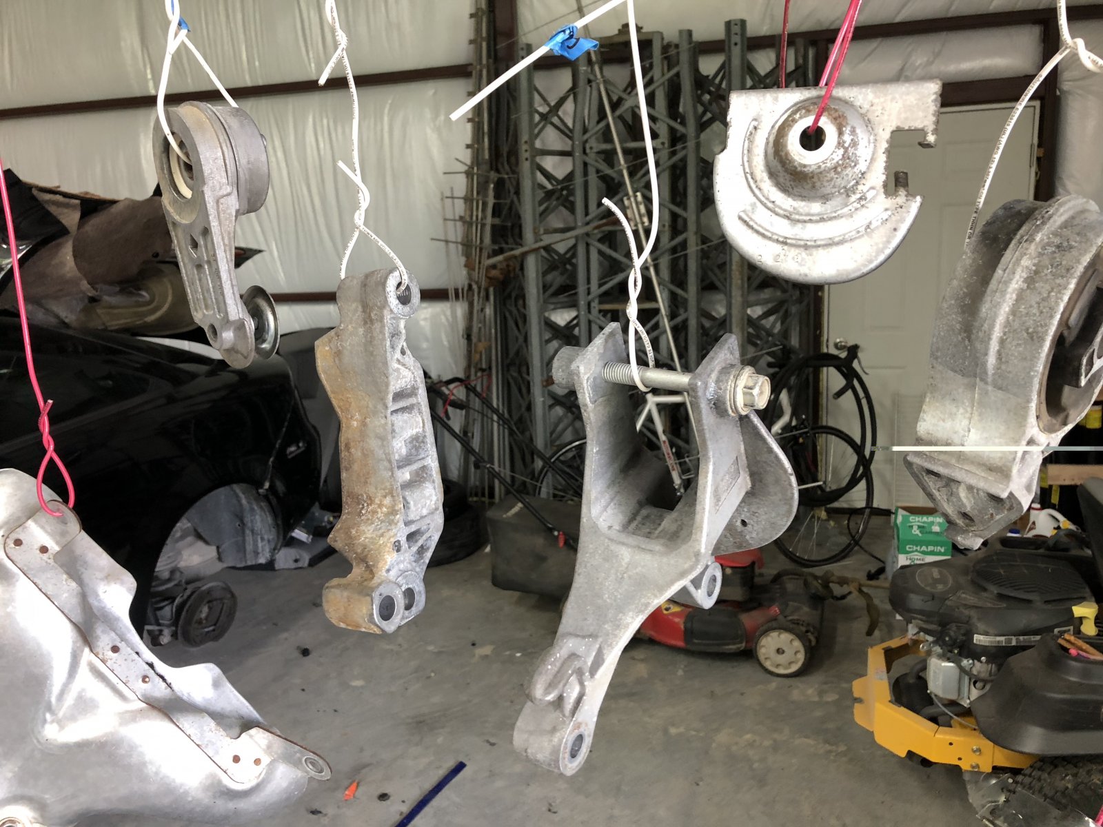

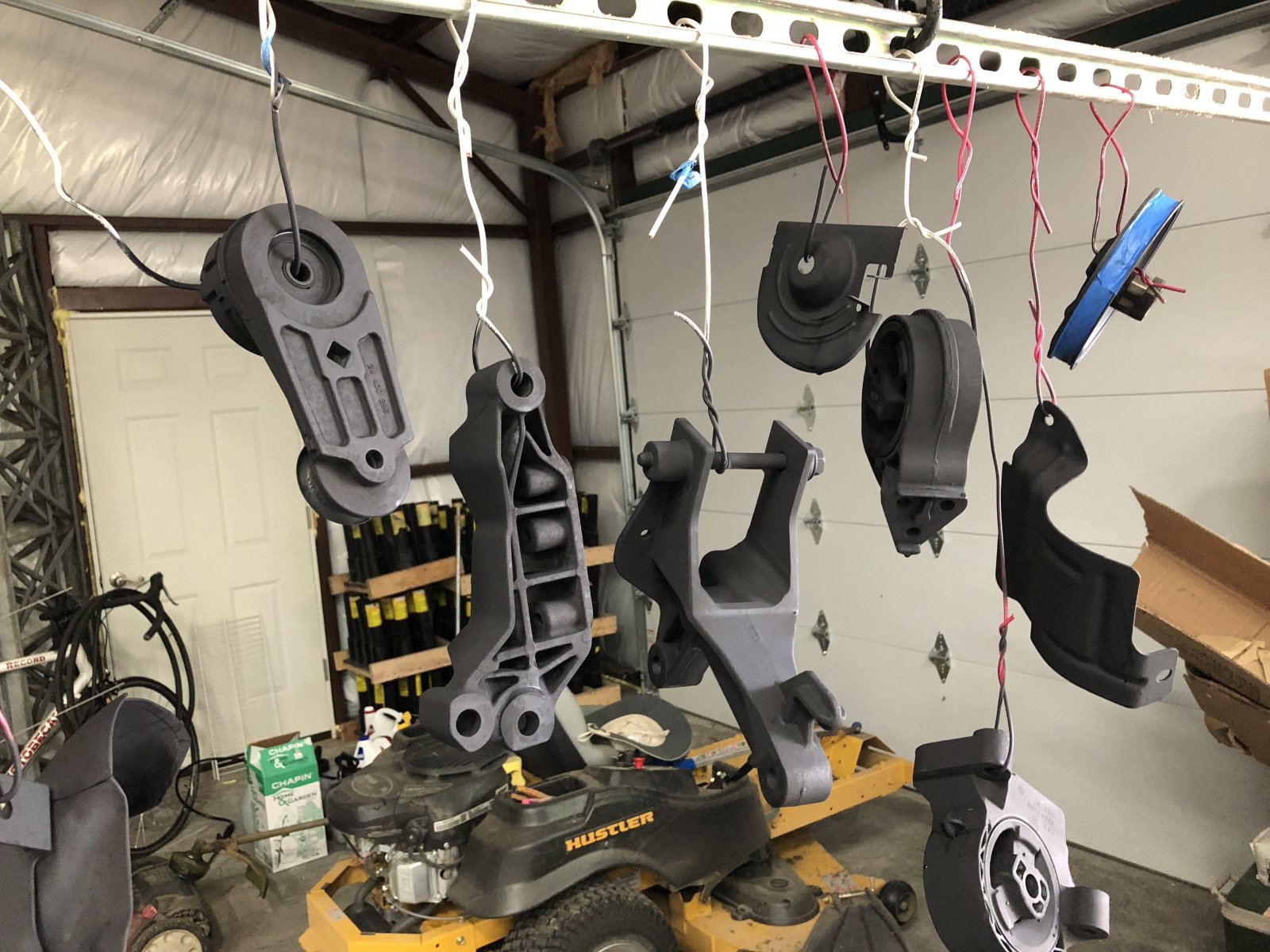

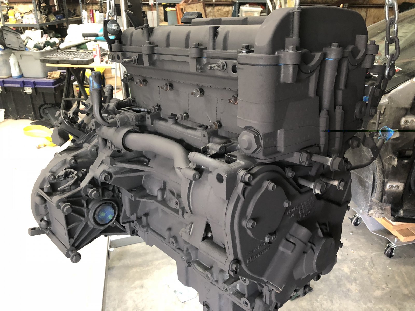

Painted engine and various parts / brackets / mounts / axles

ZjKoPOneTeiPqpCBcAfFZQ.jpg 2zyh1OSUSJGuzHAYxYM4iQ.jpg lkE1O8BgQyW+aCiunAD9NA.jpg UvyfgRgRQn+1+Ki4rz2yzQ.jpg GOsKf5lTTjSX0ijWrPqThw.jpg A1QkNWjwQxGvpI76Fp3zuQ.jpg qpg5uCexSb2M+PvLhEHsqQ.jpg 8hHBNBaWQGOC389epr+Y3g.jpg p6%GLEhGSM2XuU3hChdTEg.jpg JBuf9x8yS8mDB%rVDT+LYA.jpg

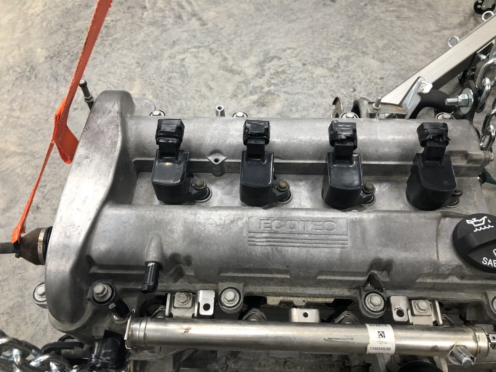

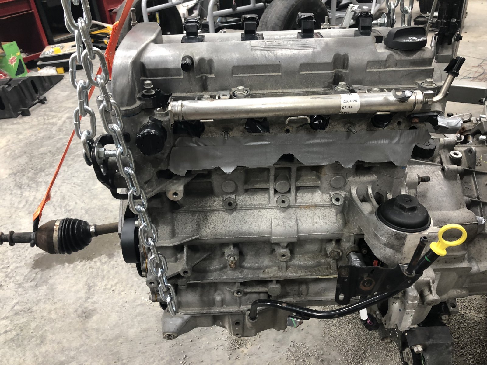

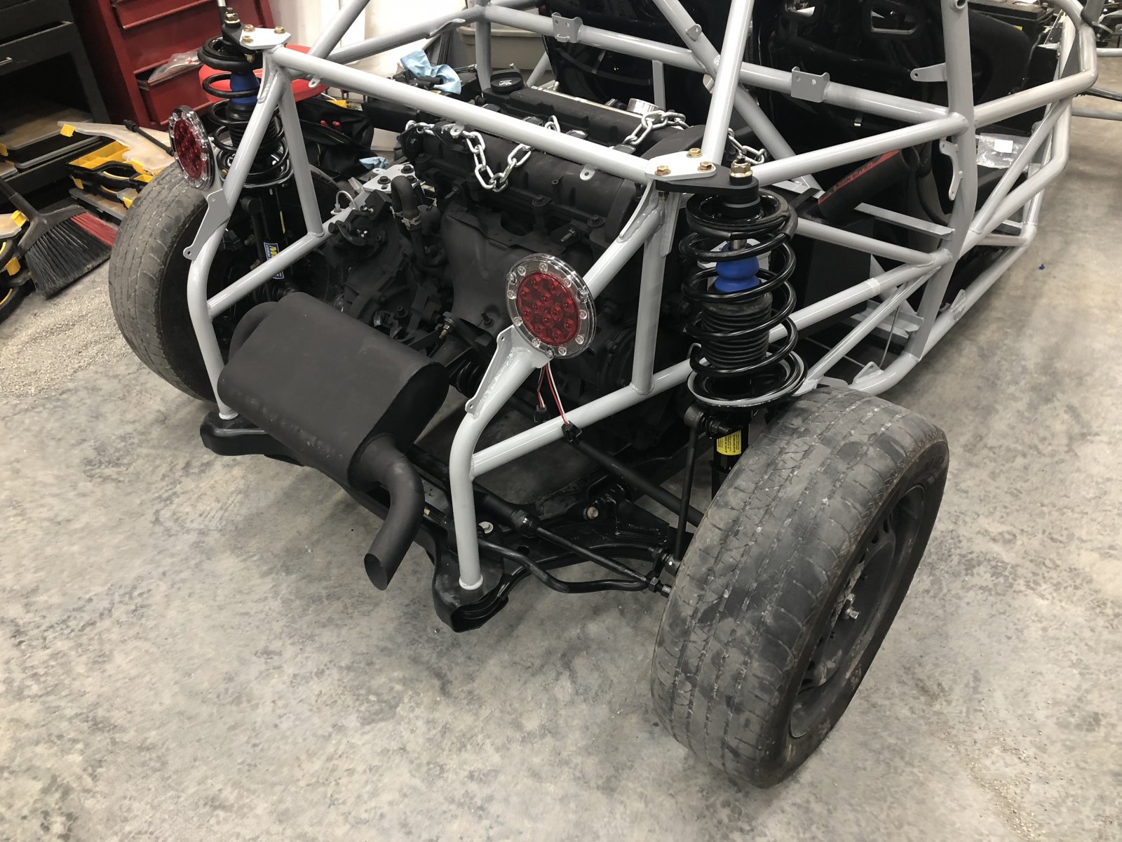

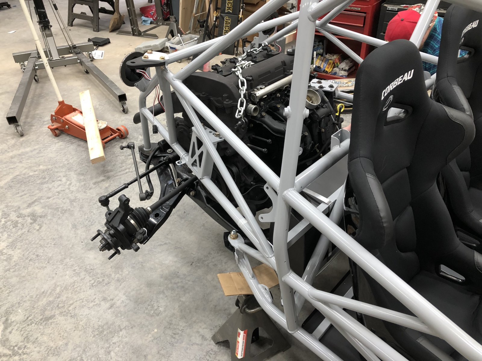

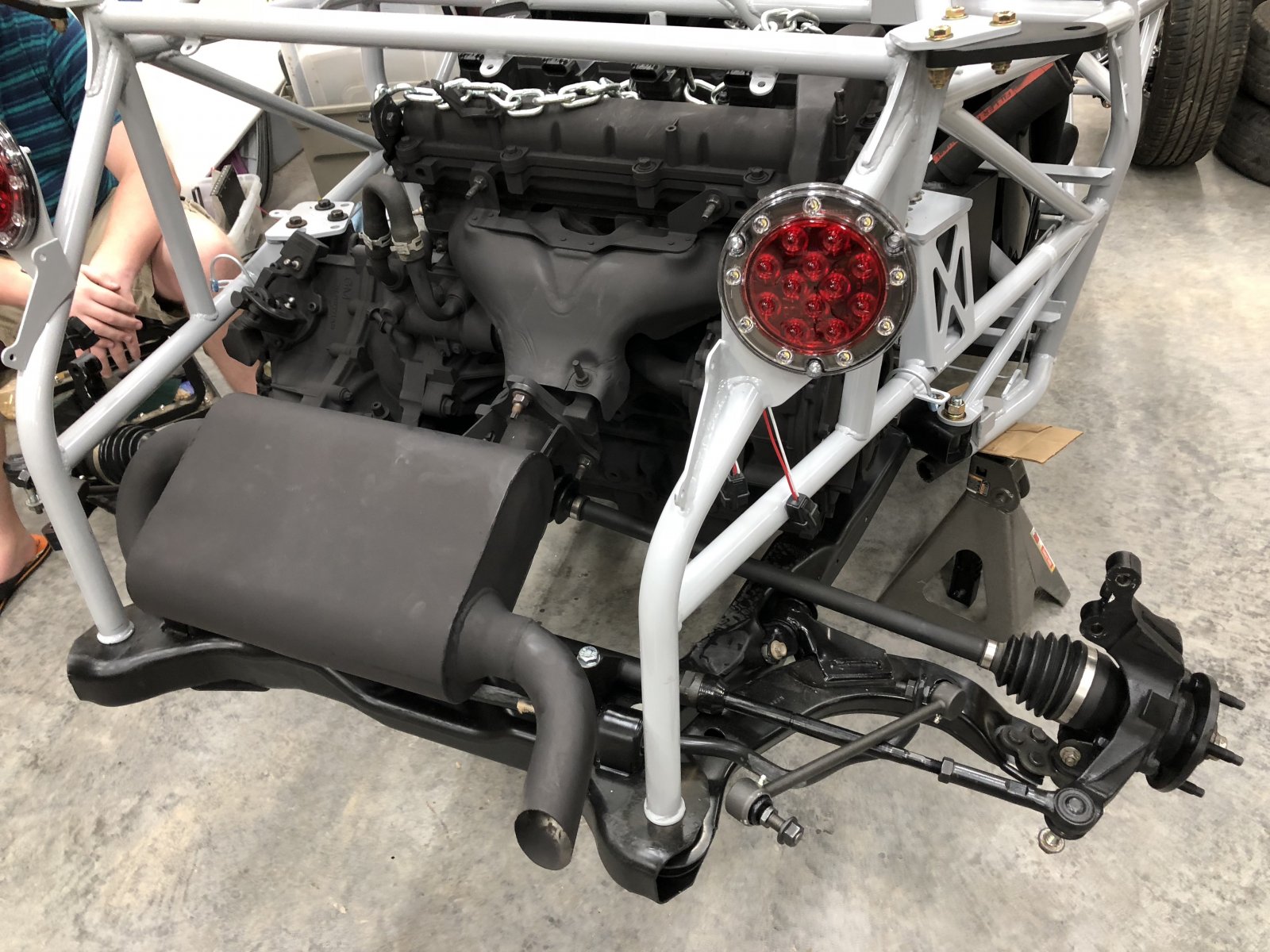

Installed engine
Reassembled rear end

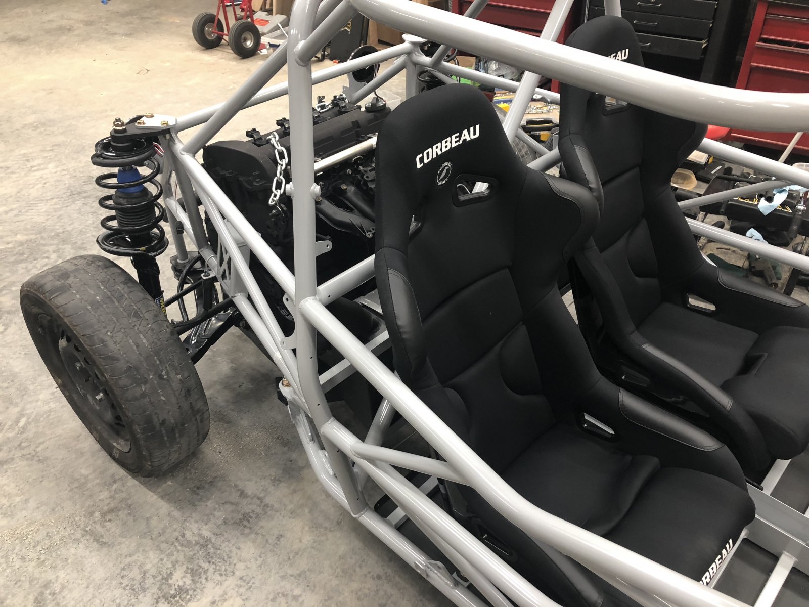

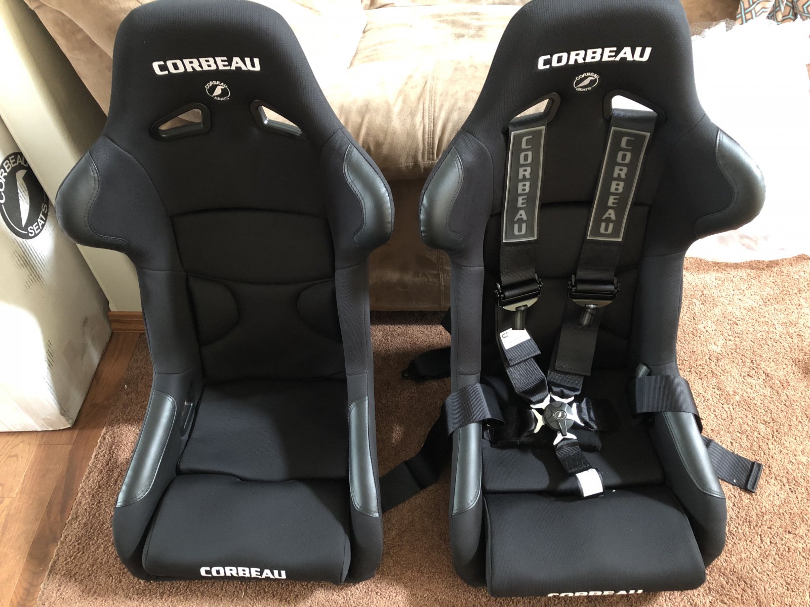

Temped in seats to test

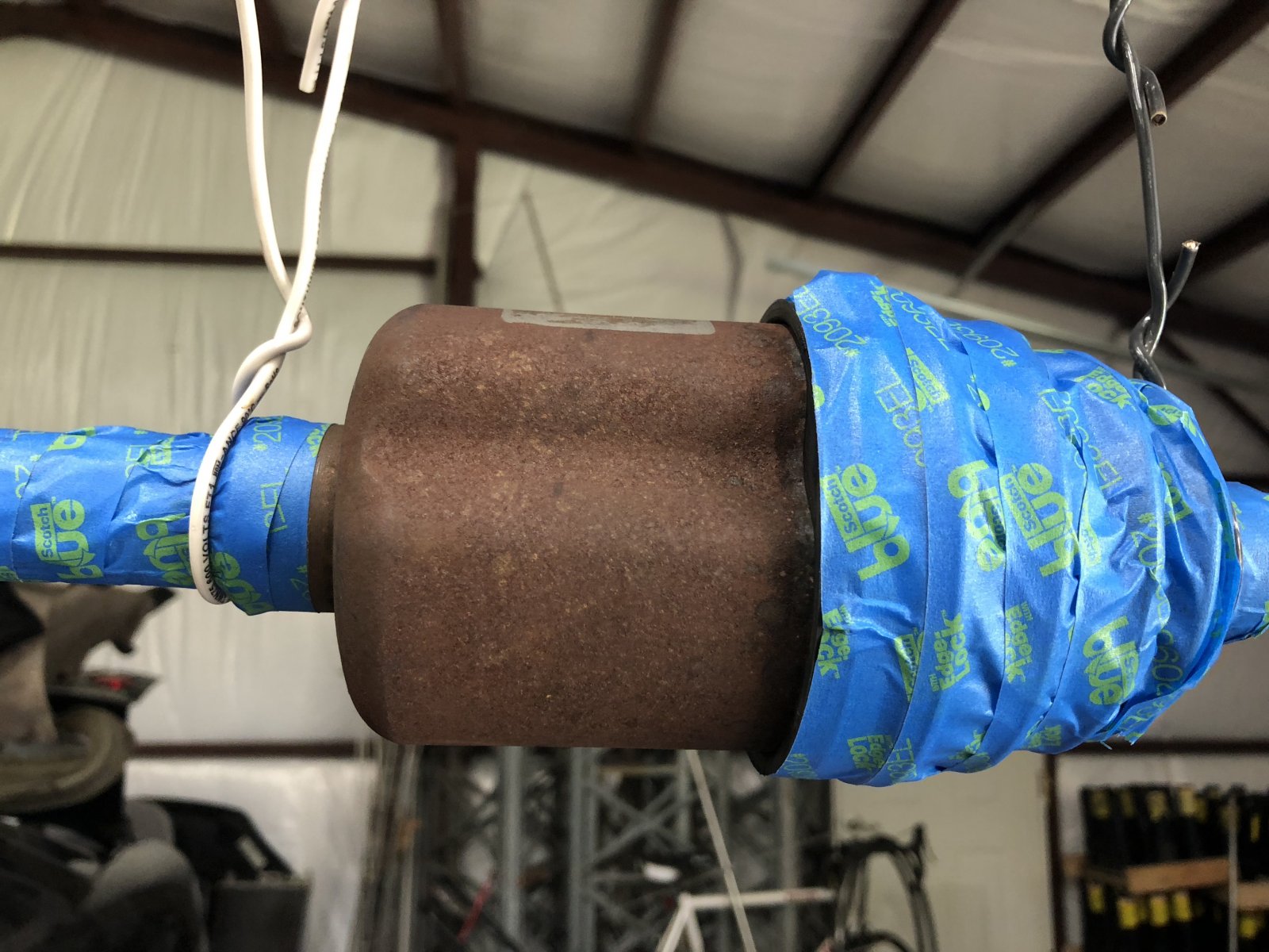

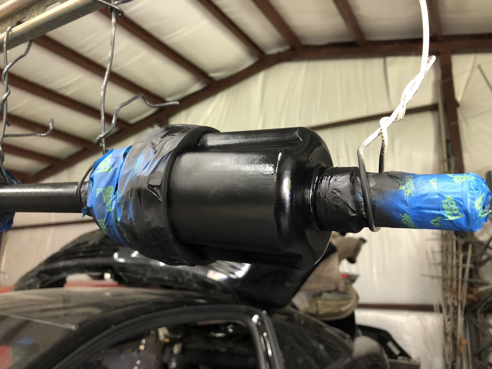

Separated steering shaft and painted

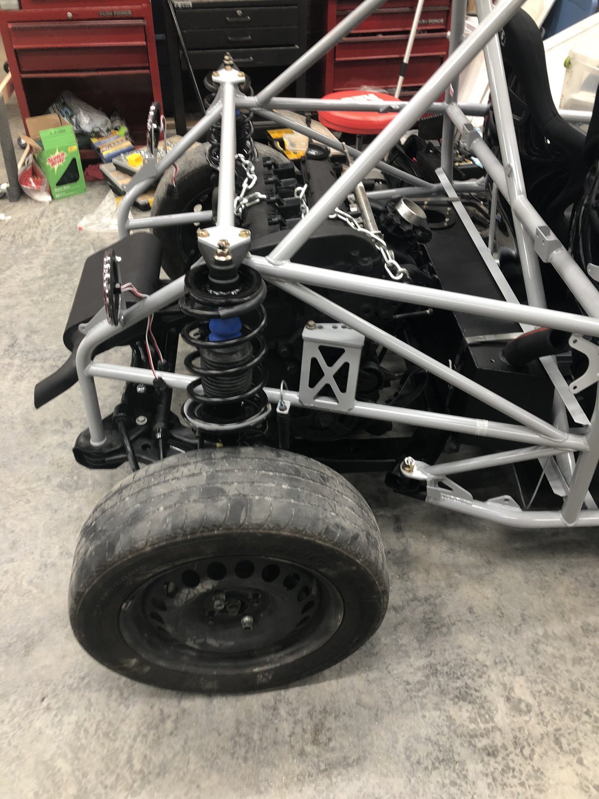

I think they are as excited as I am about finishing the car:

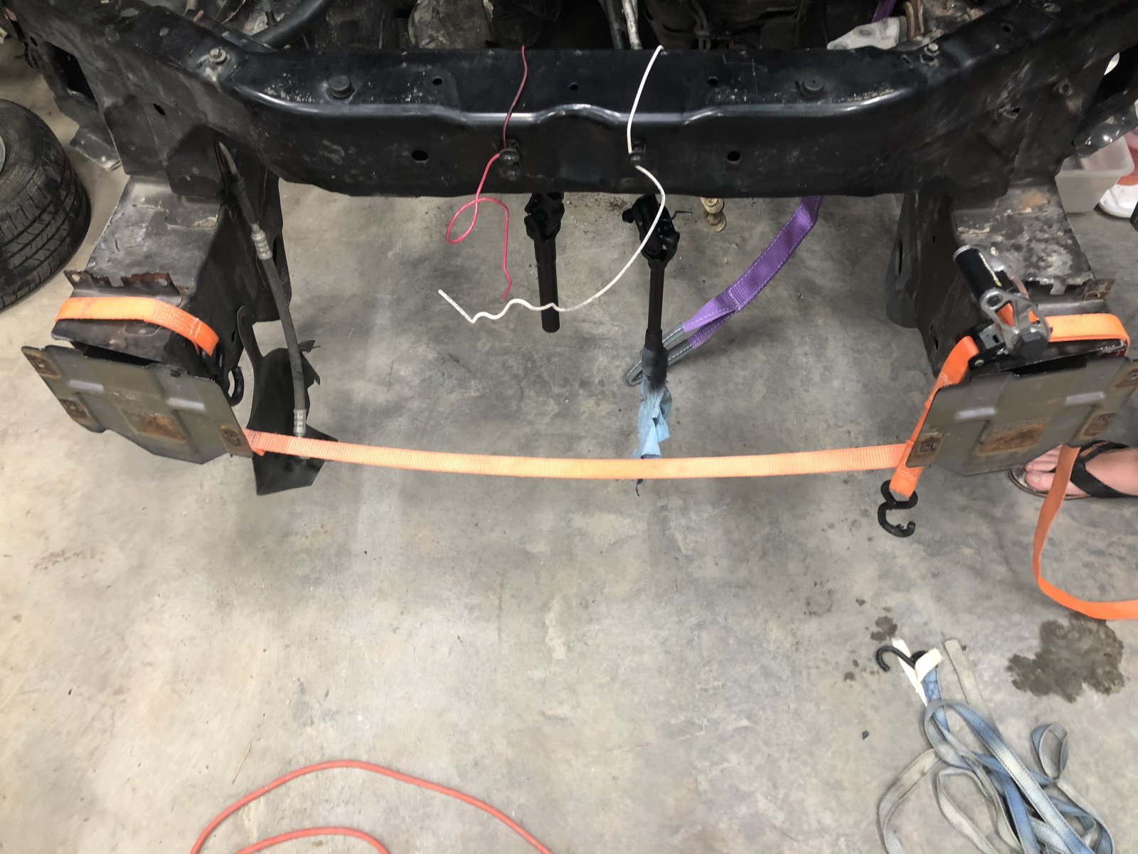

We went full on redneck on the steering shaft... Wrapped a ratchet strap around the posts on the front of the donor and used it to pull the shaft apart.
Progress pictures:

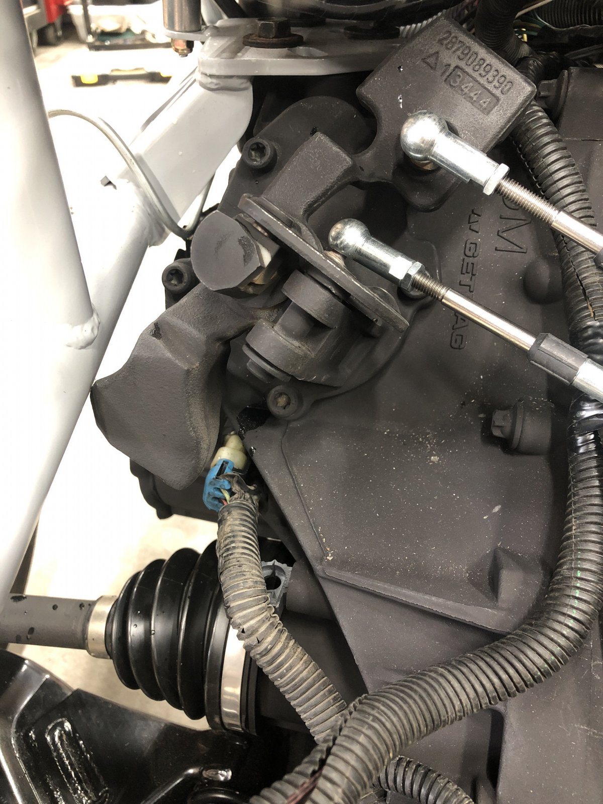

I’m trying to adjust the shifter cables and I can’t get it in first, the counterweight is hitt By the frame. Any ideas?
You will need to remove some of the counterweight.
A four-inch grinder with a cut of wheel works really well.
Trial and error.
That only happens with base manual transmission and we have only installed one of them so we are not sure how much to remove.
