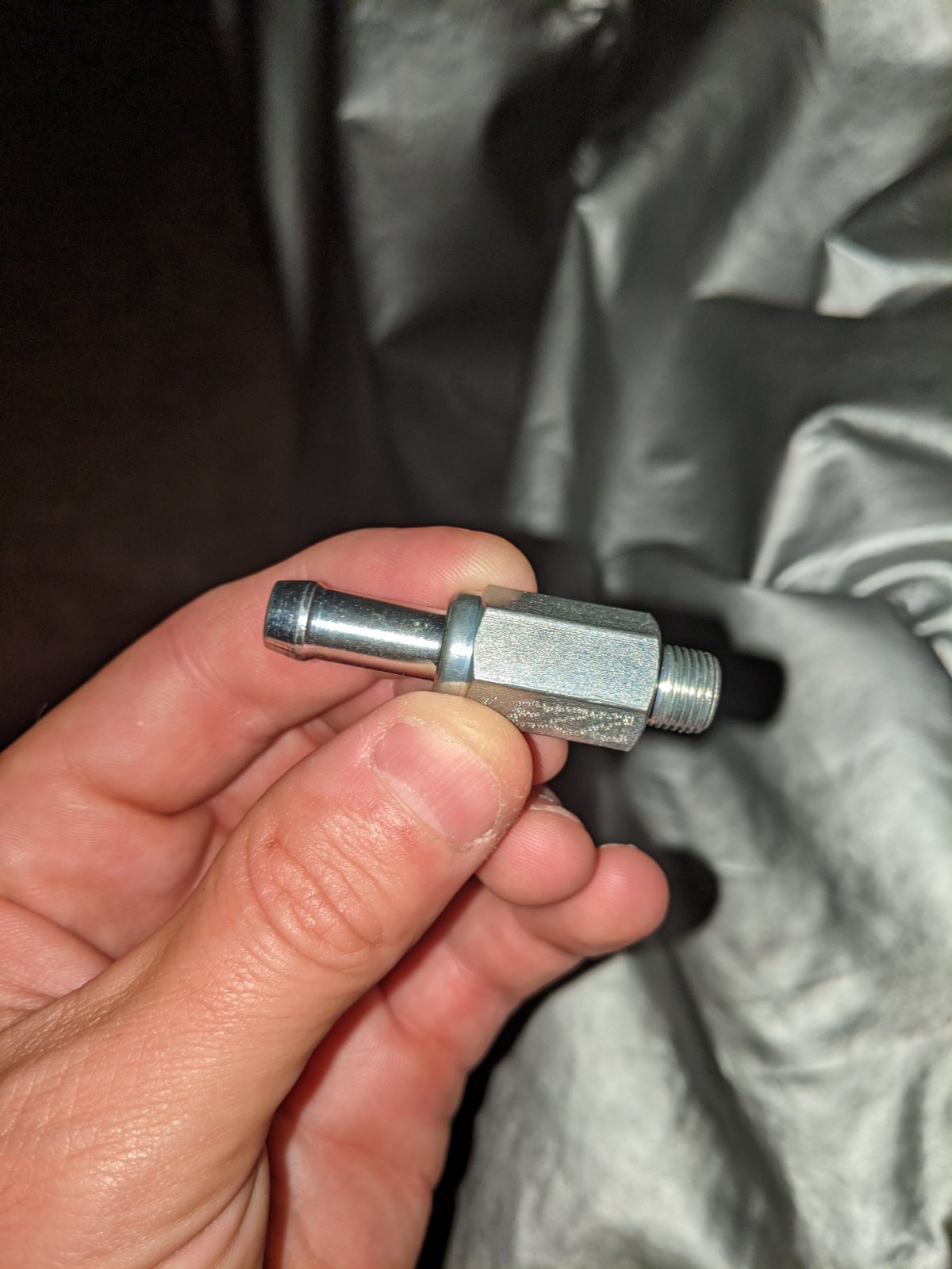

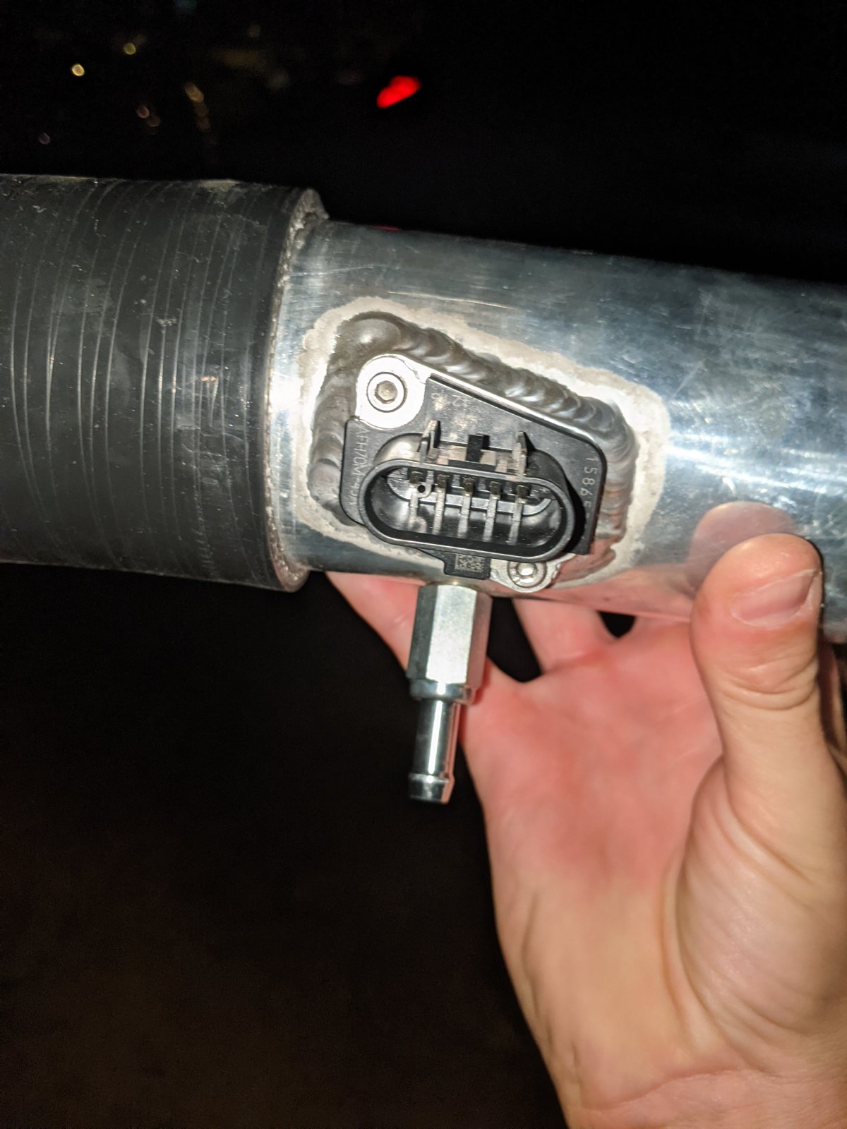

3 auto parts stores to find a $3 part. But it's a perfect fit. Part # PVC1171DL at AutoZone. It's more restrictive than I'd like, but given that some performance shops recommend plugging this side I think it'll be fine.

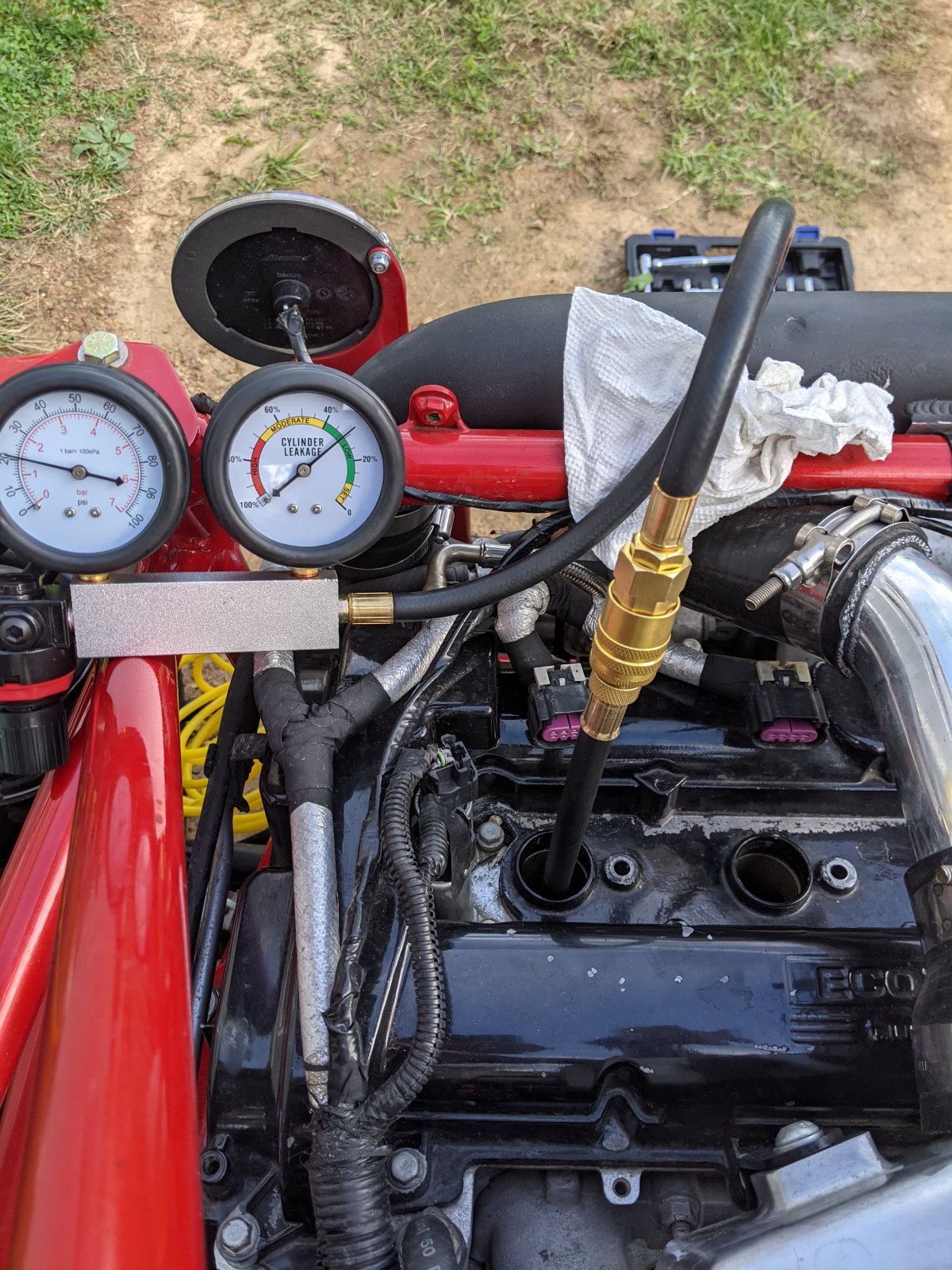

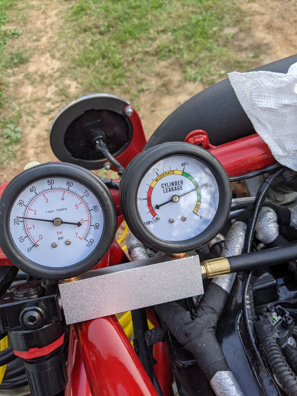

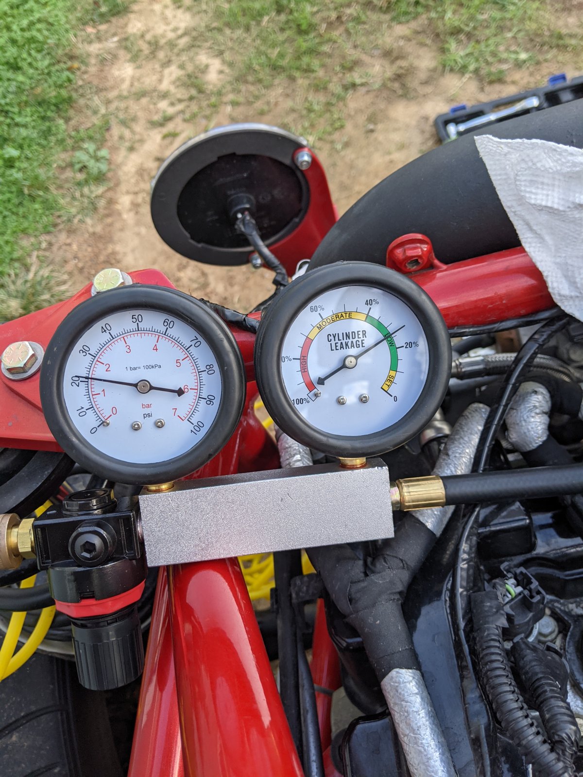

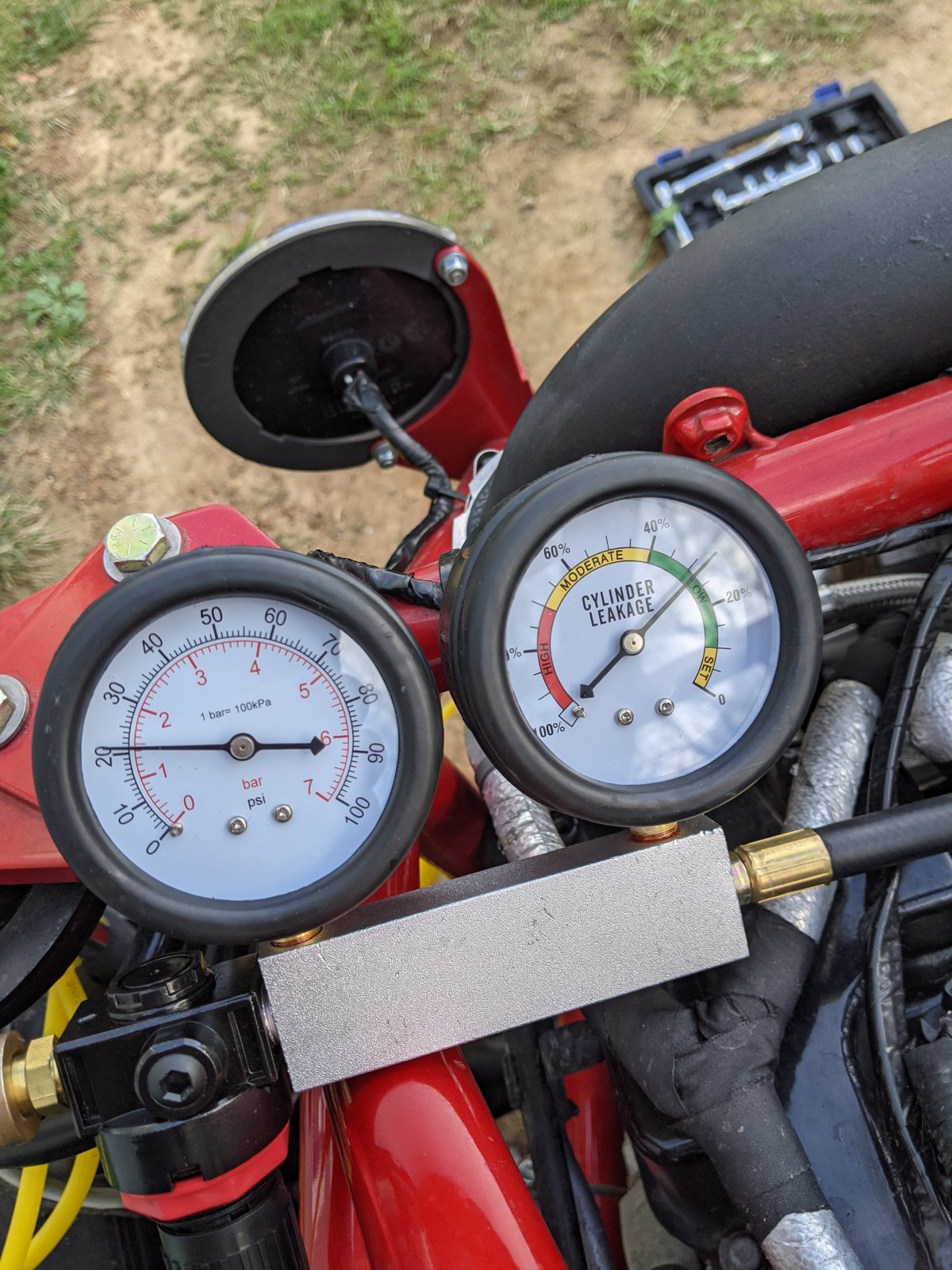

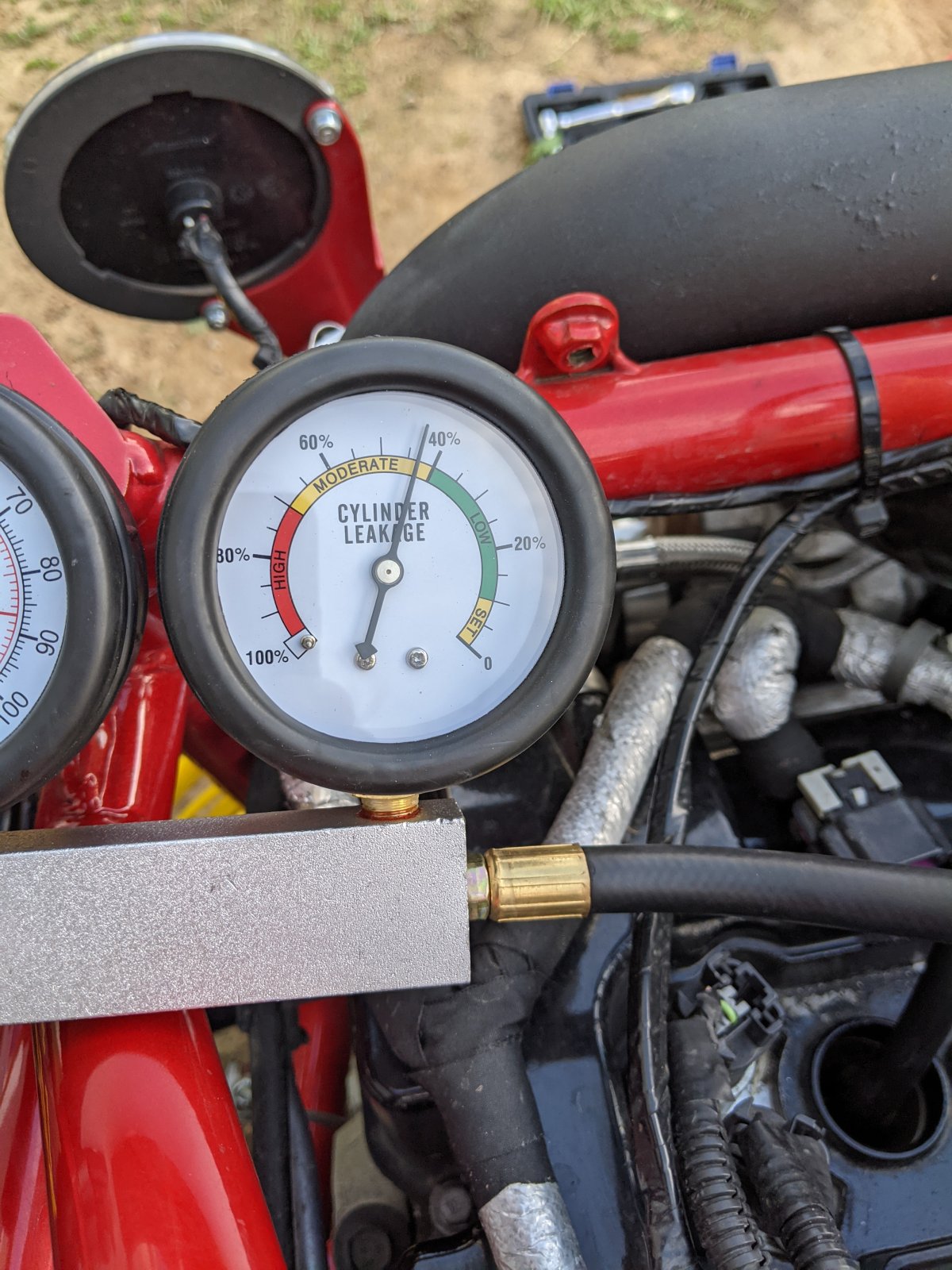

Over the weekend I finally had the opportunity to run compression and leak down tests to see if there are any obvious major issues with the engine. The compression test came back 130 160 160 155. A little low on cylinder 1 (or 4, dunno which order it runs in- assuming left to right facing backwards due to engine orientation). Leak down was a little concerning on the first run on the low cylinder on first run, but I ran it a 2nd time and it was normal across the board. Any and all noise to be heard was coming from the dipstick tube on all cylinders. 5 pics loop back around to the same problem cylinder as first and last pics.
At this point I'm really racking my brain to figure out what's going on. The car stinks like gas. The oil smells like gas. It did not smell like this when we picked it up, nor do I remember it smelling this way until after I replaced the plugs, packs, intake filter, and cleaned the MAF sensor. A little bit of oil is still making it past the less-than-airtight check valve. It's been running on an open loop since I purchased it. There are two things that I can think to weed out from here. 1) having a fouled MAF sensor caused the car to run leaner and ultimately not all that bad on an open loop. I need to hook up the wideband sensor to rule this out- pretty easy... right? Right?? 2) The fuel pump is going bad and is leaking into the engine. I've read a few instances where this has happened in various SS forums. Definitely a bigger investment to figure this one out.
Any other thoughts here? I'm very much learning as I go.

Get the O2 sensor going so you can see what the fuel is doing.
I bet you probably have multiple problems. Without reading all four pages, you likely have a somewhat worn engine and on top of that the ECM isn’t really controlling things. It could be that it’s been dumping to much fuel in which washed the cylinder wall down causing wear.
Have you tried data logging at all?
Jm12
Not yet. I've got the wideband sensor installed but nothing to log the data with/to.
