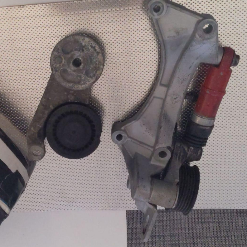

Finally got some one to ship me the tensioner and idler from an LSJ. So, looks like I'll be swapping to a 6rib after all. I think this will be a better solution for many reasons. The pulley on the alternator is one way clutched so it makes the system a lot smoother. An extra rib means less slipping. Double sided belt means better alignment. And on top of all that, the belt is shorter and the system is more compact.

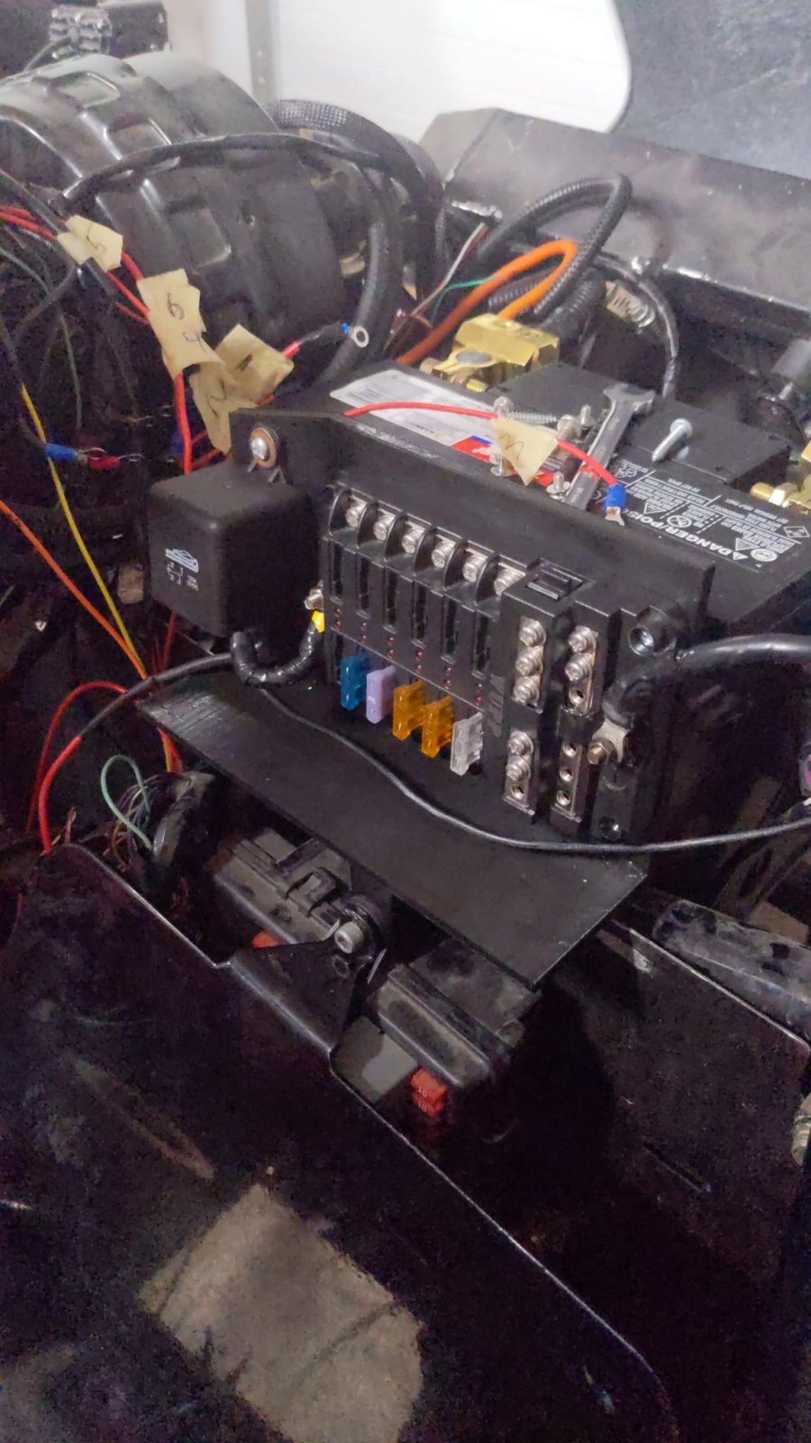

Waiting on the tensioner to get here, so I decided to clean up some wiring. Replaced the kick plate spacer with a (3D printed) mount for my auxiliary fusebox. I don't think I've posted this since the old solution was ugly and involved a piece of OSB shoved next to the battery... This is much cleaner. 100A relay that goes power on with the lights. Convenient because I can turn off the whole relay by toggling the lights. Right now it powers the radio, heat exchanger fan + pump, wide band, oil pressure sensor, and USB charger. Wires aren't added back yet since its about 90F and 1000% humidity right now and I got sick of being in the garage. Baby steps

Everything is patined and on. I might have to come up with a solution for more belt play since I'm running the ATI OD, phenolic, and M62 spacer (for methanol). I have a stock length belt that I would like to make work if possible.
The bad:
My tensioner shock thing is broken or something. It has a tiny bit of movement (1/4”), but no "shock" behavior. I can't find a way to take it apart to fix it... So I might be SOL until I find another one.
