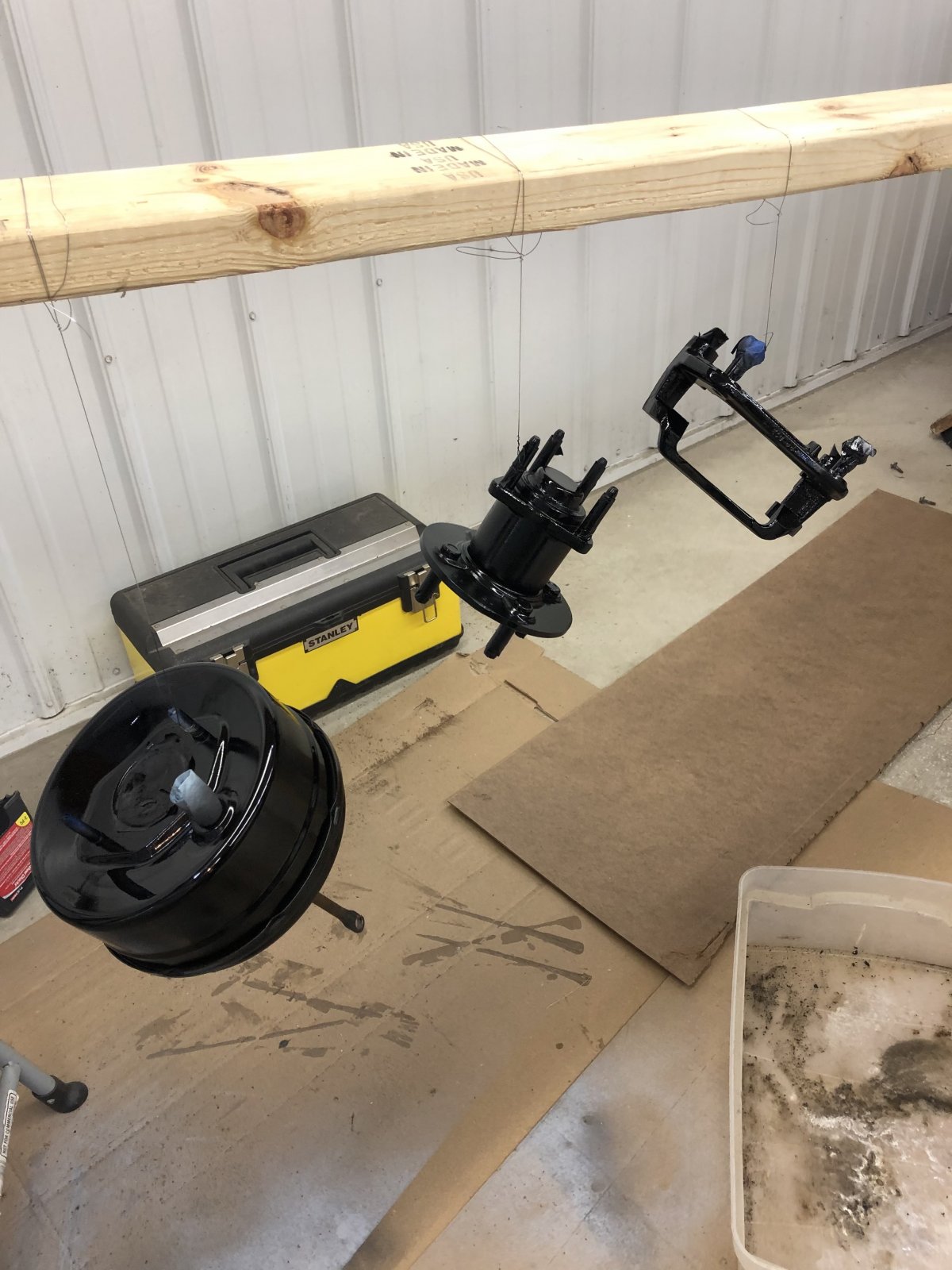

Wiring harness is done. On to blasting off a bunch of Ohio rust and painting parts. Slow going (due 100% to my not spending enough time out there), but thought I'd give a shout-out to Eastwood. I'm using their Pre Painting Prep, Self Etch Primer, and Chassis Black Satin, and it's excellent. Can't wait to see it all mounted up.

Only have the subframe left to tackle at this point. Going to wait on a second rattlecan of Chassis Black since this one's getting a little too light for me.

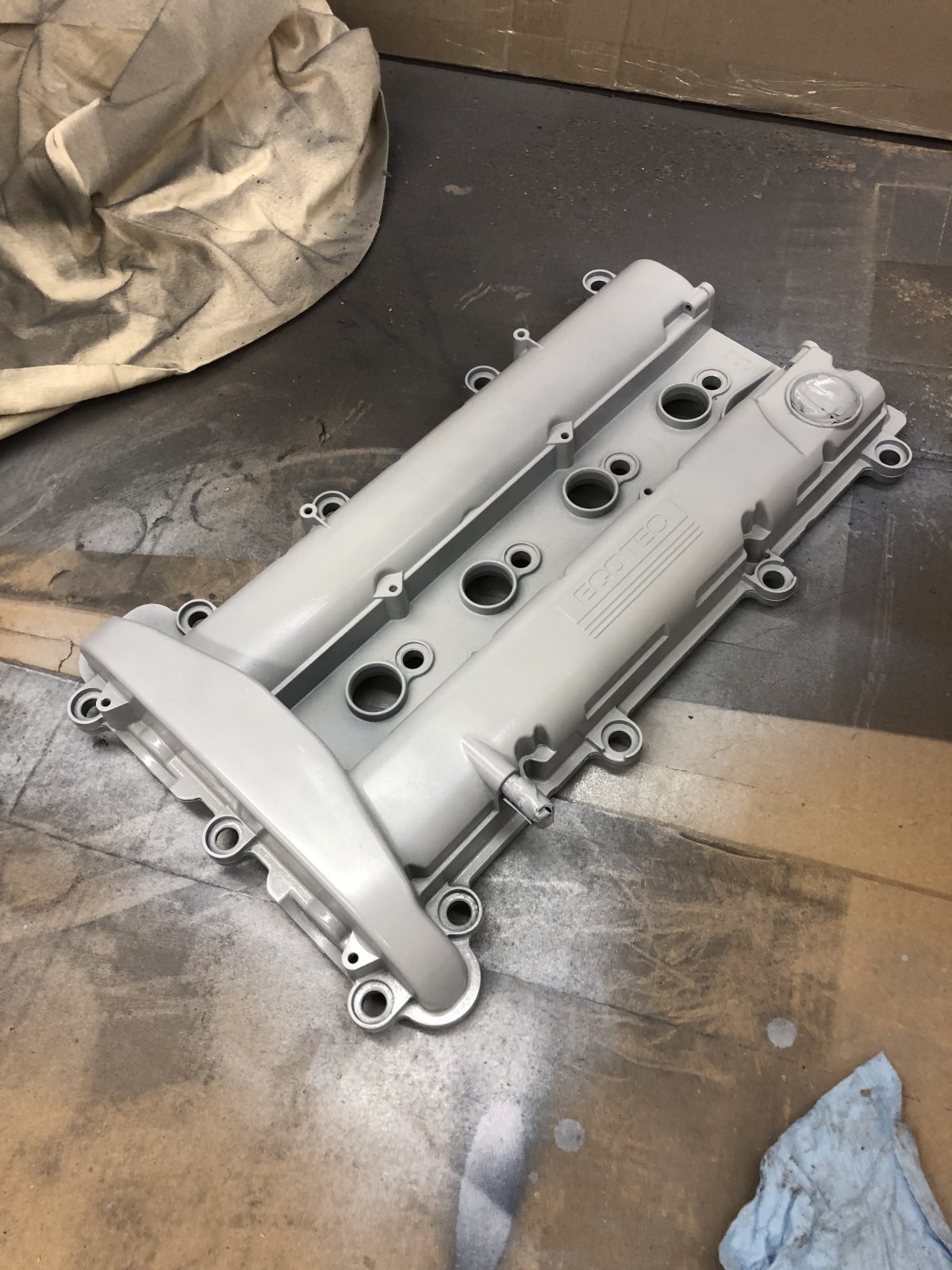

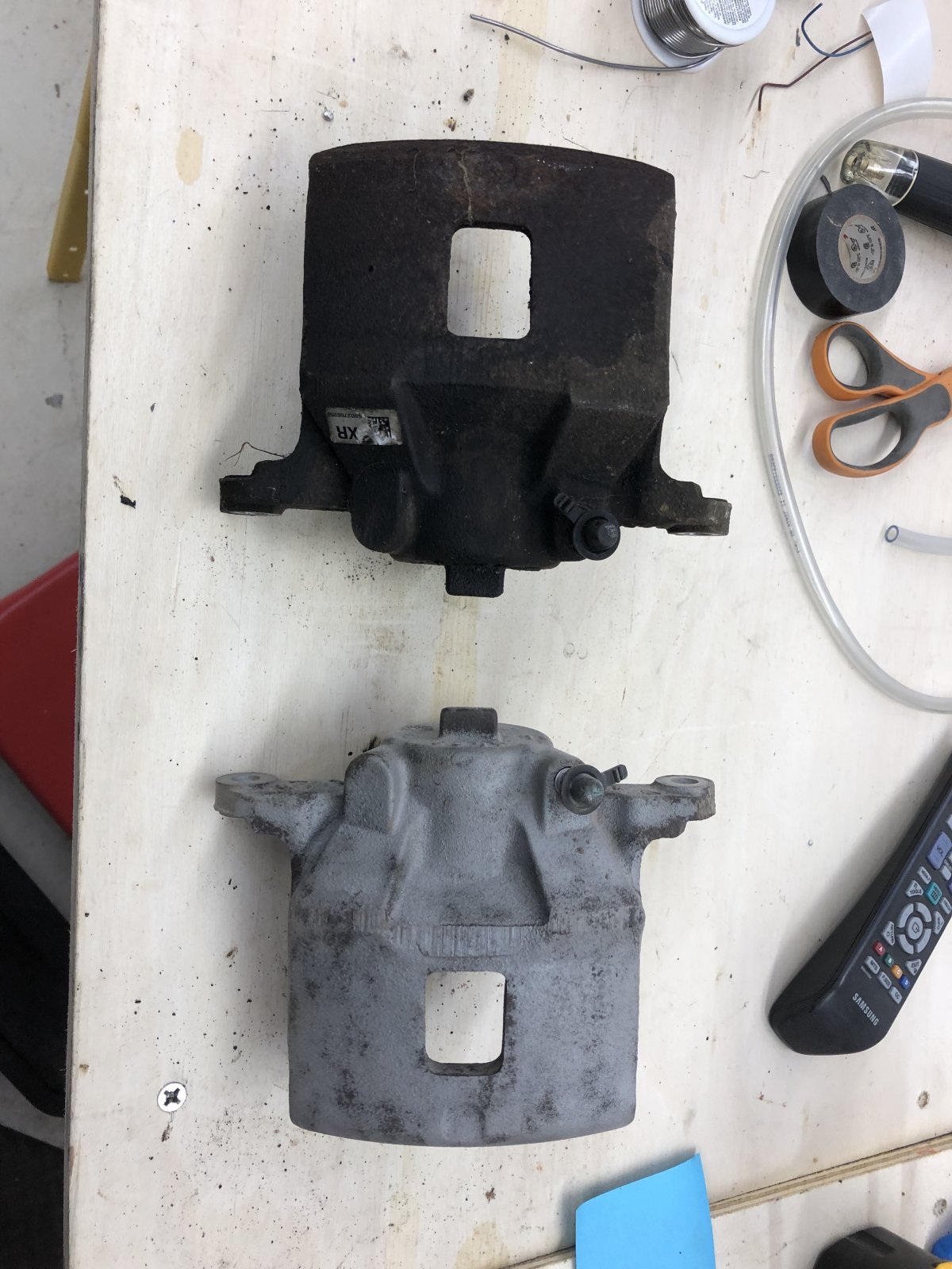

Before/after a half-assed sandblasting job. The difference is subtle, but I think it's there.

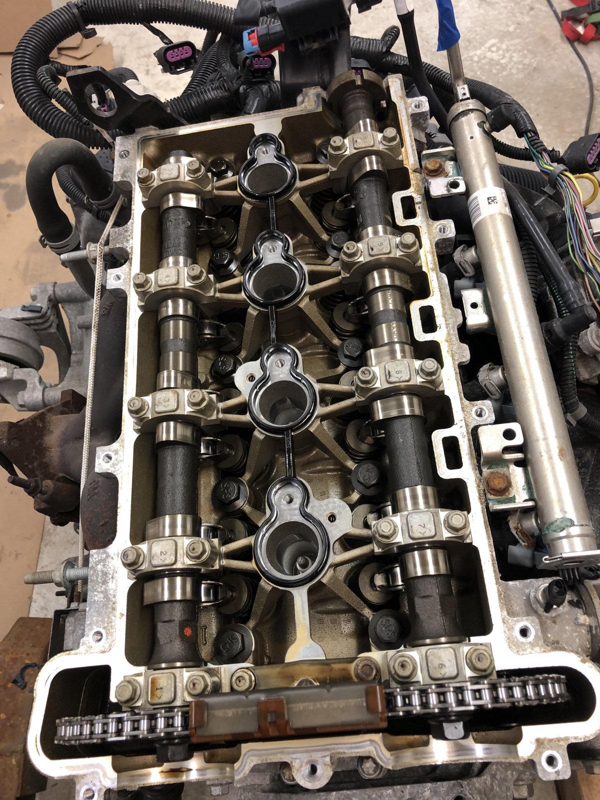

I removed the valve cover to paint it and it looks nice under there. The donor had around 70k on it and according to the owner was carefully maintained. I certainly believe him!
Wish I'd gotten a "before" pic with all the crust. I took easily an hour blasting this thing, after taping off all the oil channels and stuff underneath.
Almost to the point of rolling in the chassis and running radiator lines...
I'm sure you already know this, but really take care to make sure there is no media left behind on the valve cover. A couple of the shops that I took mine to refused to blast it for fear of media getting stuck in the ports and other areas only to come loose later down in to the engine. We ended up cleaning and baking it a couple of times before powder coating.
Yeah, I tried to seal up all the channels inside and will be giving it a good cleaning before reinstallation. I plan to change the oil after a couple engine runs too.
