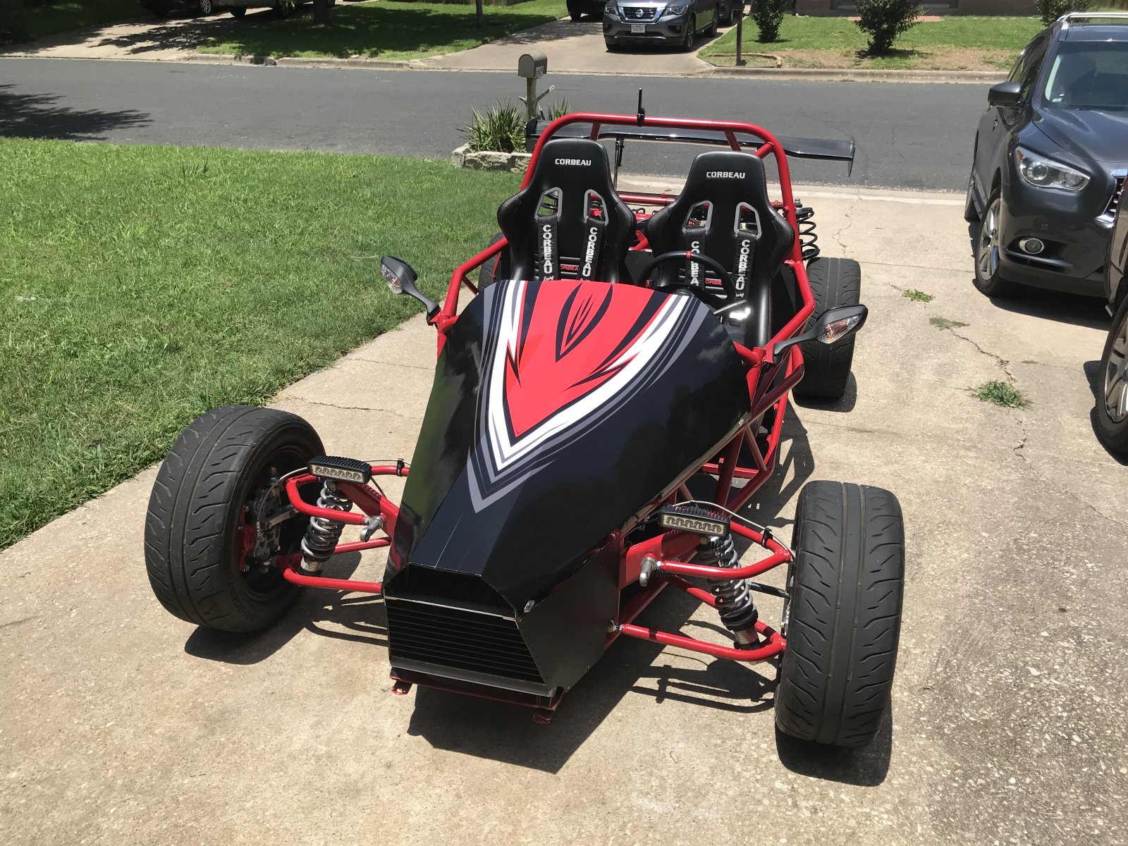

Chopped the ears off my nosecone and added a new graphic because why not
