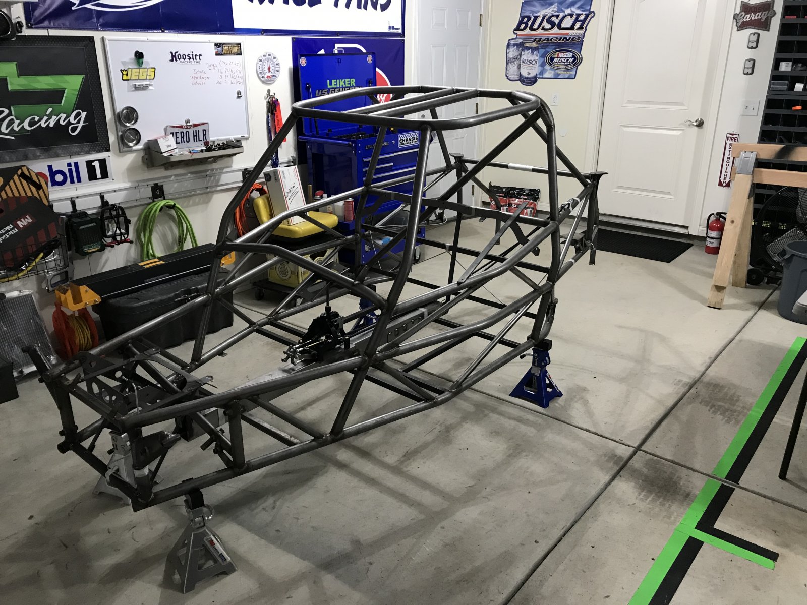

I will be picking my kit up on 19 April so they are just finishing things up right now...the latest pictures are posted above in the thread. They are checking out how the shifter and cables will work as well.
As far as the additional cost and what they plan to offer for the F40, I’ll let Adam address that...it was more work than envisioned speaking with Adam but with how they did it, it will be very nice. It took a modified lower left rail, new trans mount bracket upper and lower, and some other smaller details. Not sure how they plan to offer as an option for new purchases...only guessing it will be similar to ordering the city frame option or the track frame option (would choose F35 or F40 Regal option), but I am only speculating.

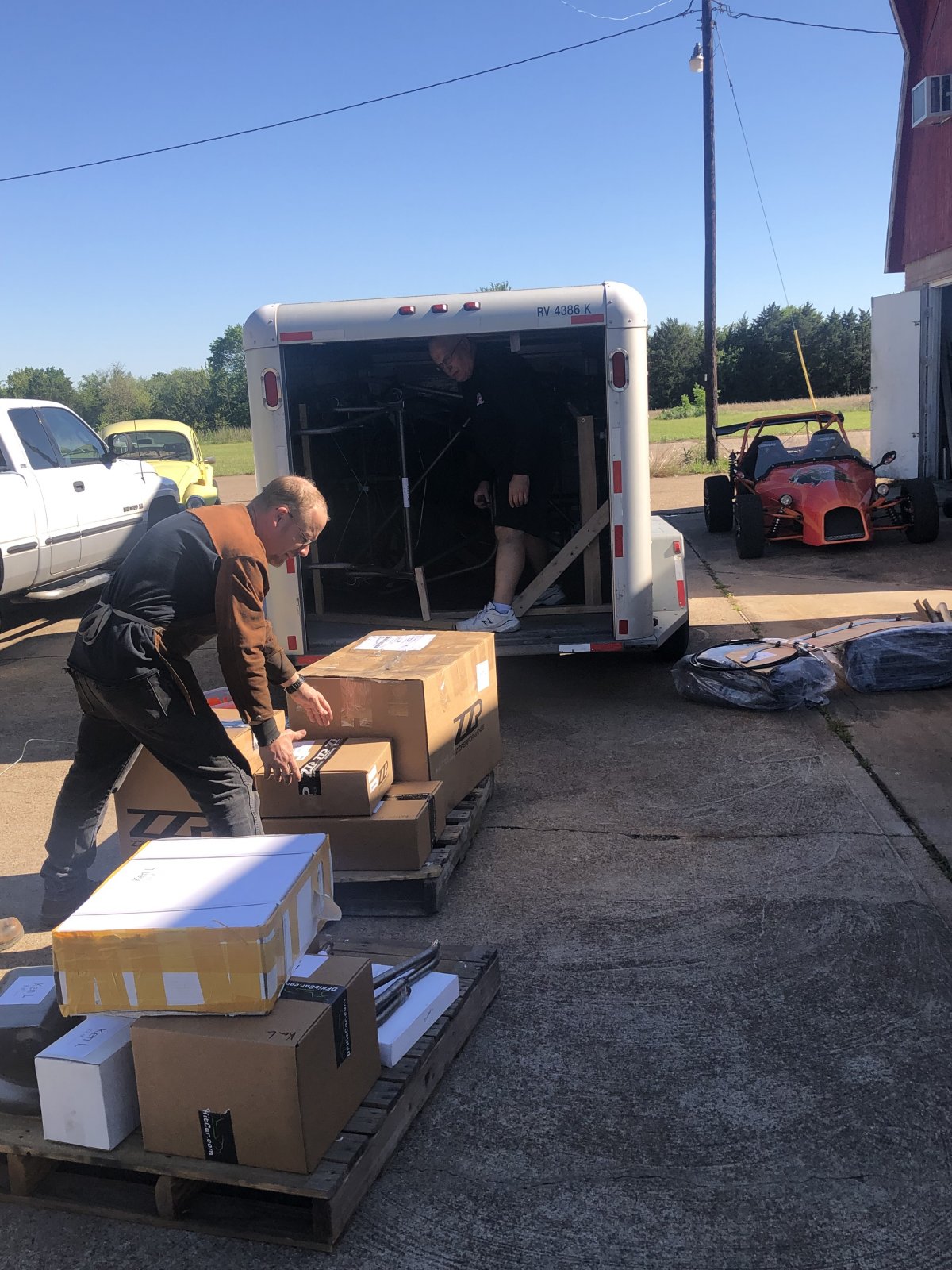

Head to Texas next week to pick the car up.....and another person’s car and a Stage 2 for another builder in the area....will be one packed 6x12 U-Haul trailer!! Lol....
Been doing so much thinking and planning, I’m ready to get the car home, plan out any additional bars or tabs I want, get the welding done and get this thing to powder coat!!!
Beyond stoked and so ready for next week!
KLMOTORSPORTS
The day has finally come when I start traveling to pick up my car! Will be meeting up with Adam and Lonny and loading up tomorrow afternoon. Can not wait to get her back home and start the build process!
Will first look at what additional tabs, pedal box (Tilton 600 series) mount, and Kirkey seat mount, DZUS plates for side panels, etc that I will want welded on and then off to the powdercoat facility.
Since my race colors have always been Lime Green and Black, looking at going black (haven’t decided Gloss or Flat) on the frame as I believe this will go well with all the aluminum stuff on the car...body would be wrapped with Lime Green graphics then.
Will be updating my build log more frequently now since I’ll have plenty of info coming up! Will also post pictures of frame mods that were completed for my LSJ/F40 build.

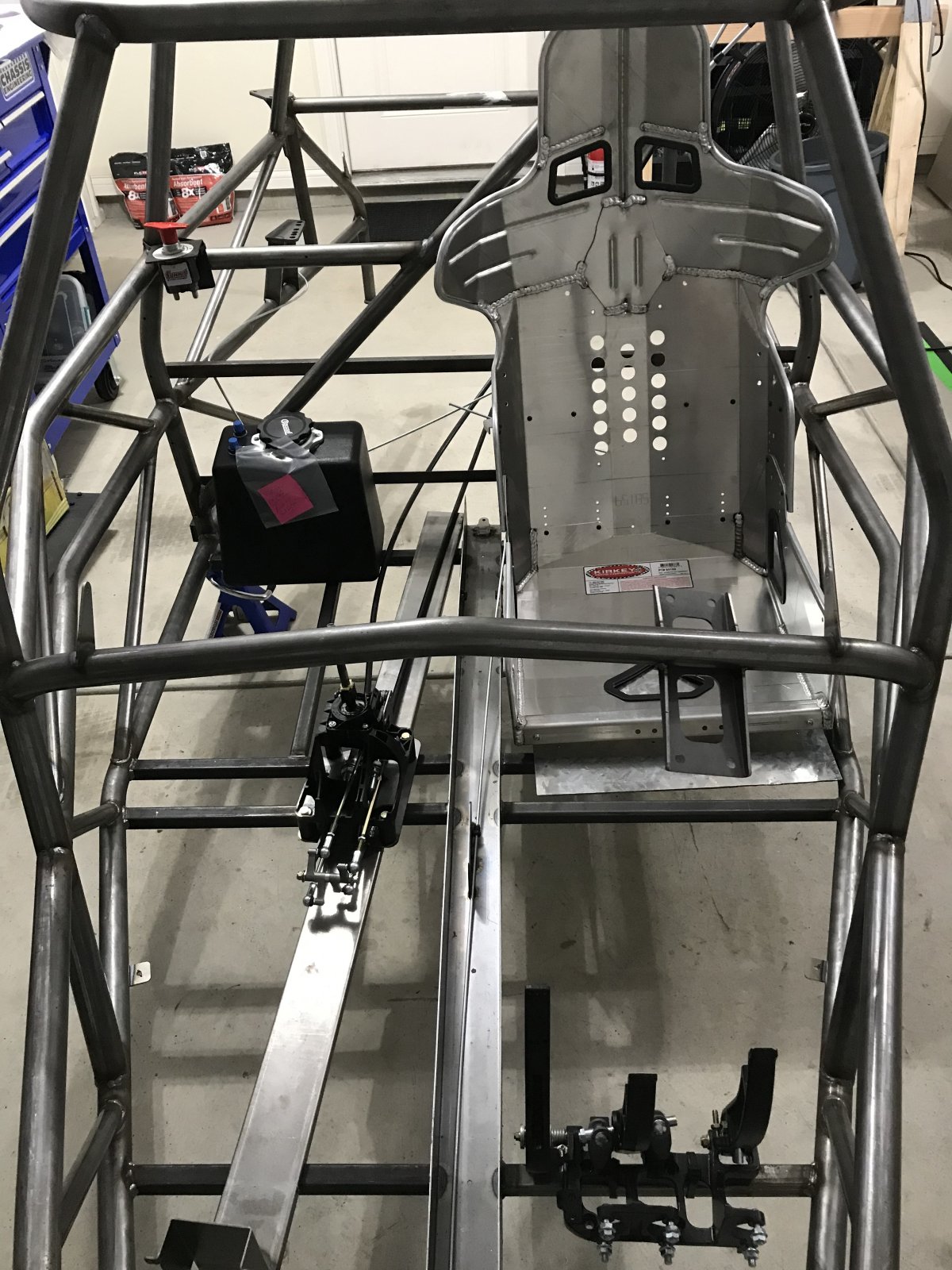

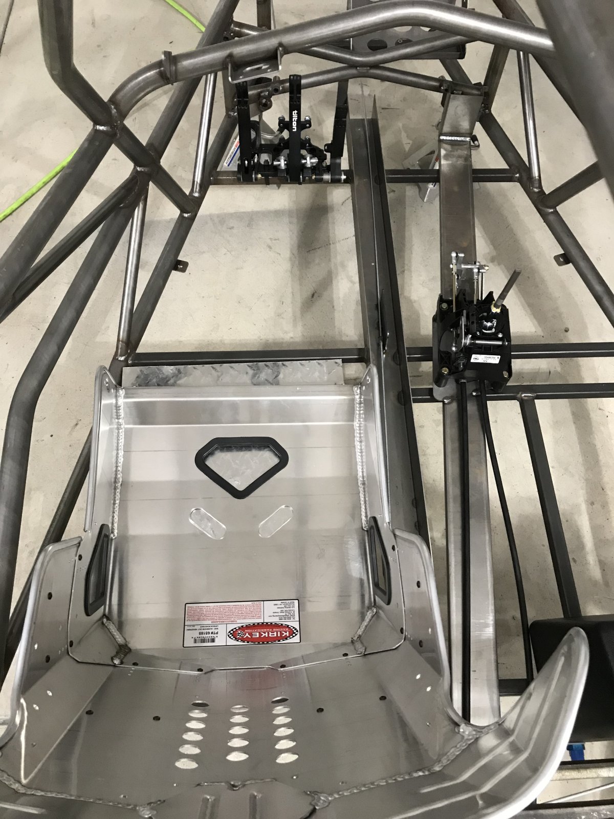

Loading up at DFKC! Chassis turned out awesome!
6 speed Saab shifter? I spy the extra bars in the top of the cage, planning to mount something or just an extra place to garb onto while entering/exiting the car? The Tilton pedals look really good and should be an improvement over the stock Cobalt parts. Are you planning to use the electric steering set up or go with something else? Looking good!
