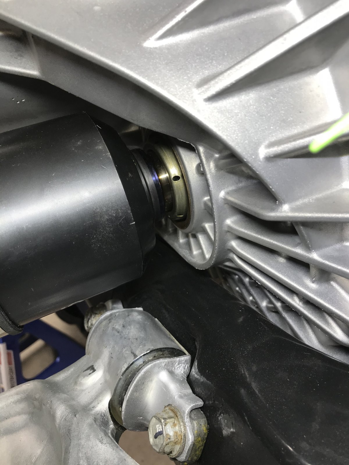

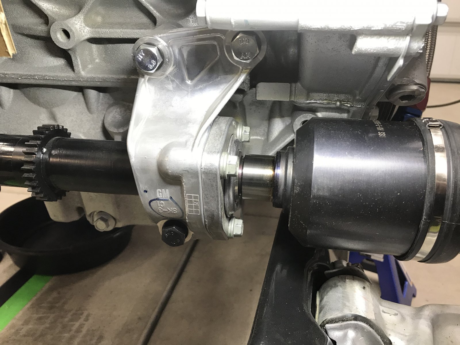

They are Stage 2 axles from Drive Shaft Shop...rated up to 450 HP. Ran into a snag with them...driver side perfect, but passenger side a little long. The sides fit in different and think that got missed (driver side in transmission vices passenger side into half shaft). Gotta send back for a little rework....no super big deal....other stuff to keep me busy!View attachment 10656View attachment 10657
Ken, I'm asking a question on an old post. The drive shafts you bought, did these include a new intermediate shaft? Or did you purchase a new one from someplace? Not sure I want to use 130K axles on my new trans. Thanks.

No, the intermediate shaft is new and came as part of the ZZP F40 Kit...the drive axles are Stage 2’s from The Driveshaft Shop
