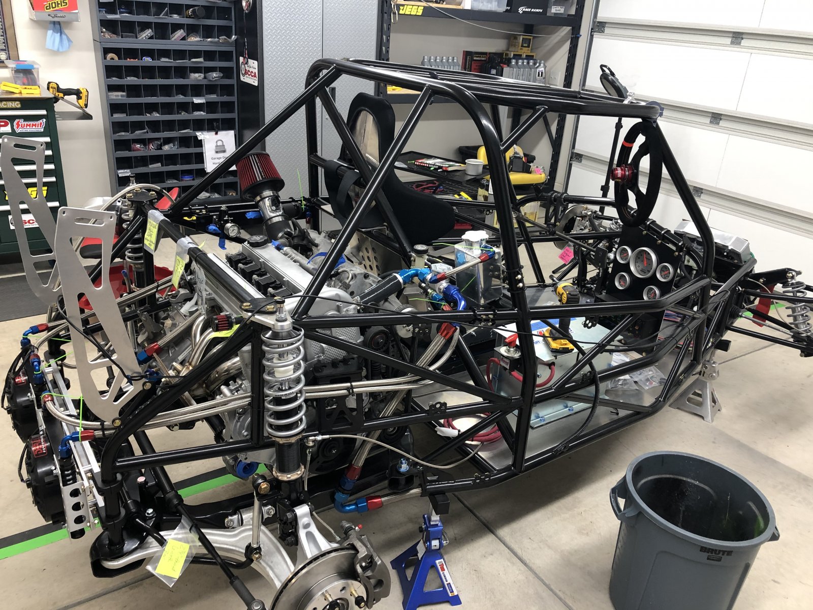

I put this info together last February, in the 'F40 Will It Work' thread:
I've seen some discussion that the F40 transmission has 'steeper' gears and its mph to rpm range is too tall for the Goblin. For those who may be curious (as I was) in the differences between the F35 and F40 in gearing, I ran the comparison at 2500 rpm to 6500 rpm mph range for each gear, starting rpm at next gear when shifting at 6500 rpm and *cruise in top gear at 75 mph:
