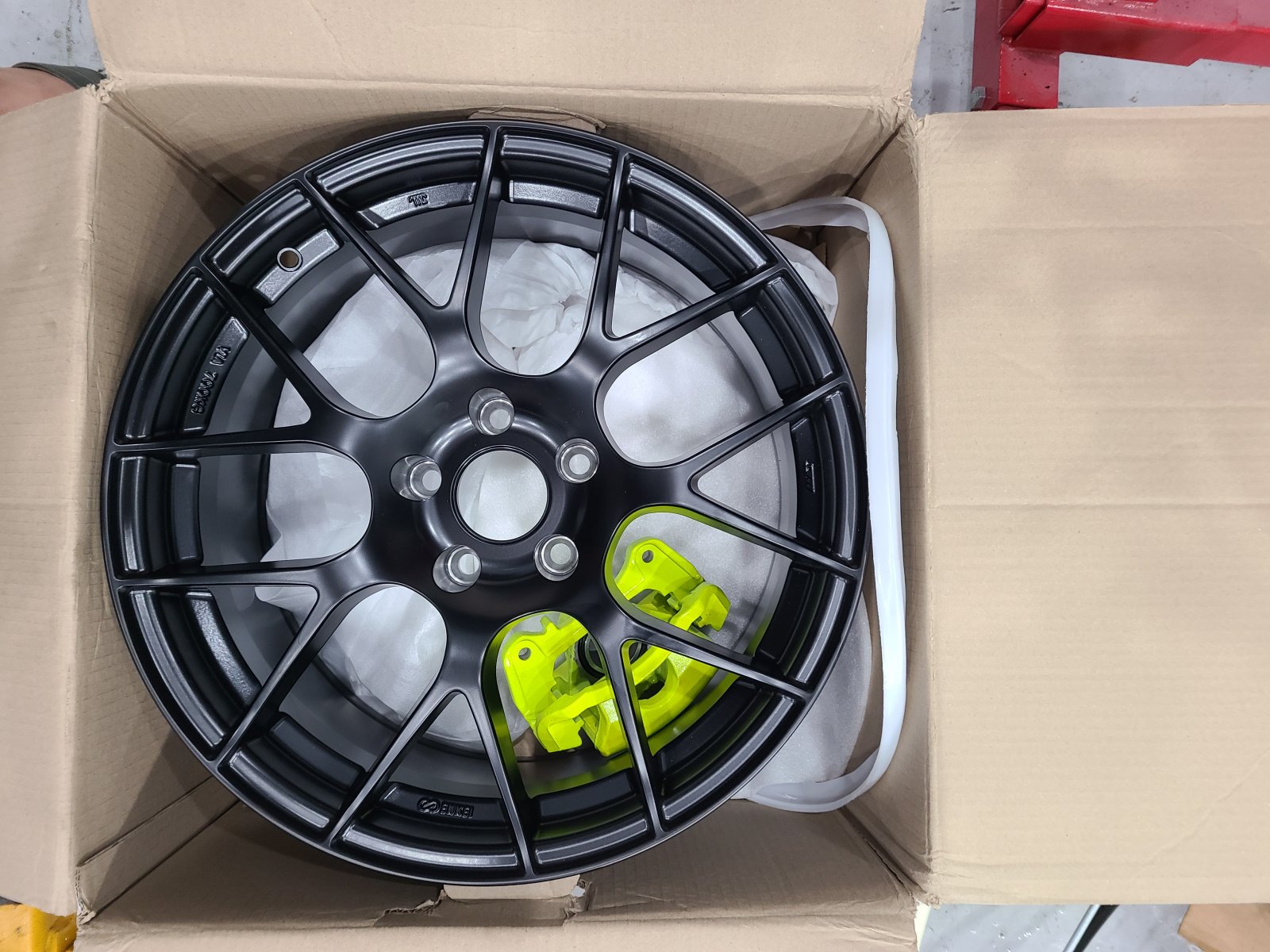

Sounds like a good idea. Thank you.Since you are already knocking out the wheel studs you should just install some ARP wheelstuds for added "security". PN# 100-7708 are the ones that worked for me. The easiest way to install new wheel studs is to 1st put it in the hole, 2nd put a few washers on the side the wheel/lug nut goes on, 3rd install an old lugnut and run it all the way down until it is snug, and 4th go to town with an impact gun on the lugnut. It will draw the stud in.
