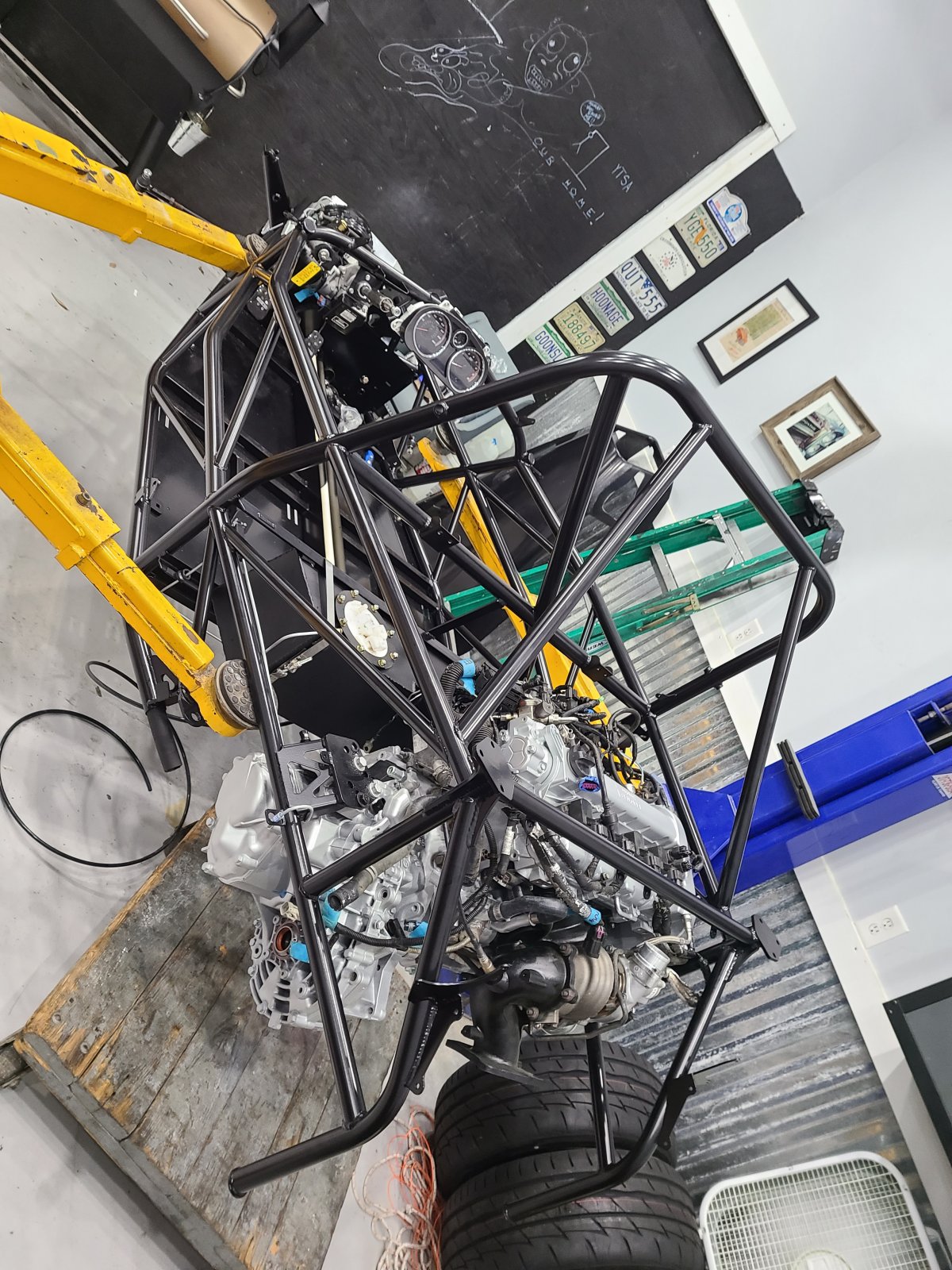

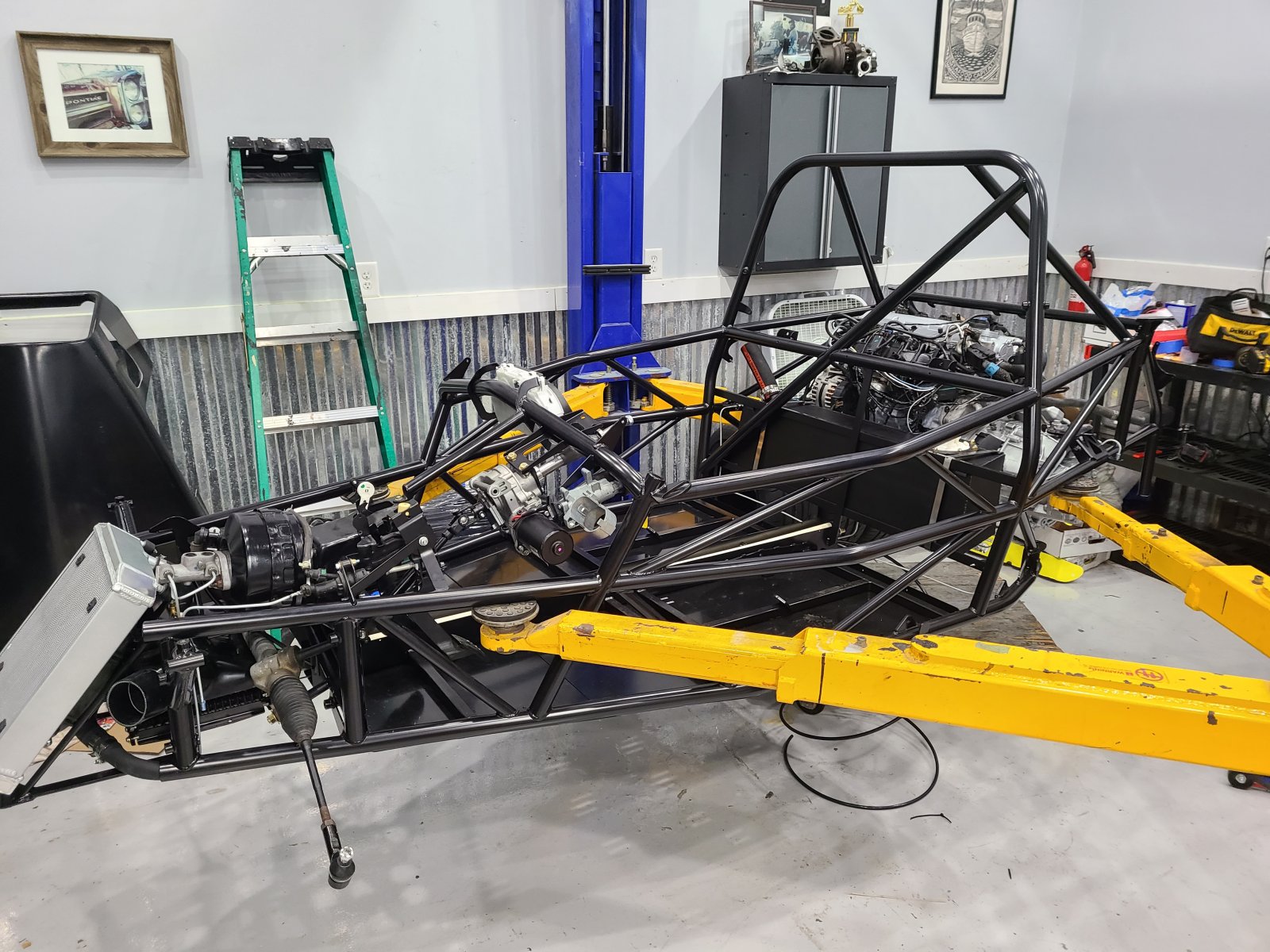

DAAAANG got the engine in and she is sitting pretty. Ashley and I find our selves standing back a lot just saying "can you believe we are building this?" What a sense of accomplishment.
OptimizePrime
I found the build comes together really quickly after you get the motor in - provided there's no electrical gremlins.
Time to get your subframe/rear suspension/brakes/front installed! Did you opt for the solid motor mounts and ebrake?

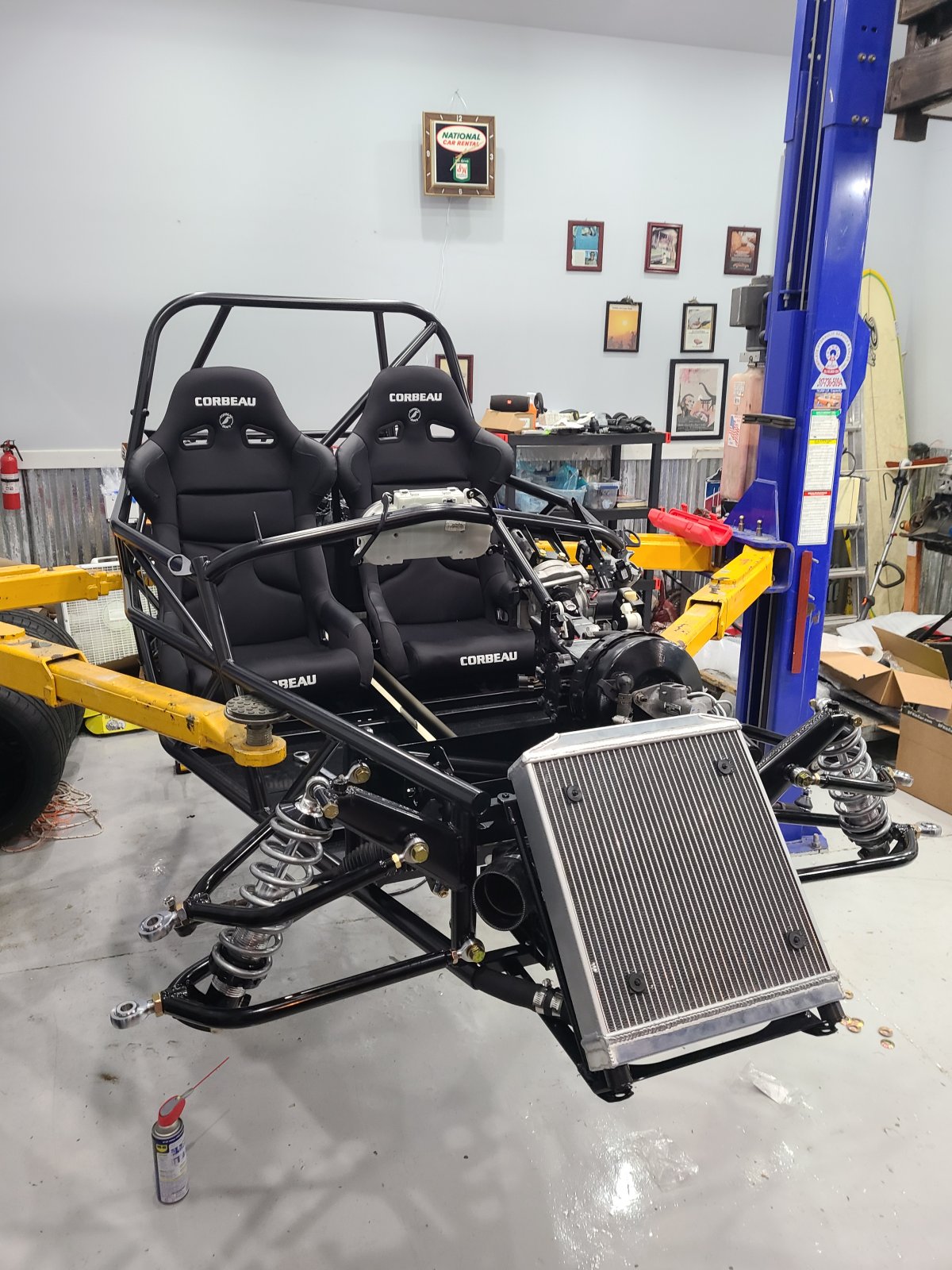

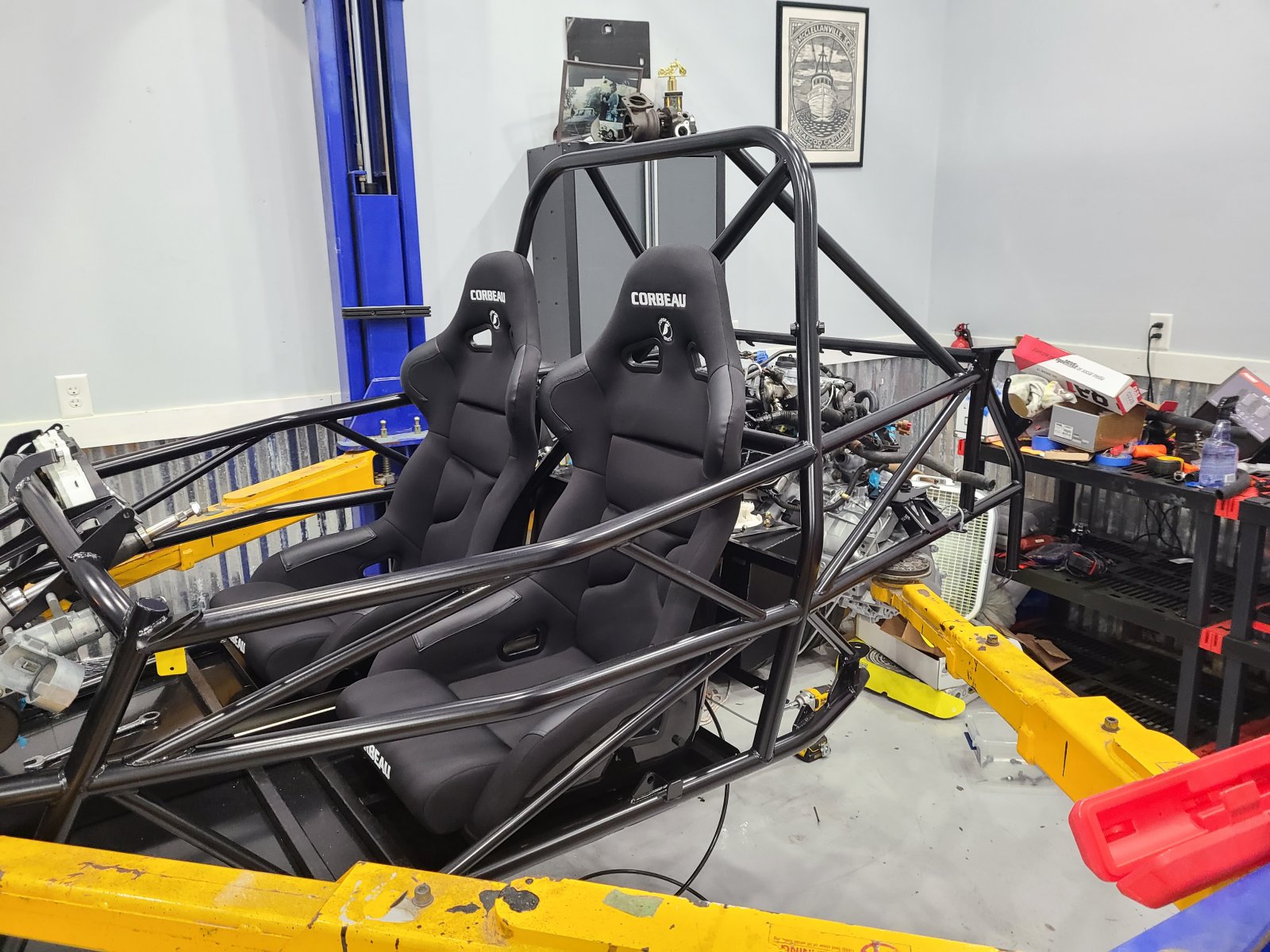

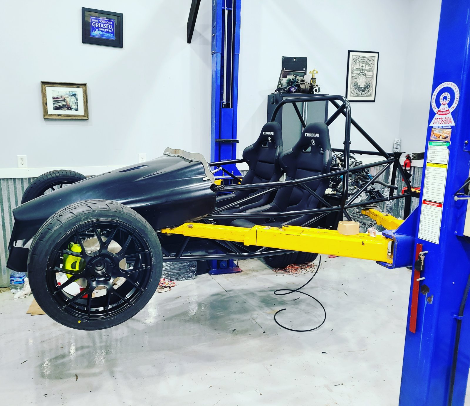

Got the front end started and the seats arrived today!

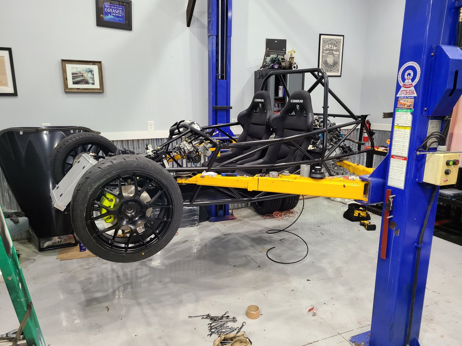

Kenny123
Really starting to take shape now! We REALLY want to install subframe and rear suspension but I'm still worried about the wire harness not being in the car quite yet. We will see. May get a hair somewhere and donit tomorrow.

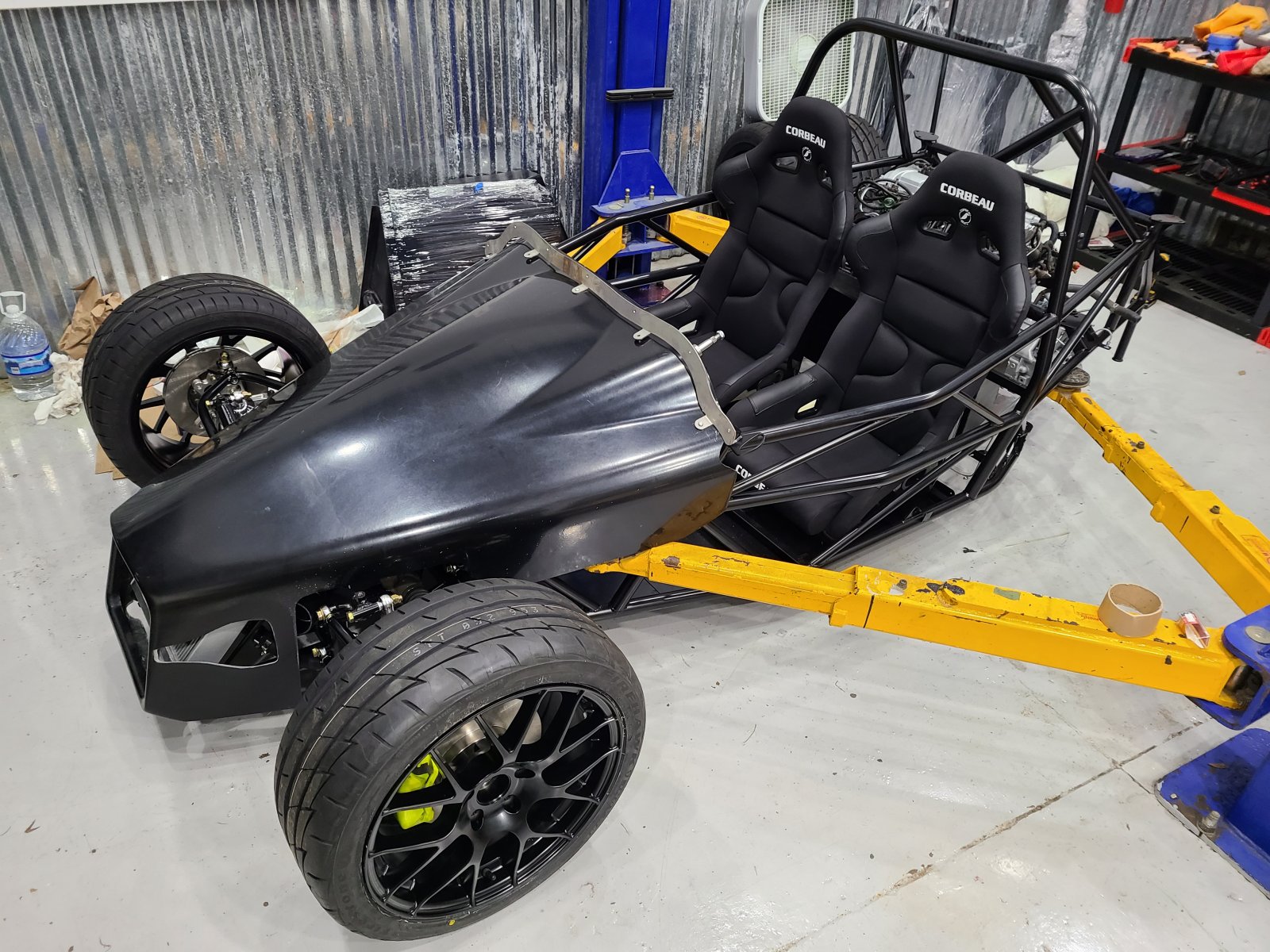

Kenny123

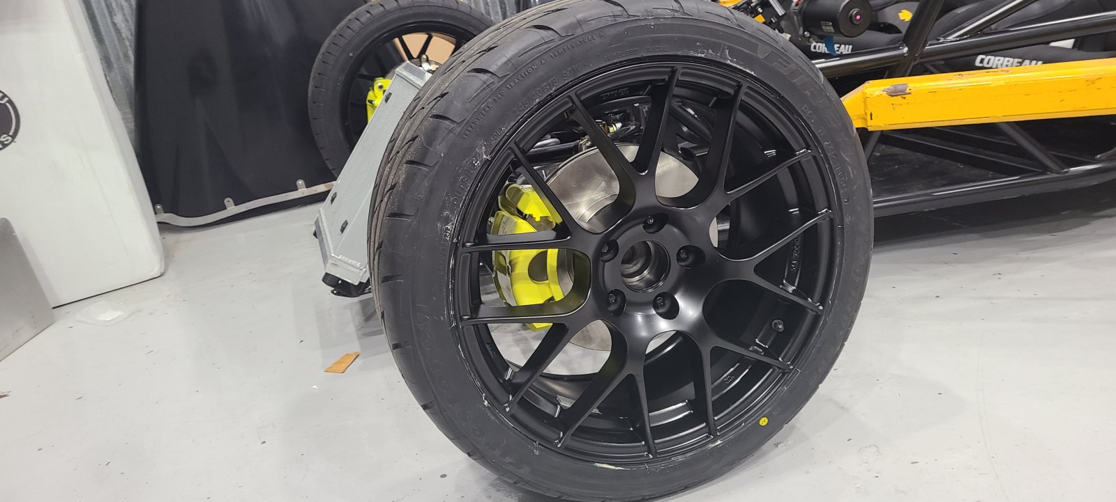

So the flourescent calipers just kept flaking no matter what so I decided to have them powder coated. HIGHLY recommend you choose powder!!!
