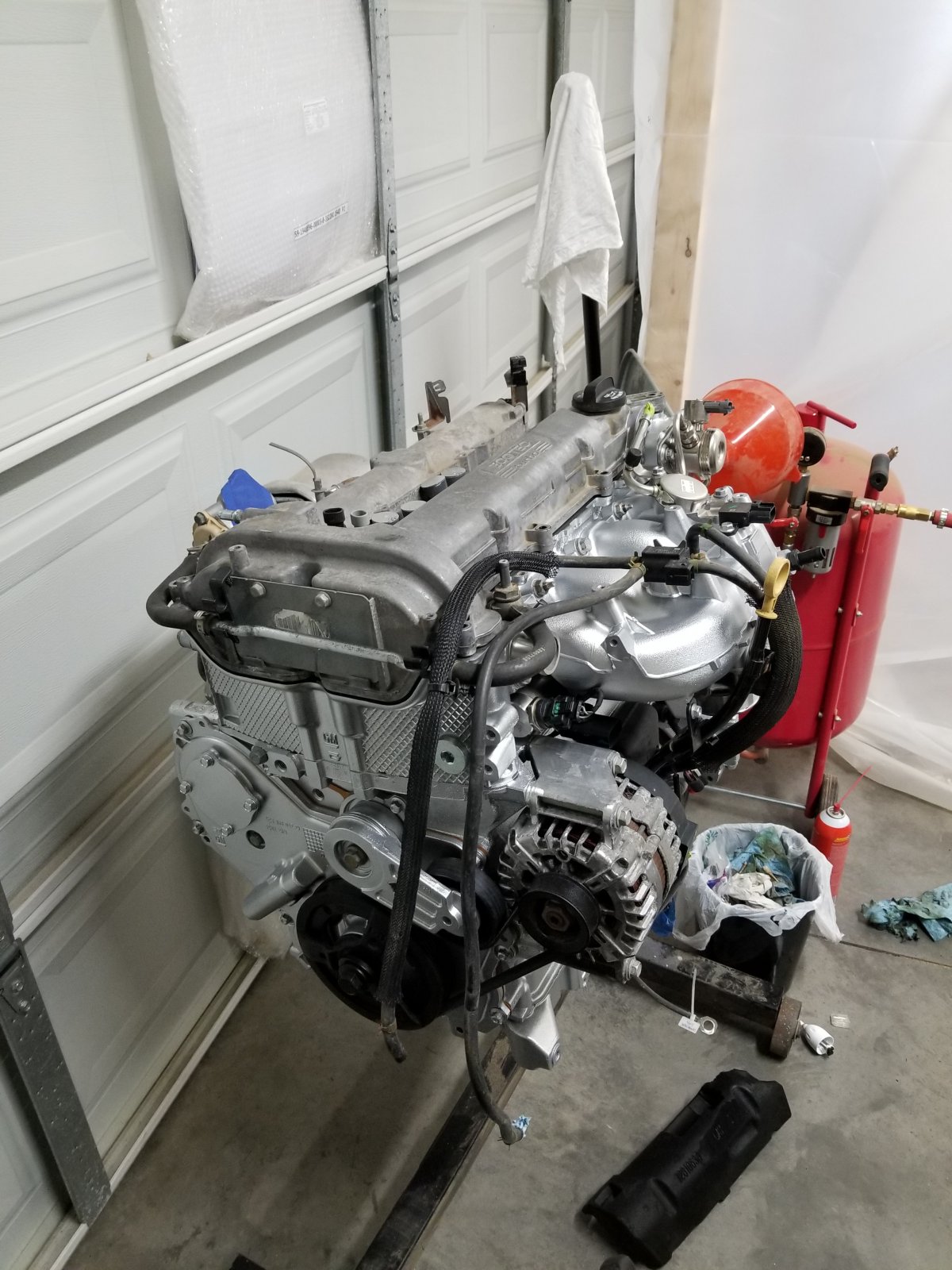

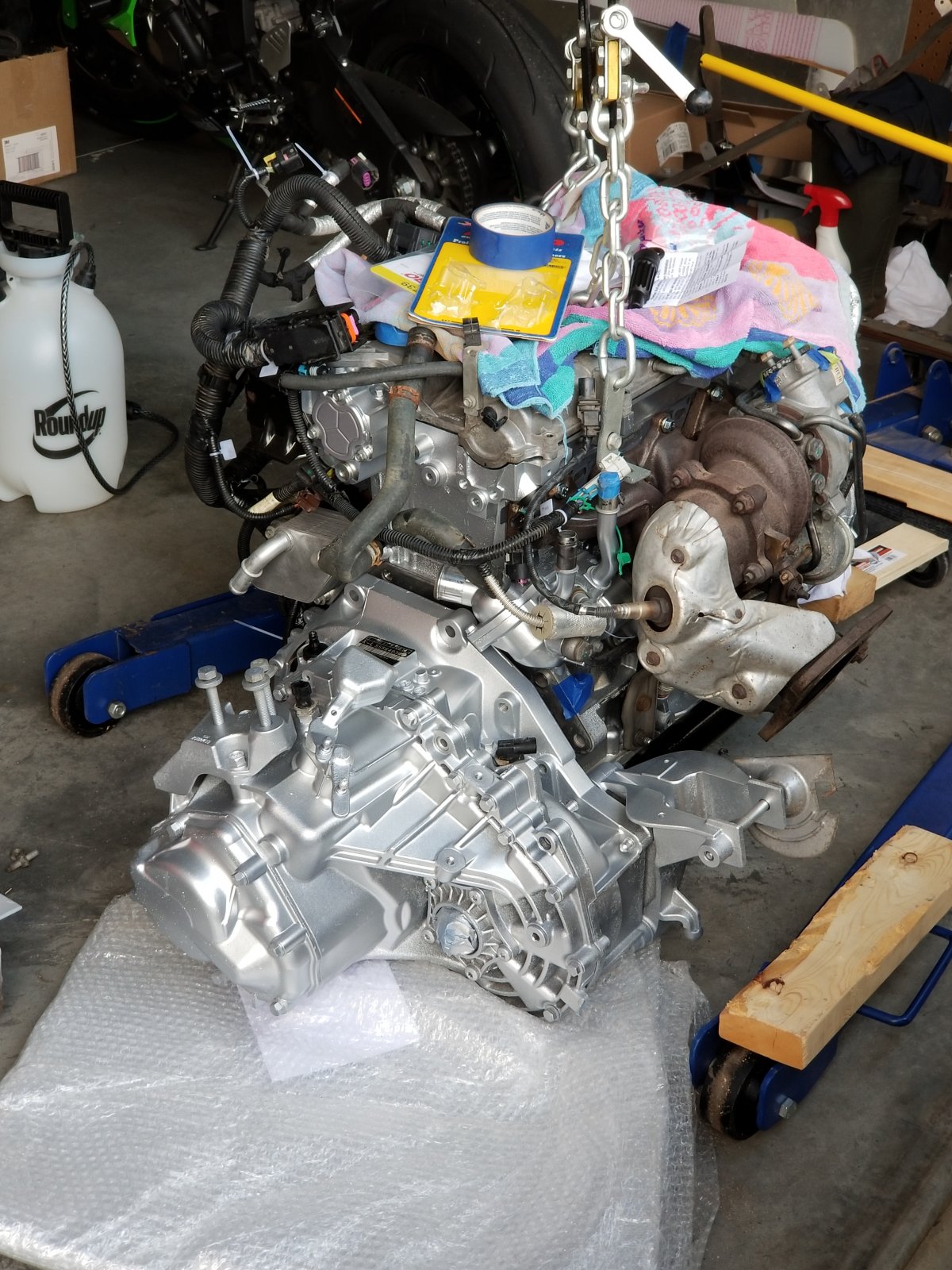

Finally for some long overdue updates, hitting some of the high points. I got through the refreshing process of the engine. I replaced all timing components including the new tensioner, water pump, all gaskets that were removed, spark plugs etc.
The engine and transmission were sprayed with Rustoleum high temp (2000F) primer then Rustoleum Ultra high temp (1200F) silver. It came out a bit more flashy than I was anticipating but happy enough with the end result.
I will address the valve cover sometime later.

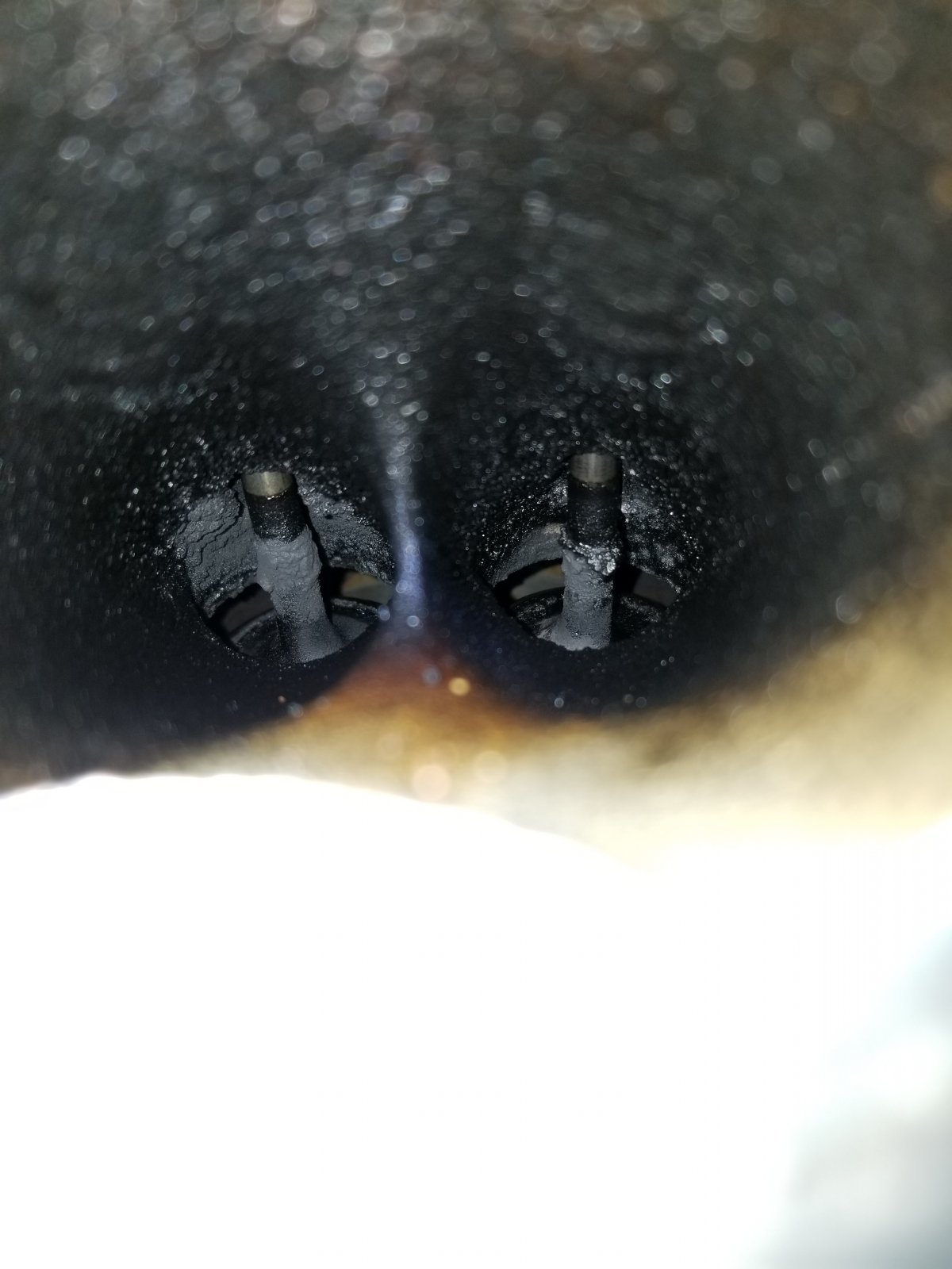

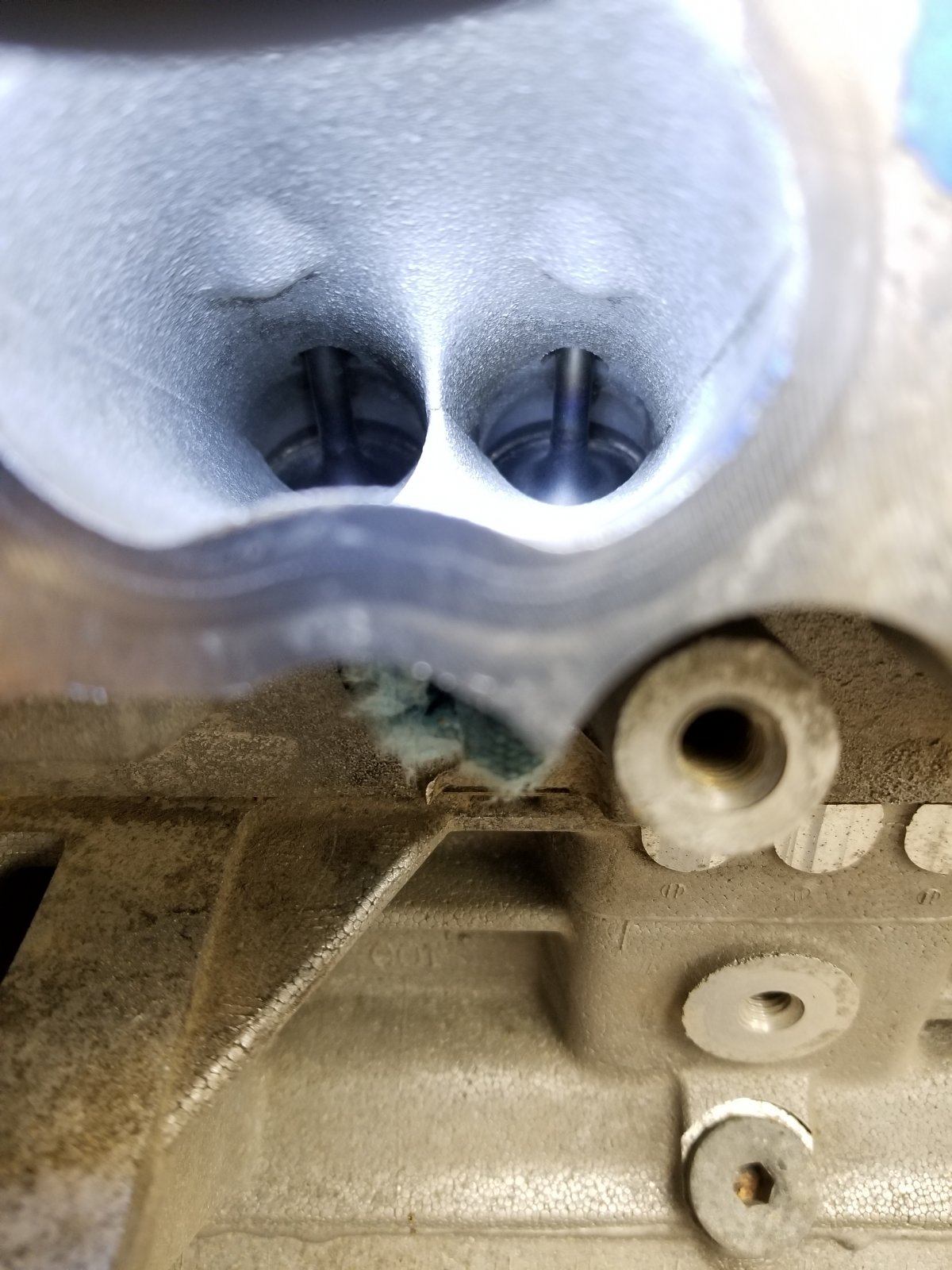

I cleaned and walnut blasted the intake runners and valves, it was very time consuming and tedious but they're as clean as they've been since the donor rolled off the dealer lot in 2010. Before and after images below. Note, the valves are open in the first image, they were closed before cleaning. I used a combination of plastic and brass picks of various shapes, CRC Intake Valve and Turbo cleaner, compressed air and shop towels.

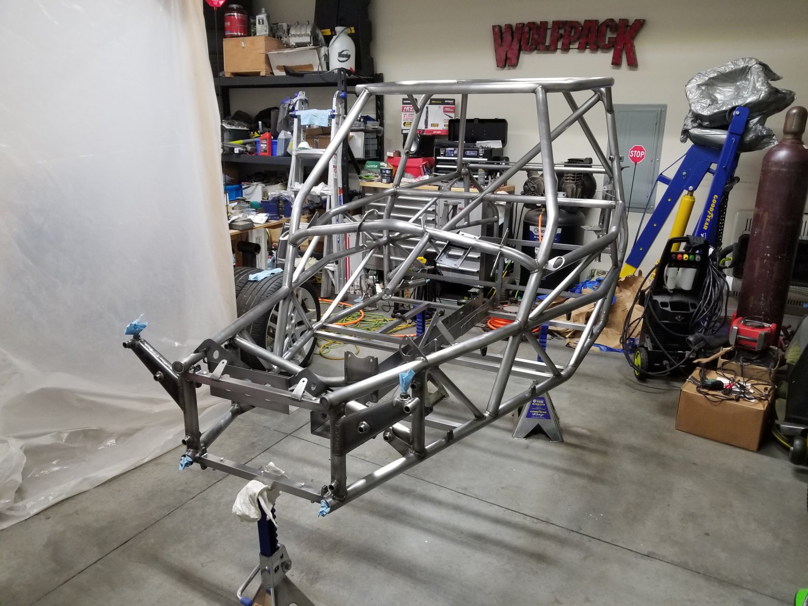

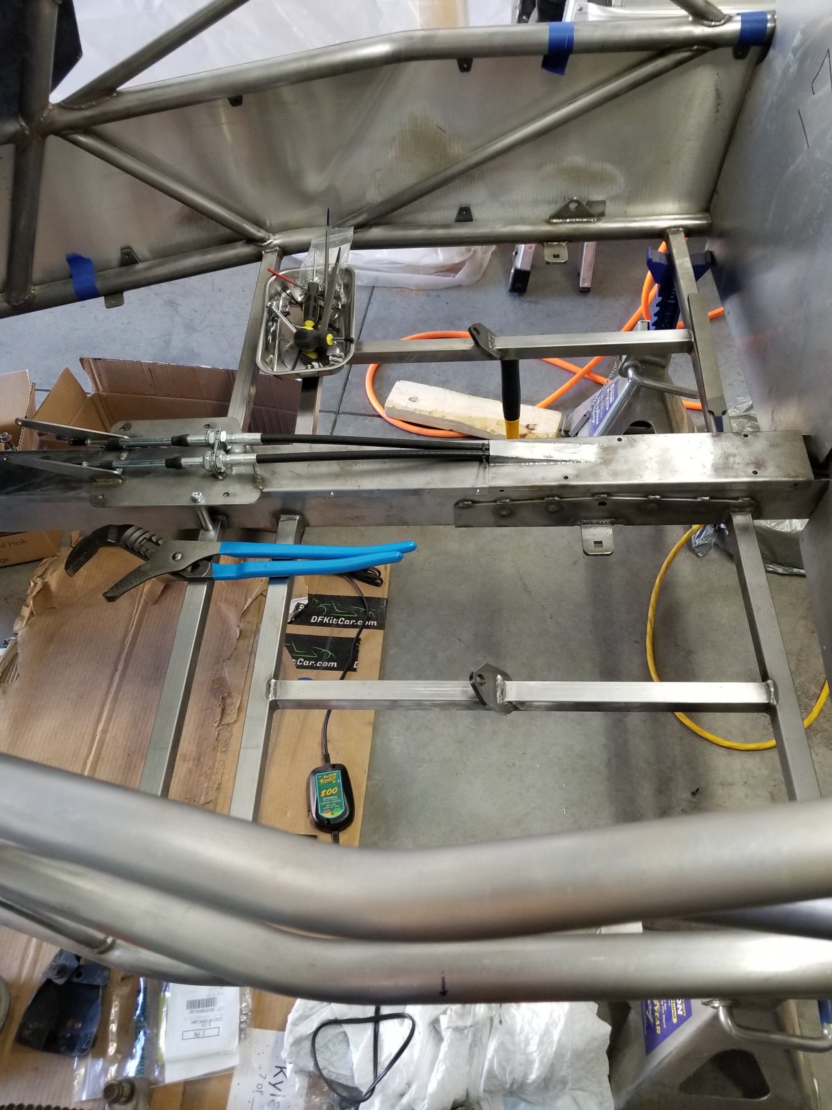

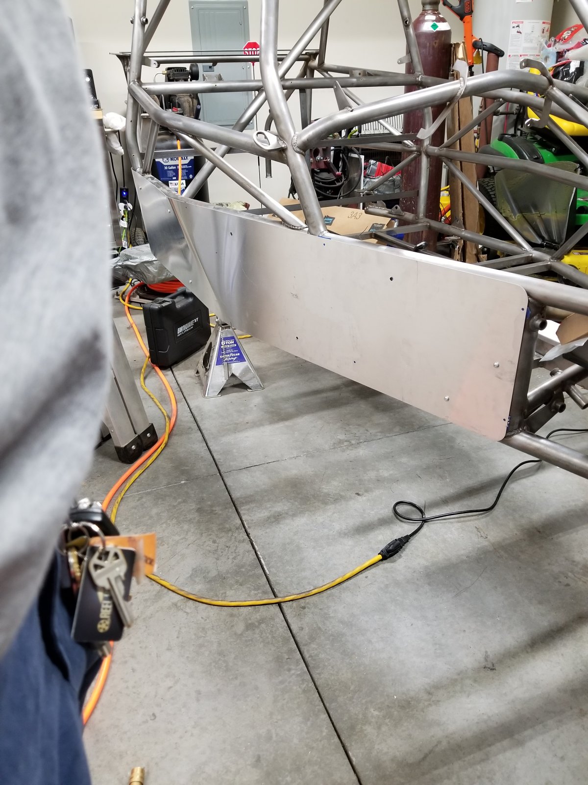

With the help of a really good friend and welder I made numerous minor additions or modifications to the frame. I might have missed some but this is most of them:
Custom welded M6 tabs for side panels (overkill but didn't want to add more holes into frame)
Cut tunnel cover into 3 pieces
Welded M4 SS square nuts in tunnel for tunnel cover
Welded M6 SS nuts for hand brake
2 welded posts for M8 bolts through shifter plate for a very solid shifter
I will also be using one of the K Tuned aluminum shifter assemblies
Cut and welded 'ramped' feature for tucking shifter cables under hand brake
M4 rivnuts for floor pans and firewall
M5 rivnuts for all hard brake line hold downs
M5 rivnuts for passenger kick plate

Side panel mocked up with all of the new holes for the welded tabs.

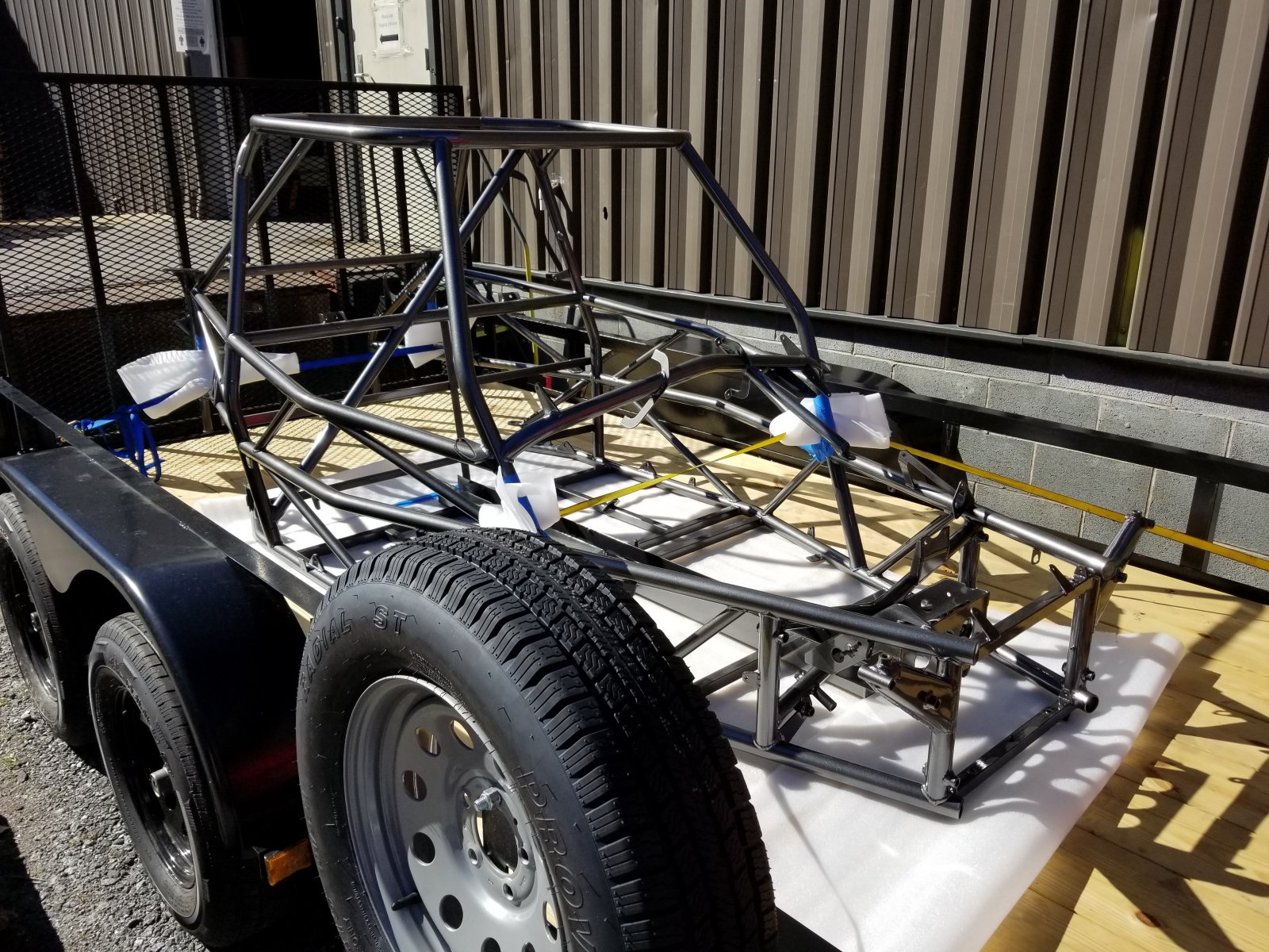

Frame sanded and cleaned and ready for powder coat.
18726
Frame picked up from the powder coater. I went with Kingsport Gray (Prismatic) for the frame, control arms and tunnel cover pieces. The picture doesn't quite do the color justice. Not pictured is the fuel tank, kick plate, front bulkhead panel and a few other small pieces that were coated in a flat black.
18727
This was a relieving sight.

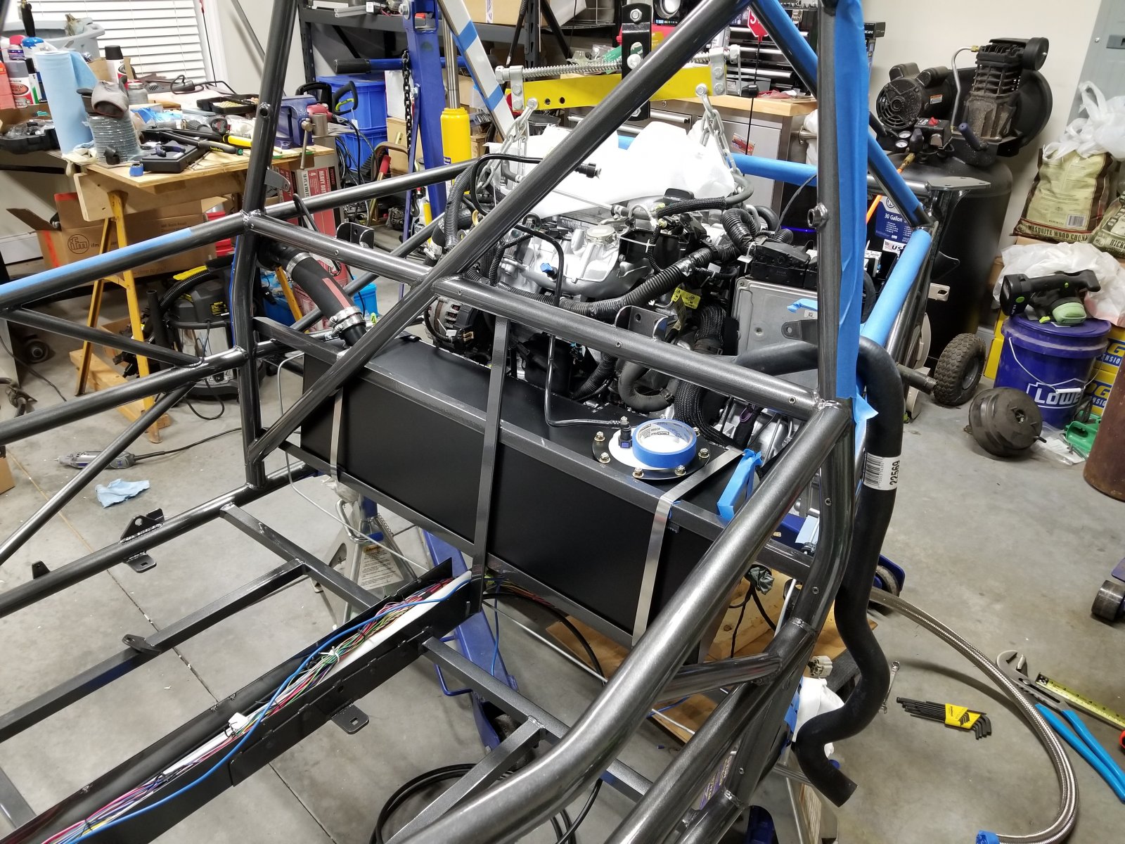

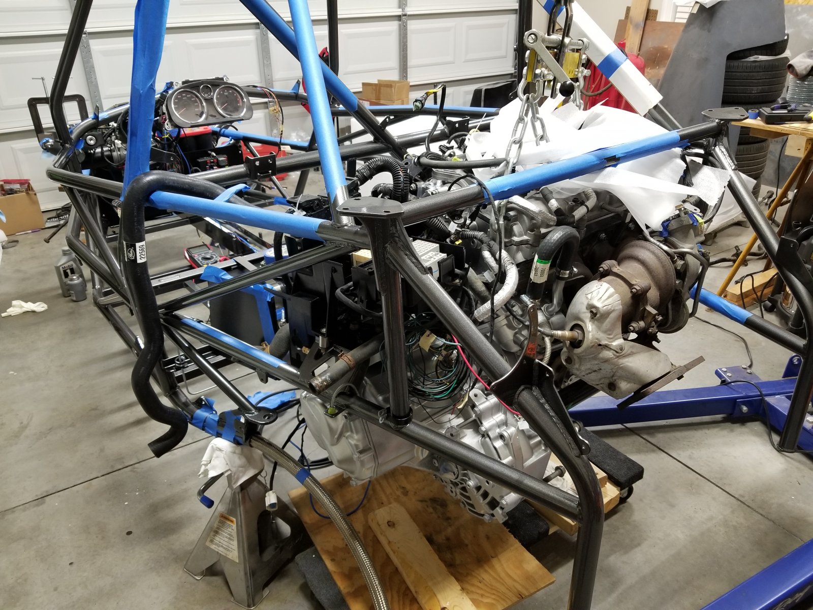

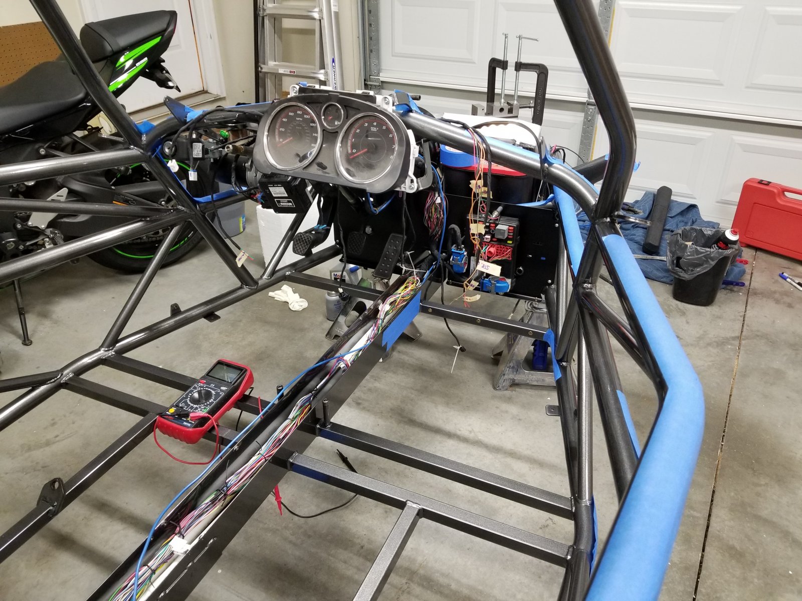

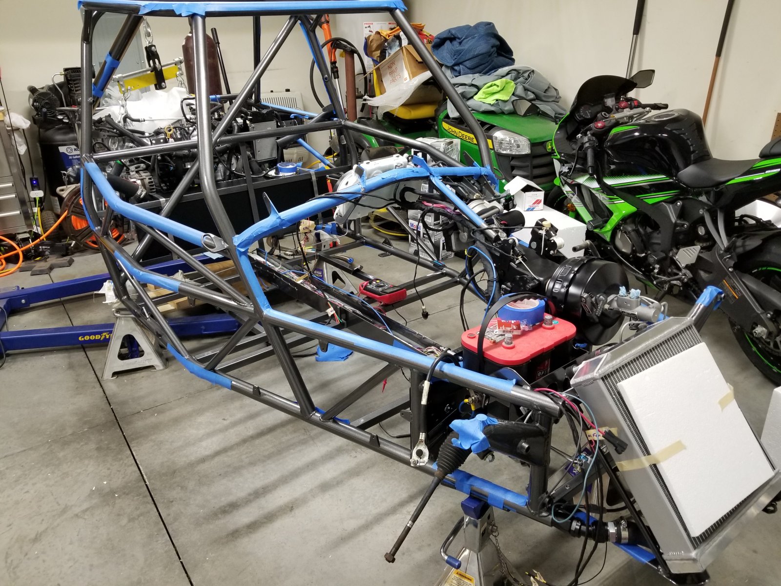

So far in the build process I have installed:
- all of the brake/clutch hard lines
- bulkhead panel
- radiator/fan
- wired in 2 pin deutsch connector, also on the harness side
- brake booster and master cylinder
- clutch master
- brake and clutch pedal assemblies
- steering rack, power steering unit, ignition switch
- rough routing of the wire harness
- BCM
- fuel tank, pump, filler neck
- gauge cluster
- drivetrain
- fuse box, ECU
- 16AN main water lines, about 75% complete ish

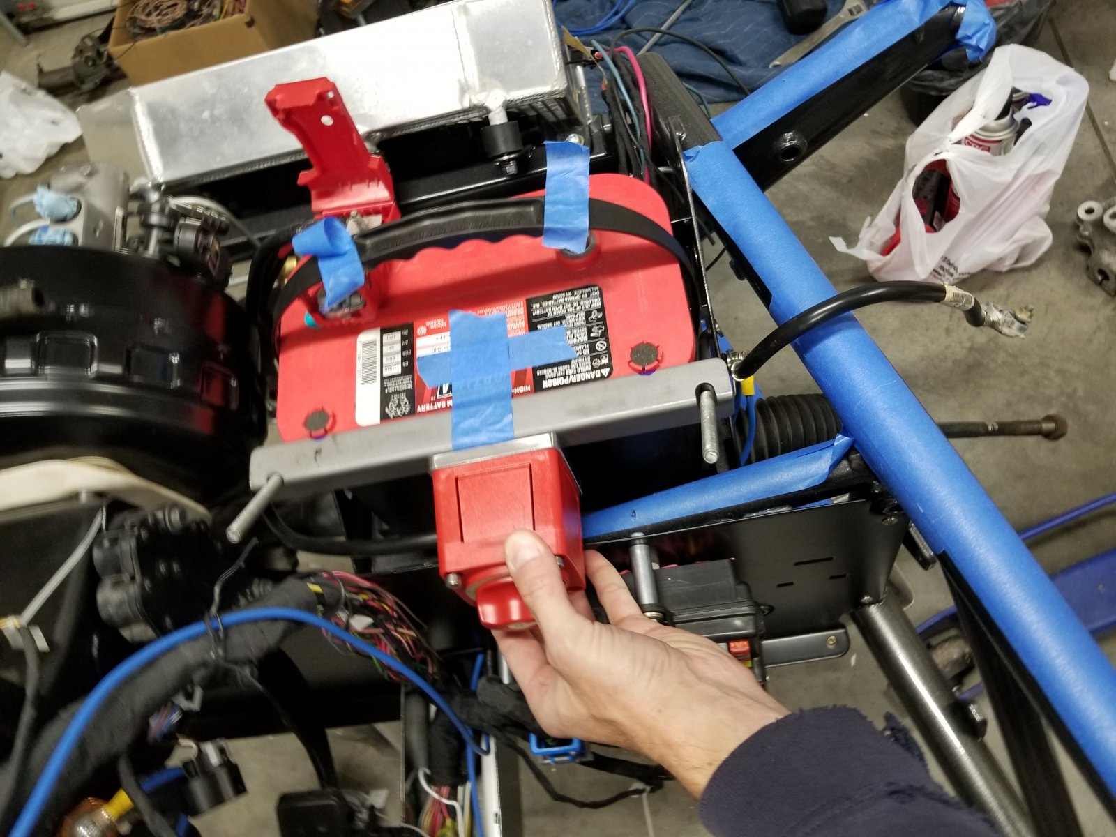

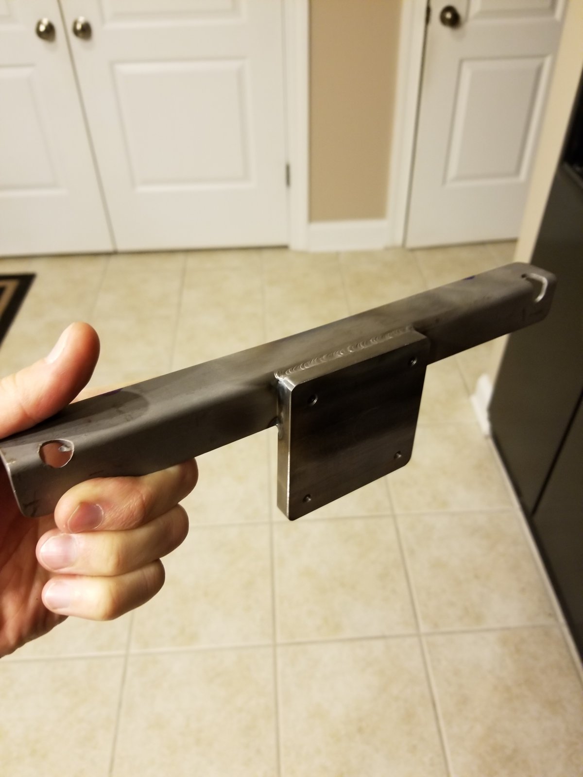

Minor update. I've been working on incorporating a battery disconnect switch to have a quick way to shut off power to the car when I'm going to wrench on it or if it's just going to be sitting a while. I don't have a fully installed photo yet as the battery tie down strap still needs to be painted.
19089
Welded plate for disconnect switch.

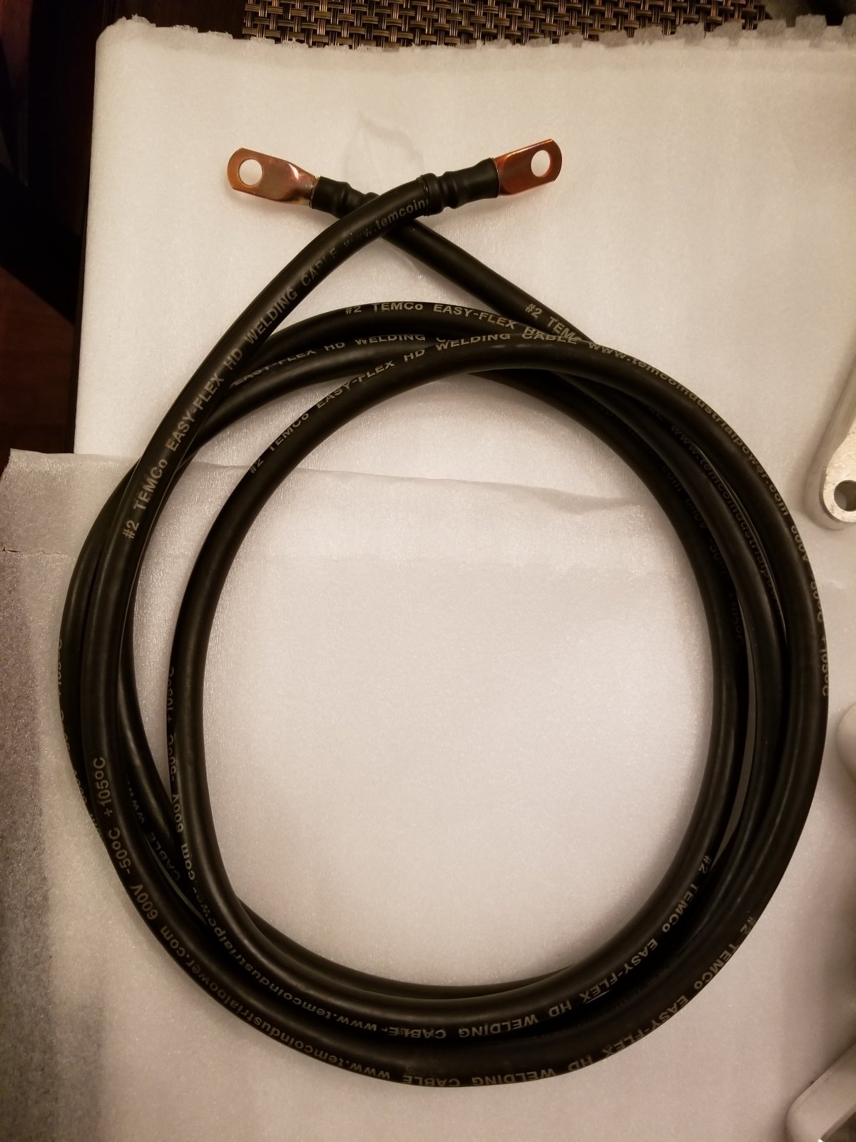

Ground cable (2 gauge) to run from front ground post at the battery to stud on the transmission. I performed the same crimp, solder, heat shrink on the positive cable connections.

That area of the car isn't super easy to get to in terms of emergency shutdown concerns. Especially if you're strapped in with a harness. I thought about adding a battery cutoff on the transmission tunnel but ended up not.
KSLunsfo
Yep, I thought about how well I would be able to reach down there while sitting in the driver's seat. I'm sure it will be tough if doable at all. However, I wasn't thinking too much of using it as an emergency shutoff and more just a nice feature for working on the car and saving the battery from trickling down if/when the car sits for extended periods.
