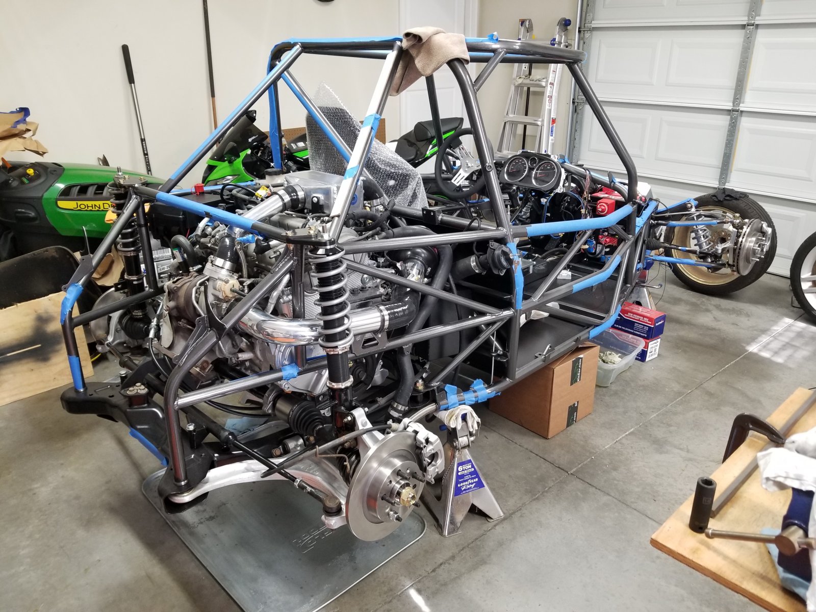

Figured I would come back with a more detailed update. I did get the car started up for the first time, it was good to hear it run after so long.
I got the AN main water lines finished off, ended up with 3x 120° -16 fittings and 1x 30° fitting (passenger front) all with AN to 1.25" barb adapters. I was able to use all DF provided hoses with this configuration, just had to cut them a bit more.

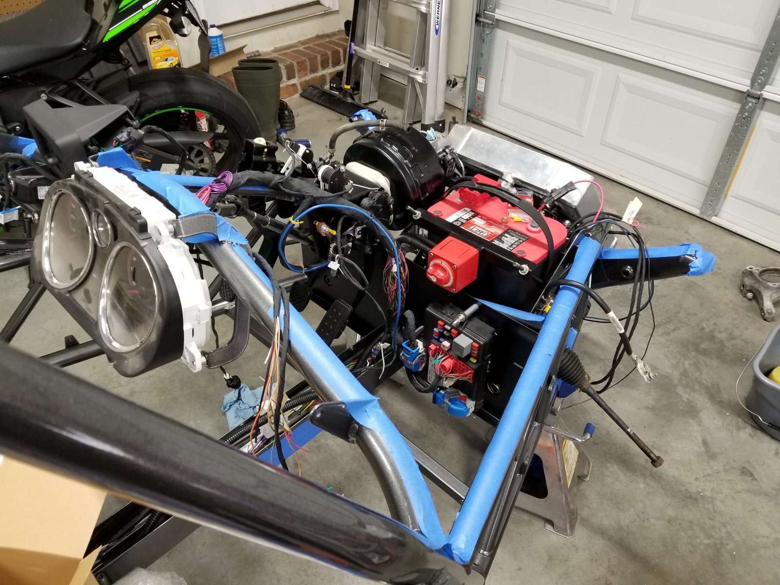

Finished the battery shutoff switch install:

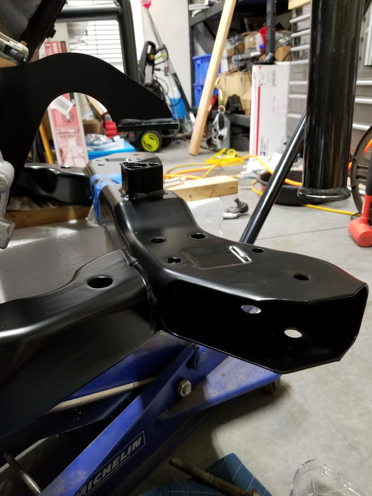

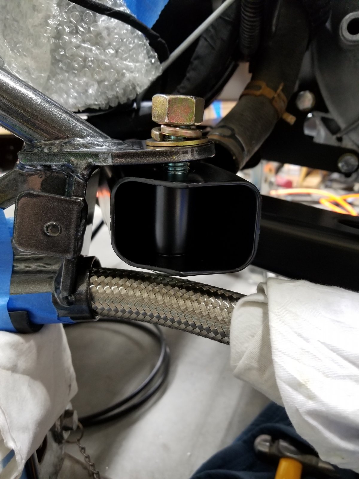

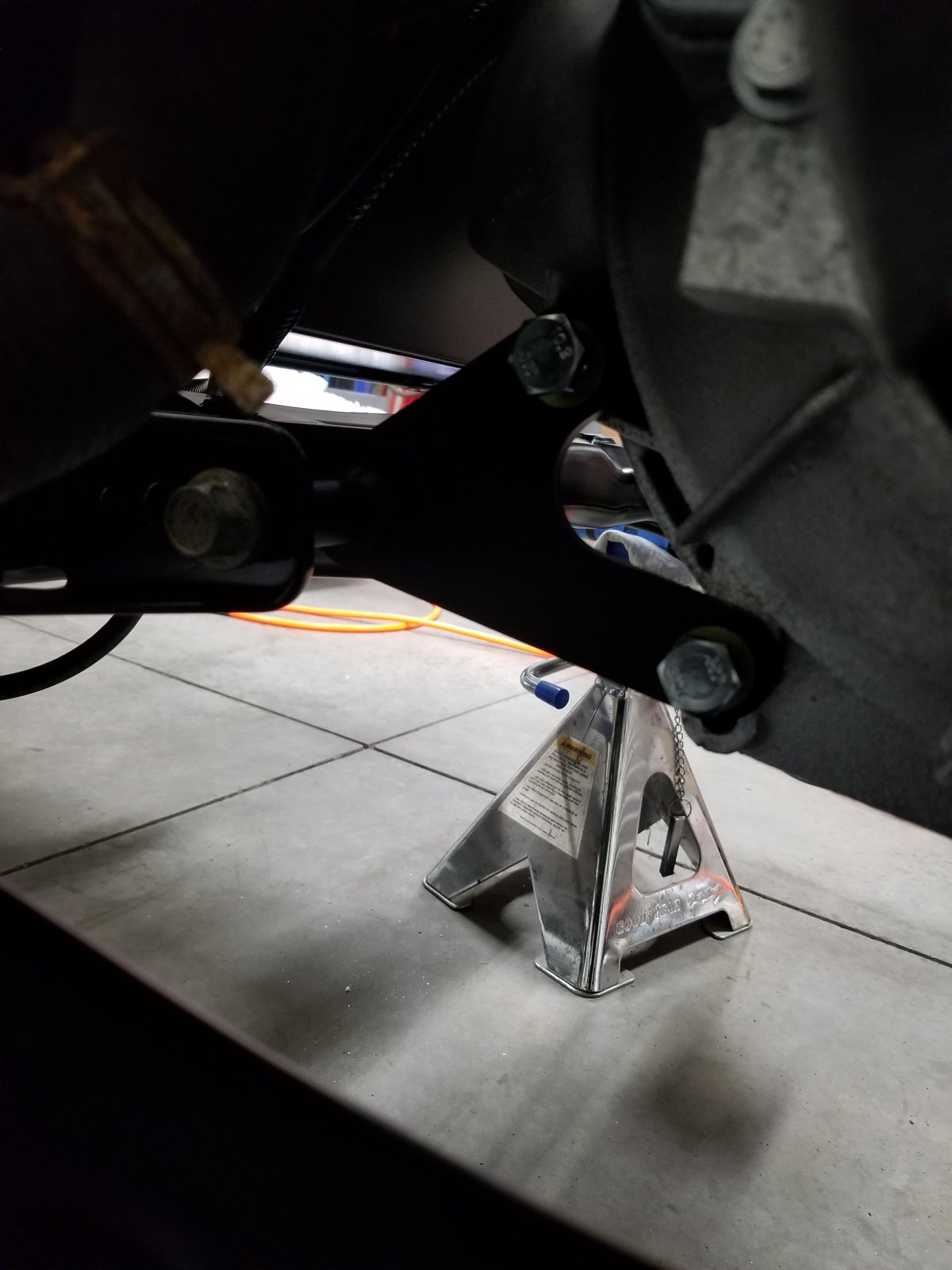

While installing the solid motor mounts it seemed to me as though the edge of the front mount was preventing the face of the plate from bolting up completely flush to the mount point on the transmission. So, I shaved a small amount off and hit it with a bit of primer and paint. Not sure if it's small enough that people haven't noticed it or just didn't care. Or somehow I'm a special case, which probably wouldn't be a new thing...

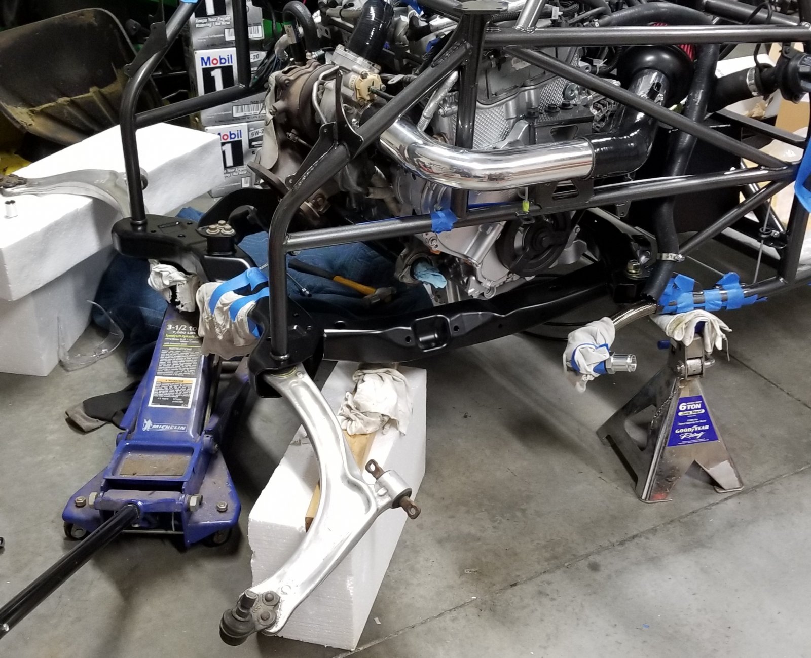

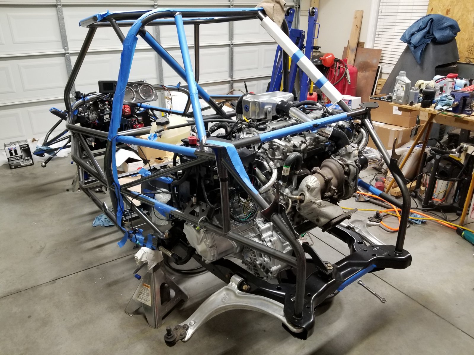

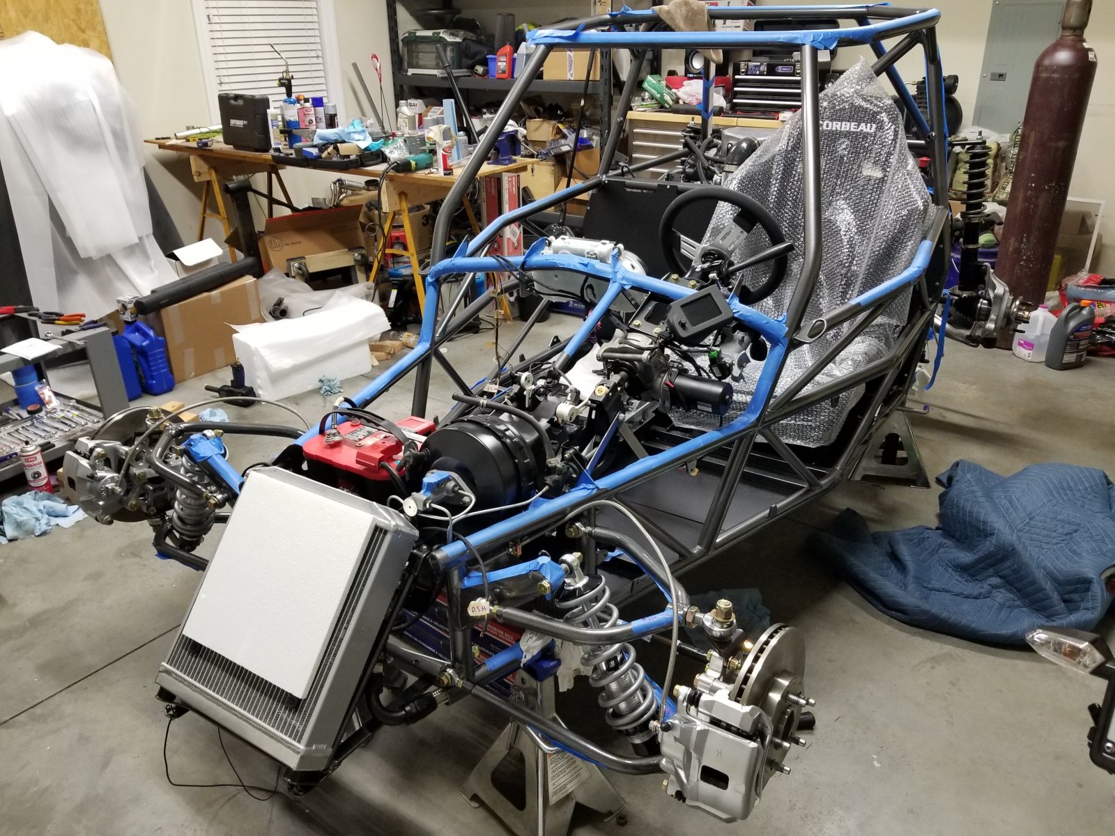

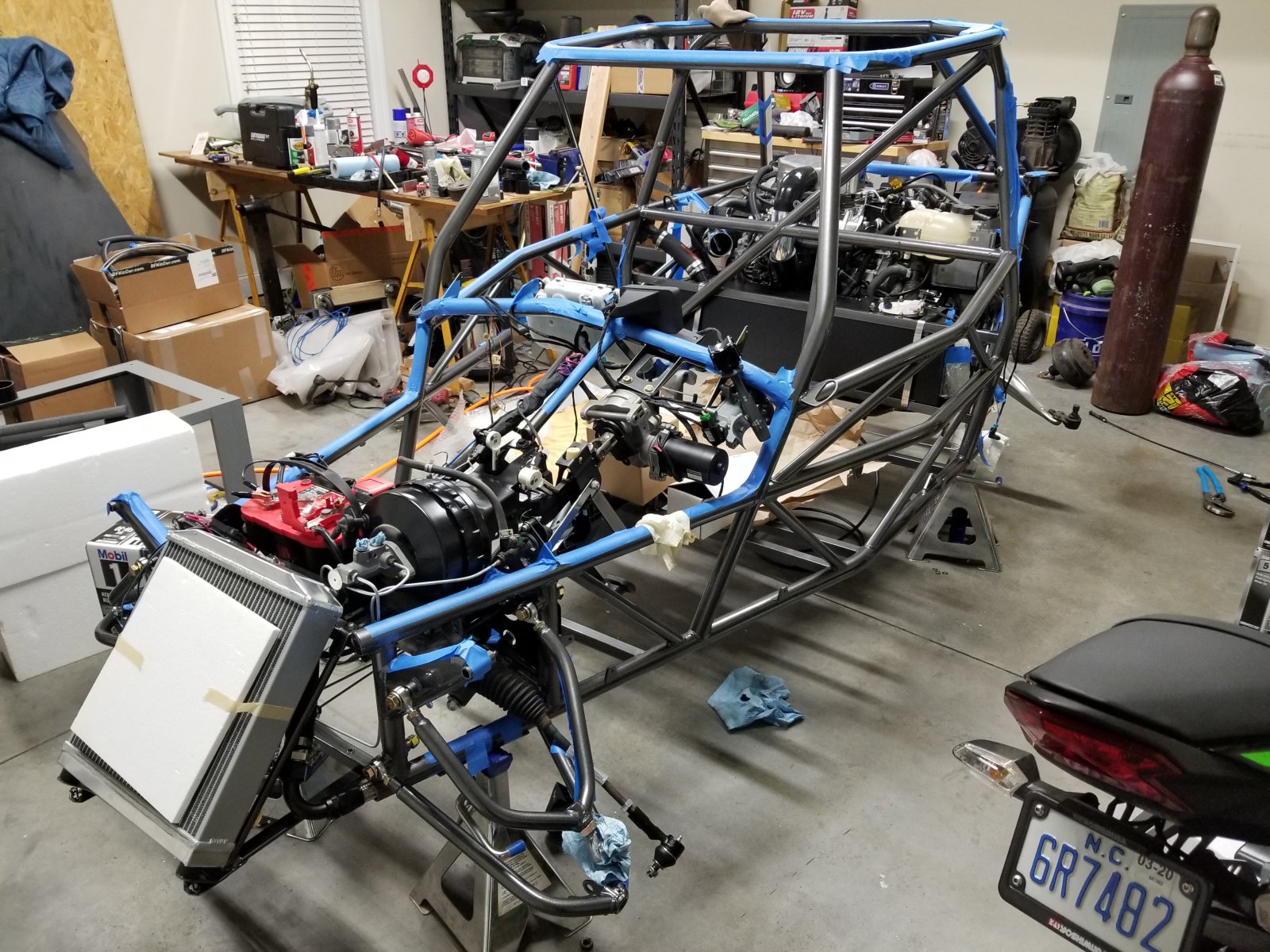

I struggled with installing the sub frame quite a bit, especially trying to do so without scratching up all of my fresh powder coat.
The process that ultimately worked for me (sort of highlighted with the following pictures):
1.) Mounted the sub frame by all 4 main bolts (all left loose)
2.) Supported the rear with a jack and removed the 2 rear bolts
3.) Installed the front solid mount (left loose)
4.) Installed the rear solid mount (left loose)
5.) Installed the rear 2 main bolts (the most difficult part by my 140lb self flexing the frame into place to get the bolts started)
6.) Torque all

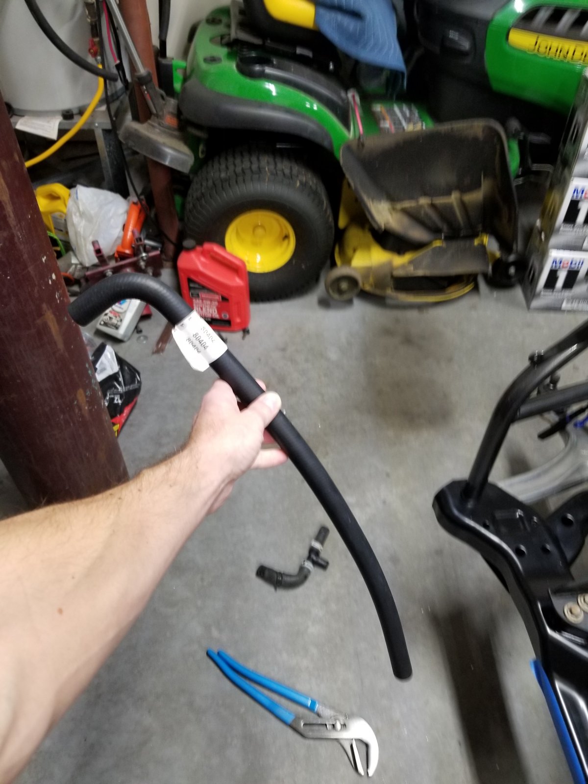

I used the following hose for the coolant reservoir. I had to cut several inches off the long end and a bit off the short end but seems to work well. There are other hoses that people have referenced here that I was going to try, the local auto store just didn't have those. This is a Dayco PN 80404.

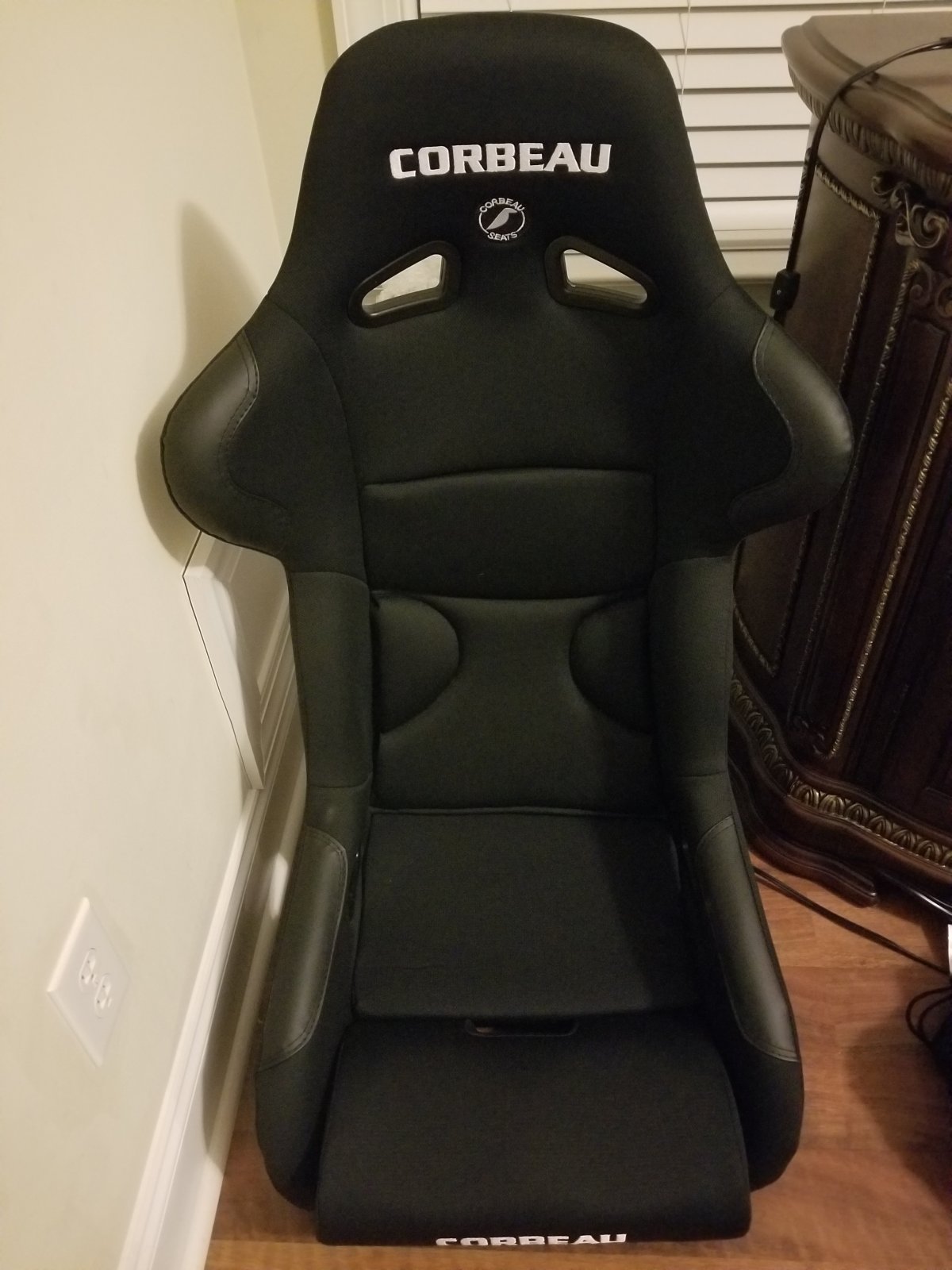

Received my Corbeus just a couple days after the first startup.

I finally see where you battery disconnect switch is located up at the battery box. Not sure how you will be activating the switch all the way up there with the hood in place, unless you do it with your toes?:rolleyes::D
KSLunsfo
Part of me wanted it sort of hidden anyway, but I did a test reach if you will (before permanently locating it)... leaning into the car from the passenger side I can easily reach it with my right hand.

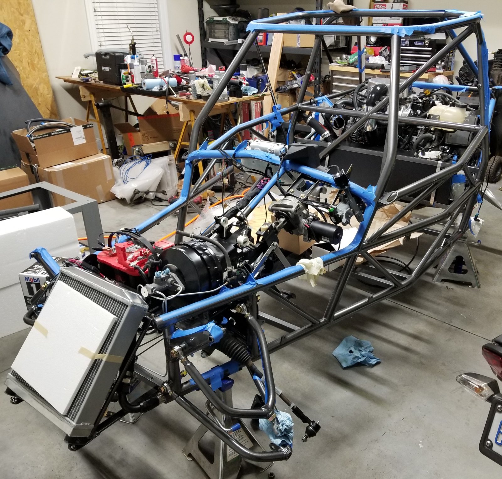

Next update...

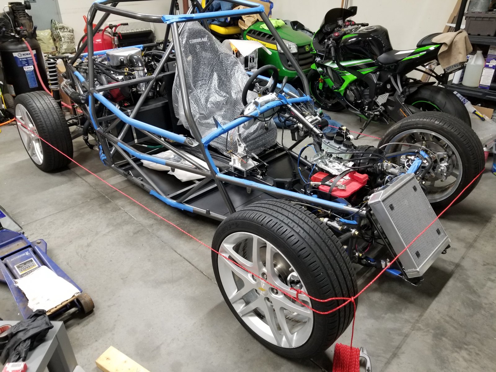

I've now installed suspension and brakes all around with lines connected, just need to get my hands on some line clamps now. I still have to install the parking brake cables, I opted to buy new cables @ ~$12 per cable from Rock Auto since mine were a bit rough.
Floor pans and firewall panels finally in, driver's seat loosely bolted in, steering wheel installed.

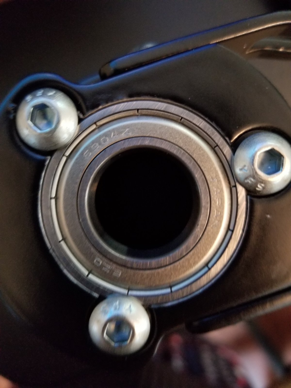

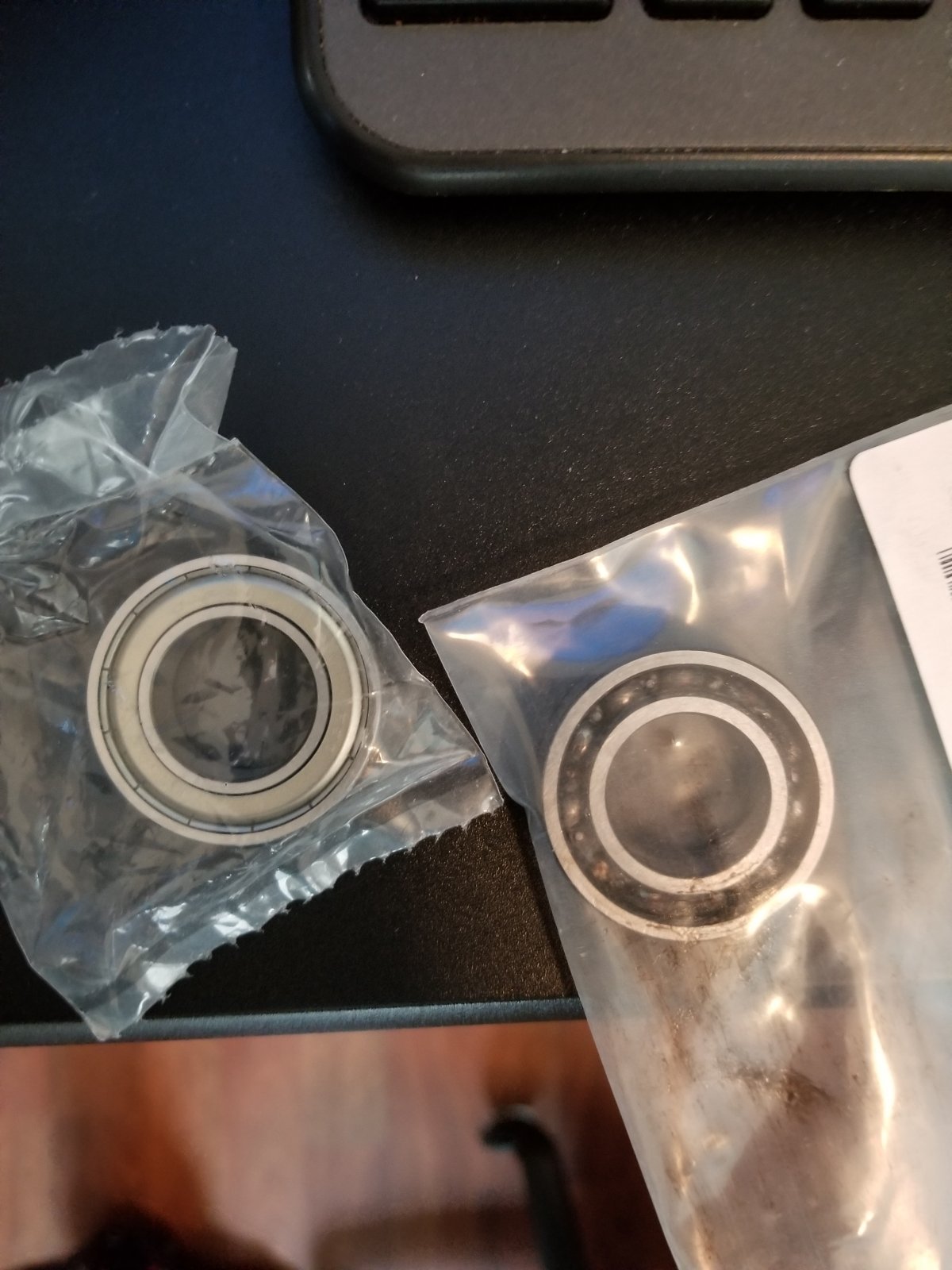

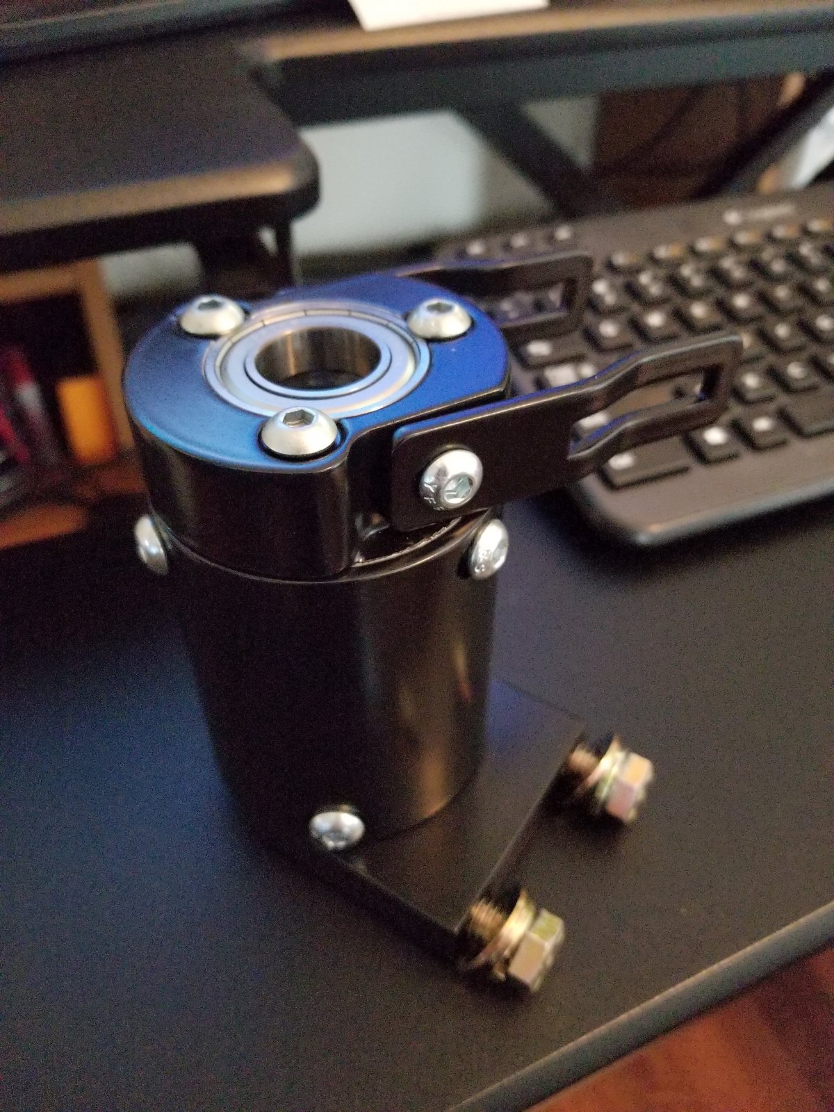

I didn't like that the ball bearings for the steering column were exposed, so I replaced it with a shielded bearing from McMaster Carr.

Next update...

Do you have steering column bearing PN?

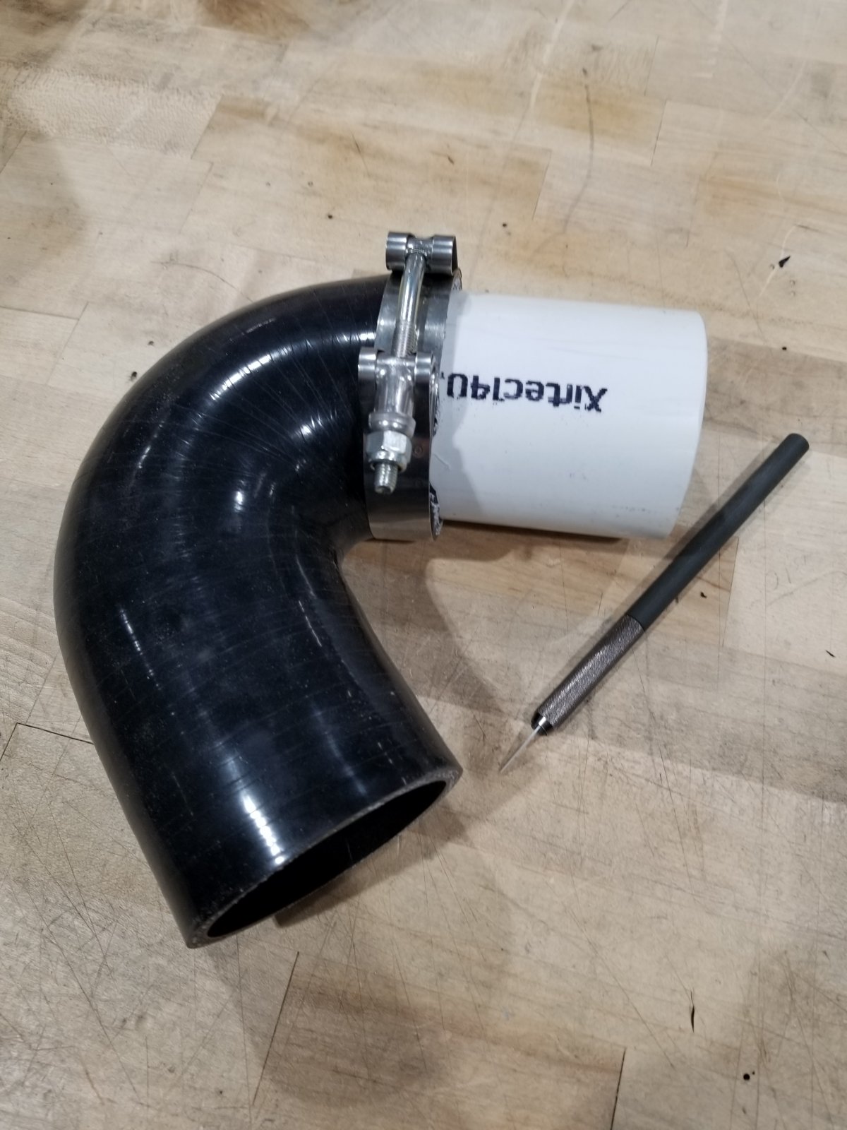

Also forgot to include this small tidbit.
A good way to cleanly and precisely cut couplers is using some round object (PVC in this case) matching the ID of the coupler, then tightening a clamp in place to use as a guide for your exacto knife or razor blade. I did this after getting the cut close and then this method allowed me to trim just a small amount more to get the throttle body elbow such that it's not rubbing on the fuel tank.

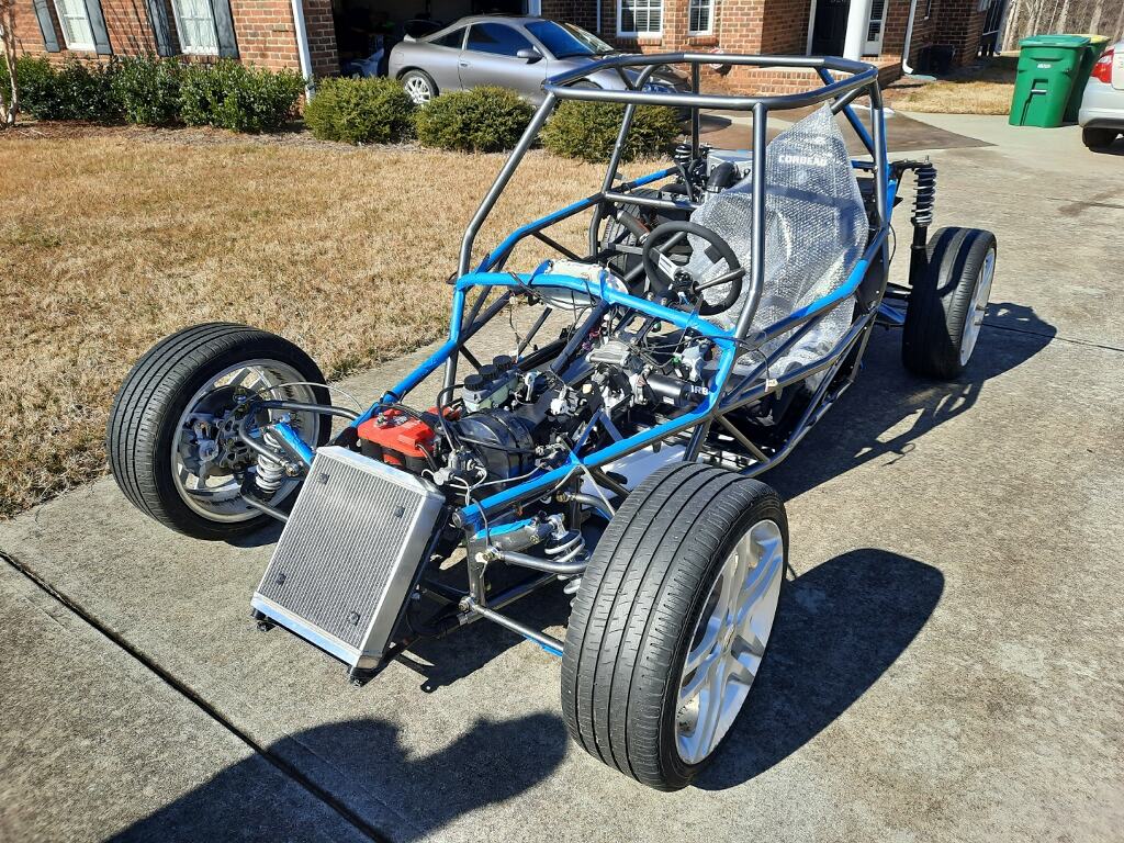

Got the remaining items knocked out to get to first drive...

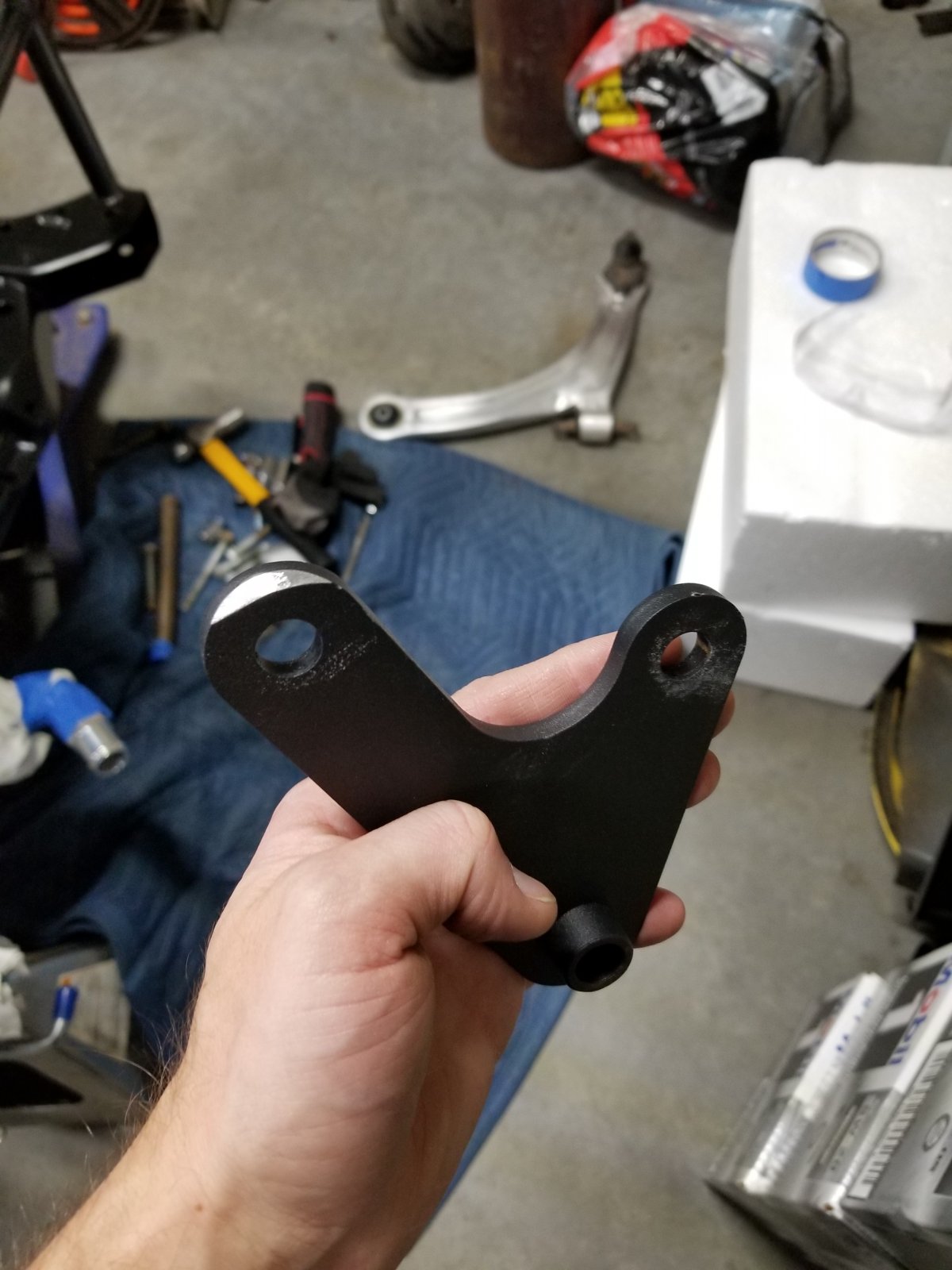

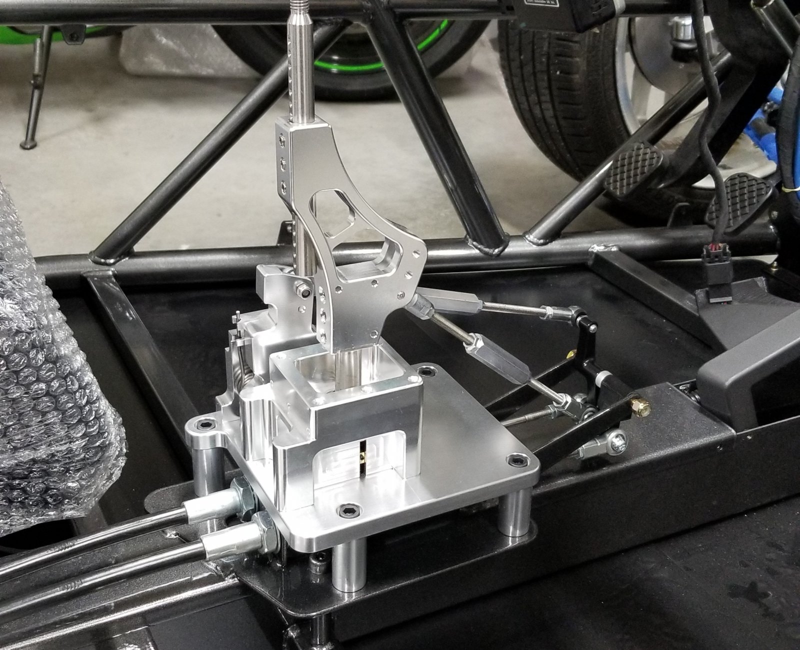

Tilton reservoir installed using OptimiePrime's 3D printed bracket.
Ktuned shifter installed and operating on a 3D printed prototype custom 'non-reversing' lever for the front/back motion. I Intend on making a permanent steel version in the not so distant future.

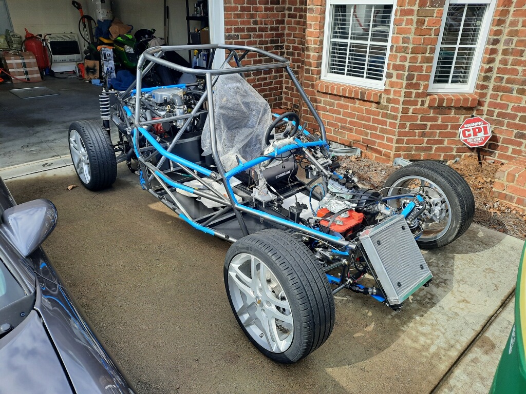

Had the alignment pretty close (relatively speaking) before ever setting it on the ground, just a couple turns of all tie rods with a cord and the car seems to track perfectly straight already. I will get in a more thorough alignment job in the coming weeks/months.
Got the car on wheels for the very first time and completed the first mile of driving.
Drove in first and second gear and even got a tiny bit of boost in. And already excited a large group of kids in the neighborhood with my oversized go cart.
So far the only negative I can say is brakes, which is unusually common here it seems. I'm not sure if it has something to do the brand/manufacturer of the calipers or what. But it seems I have a very slow leak at one of the front bleeders, any tighter and I feel like I'll risk stripping the threads. Also, the pedal doesn't seem to do much until the very bottom of the pedal travel. However, it's probably safe to say I still need to do some bleeding on the brakes. I am also not currently using the vacuum assist at all on the booster, the port on the intake manifold is plugged and not connected to the booster.

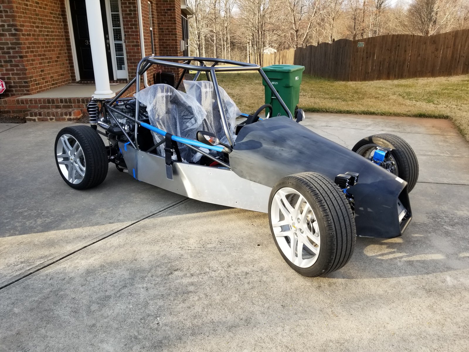

Guess an update is well overdue...
I received my Montana tag just shy of a month ago and have since drove back and forth to work numerous times, through various fast food drive-thrus, short visits to a few different stores etc. I would roughly estimate I've logged just under 100 miles or so since being registered. I've even been bold enough for a couple really short trips on the interstate. So far I'm LOVING it. I will briefly outline my Montana registration experience in another post.
I've completed the following since the last update in no particular order. I've also left off many smaller, less notable actions.

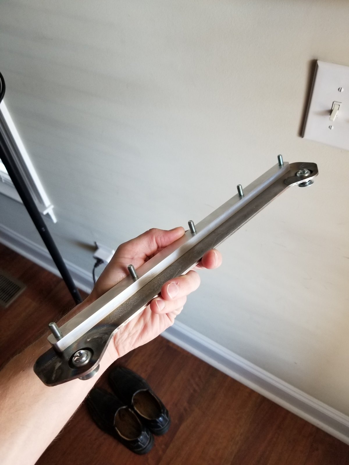

-Installed remaining firewall panels/hood/side panels (made threaded 'sandwhiching' bar for bolting on the DZUS plate to the hood)

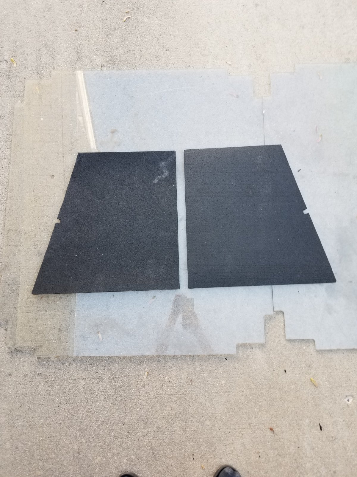

-Cut custom rubber floor mats

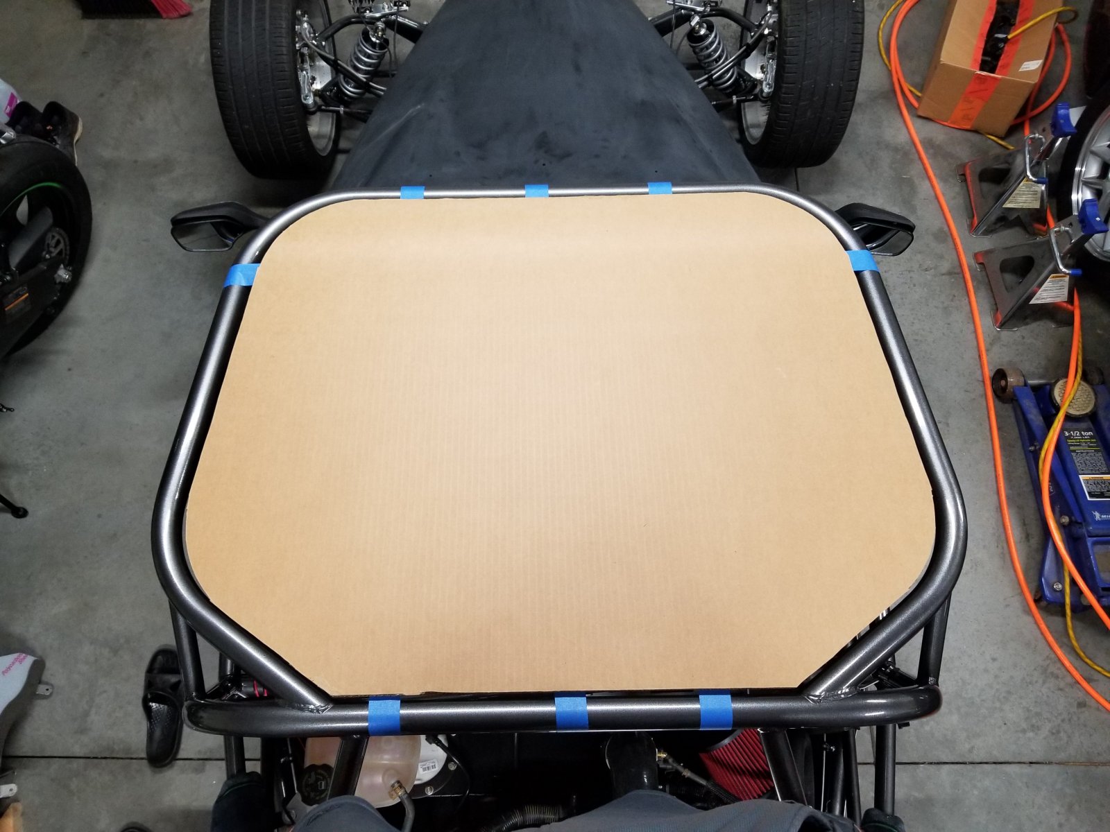

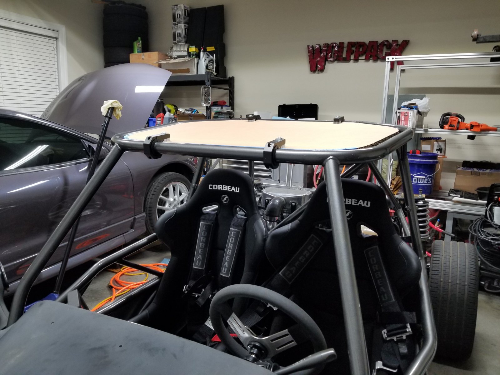

-Made prototype cardboard roof (considering smoked polycarbonate for permanent roof)

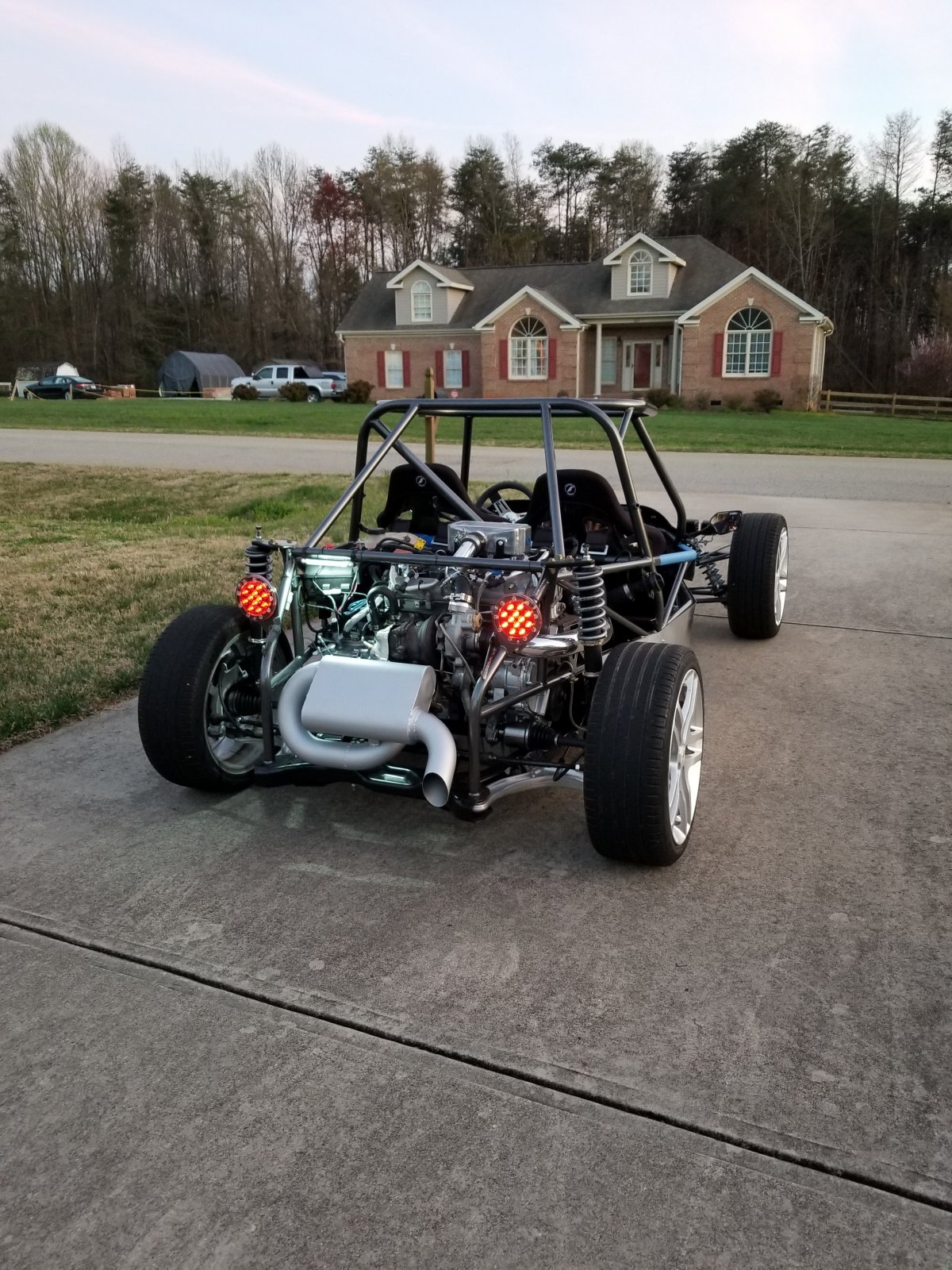

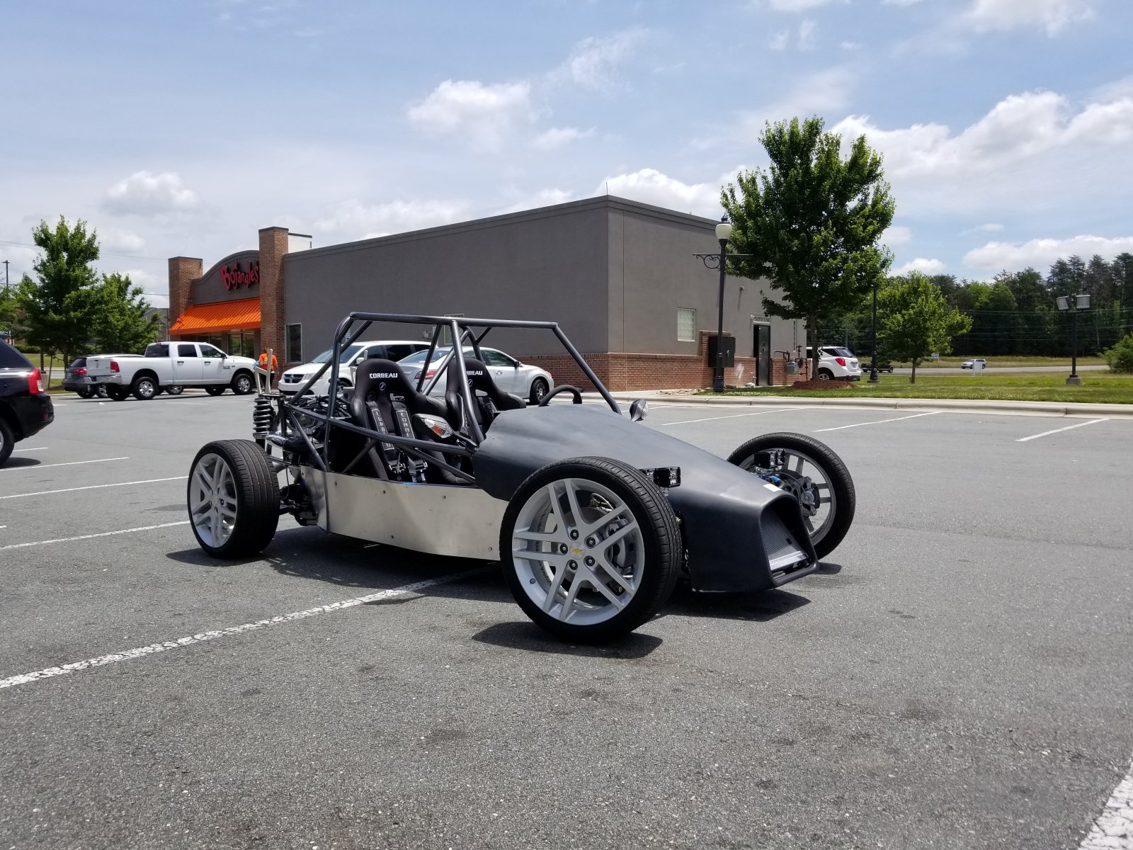

Very first road drive was to a Bojangles.

0.5" gym type rubber mat material.

DZUS bar goes on the underside of the hood, threaded "sandwiching" bar goes inside the hood. Threads are M6.

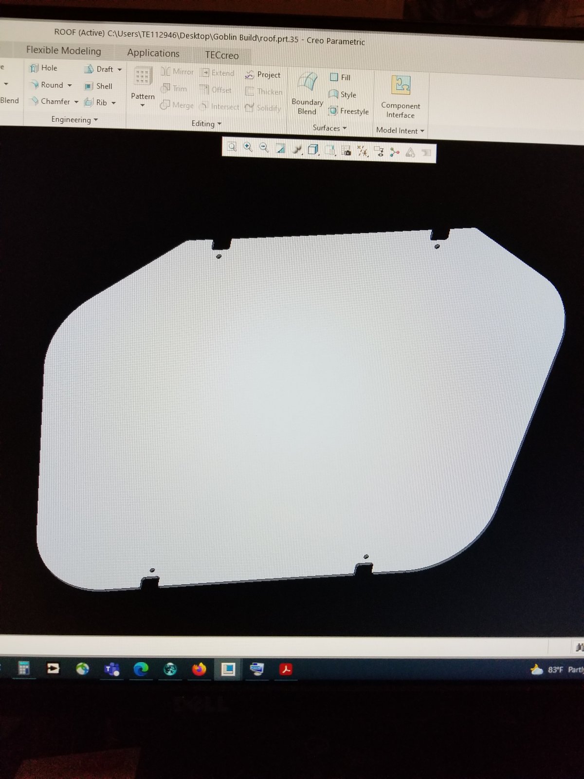

CAD.... meet CAD....
25008
25009
Came out short on the width due to a mistake in cutting it out, but the 3D model should be spot on. Some may find it interesting that this double layer cardboard roof is surprisingly solid at 80mph.... Over half of my miles have been with this temporary roof.
