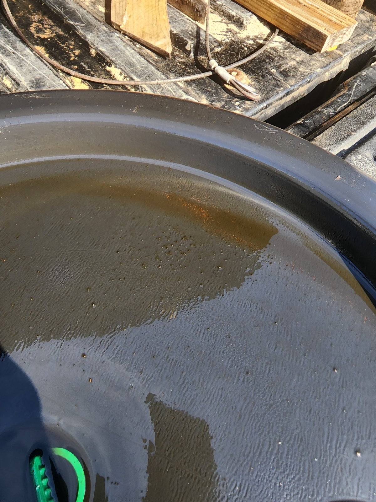

Good news and bad news. If I was back panning for gold in Alaska it's time to bring in the hoe.. But if checking for bearing material in oil it's time to pull the motor...
95Blitz
Does a magnet pick the pieces up? If not it is likely bearing material or aluminum pieces. If not it could be timing chain pieces. Either way it's not good.
It looked like copper.. just check not magnetic.
