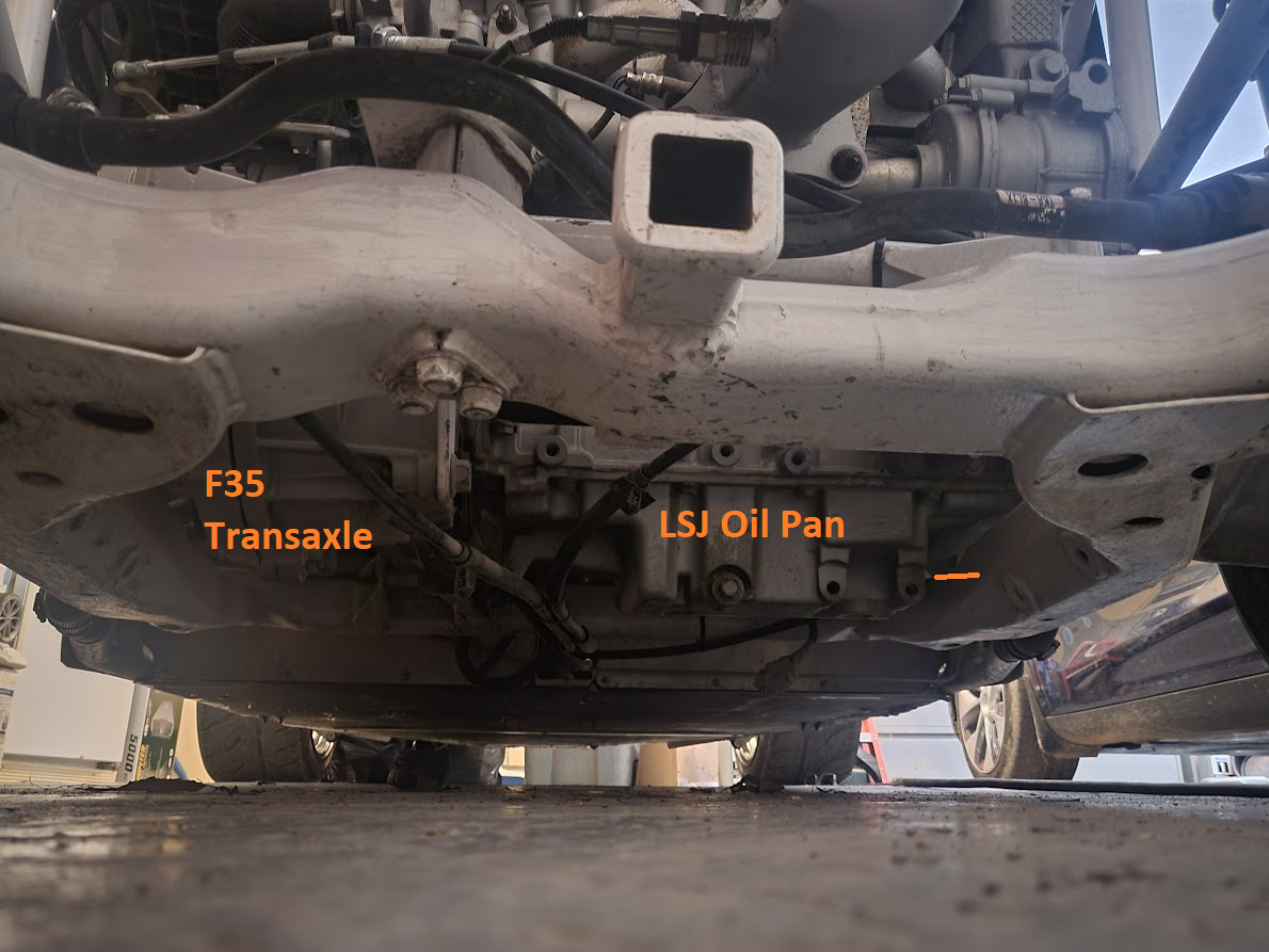

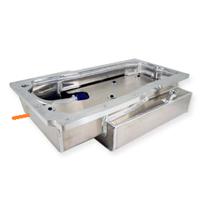

Well, the motor is out to swap the clutch and transmission and I've fallen into a bunch of while I'm here questions. Cams, valve springs, deletes, but mainly I know it's recommended to swap the oil pan for an LDK pan to help with slosh. But does anyone know if the CBM sheet metal pan fits on a factory subframe, I unfortunately didn't measure with my motor in the car and they aren't sure if it works due to them mainly using it on one-off sand rails. I spoke to them today, it's built to order and I dont want to wait to put this thing back together and then it doesn't fit for some reason.
Based on the photos on the CBM website: the Cobalt subframe, there is plenty of room to accommodate the side extensions of the CBM oil pan. There is at least 4 inches in the front of the engine and more than 12 inches of space at the rear. Not certain how far below the stock oil pan dimensions this custom pan extends, can't tell from the photos. But the stock oil pan sits nearly level with the bottom of the subframe rail - personally I wouldn't want the oil pan extending below that level.
You shouldn't have a problem.
38171
The orange line is the closest point to the Cobalt frame, and I can fit 2 fingers in there, so over 1" of space. The other sides have lots of room.
That orange line is on the side of the pan that hasn't expanded, so no issues.
