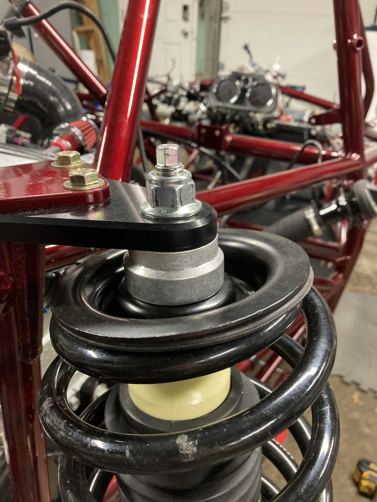

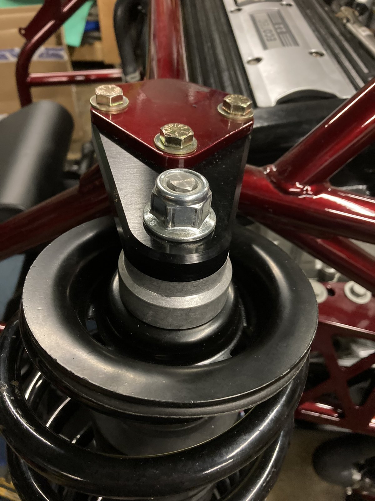

Yeah, both times. LolDid you modify the spring at all, or just keep the stock spring height?

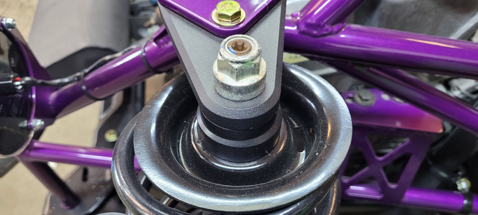

No, they don't. It has a hex head instead of a socket torx like yours. I'll play around with it and see if I can get more of the threads to engage.The stock struts have threads all the way to the end and lock into the nylon. It looks like yours may not. I would be concerned.
