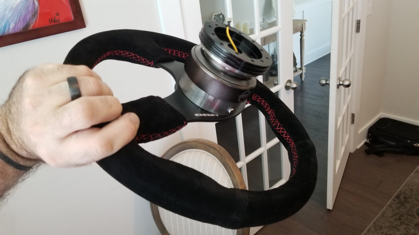

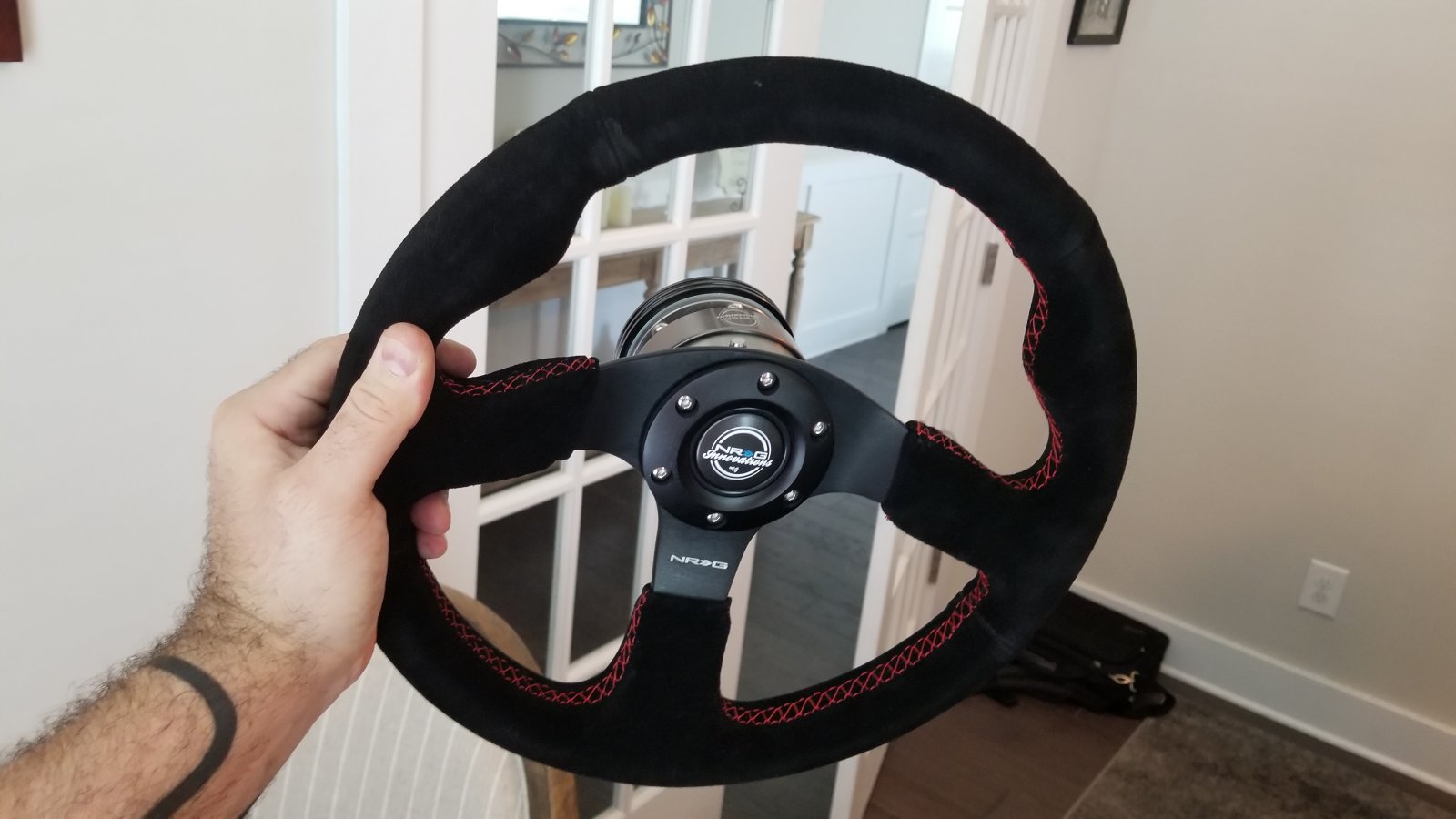

Got a red stitched Suede NRG wheel and gen 2 quick disconnect, with a 6 to 3 adapter.
Absolutely love it.

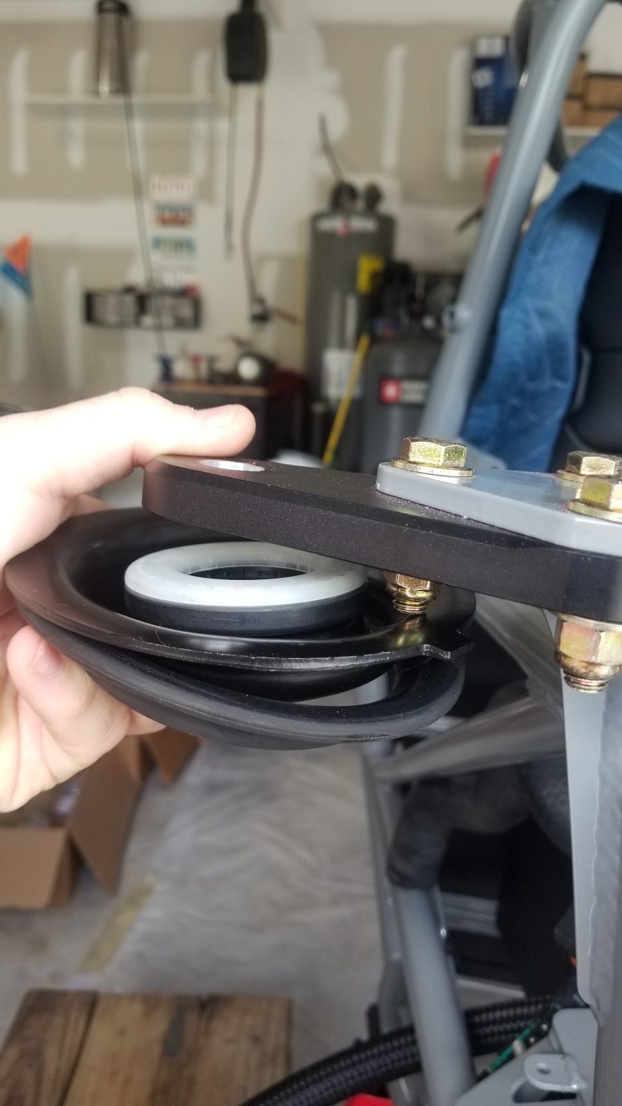

I'm installing my new suspension from Ark, but there aren't any DF instructions that I can find for the stock Cobalt suspension. I know plenty of you have done it but it looks like I may be missing a spacer for the top of the struts?
Can someone tell me if there's something that goes on top of the stock struts?

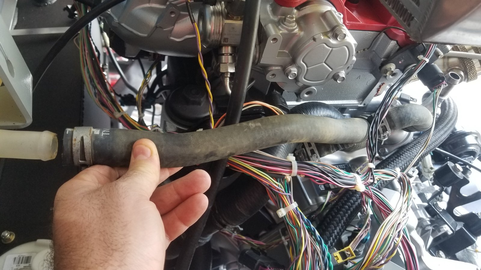

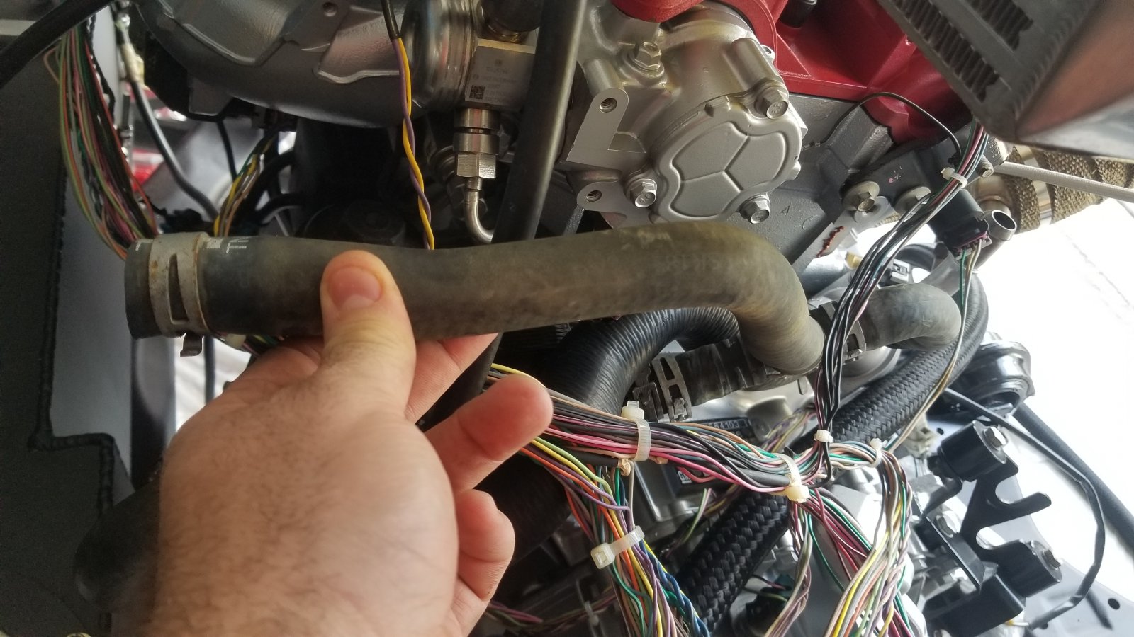

Also this hose doesn't fit to the coolant res tank from the thermostat, am I supposed to buy a new hose or is this supplied? I don't think I received a hose this size and I can't remember being told to buy something.

Looking at pictures, it looks like there should be a spacer.
cant help you on the coolant hose. Probably need some bulk hose.

Yeah, I think I'm missing a piece? I have the coilover suspension adapters I paid 50 bucks for but nothing for the stock ones.
I'm guessing because I got the coilover adapters that I didn't get the stock ones. Makes sense but I need the stock ones.

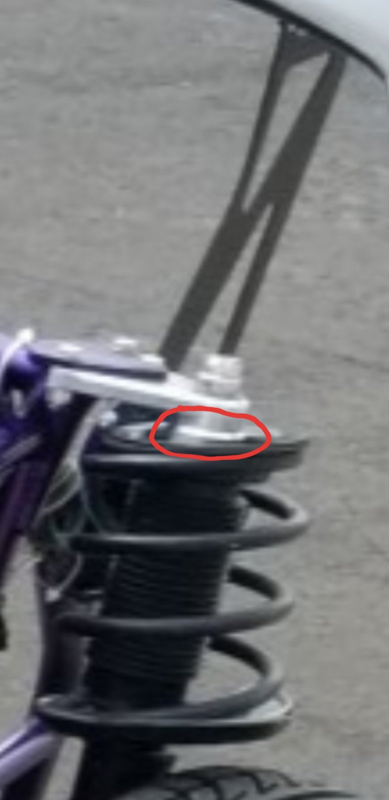

Alex stopped by with his Goblin so I took a picture for you
