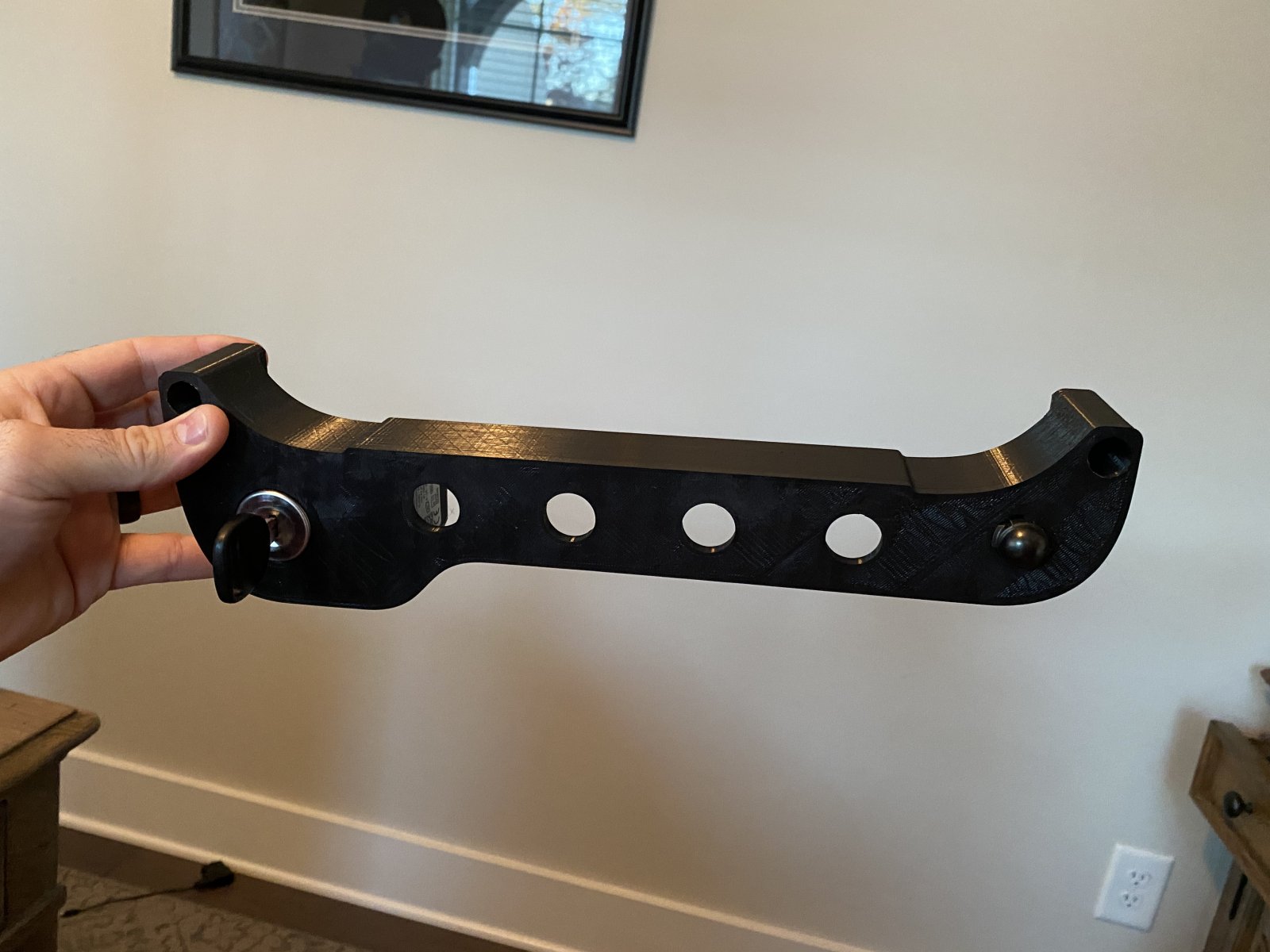

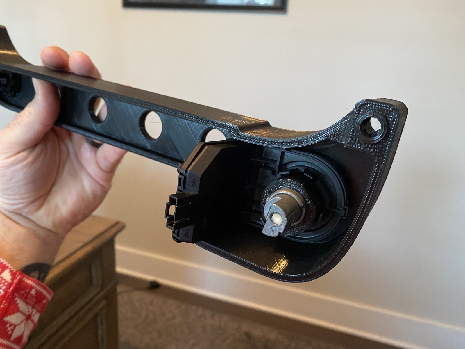

Also, I made this snazzy little ignition placeholder for my @bradr ignition bypass... I still need the key to bypass VATs but I am going push start with his little piece... key goes in to satisfy VATs, then I'll have one toggle button for ON and another momentary button for START. Pretty happy with the fitment, it looks slick.
