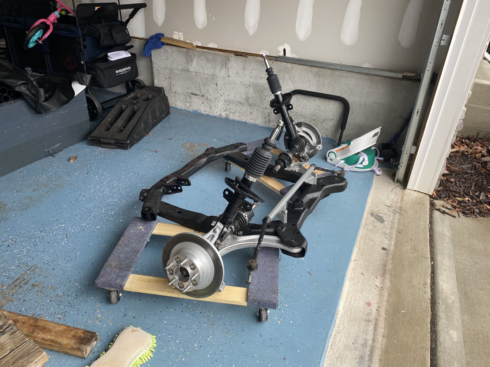

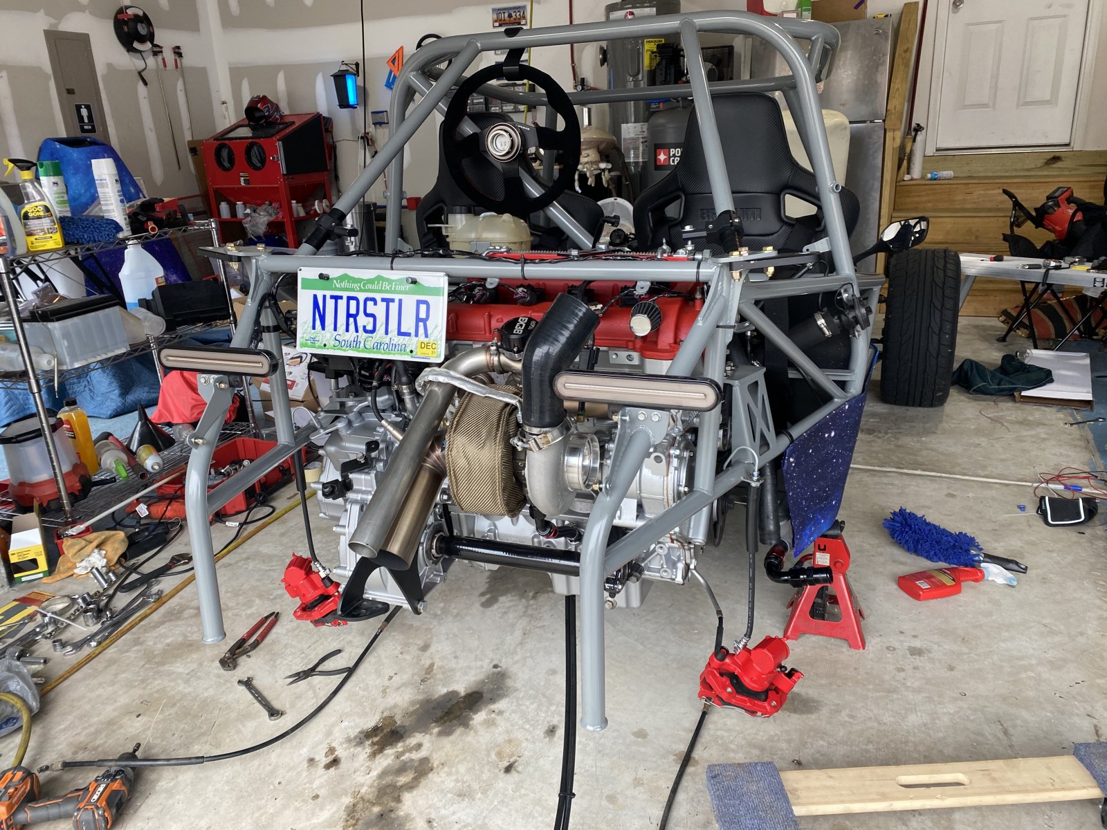

Yesterday I started to pull the motor to fix my leaking RMS (assuming it's that). I got as far as getting the subfame/suspension off and unhooked everything off the motor and drained fluids. Wednesday I plan on pulling it and assessing where my oil leak is.
I've been talking to a speed shop in Taylorsville, NC about tuning... so it looks like I may be heading up to Redemption Garage on Presidents' day (Federal Holiday so I have it off). He said to estimate about max ~375ish to the wheels so I'll be pleased if it's near/around there.
I'm hoping to have the RMS (or whatever issue it is) fixed and smoked tested before then, 2 weeks countdown started yesterday!

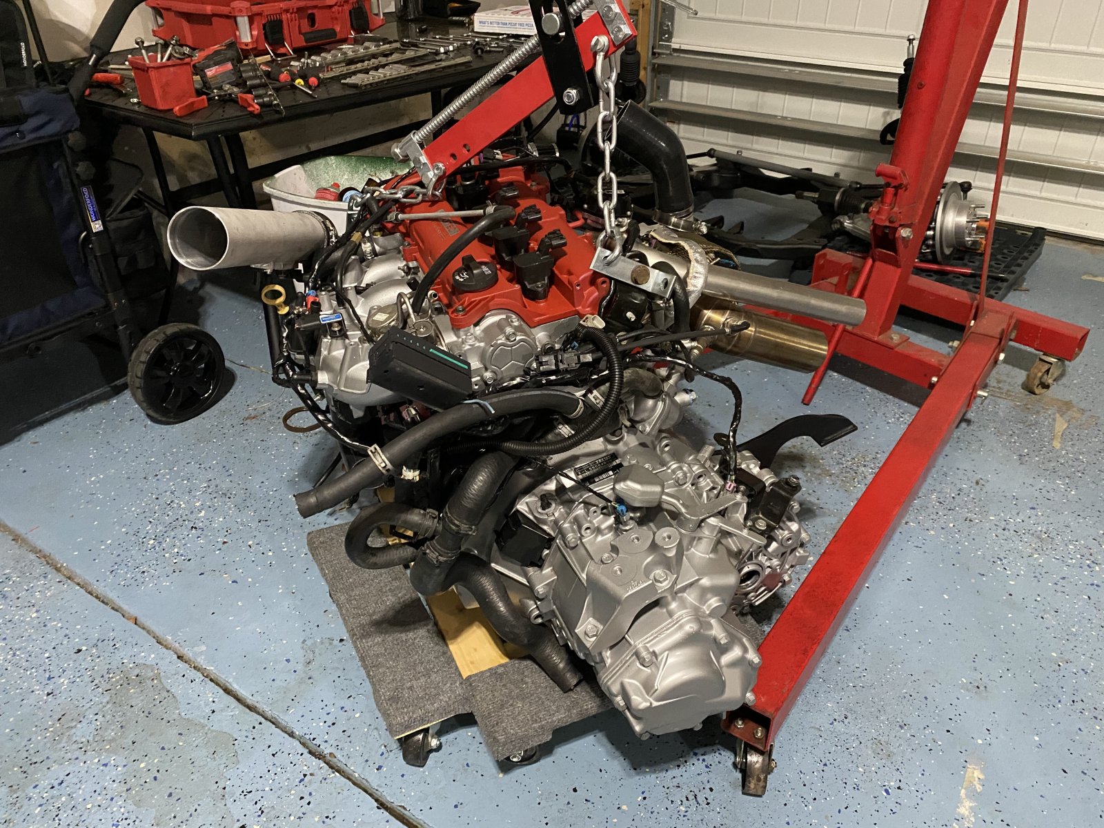

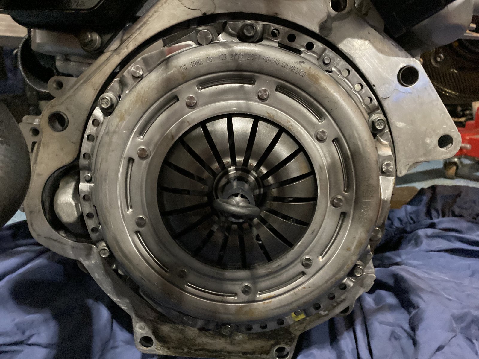

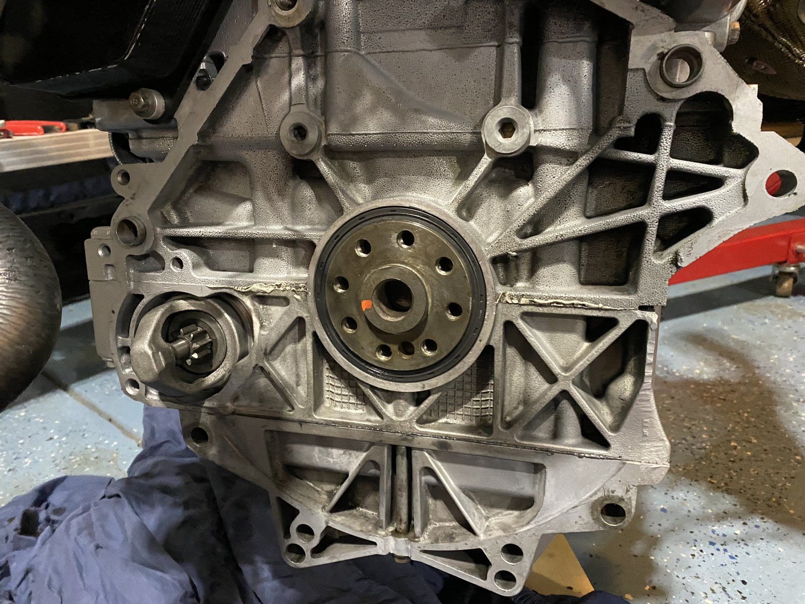

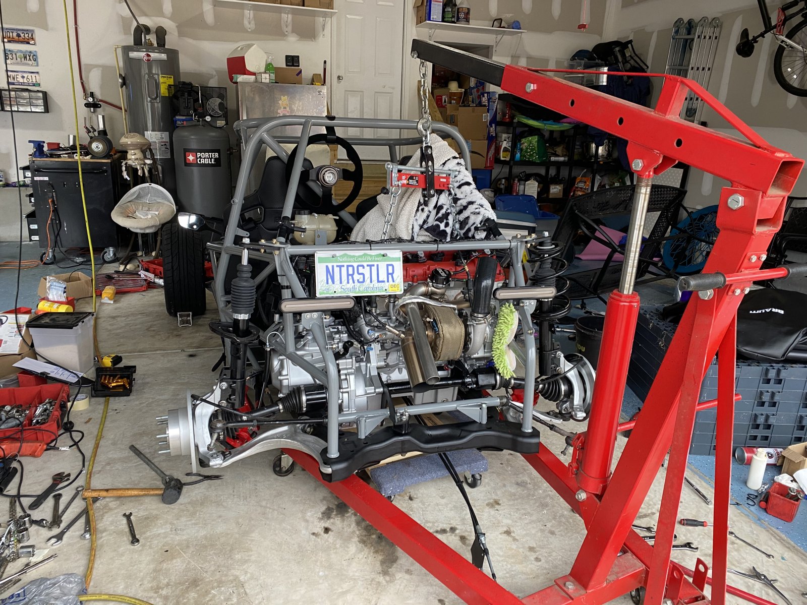

Got the motor out last night and swapped the RMS with a new one. Everything was covered in oil and I saw no clear indicator of it being due to the RMS, but that's the only place it could have come from. The oil pan seal appeared to be well seated, too.
Hoping to put the engine back in this weekend.
Edit: My garage is an absolute disaster - don't judge me.

Not to intentionally ask a possibly dumb question, but you're sure it's oil and not gear oil right?
Also, try to check that you're not pressurizing your crankcase somehow. That will almost always result in leaking seals. Not sure how much time you've spent in boost yet so this may be N/A.
Mayor West
I'm more certain of it being engine oil than gear oil, but I guess I'm not 100% either way. I know it's not DOT3. The RMS seal was not dry, further leading me to believe it's the RMS... if it were gear oil it'd have to travel from the input shaft all the way past the clutch/flywheel to that area which I find incredibly unlikely. I did notice it may not have been completely seated, so I made sure the new one was perfectly flush... I guess I overlooked this when I first changed it.
The most boost I've seen is just a few PSI here and there, I've yet to spend more than a second or two into it. I have a breather filter on the valve cover as well, although that isn't the same as a proper set up. I've only put maybe 40 miles total since finishing.
If it continues to happen I'll revisit this. I have only put a few miles on everything, and prior to my disassembly of the donor vehicle all I did was idle/rev it (I never drove it) so the condition of the transmission is an unknown variable.
