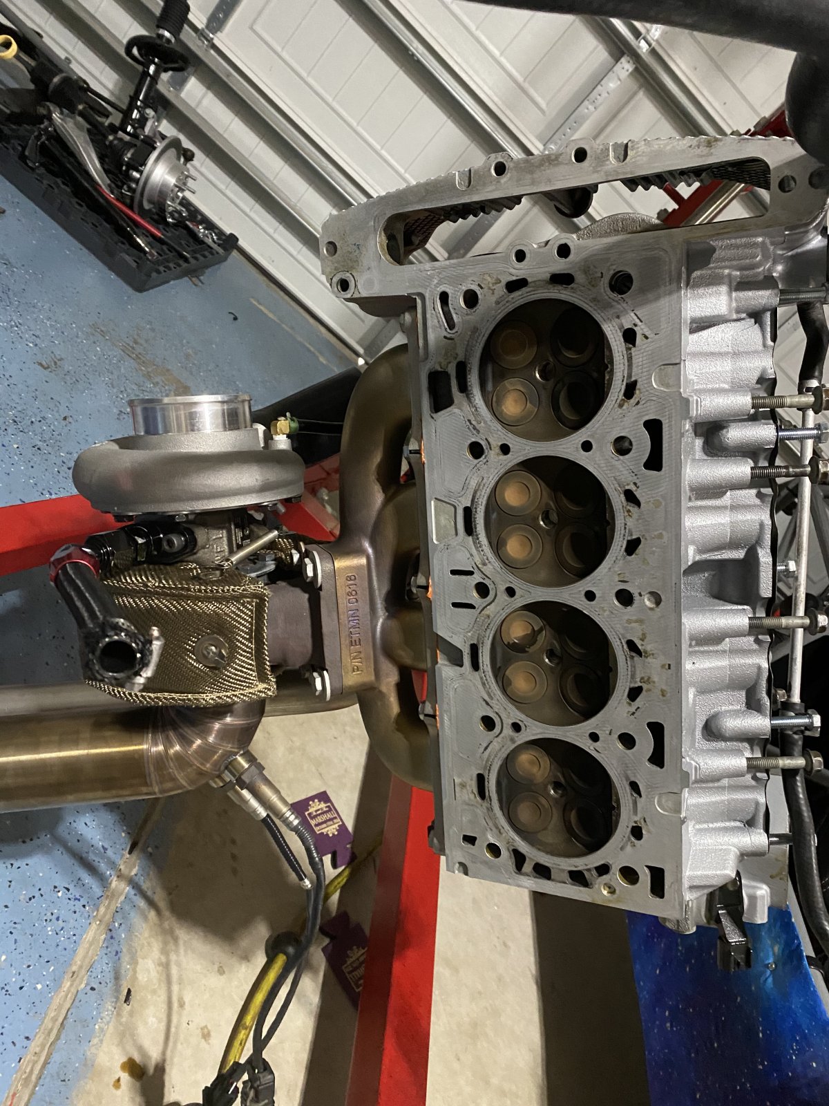

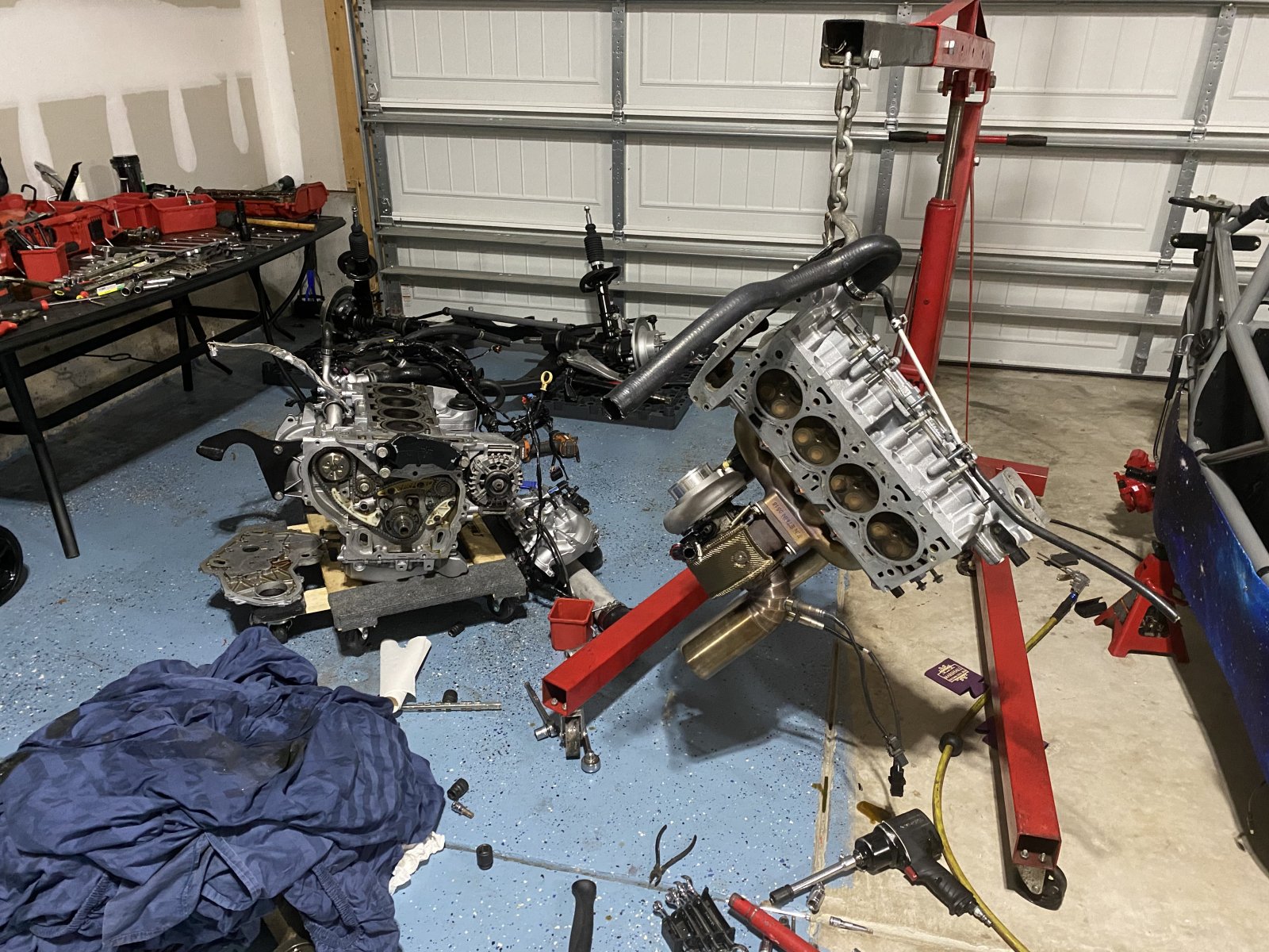

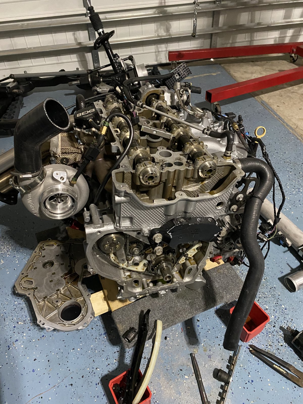

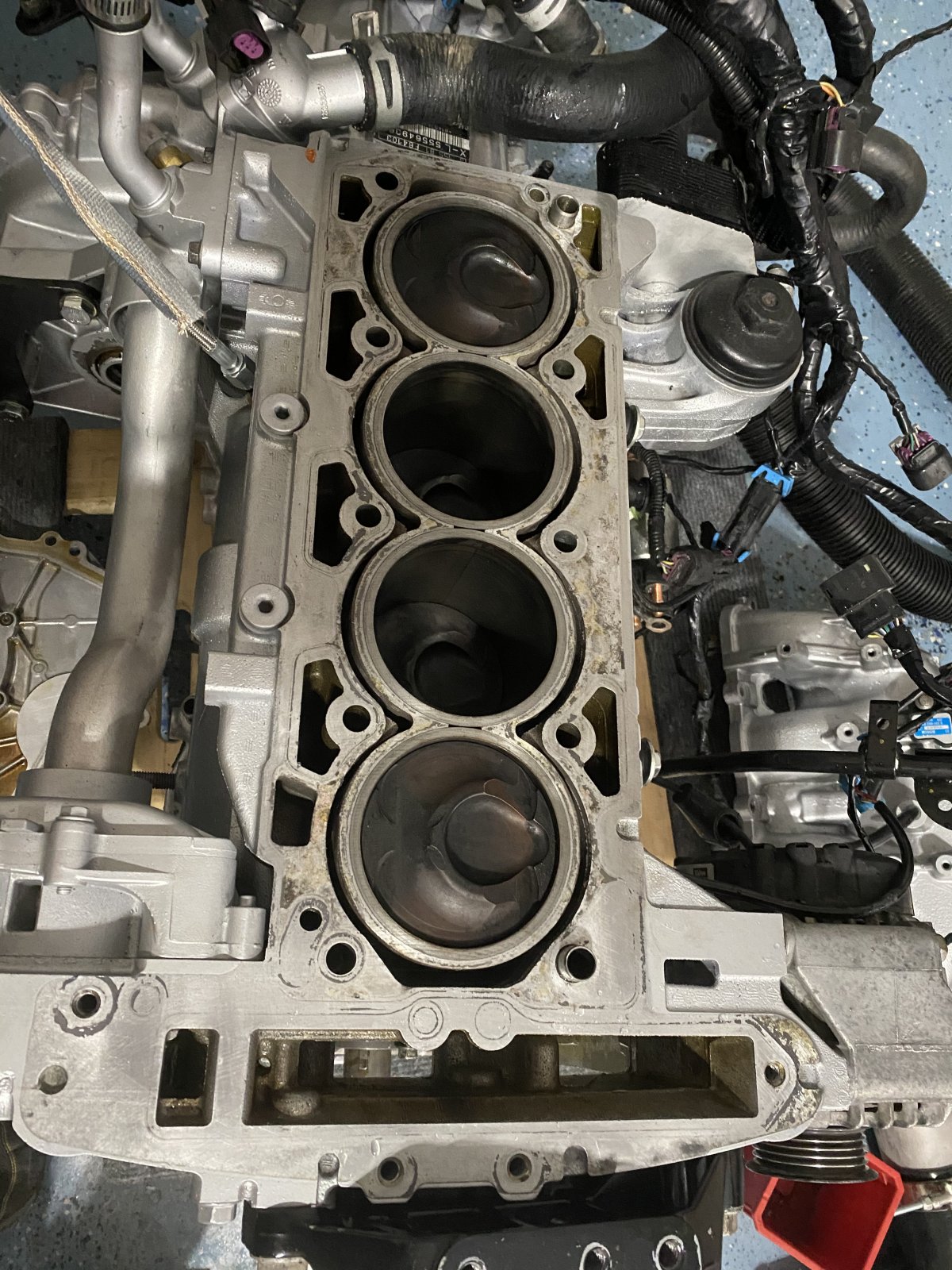

Pulled the head, it only had 40ish miles on it since I refurbished it so I didn't expect it to be roughed up. Only thing left to do is pull the valve springs so I can swap em with the new ones, saving that for another day this weekend.
