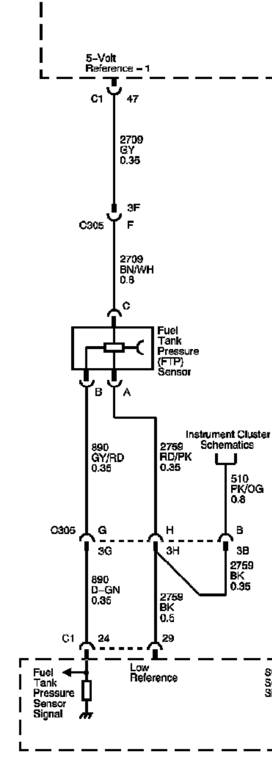

Question regarding the fuel pump and fuel tank connection. I have a 4 pin connector for the fuel pump. https://charm.li/Chevrolet/2007/Cob...Diagnosis/Diagrams/Connector Views/Fuel Pump/ This plug as the supply voltage and ground for the fuel pump and the fuel level signal and ground.
Now, in the wiring diagram is another sensor for the fuel tank. Fuel Tank Pressure Sensor FTP. I don't have this sensor at my fuel tank. Do I need that?

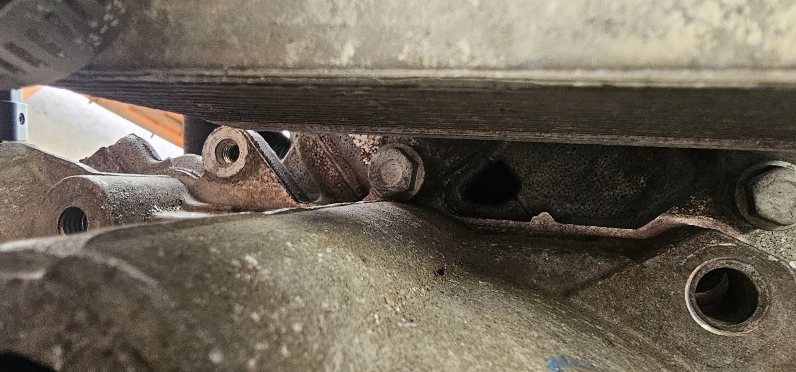

@Rauq Did you had any issues with the lower screw of the oil cooler? The left one in the picture.
44515
Can you elaborate what the concern is, just to refresh my memory? I vaguely recall pulling the oil cooler for some order of operations but I'm pretty sure there were no modifications required to make everything go together.

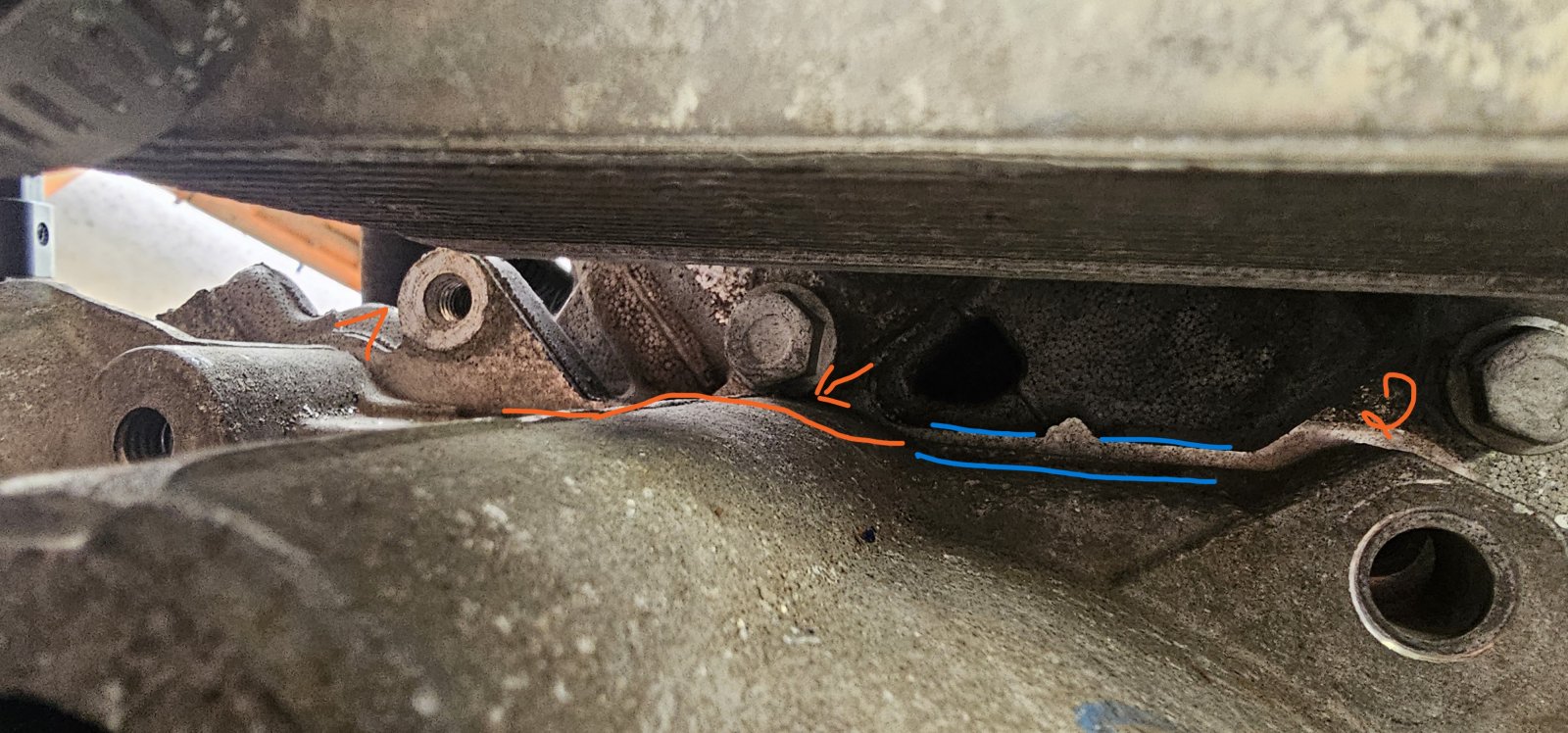

I had to pull the trans after a couple drives because my new OEM slave cylinder had a torn input shaft seal, and I don't remember having to do anything with the oil cooler on the reinstall.
Yes, please see at the picture. The blue lines need to be on top of each other. The left side (1) is already in position, the right side (2) is still a bit to low and will not move any higher due to contact of the screw for the oil cooler and the oil cooler itself.
I used a file and worked a bit on the gearbox housing, that made it fit.

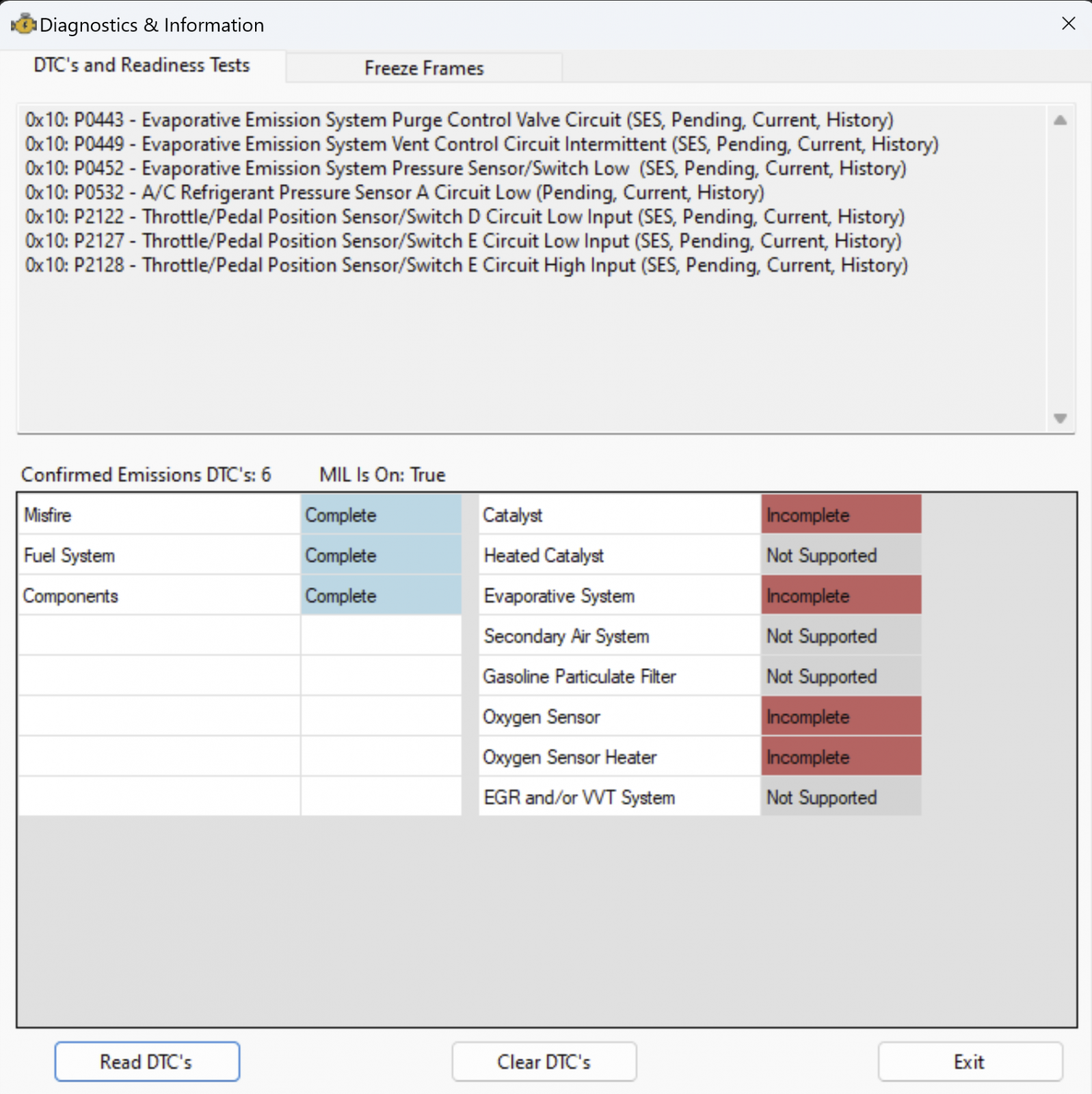

The day came where I turned the key.... and nothing happened :D
Before I did that, I connected the HP Tuner and read out the DTC codes. Missed the gas pedal connection and the coolant level switch. Other than that it looked good. In HP Tuners I switched the Fuel pump on. Wanted to prime the fuel system, but could not hear anything. I looked in the wiring diagram and checked the fuse of the fuel pump. It says in the diagramm, that the fuse is on one side hot at all times. I guess that means it comes directly from the battery. But for me, neither side of the fuse has voltage. I removed the fuse and measured at the pins directly.... nothing. Is there something else I can do?
Tried to crank the engine and even that did not work at all. No crank. Have not yet measured the voltage on the starter. The starter works, I tested it when the engine was out.
Problems problems problems....
Looking for any hints! Below are the DTC codes.
The Control instrument says engine power reduced AND the little symbol down right with the lock and the car is illuminated. Now I don't recall if that was standard with the other car as well. I kept the Key and TPMS module from the old car. Do I need to relearn the key or so?

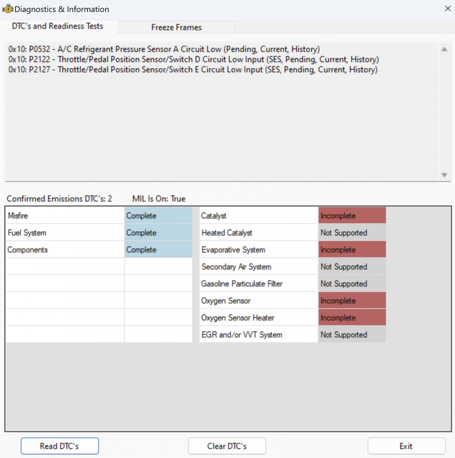

This are the current error codes. I took the EVAP system out, same for the AC. That tells me the first 4 errors can be ignored or do I have to change something regarding the EVAP system?
The accelerator pedal reading in HP Tuners does not change. I made my own adapter, I wonder if there is something wrong?

Yeah, I looked again at my self made adapter. I measured the voltage and one potentiometer had no voltage. The 5V supply pin was not seated correctly did not had a good connection. I also checked HP Tuners again and added everything which had accelerator pedal to the monitor list.
