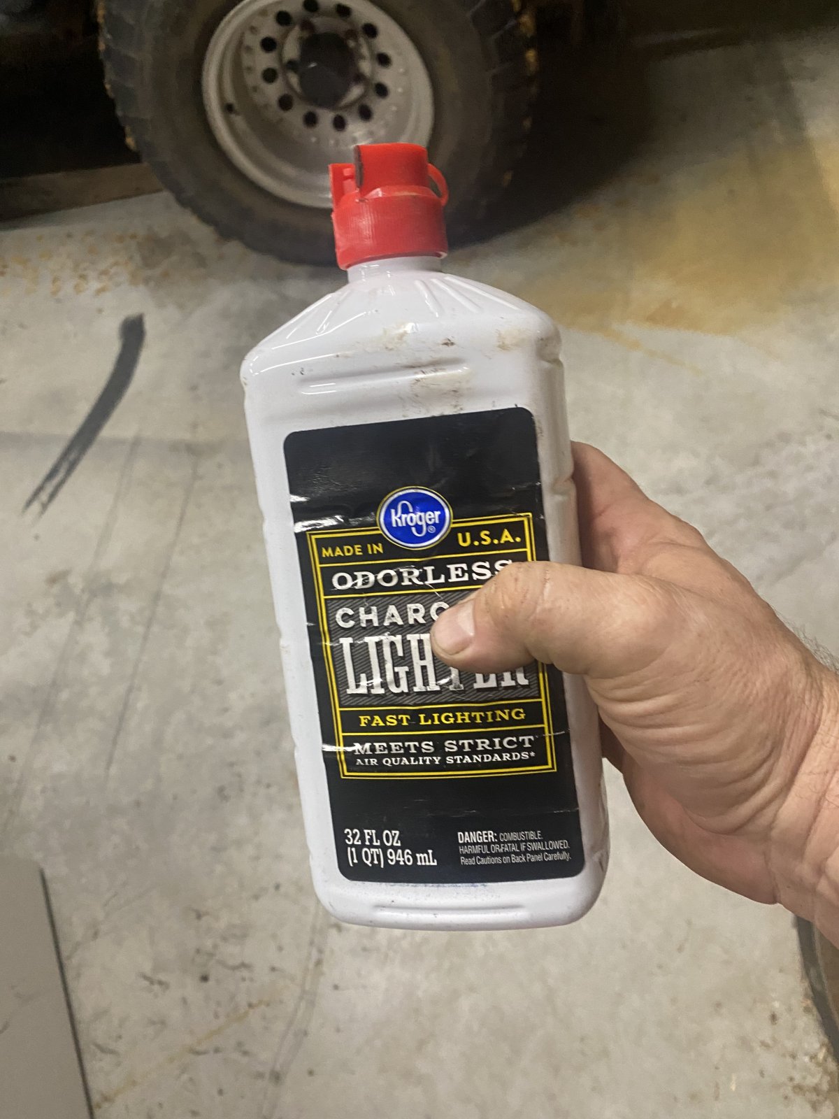

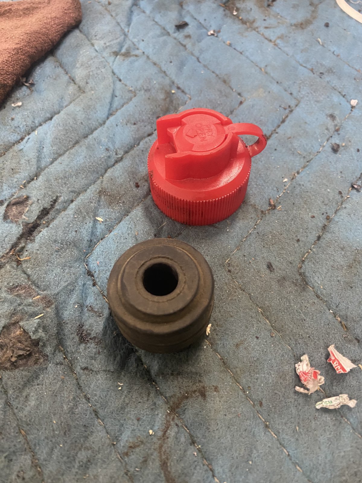

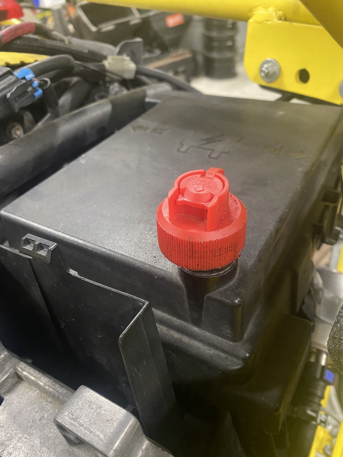

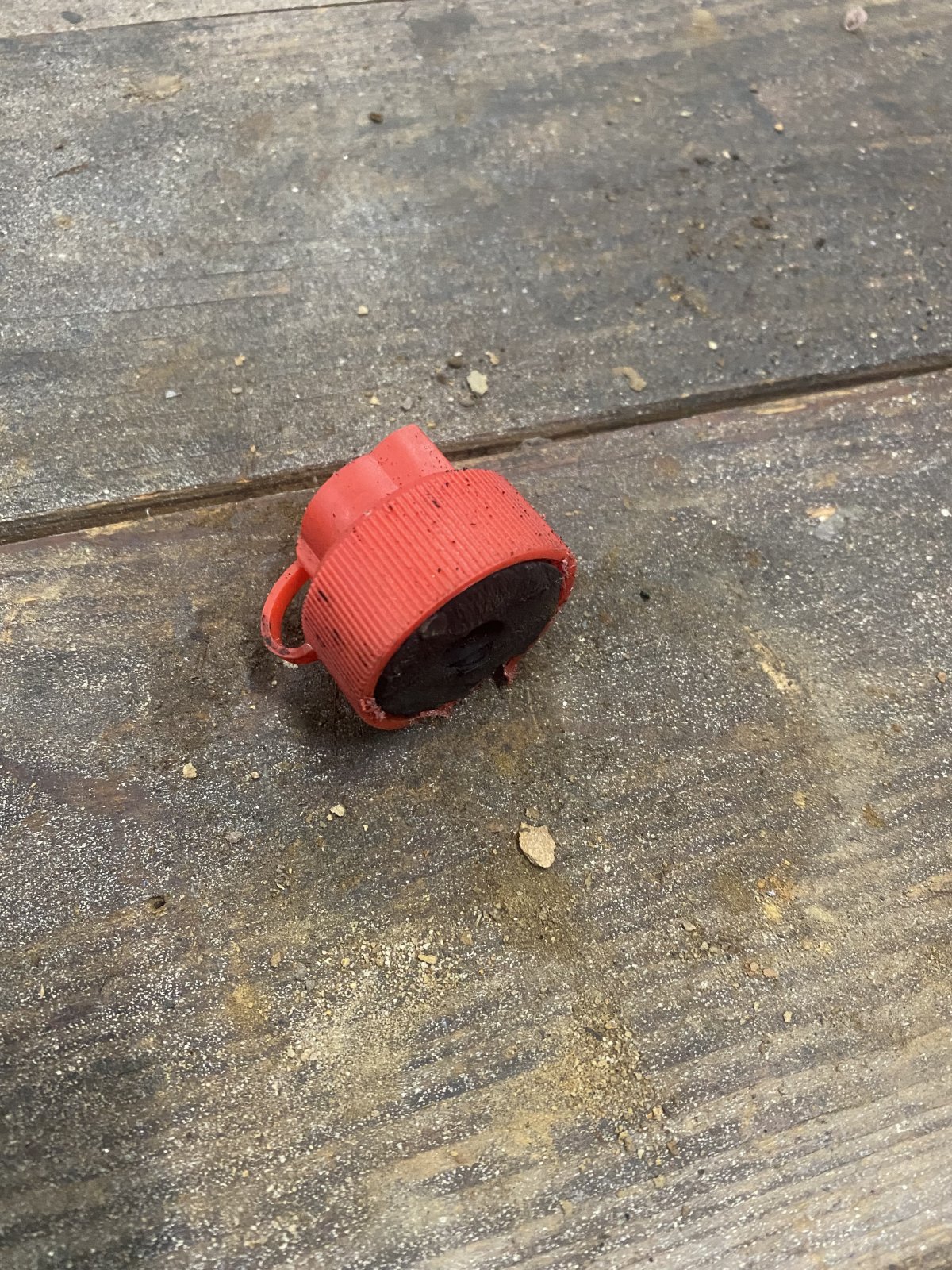

Rttoys Smokin' Goblin Rttoys Smokin' Goblin Aug 6, 2022 #1 90% of those little red caps that cover the positive post on the under hood fuse box (uhfb) go missing. I have solution to that 1- charcoal lighter cap 1: sway bar end link bushing (can be sub’d by shock bushing or any other) Drill and cut to fit and bam.
JBINTX Goblin Guru JBINTX Goblin Guru Aug 7, 2022 #3 Rttoys said: Patent pending Click to expand... AutoX tech will flag that……….
Joebob Goblin Guru Joebob Goblin Guru Aug 7, 2022 #4 Just don't pop the top after it has been hot in the sun.
