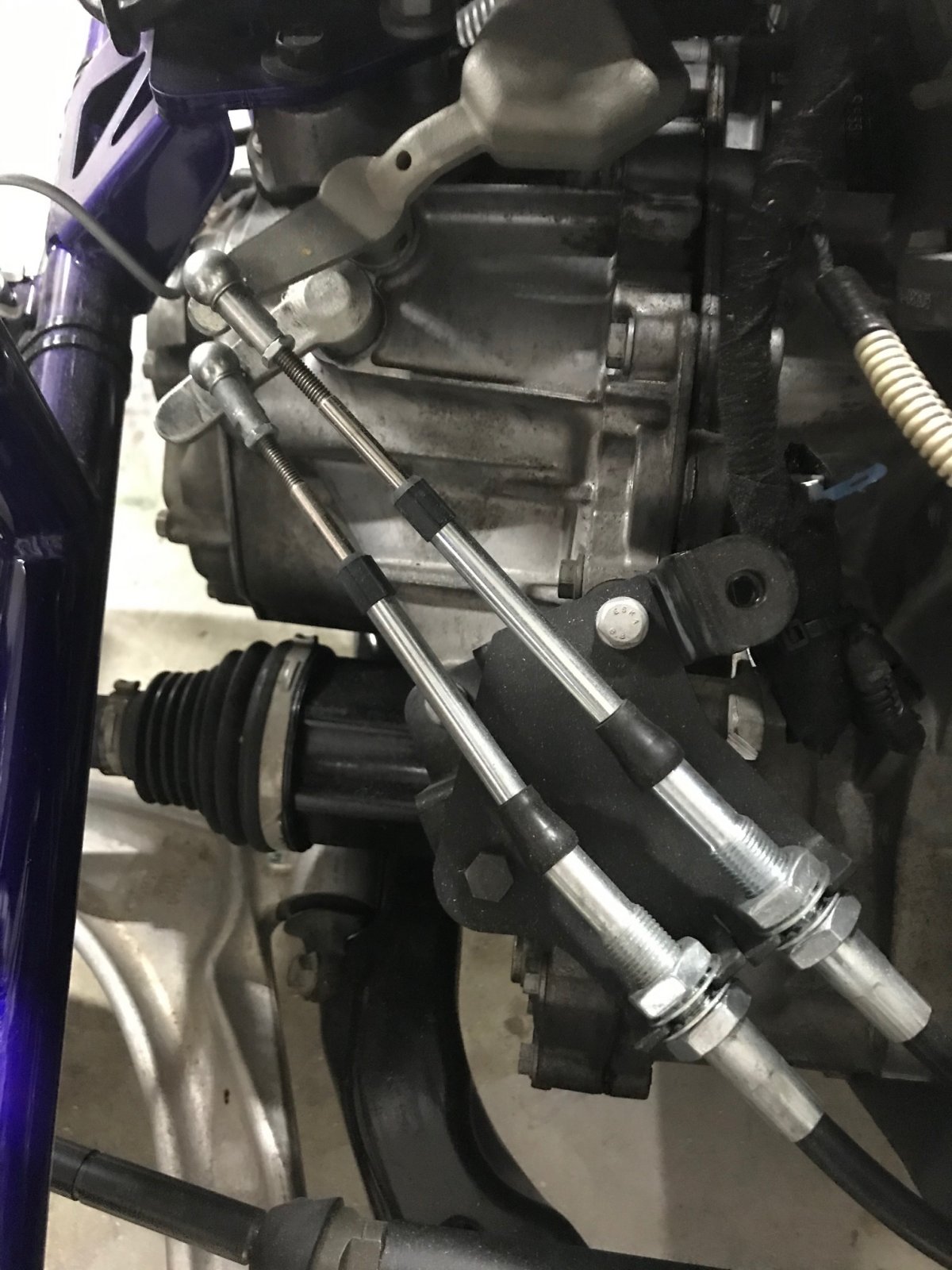

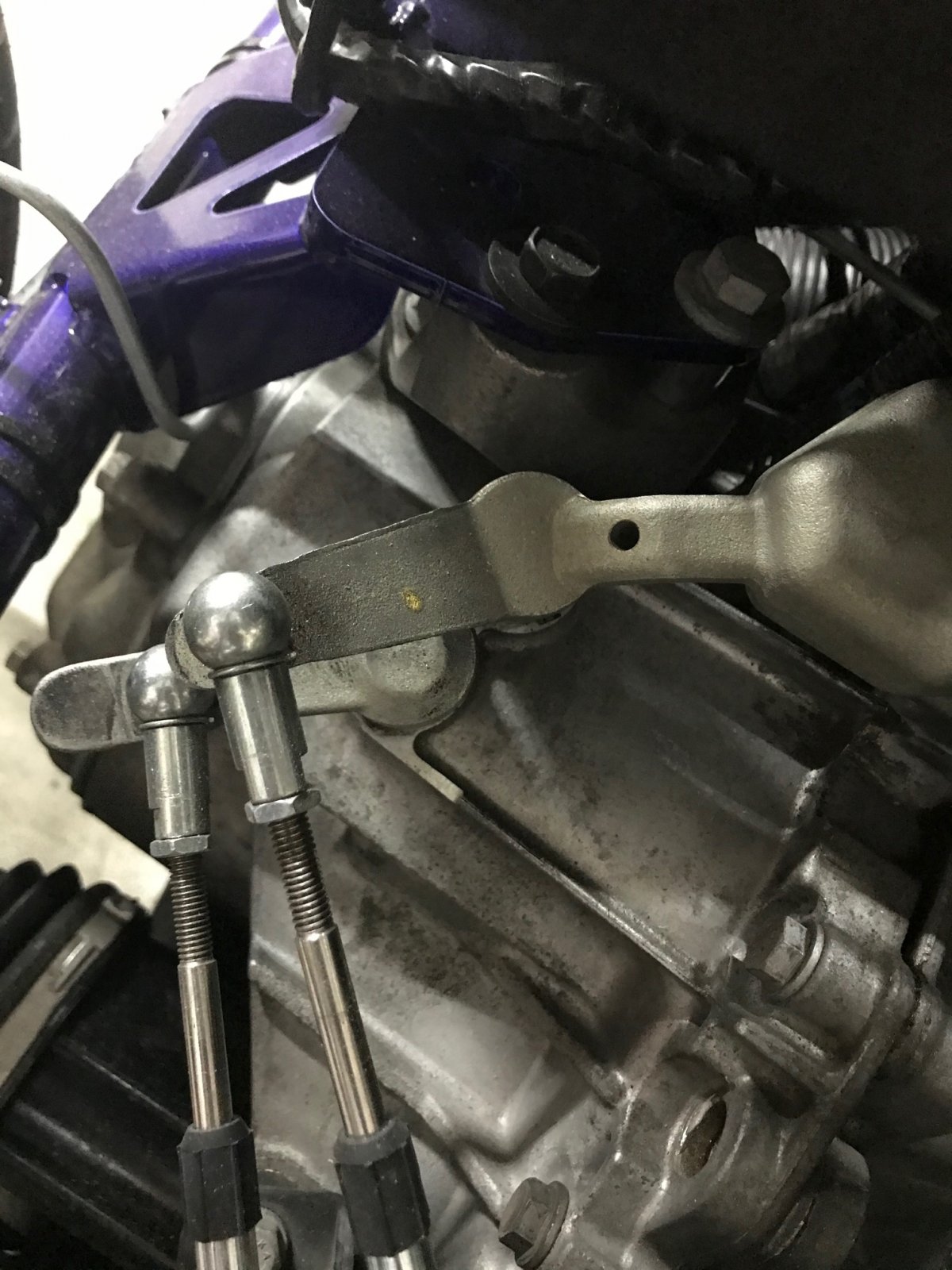

Here are the pics you requested. Both levers have three positions. The middle position for both is neutral.
MisterDave
I've noticed in some first start videos that the axles are turning. Mine did this too.... Does this mean that it's not in neutral? It didn't alarm me because I've seen it happen before... Just trying to make sure I have the car set in neutral before I hook up the transmission cables to the stick shift.
It‘s in neutral. When the engine turns, it’s turning parts in the trans. Friction makes other parts turn all the way to the out put. With no resistance on the output (tires on the ground) the shafts will turn.
it’s no big deal. They can actually be stopped by hand, because the force is minimal.

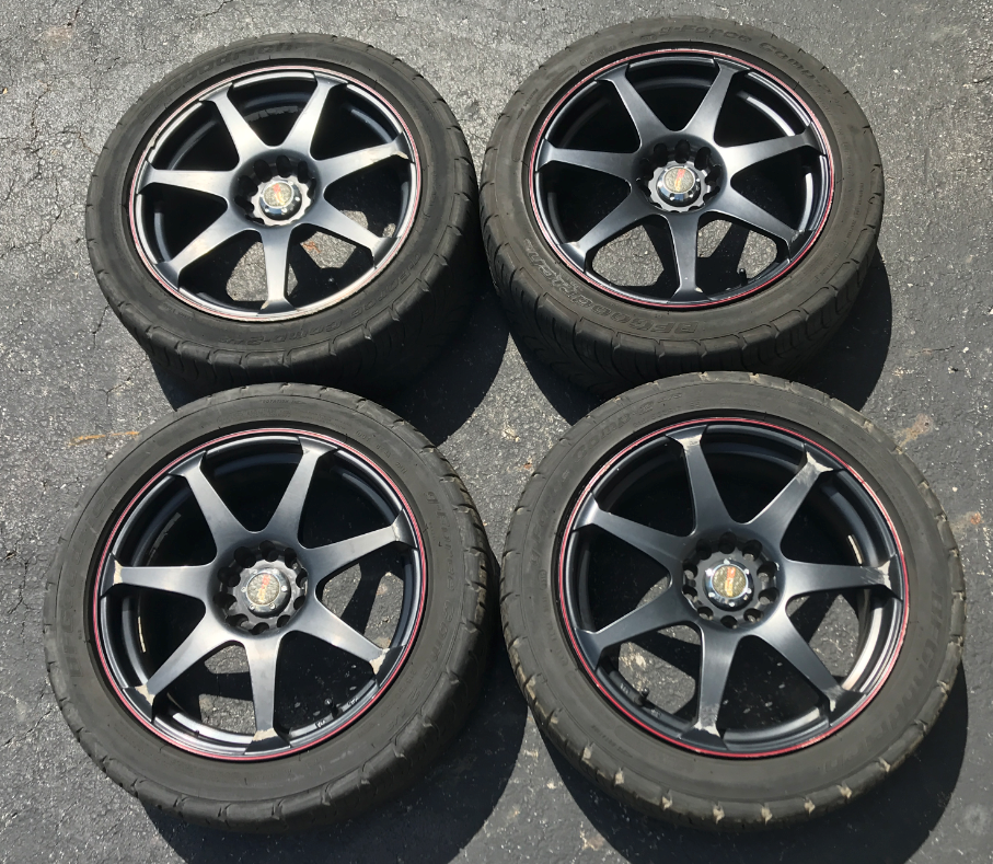

I purchased my wheels (Drag 33) from Discount Tire (https://www.discounttire.com/buy-wheels/drag-dr-33). They were a little confused when I told them I just wanted the tires mounted onto the wheels, but didn't want them installed on the car itself. Took about a week from when I ordered to when I picked them up.
A set of those came on my donor when I bought it! I would've sold you mine really cheap, but they are all curb'd up...

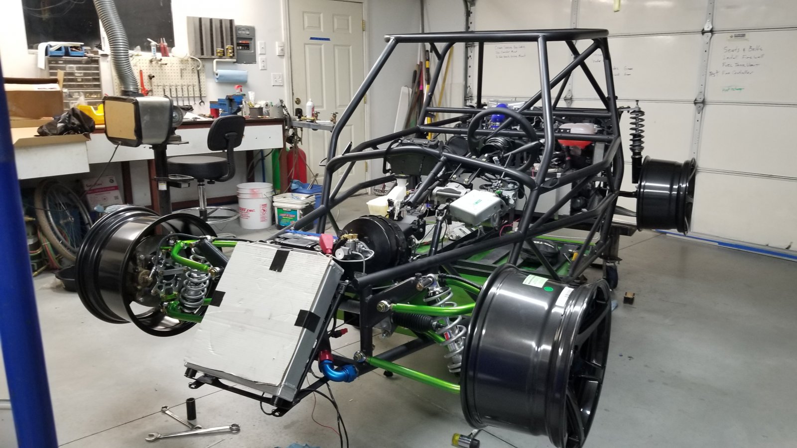

I just got my Konig Tandem 17x9.5 +15 yesterday. They were supposed to be here in 3 days from LA and got them 12 days later.
They are sitting 3/4" off the spring in the rear.

My difficulty is that I plan to have fenders and I'm trying to get the offset so that the wheel will line up center to the fender. I can do some adjusting once I have the wheels, but I'd like to get it close to start.

This thread has me thinking that I might as well just order spacers now. I am almost certain my wheels won't clear the springs in the back.
Once I get my springs, I'll know for sure, so I'll just hold off until then.
