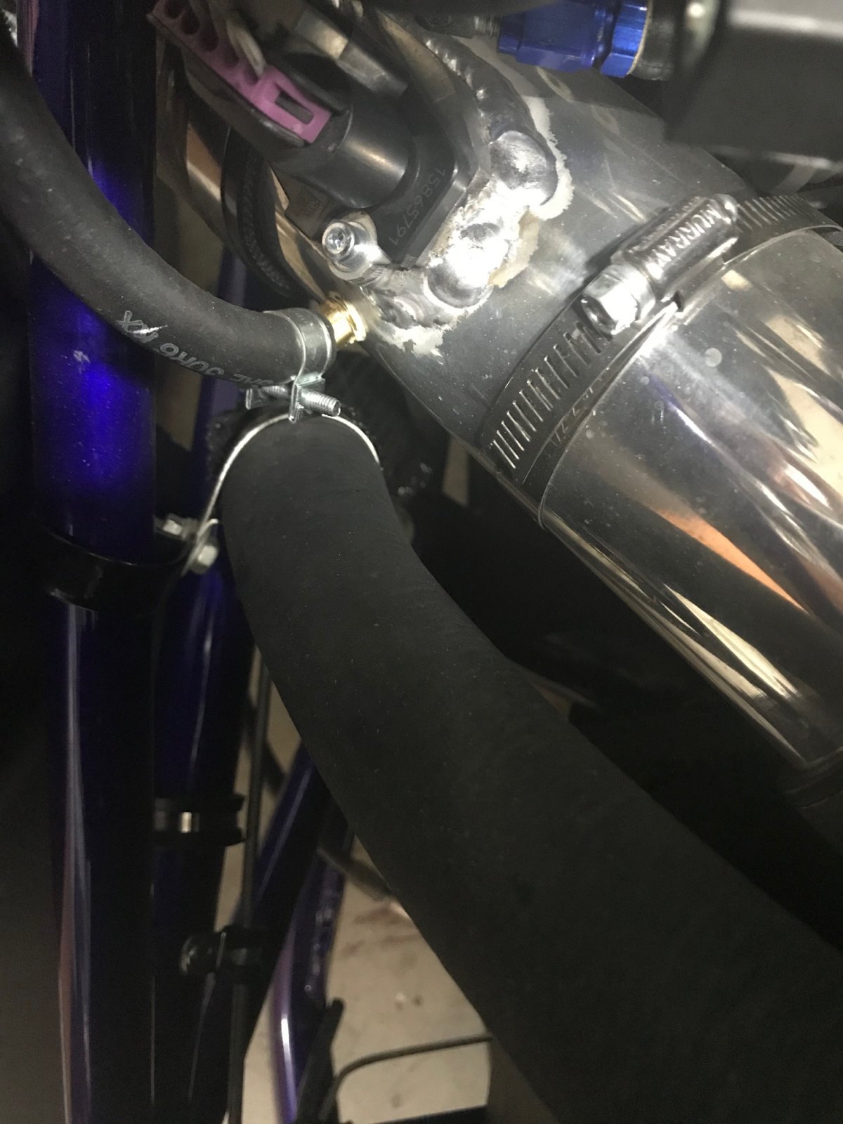

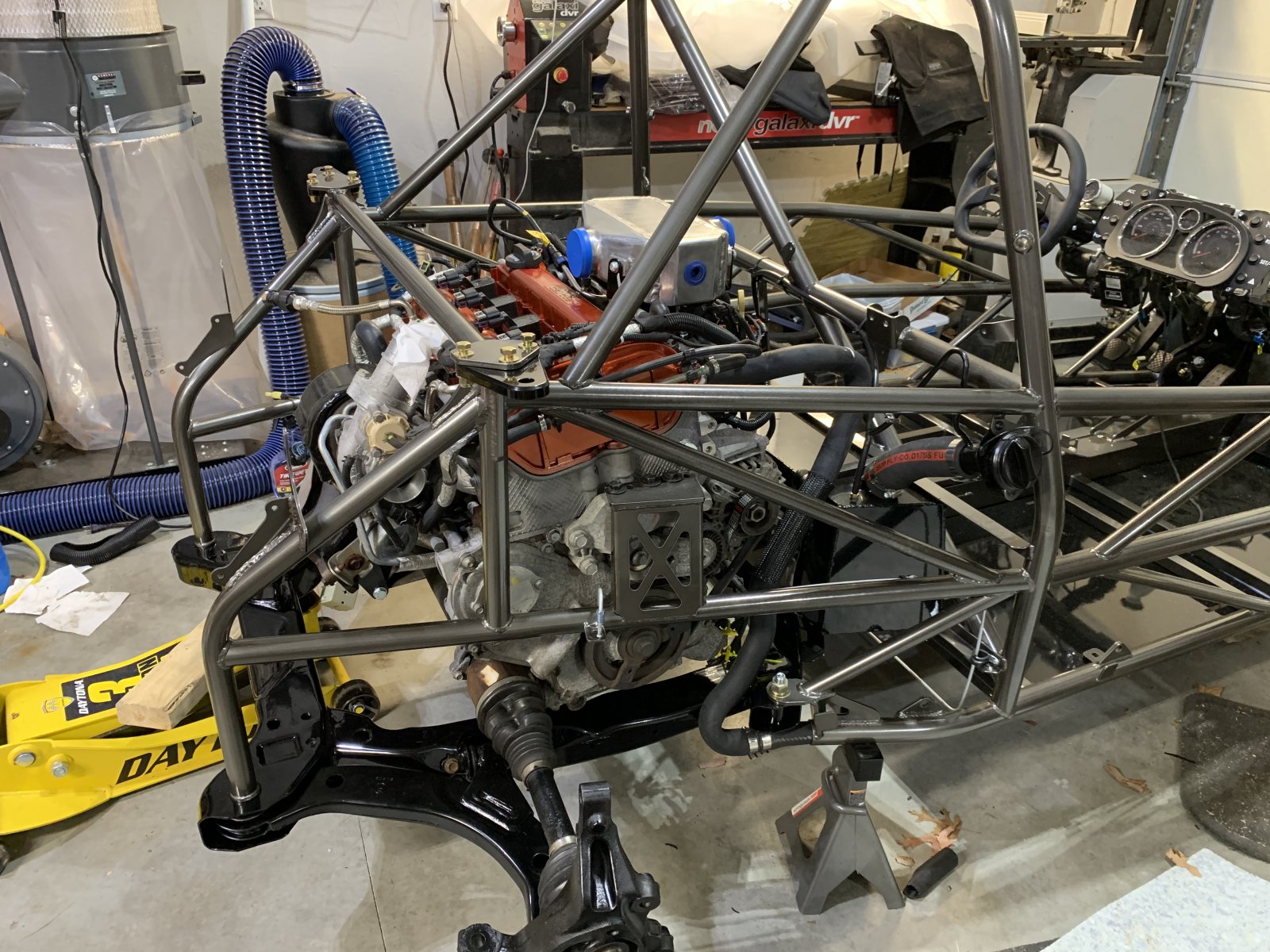

That is similar to what I did. Ordered the brake hose so I didn't have any splices in it. Figured it would be less chances for leaks.This is what they had in mind for the clutch reservoir line:
Jason in Texas - ext. track - 09 SS/TC
Brake fluid doesn't sweat out of the fuel line? No, it's been about a year and half and looks and feels like the day I installed it.dfkitcar.com
Take your current hose off the master cylinder and cut it in half and use the nylon line to patch them together.
I bought a couple of feet of this 5/16" ID... instead. It is a little pricing: https://www.ebay.com/itm/REMOTE-BRAKE-FLUID-RESERVOIR-HOSE-5-16-ID-Sold-by-the-Foot-see-description/332975349019?ssPageName=STRK:MEBIDX:IT&_trksid=p2057872.m2749.l2649

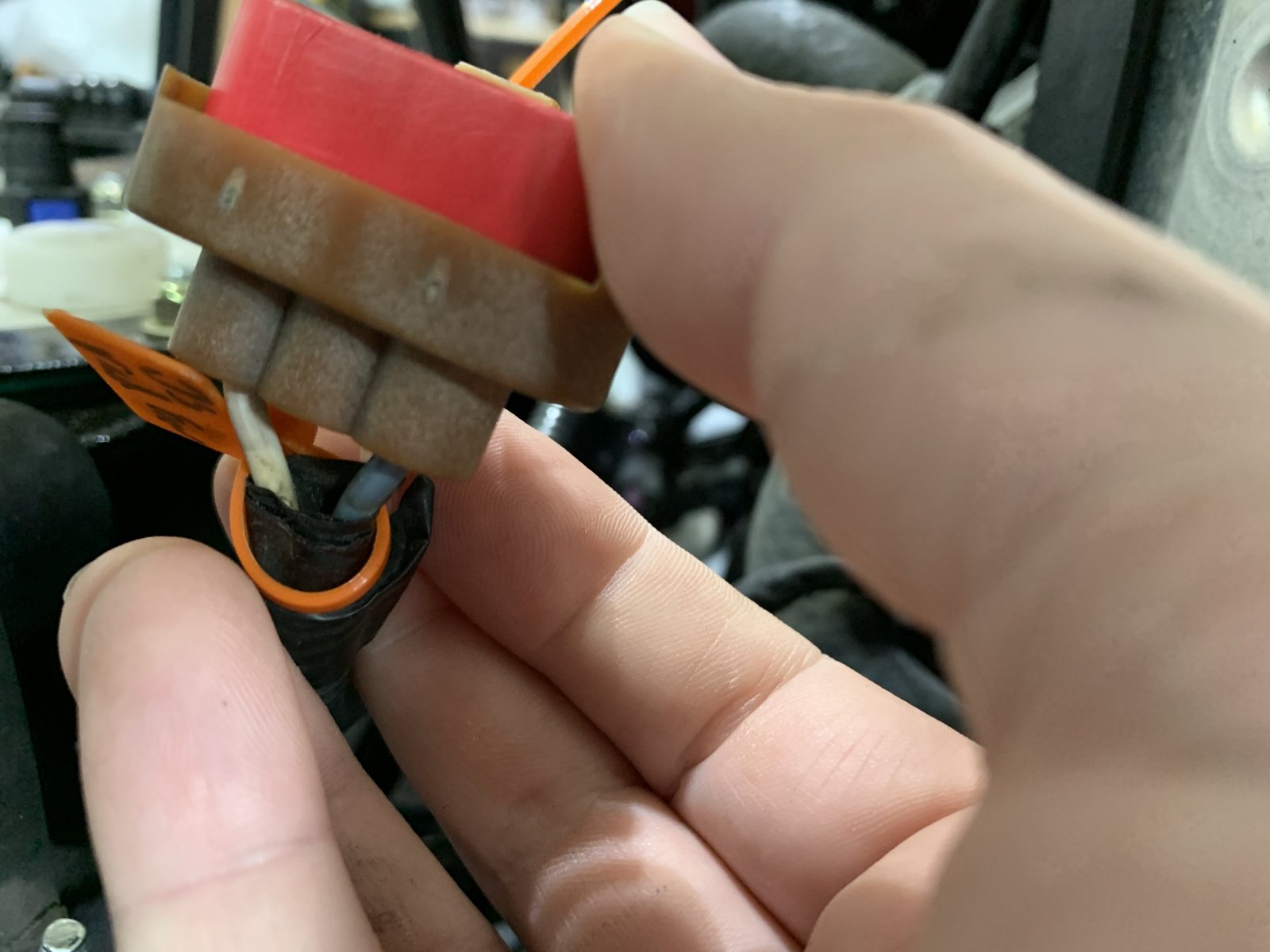

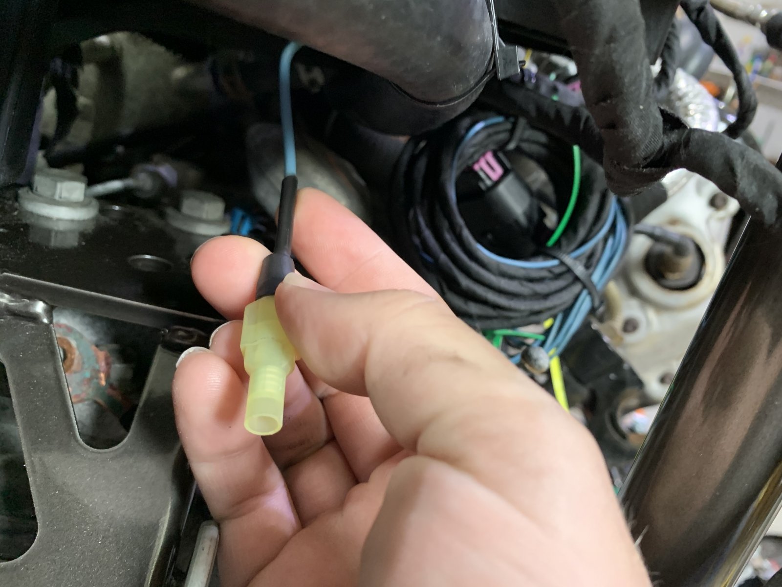

yep on the screws. I used shorter ones.Thanks for the help, I did cut that blue wire from the plug and connected it to my fan wire. The white wire I just capped off with some heat shrink.

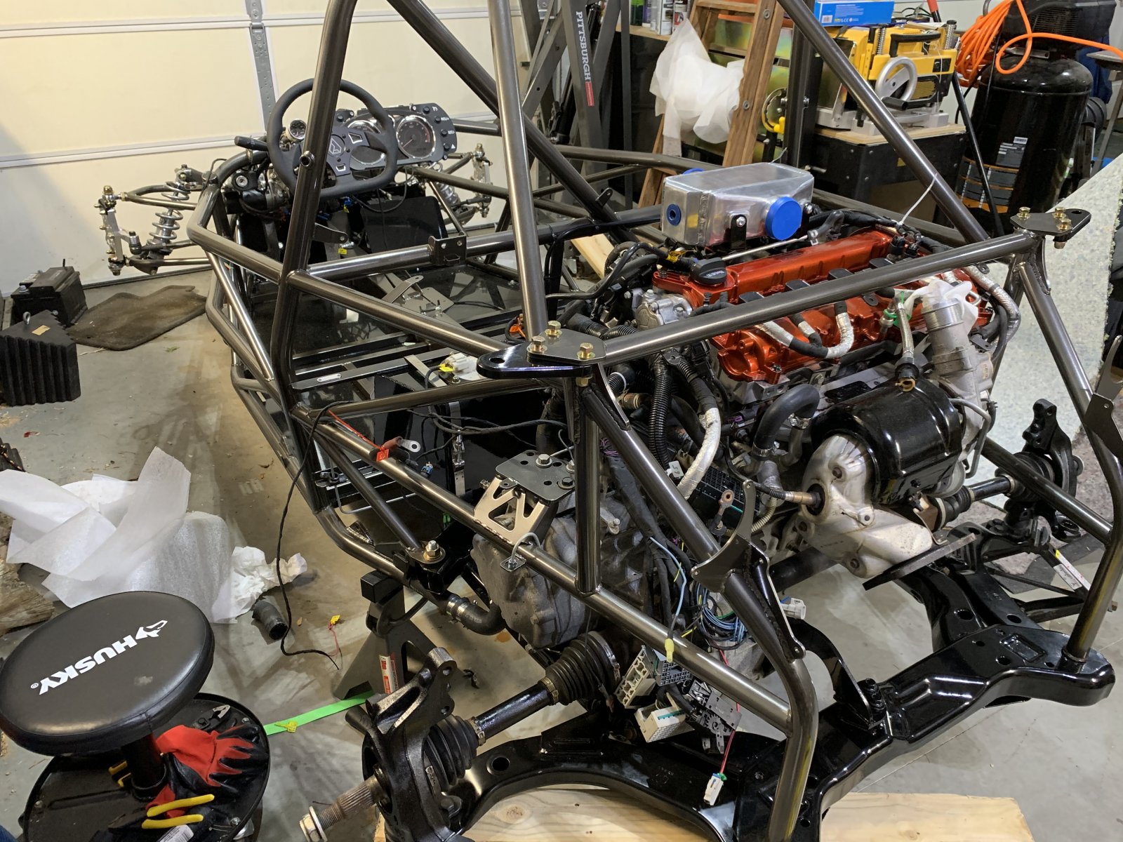

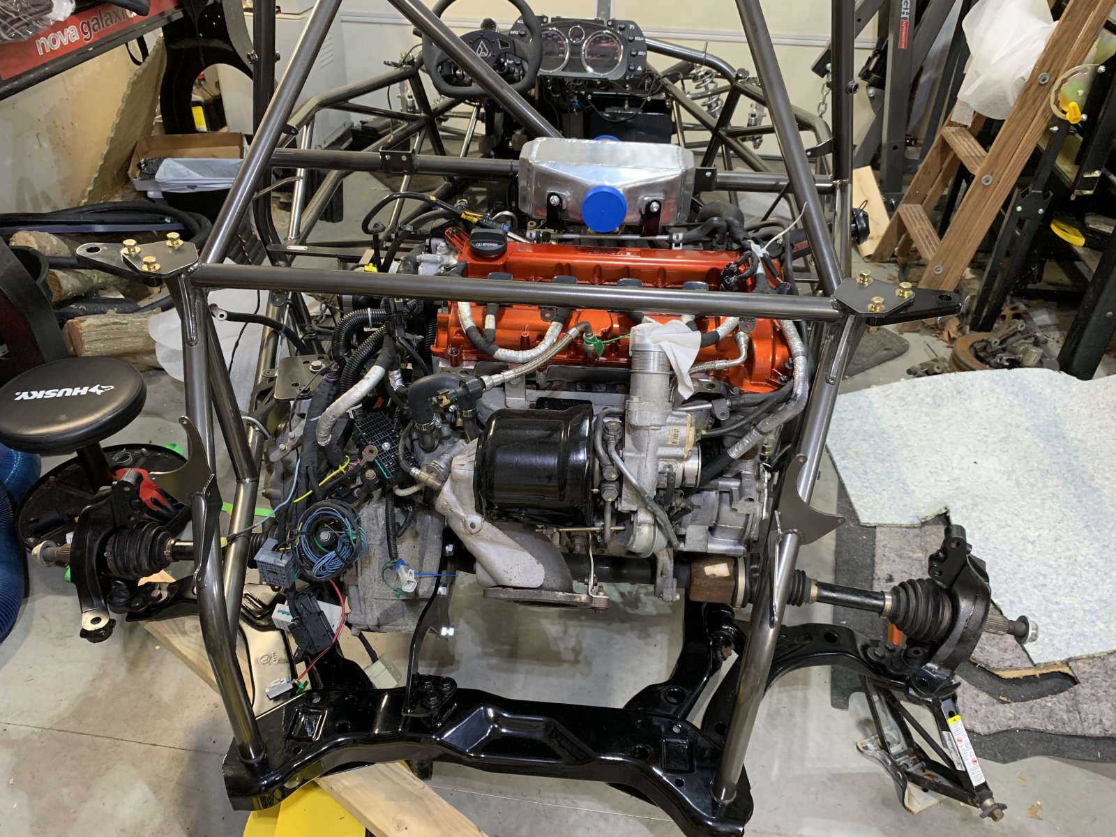

This morning I tried to mount my inter-cooler water pump. I got the mount plate(diamond shaped) bolted on to the oil pan. Now the next session of Dave's dumb questions.... There are two screws that go into that plate to mount the water pump clamp. These screws are 3/4" long. With the plate being 1/4 thick and clamp mount is only about 0.1" that 3/4" screw seems too long. Am I missing something? the screws bottom out and hit the oil pan.

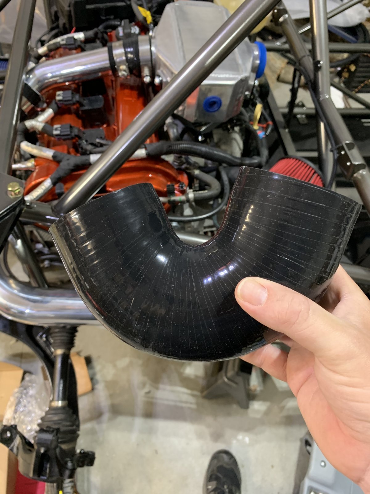

I was actually hoping your build log might provide an answer for that coated clamp. I was waiting to see if you had any replys to that one. Mine is still in it's bag.Like JB said, I don't think anyone's going to be able to give you exact numbers. I know I cut at least an inch off the tight elbow that goes under the intake manifold, and I cut off at least 2 inches off the thinner tube that goes from the turbo to the intercooler.
What did you do with the coated clamp that's part of bag L23D, "Intake hardware for TC"? I don't see anywhere it can fit my build .... just curious.
