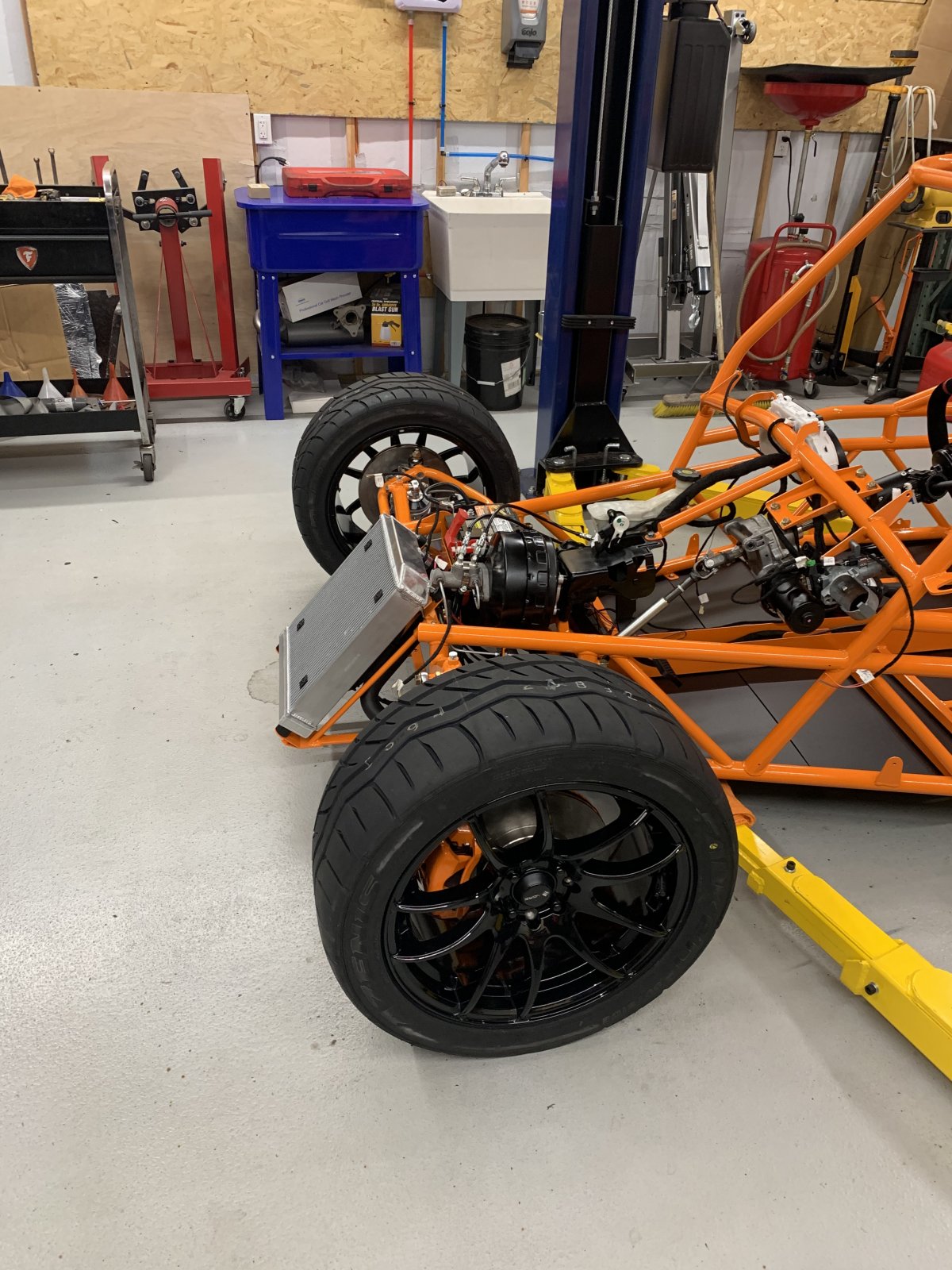

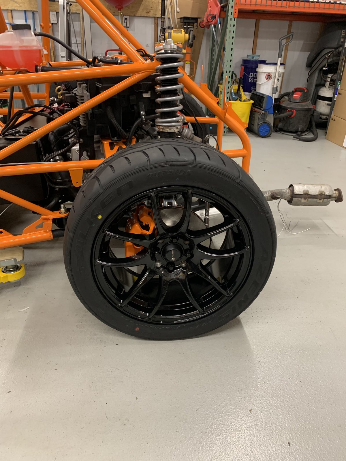

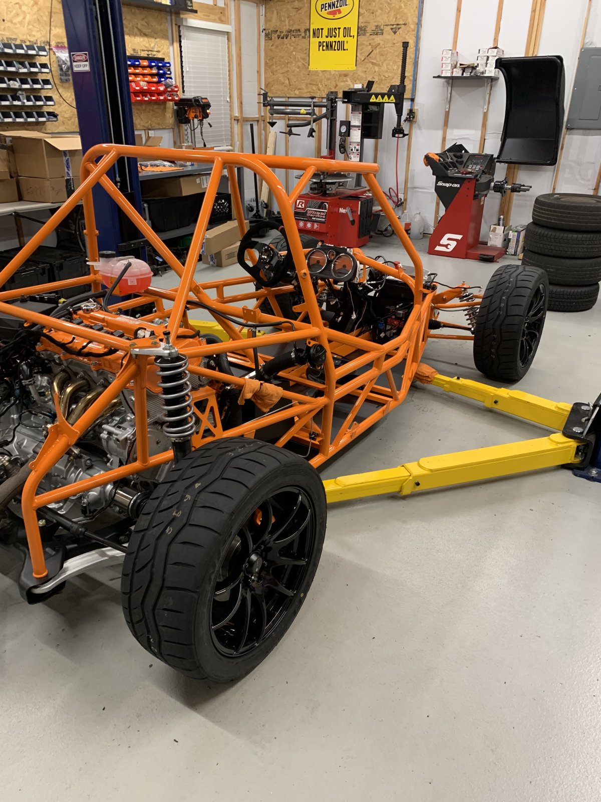

Rims and tires are installed.
Rims are Vors TR4 17x8
Tires are Falken Azenis RT615K+ 245/45/17

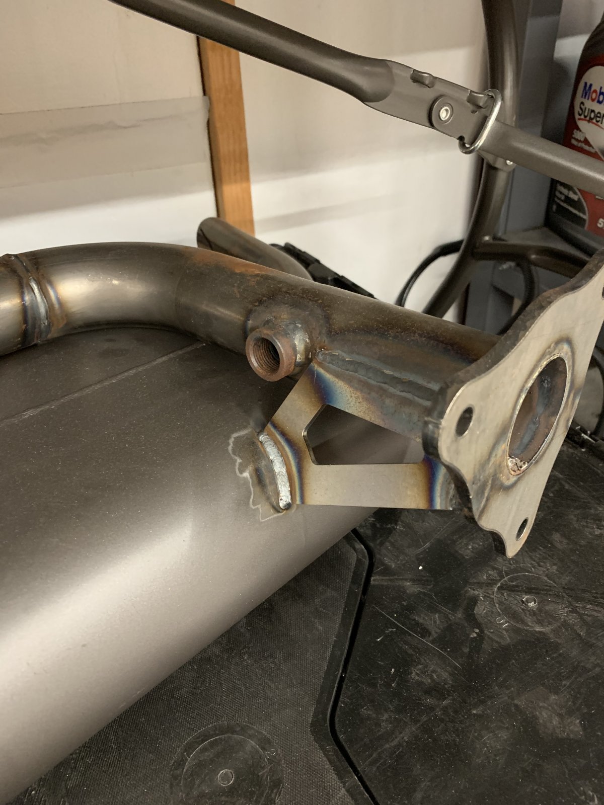

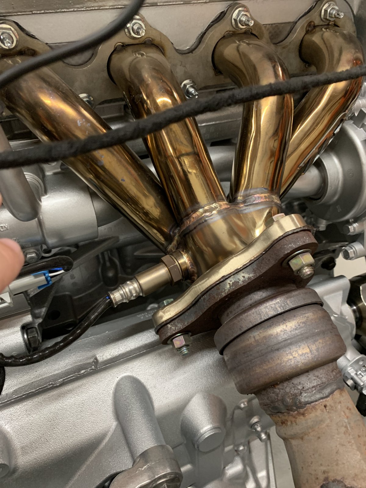

My exhaust manifold/header has a bung for the upstream oxygen sensor. The DF muffler also has a bung for an oxygen sensor.
Where do I put the upstream sensor?
Do I plug one of the holes?
Do I put in a downstream oxygen sensor?
First bung is for the stock narrowband O2 sensor, the second one is for your wideband. If you don't have a wideband, you can alway put the stock post-cat O2 sensor in there, or just plug it.
