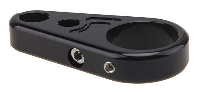

Ugghhh i was worried about this. I held off until this last weekend because i didnt want to drill through the A Arms to put on clamps that looked weak. Should have done something else....
Search eBay for motorcycle brake line clamp. A set of 4 will run you about $30.
https://www.amazon.com/gp/product/B07353YRMD/ref=oh_aui_detailpage_o05_s00?ie=UTF8&psc=1&pldnSite=1

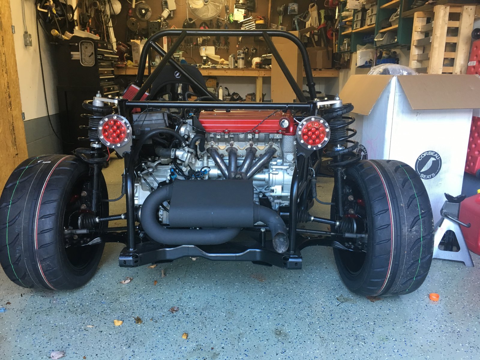

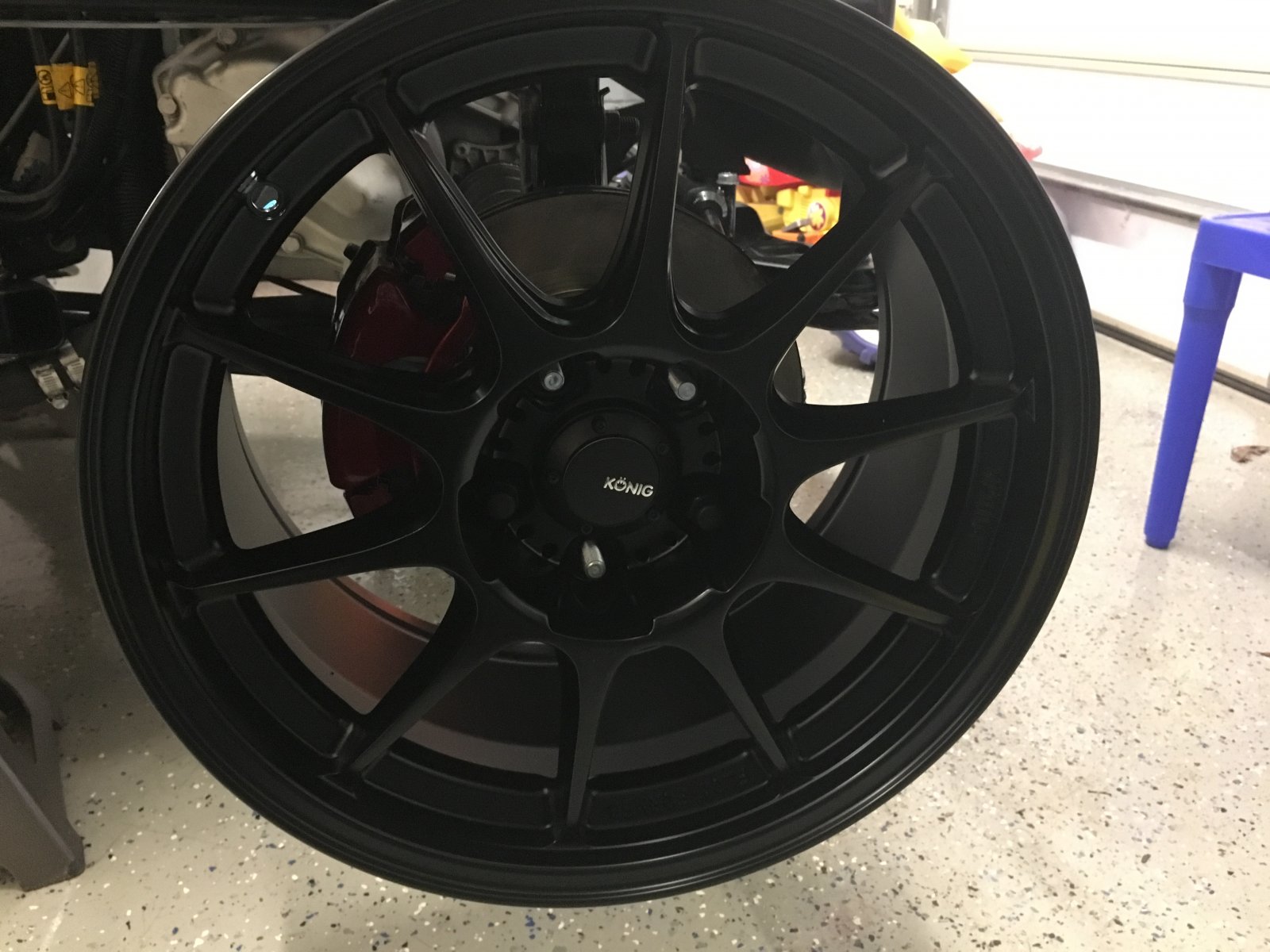

What offset are your rear wheels? Clearance looks pretty tight between the strut, strut perch and tire.
With those wheels you might need to use wheel spacers to give you the clearance's you need.
N
Dont know what my offset was but i am running 275s in the rear (and front) with 1 inch wheel spacer/adapters and have maybe a couple hundred thou of gap between the strut and tire. Thinking of going to coilovers potentially.... i would hate to cut down a tire if the struts moved somehow...
Waterdriver
The offset should be cast into the backside of the wheel. Shown as "+35" as an example.
I hate to say it but you might have go with a lower offset wheel to get the clearance.
That was the issue I was having when choosing a wheel. Something that I liked, light, strong, wide enough with bolt pattern I was looking for and a lower/lowest offset (for the rear) without breaking the bank.
