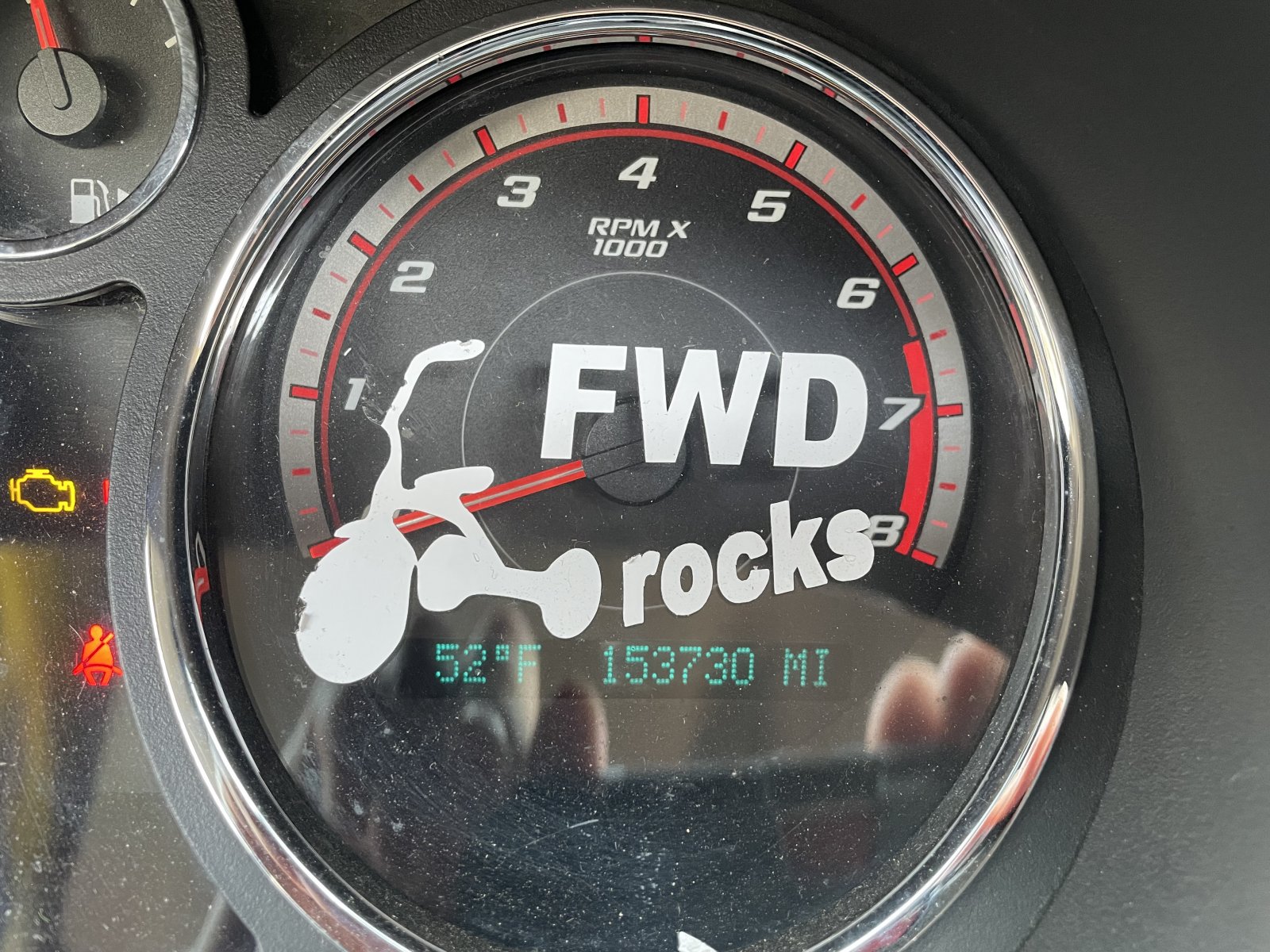

I began scouring the internets for a vehicle. I knew I didn't want an automatic but was really open to anything other than that. After searching for what seemed like eons (it was two weeks), I found a 2006 Yellow AF SS/SC with 150k miles only 3.5 short hours away. The interior and exterior weren't great but what it had everywhere else was perfect. The engine has the GM Stage 2 upgrades, 3.0" pulley, Dual Pass kit (that I didn't know about) and a huge heat exchange. Oh, and it also had a stupid "FWD Rocks' sticker over the tachometer. The vehicle was running and driving, the seller was open about everything 'wrong' with the vehicle so a deal was struck. Engine felt strong, made 15 psi on the boost gauge and the trans went into gears. My father and I got the vehicle loaded and home safely and the original plan was to wait until the title came through to rip it apart, but that didn't happen. We all know the story here, the following weekend the carnage began. The title actually came a couple days after I finished the bulk of the tear down. I didn't take a lot of photos of the car in 'new to me' status as I didn't care. An extra little bonus, while getting the Bill of Sale notarized the guys father showed up with a box which contained brand new wheel bearings for all 4 corners (score!). I know most wouldn't have gone for such a high mileage engine but if it blows, it blows. At that time my son will get an education in engine internals and disassembly/building the engine.

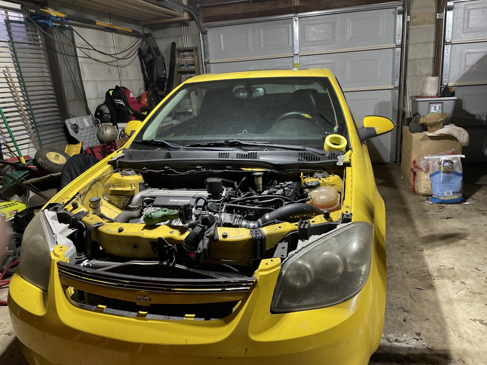

Began stripping the interior and exterior. The previous owner left a lot of change, some tools and a Joker playing card. I know when I sell a car I get everything out of it, but to each their own. Piece of advice for future readers/builders. LABEL EVERY WIRE AND CONNECTOR. This little bit of time now will pay dividends later. I didn't label what the connectors were called, so that caused a little confusion in Day 10. I used painters tape and a sharpie, which was ok.

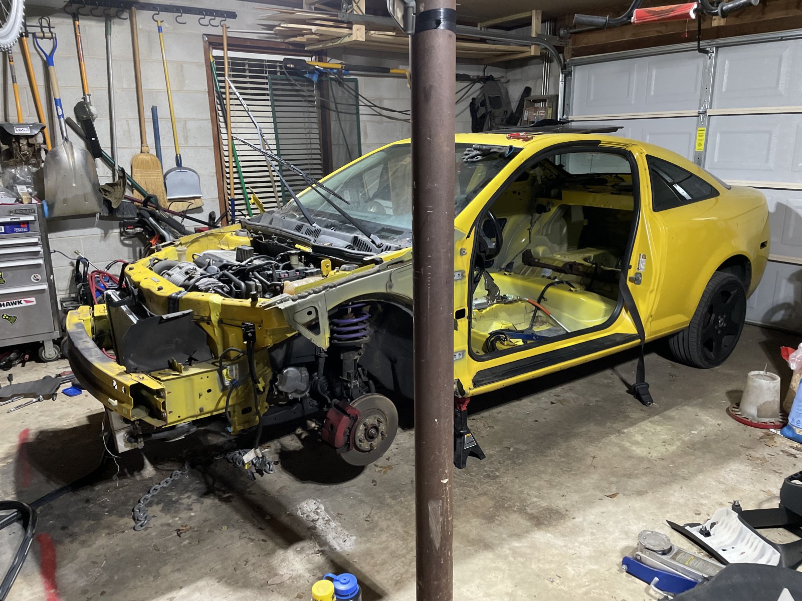

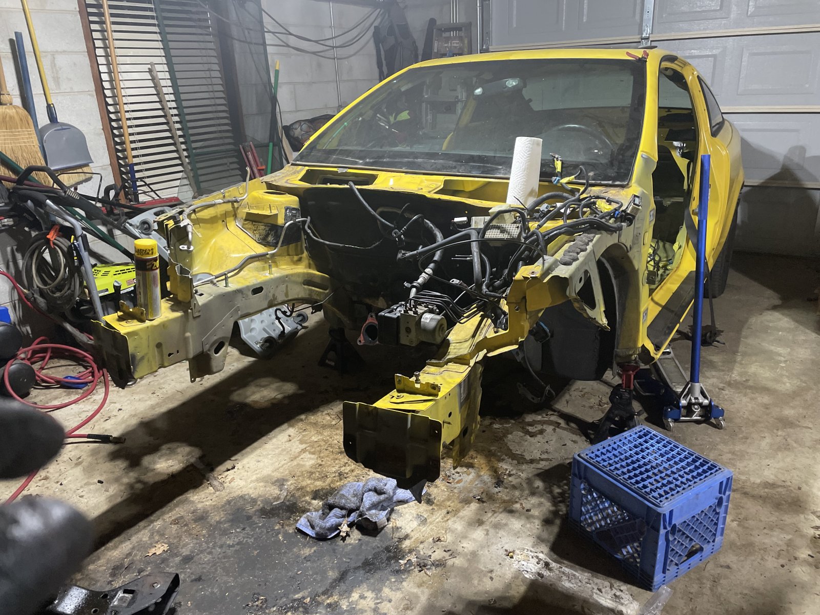

Continued stripping the exterior and engine bay. There were many, many attempts to get the engine out which we did through the top. If you have means to drop the engine to the floor, DO IT. We did not, so here we are. The engine finally came out, thanks to my wife for the assist here. She help keep stuff out of the way while I pulled. It's a relieving feeling once that engine breaks loose. You think the hard part is over, those bolts holding in the back of the dash beg to differ. The fuel pump trick really helped out. I had about 10 gallons of fuel to deal with. So, riding mower got filled, along with my 5-gal and 3-gal cans but the big payoff comes later.

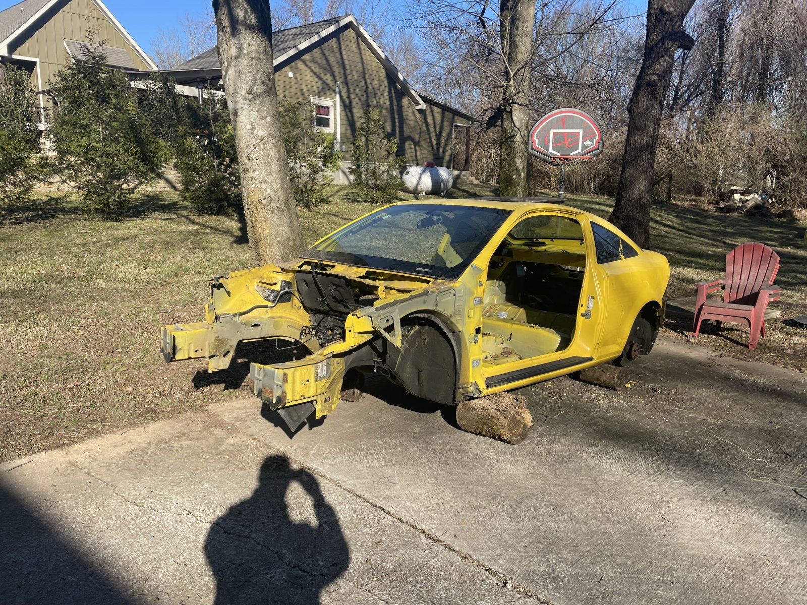

This day we rolled the frame out of the garage. It was very easy with wheel casters, this allowed the frame to pivot. We did this with the rear tires on (momentarily) and plates under the front. After it found it's final (at my house) home, the rear wheels and hubs were stripped. Yes, those are logs under the frame to hold it up. I posted a listing of the Facebook Market place for a free frame with No Title, I had more that enough 'buyers'. The guys who ended up getting it may end up dead in the near future, they came with no winch or come-a-long. They proceeded to rock the vehicle onto the trailer. I also scratched out the VINs on the frame. Since pieces of the front end are cut off, it would be a bit hard to rebuild this (or maybe not?)

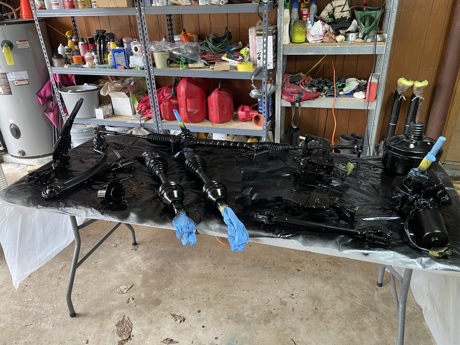

Painted the reused donor parts Rustoleum Satin Black. I like the results and glad other members convinced me of this rather than flat black. Still trying to decide what to do with the sub-frame color. The two option right now are more Rustoleum or powder coat it the same as the frame bars

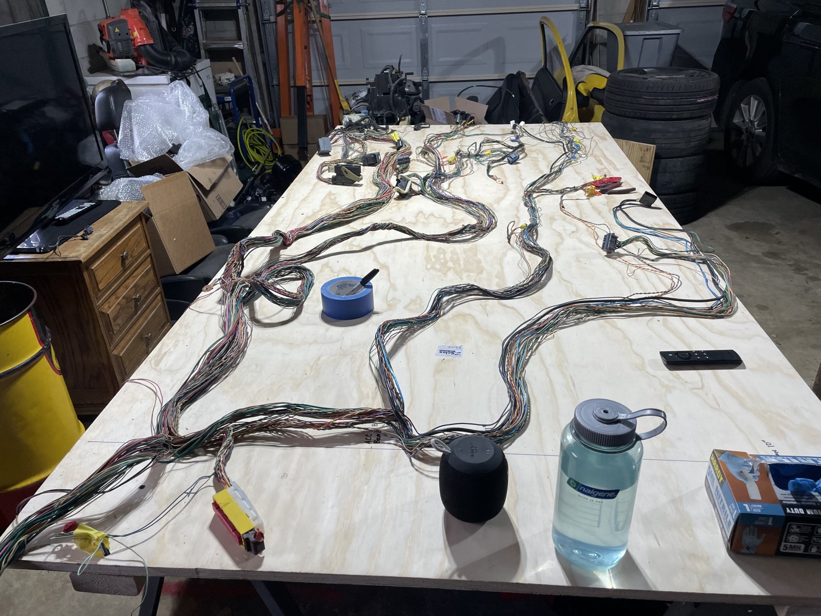

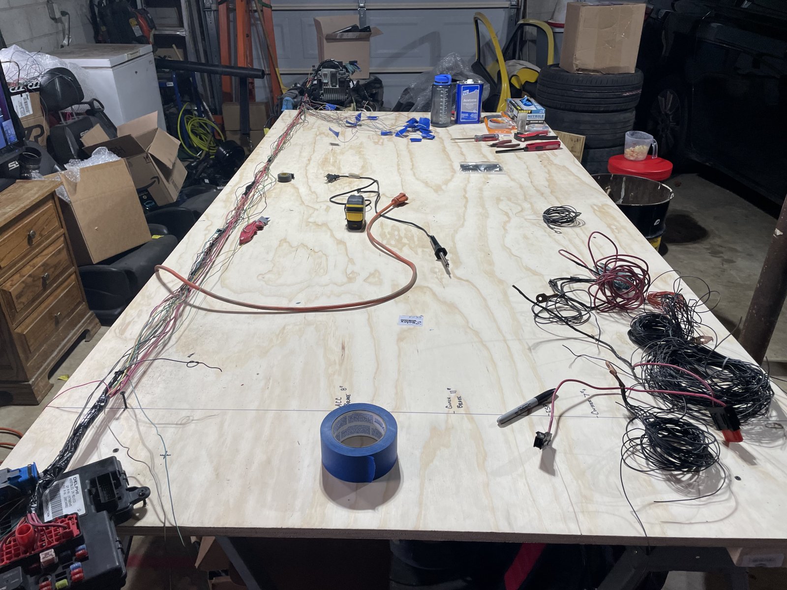

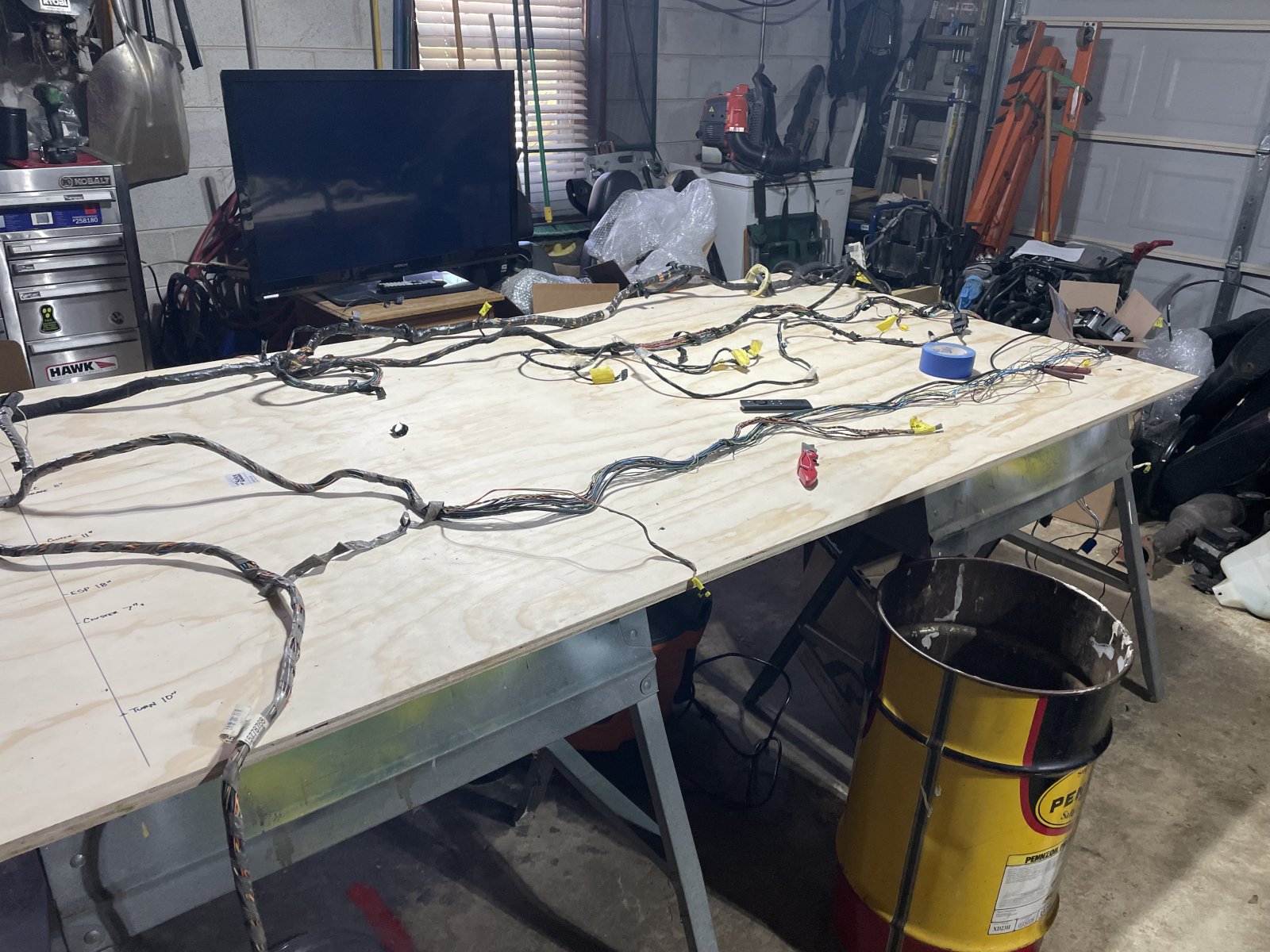

The day I have dreaded is here, wiring. I built a table and started stretching out this monster to get a good view. She is gigantic. Afraid but still vigilant I pulled out my trusty clips and saber (razorblade) and began following Lonnie on Wiring Video #1. There was a lot of pausing and re-watching but Lonnie (via YT video) and I got the harness mostly stripped of tape. Had it not been time to go to pickup soccer, we would have gotten the video completed. God Bless him and DF Kit Cars for making these videos. Note: wear disposable gloves and wipe down your tools after working. The harness is super sticky after removing the tape and looms. I also had setup a spare TV and Amazon (TM) Fire Stick in my garage to watch the Goblin videos while I work. This has been very helpful, we'll most likely keep this going all through the build. Plus I can hide in the garage to watch English Premier League (EPL) and 'work' on the kit with my friend Clyde May or Jackie Daniels.

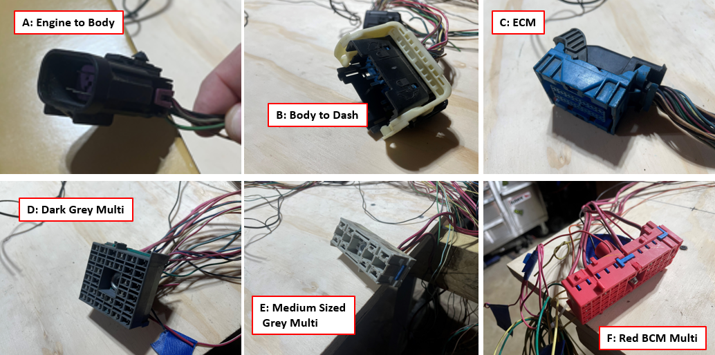

2022-03-27 Harness Start.JPG2022-03-28 Harness End V01.JPGConnector Names 2006 SS_SC.PNG
Edit: I've added the list of plugs for future builders of 2006 SC Goblins, this could possible go with other years that have the SC 2.0 engine. These names will become very important as you thin out the harness in the next video.

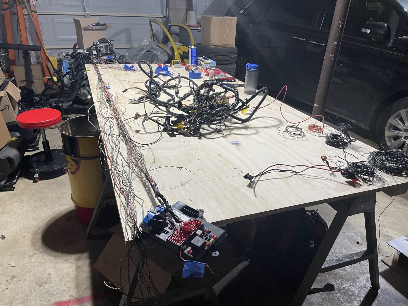

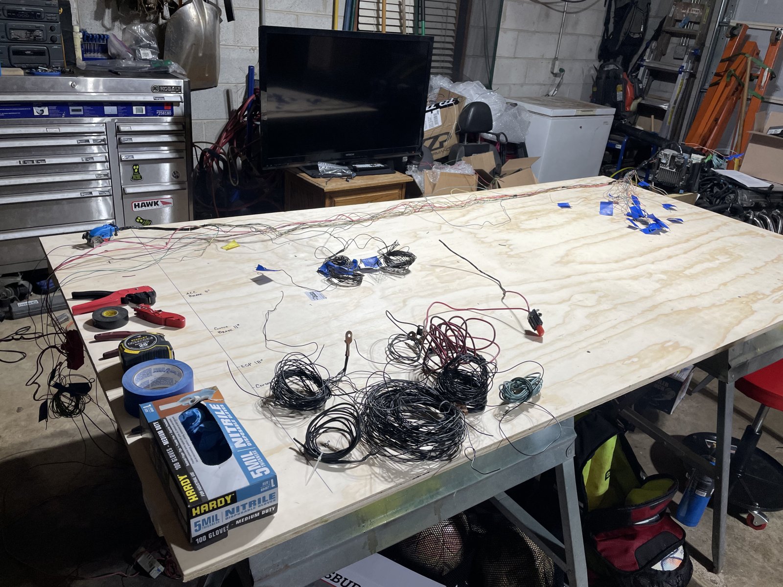

Today Lonnie and I worked on Wiring Video #2 and #3. Only a few snags here and there. I clipped out the reverse lights (backup lights) so have to find those. Also some confusion about the various plugs and where the data wires went. My EBMC harness had two sets of tan/tan-blk wires. After posting in haste about it and then being reasonable and following the wires, one set went to a plug close to the fuse box and the other went to the OnStar or XM unit. Lonnie is right, at the end of Video 3 the claims the harness is much less intimidating, which it is. However, I do know that I'm about to have to solder and all which is exciting and terrifying at the same time. This build may go forward or get sold, only time will tell the outcome. As noted in my bio, I am mechanically inclined and can do some small wiring such as stereo installs on my old vehicle. However, this is something completely different.

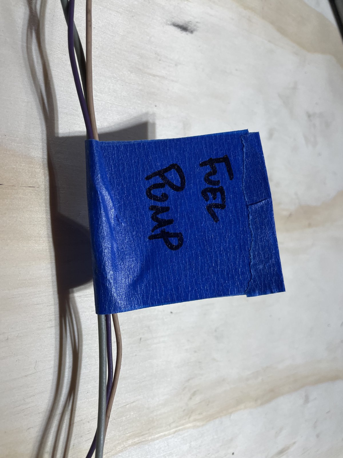

Made it through Wiring Video #4. A couple of items came up from this. I only had 1 wire that did not get labelled from the body connector that gets cut out. At the end of the video Lonnie mentions a pink coolant level wire, did he mean the intercooler pump? Lastly, I have 3 wires for the fuel pump, seen in the second photo, but the video states 2 FP wires.
Edit: If you have means to print the Avery labels, do it. I did not and used painters tape with a sharpie but this would have been much faster and easier to just peel and label.

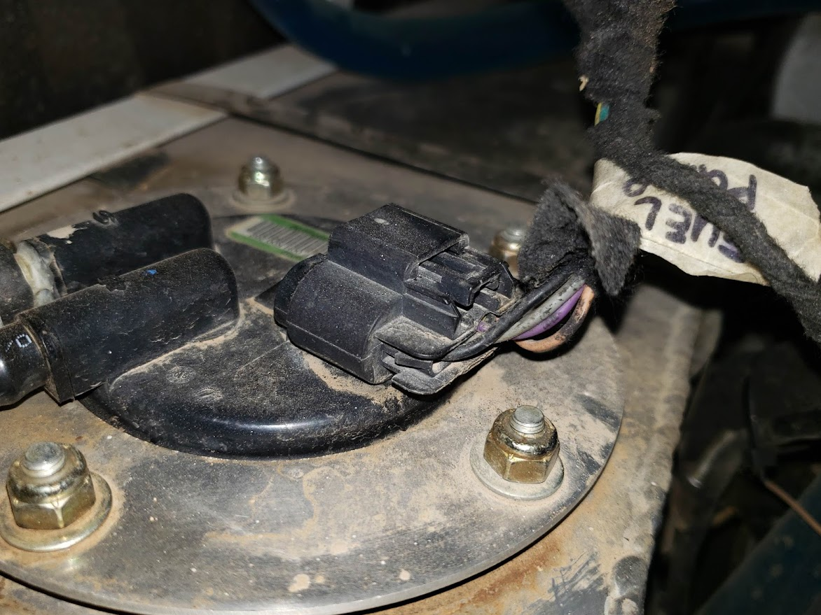

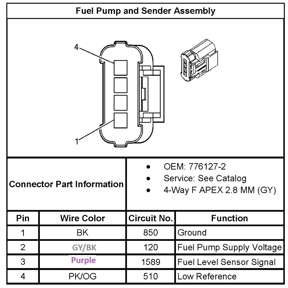

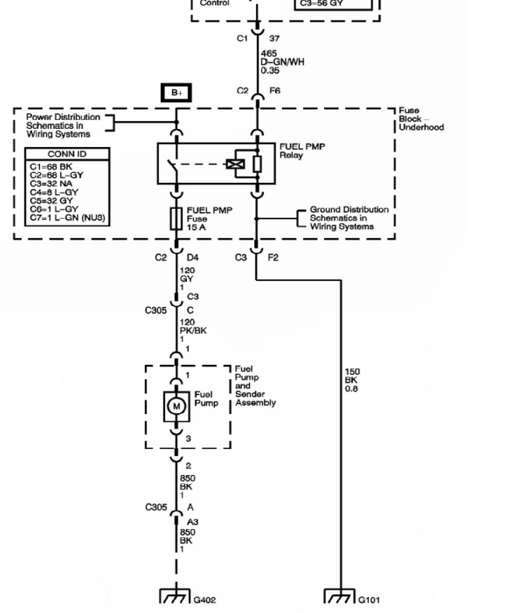

1. Fuel Pump Connector
2. Pink Coolant Plug?
My fuel pump has 4 wires, of which one is pink... apparently it has a black stripe on it, and goes to the fuel pump.
31899
31900
45136
Your picture has 3 wires for a fuel pump, and my picture has 4 wires. So I'm confused as to how they are exactly alike.

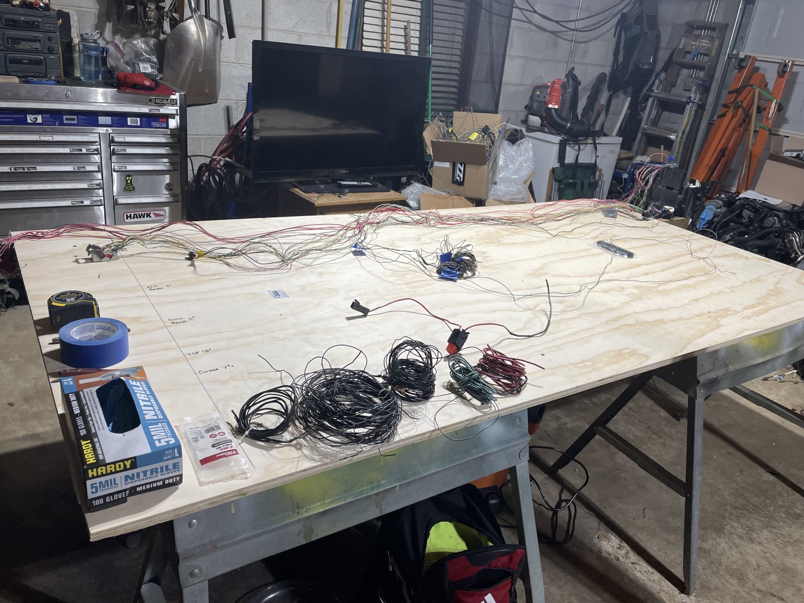

This evening Lonnie and I tackled Video's #5, #6 and made it partially through #7 at which time my children asked for an ice cream trip. A milkshake sounded good and I'm going mad from wiring so this was needed for all. Since I was going to be measuring a bunch of old wires I made a rough jig/ruler for this. I put a drywall screw at 0ft on the edge of the table and measured out increments of 0.5ft all the way to 4ft. This was much easier than trying to measure wires with a tape. A small loop made the wires stay in place on the drywall screw. Amazon didn't deliver something I was going to try today, solder connectors with heat shrink wrapping. My uncle swears by these things so I'm going to give them a try. For today, we just did things the 'old' way. I would get heat shrink wrapping that is a size up from the 22 AWG. By using 22 AWG shrink tubing, I had to fan/mate my wires inline with the wires as they were very tight going across. If it had been a size up (I think 14-20 AWG) I could have just twisted the lines together and soldered like the videos do. This would have been much, much faster. Another thing, the Green and Yellow wires mentioned in Video 5 that runs back to the fuse box are the tail light wires. I spent about 30 minutes watching the videos over and over making sure it should have been them. There were other wires by the BCM that were Yellow and Green for the Ambient Temp Sensor. When you get to video #7 it makes sense as you make the tail light bundles.
A couple items came up from these videos:
1. I mistakenly discarded my fuel pump connector after cutting it out in the tear down. Be sure to keep your as you will need it! This is a $20 mistake but the OCD in me doesn't like that the task isn't completed. For now, the wires and ground are zip-tied out of the bundle and can be mated back in later. So don't be a bobo like me, keep ALL your connectors!
2. In Wiring Video #7 for the headlights, the darker blue wire seemed to run from headlight harness to headlight harness. In the video we cut these, extended and ran to the BCM box. I'm hoping something is mated later in the build.
Thus far, other than the FP harness fiasco and this headlight blue wire question things have ran pretty smoothly. I do know form watching ahead that things are going to slow down as a lot happens in the later videos.
