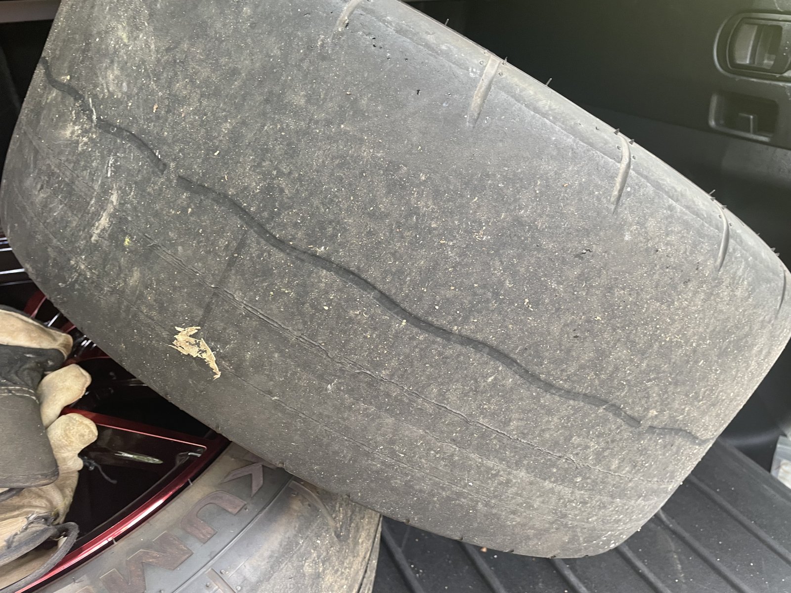

Fresh Meats for the GF24. I think I got a good runout of these. Still just went with 235-40R17 Khumo v730's. Current mileage 14,203 for future tracking.

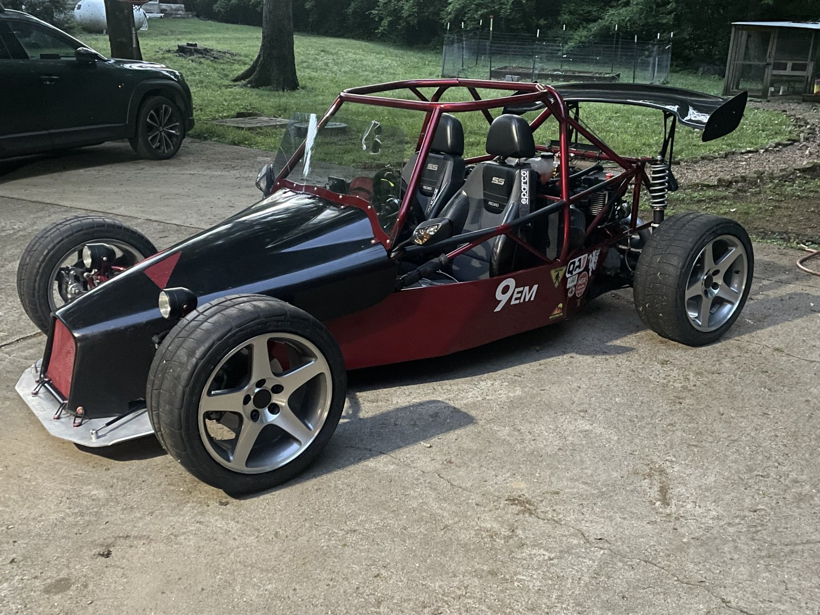

Cut a new wind screen, had it tinted on one side and PPF on the other. Hopefully this will allow cleaning without worry of scratching. So far, it's worked well and I've cleaned it a couple of time. The tint also reduces the nighttime glare from other vehicles.
Installed the new radiator support. Installing the hood with the DF DSUZ nuts is a lot harder now. Have to be careful when removing/installing the hood as the nuts like to catch the splitter. It holds much better than the fender bands I had installed. I still use these just for extra hold and that racer boy look. To be honest, I just don't want visible holes in the hood and splitter from removing them

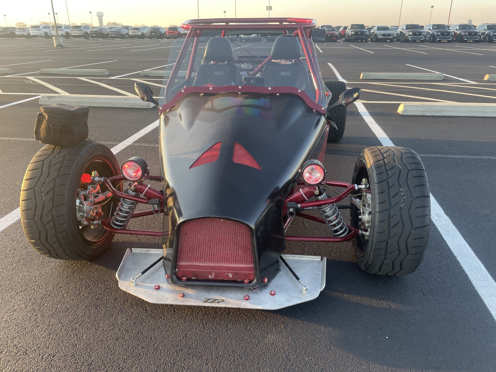

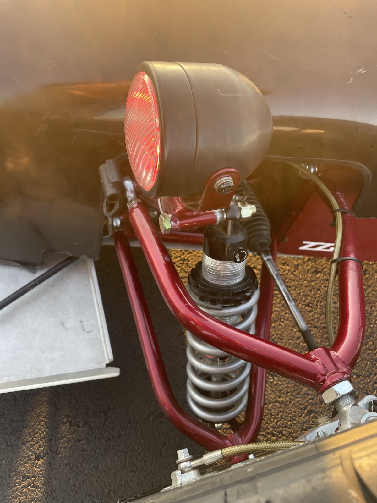

Swapped the burned out Dominator incandescent bulbs for a set of red LED bulbs. When only parking lights are on, it glows red but is completely washed out when the headlights come on.
Installed a new rack this weekend and DF rack limiter kit. The old rack had a dead spot at the center area, this one is very tight. Also, the inner tie rod ends were worn out, they would just flop around. The new rack has tight inner tie rods. While doing this, I slotted the rear damper upper mount holes to the knuckle (just the top one). Camber in the rear is now at -0.5 degrees on both sides. Started with -2.5 (right) and -2.0 (left). Haven't driven at highway speeds but a quick drive down the street everything feels much tighter. Steering response has greatly improved. There is no slop in the steering response that was there even at low speeds. Still running 0 degrees toe in the front and 0.5mm toe in for the rear. I think I goofed on the last alignment and had everything at toe out but cannot find my old measurements to verify. This would explain why the tires wore out so quickly, along with the extreme rear camber. Rookie mistake but it happens. I may remove the front wheel spacers, still debating this one.

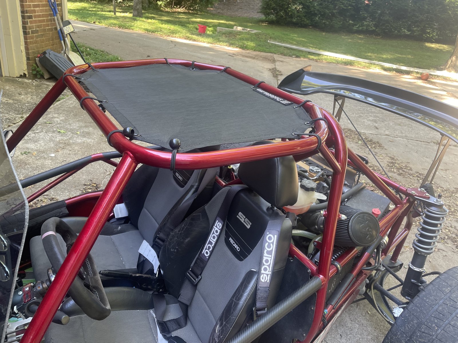

2025-08-28 Added a Shade Idea cover. They now have a shade topper for the extended and shorter version Goblin, so specify when ordering.
Shadeidea DF Goblin Top Sun Shade Roof Mesh Sunshade - Customized

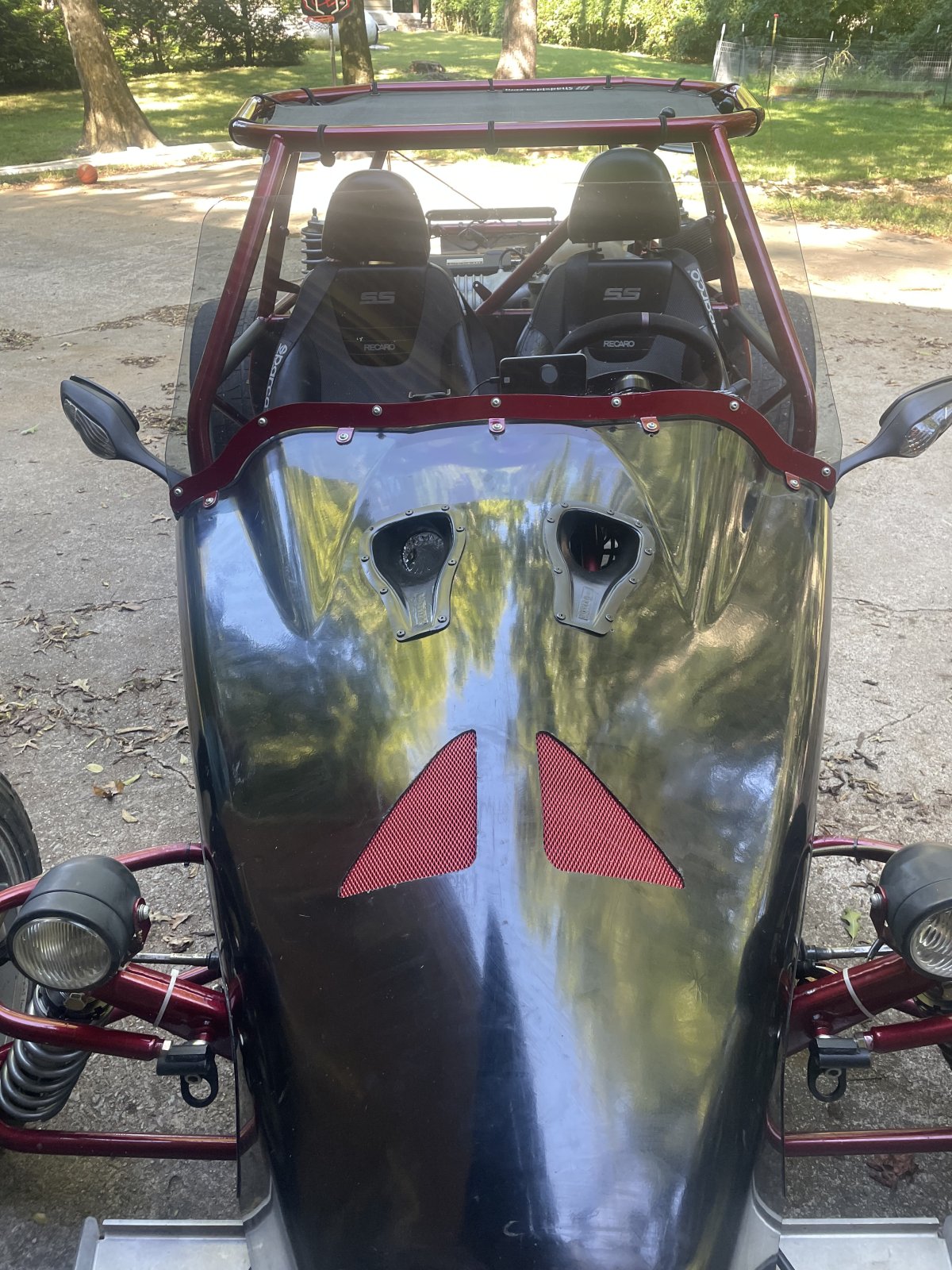

2025-09-05 Added some NACA ducts to works as a cabin vent. You might ask, what do you do when it rains or gets cold? I also have plugs to fill the vents when that time comes. For the passenger side, I also added a bit of 2" ducting, so the air flows to the passenger directly. The drives side had a bar in the way, so no ducting. It works well, the air moves in the cabin are nicely.
Next up is changing the oil, a new pulley belt and other miscellaneous things.

I really like the NACA ducts! That's a great idea! How painful was it to get them installed? My hood is already wrapped. I wonder if I still could do it.
