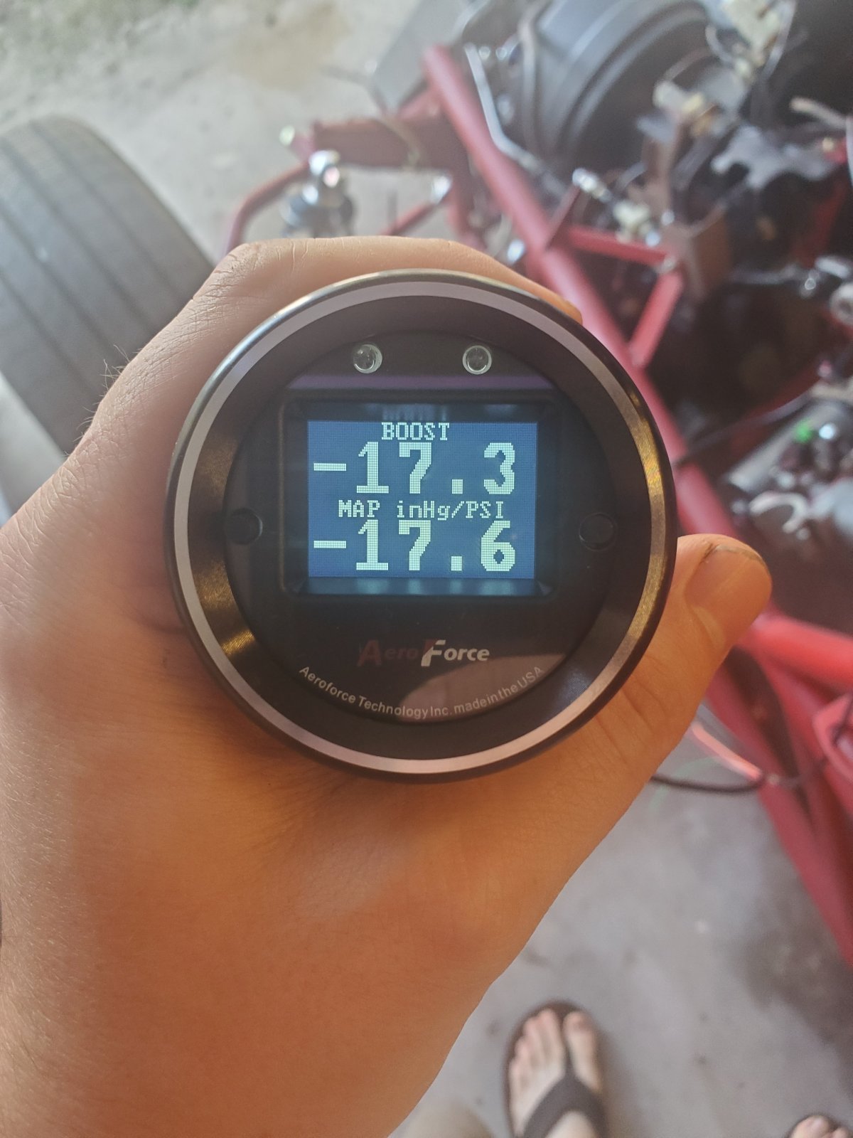

(1 atmosphere) - (17.3 inches of mercury) =
42.7 kPa doesn't really indicate a vacuum leak.

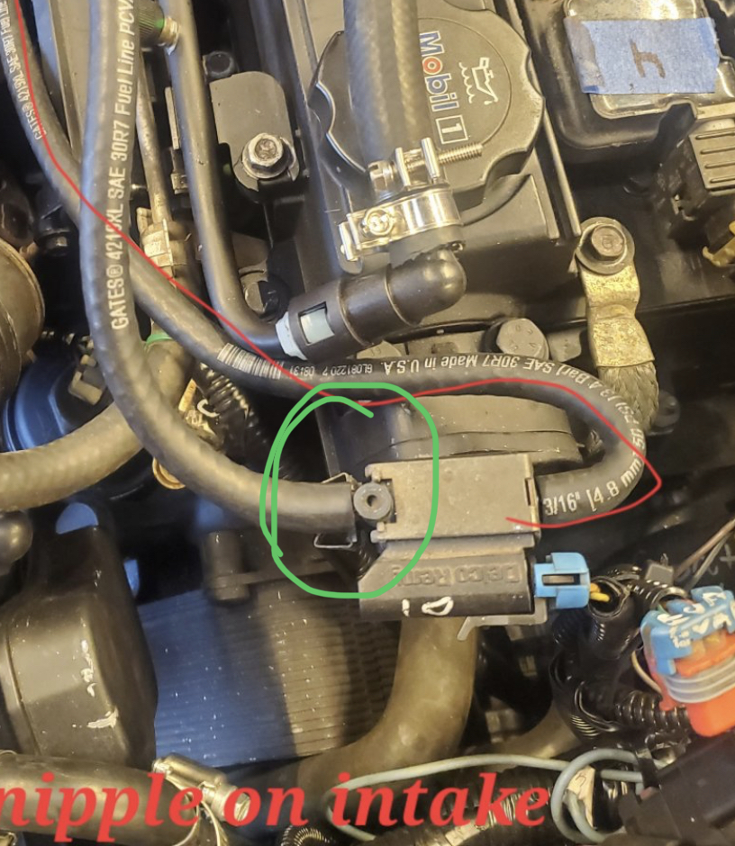

However, the oil cap symptom does seem to point back to crankcase pressure. What's on your barb at the back left side of the valve cover? Can you cover and uncover that port with your finger and get any change?
