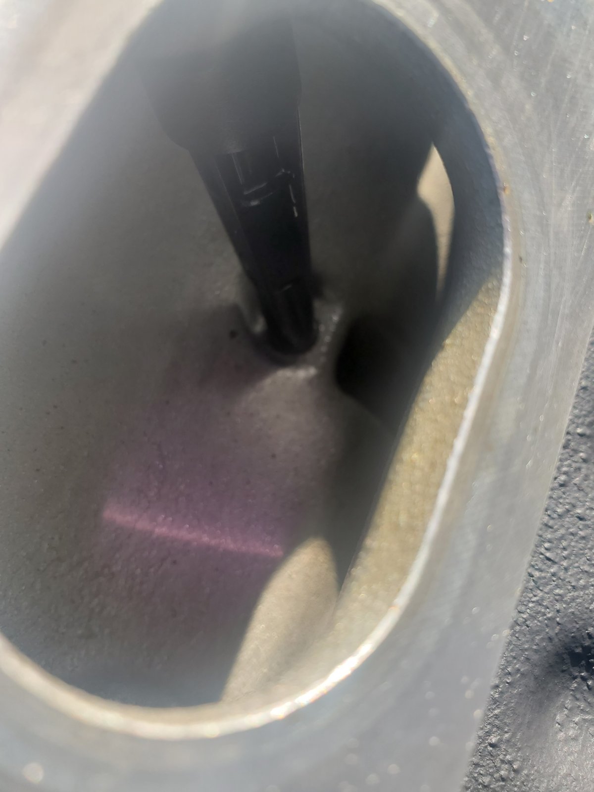

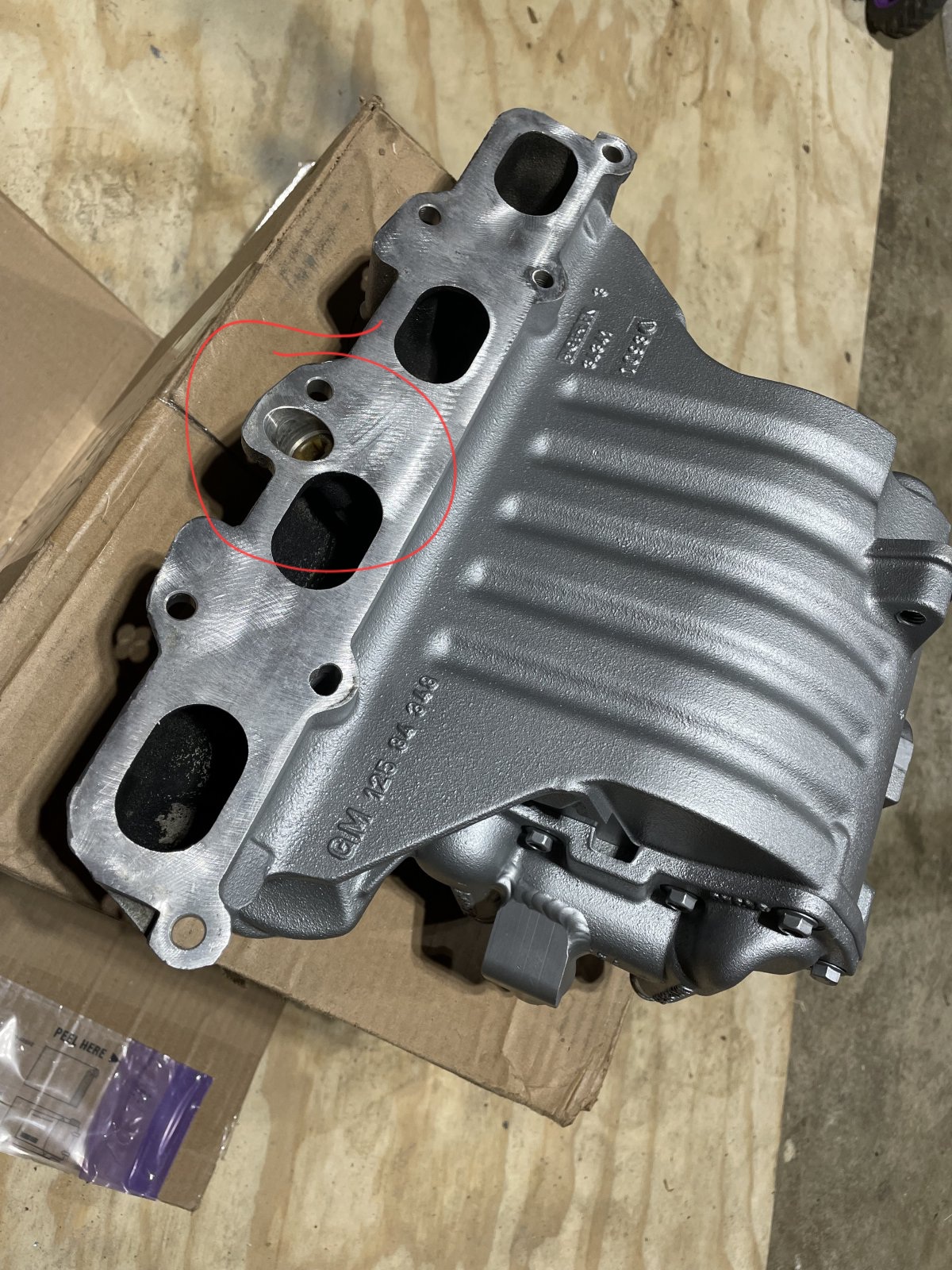

sorry if this has already been mentioned but there is a check valve where the PCV routes back into the intake. is your check valve in backwards? maybe you dont have a check valve, I only know what is there for a turbo engine.
LSJ only has that check valve in the IM and the hose from the valve cover port that's supposed to go to the intake tube.
Have you tried capping the intake at the filter and smoke testing the intake system? I'm not sure if you'll get enough flow past the throttle body to get smoke out of a potential IM leak though.

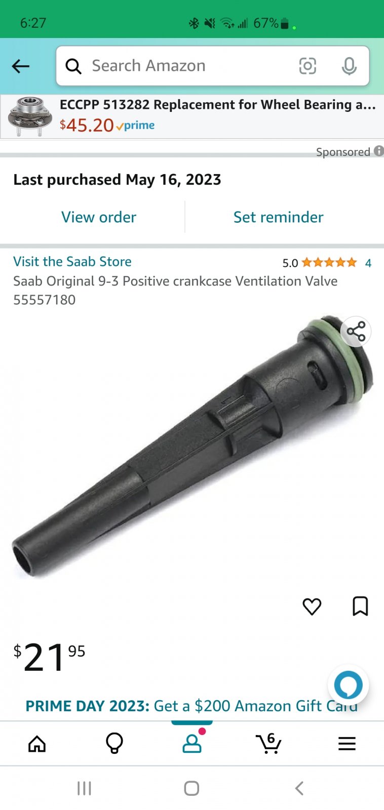

Do you know the manufacturer of the PCV valve that didn't work? Do you have picture of it? It would be nice to document it, so other builders can avoid this issue.
P
This is what I used matches the part number same as the saab part number on saabusa.com they were having some website issue only reason I bought it off Amazon but same part I put in my daily driven lsj and never had an issue. The part on my daily was installed pre-covid so maybe part quality is just garbage now lol

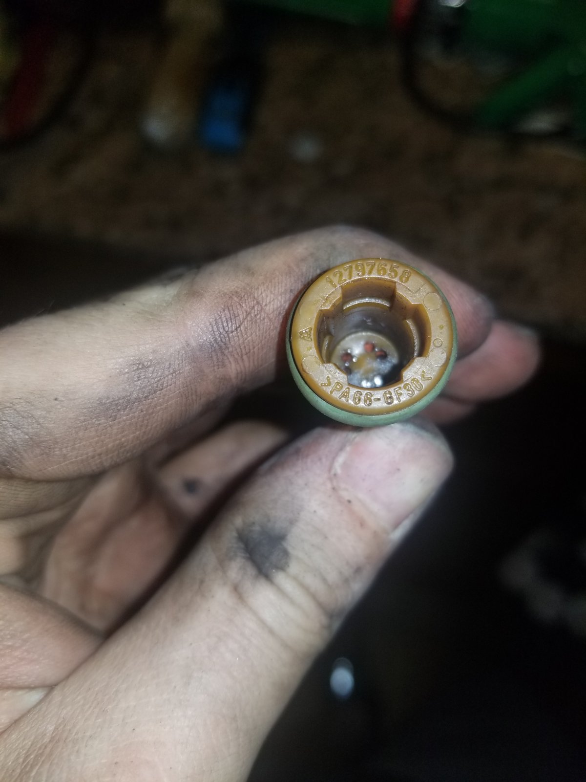

I think this is the one I pulled from my daily a couple years ago part number is different on top believe its oem part and the saab one has the 55557180 stamped on top.
Dale E
Post # 73 is a PCV for the Supercharged Cobalt. This one was discontinued some time ago. I gave Lonny a box with a couple of each in it about 2 years ago, but I don't know if he still has them.
Post # 74 is the PCV for a Turbo Cobalt.
