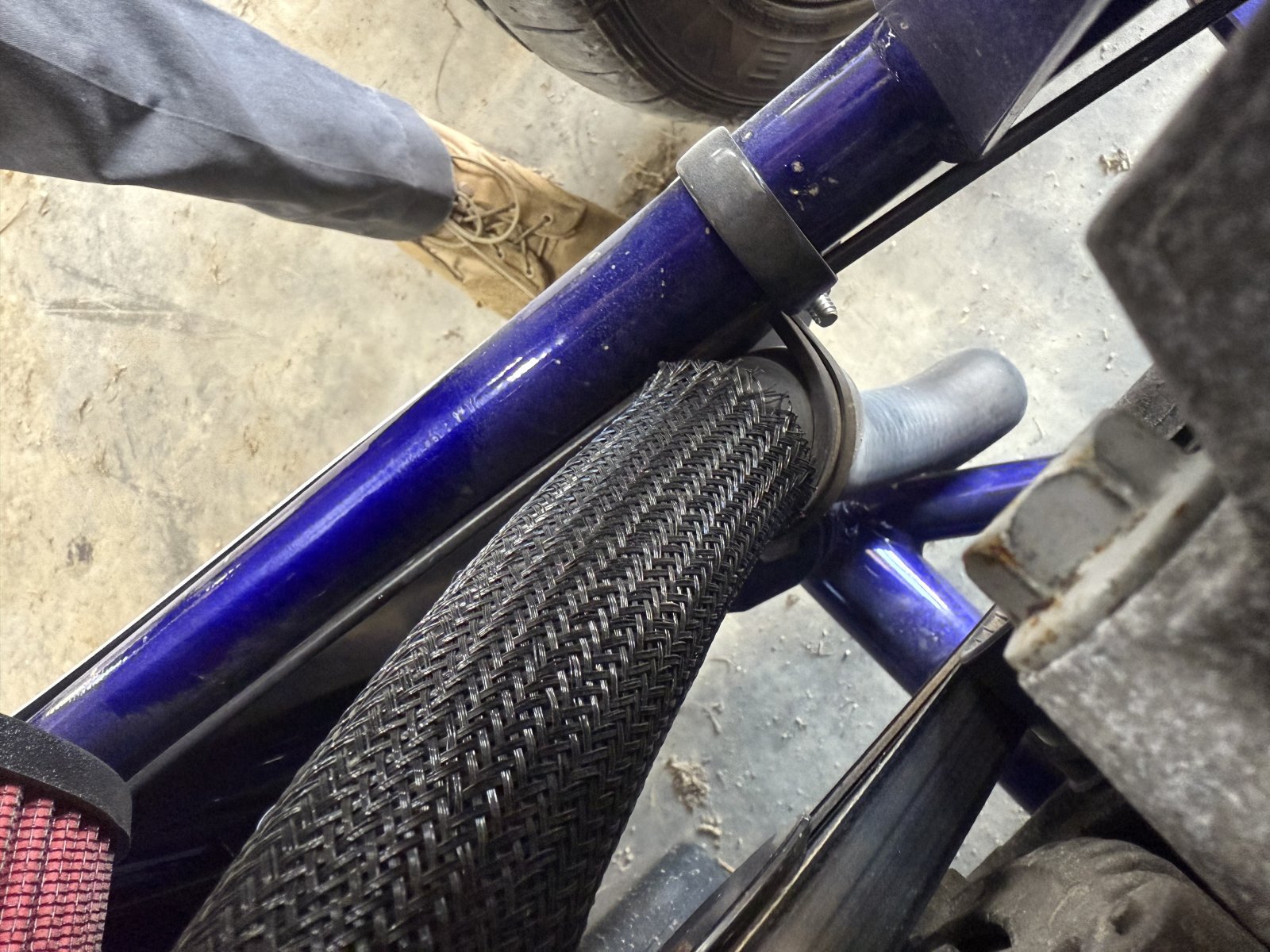

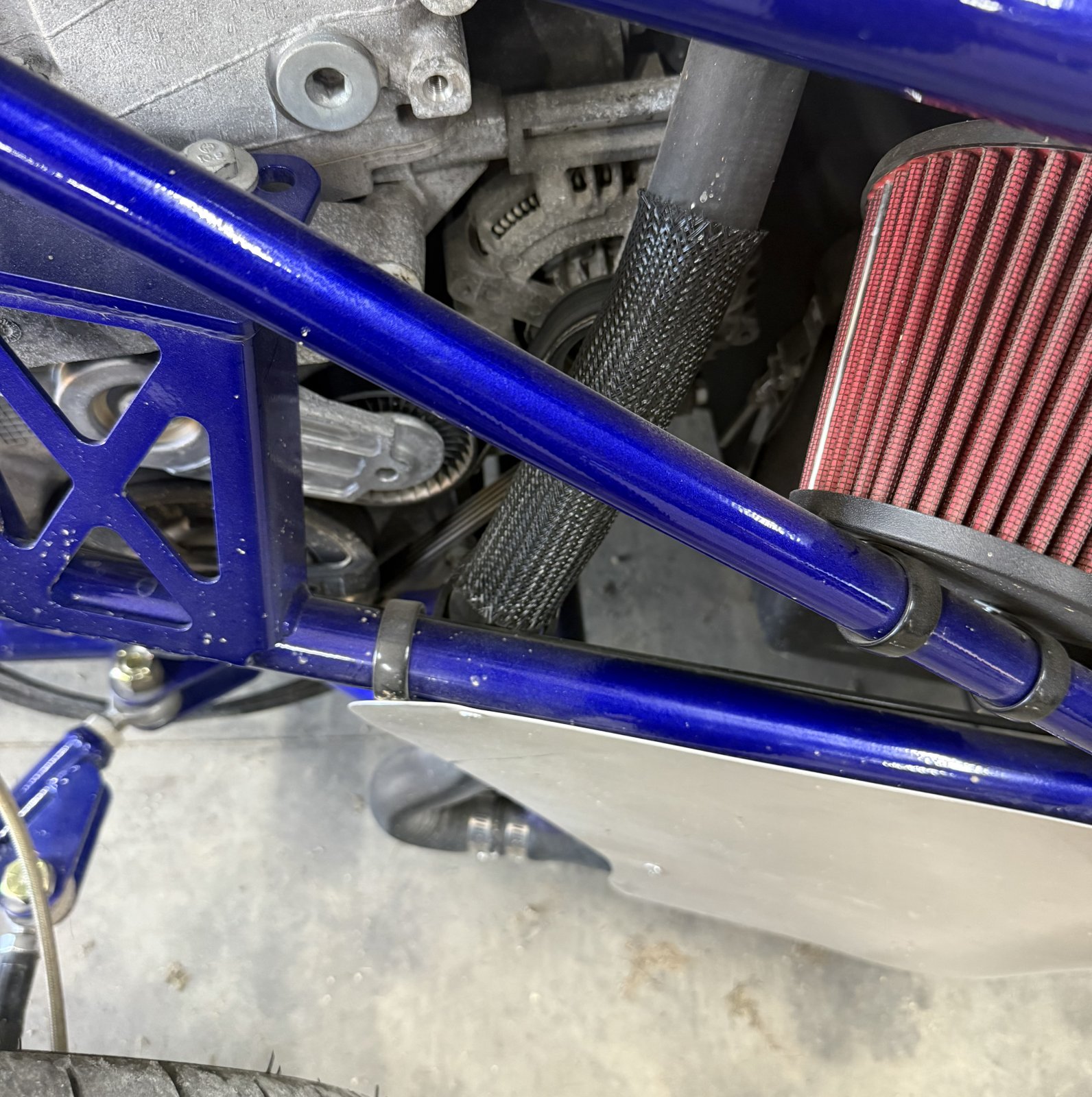

I will be making some sort of bracket to secure the hose and keep it off of the alternator and fuel tank
Markm
Very cramped and a lot of potential big problems from anything being a little bit not perfect…
Not sure if this was the intended purpose but there were two clamps in my kit that I used for this purpose

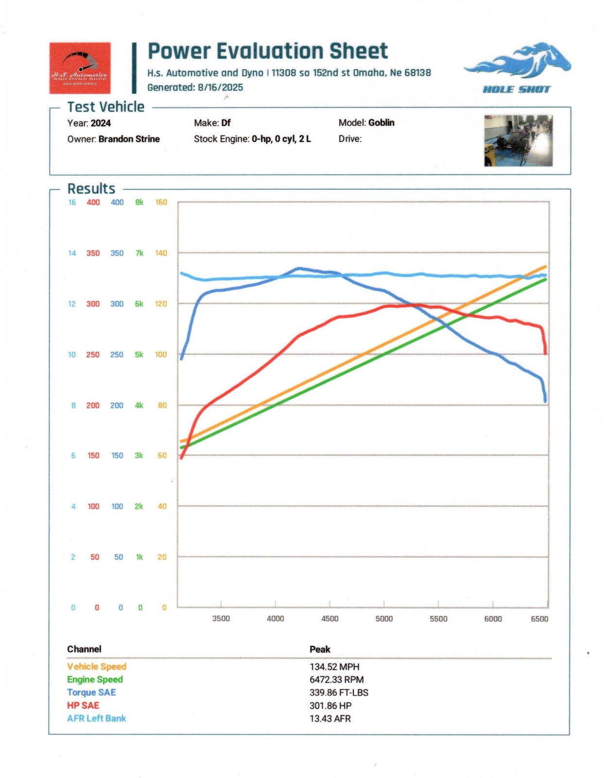

Had the boost gauge sitting at 24PSI the whole pull, It started to get hot I wish I would have been better prepared and brought my laptop to do a data log. I'm really curious how hot the iat2 was getting with that long of a pull.
It is significantly less power than I was led to believe I would end up with but I'm not mad about where it landed.
With the traction problems I'm having more power isn't the answer to anything.

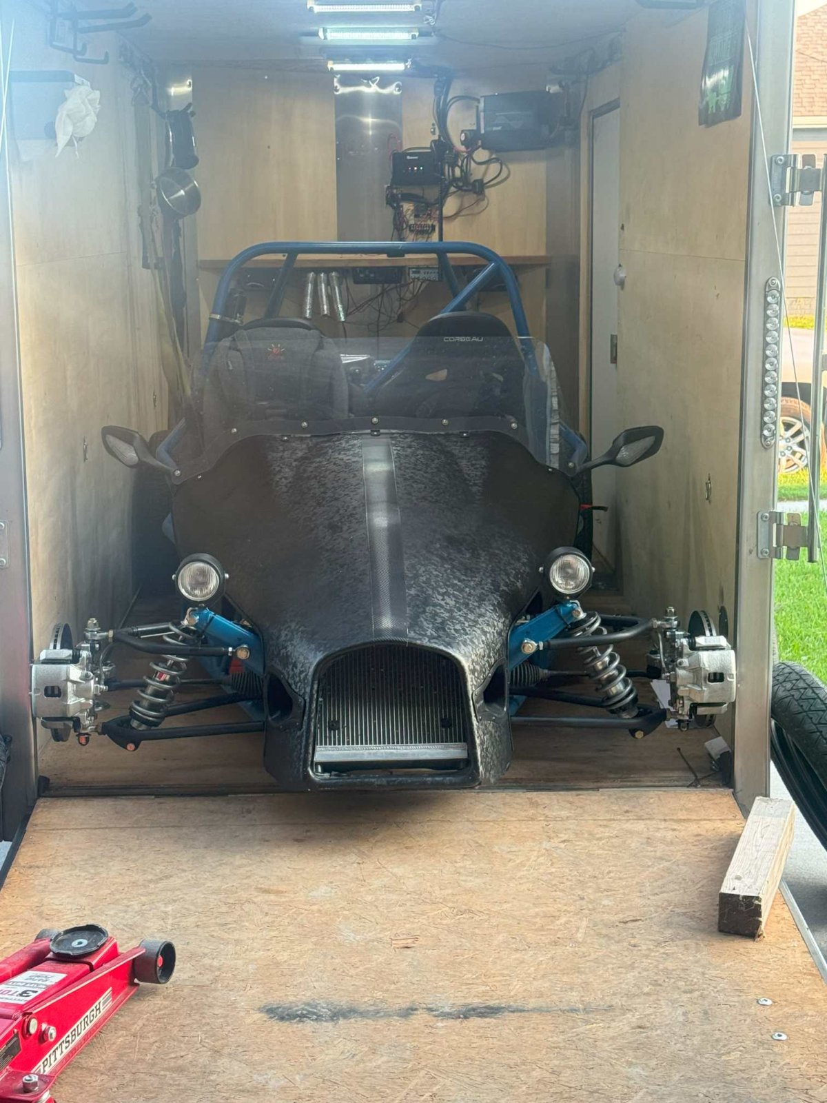

I have proof the Goblin can fit in the trailer.
The donuts fit past the cables on the liftgate but not through the door.
I had to jack it up and set it on a 4 wheel dolly, I then jacked it up again and set the frame on a 4' 8x8 (not the block in the picture, that was a tire chock while I grabbed the jack...)

Healthy for RWHP and Torque! These figures are nothing to sneeze at and are probably pretty good, given the temperatures you believe were occurring. :D
