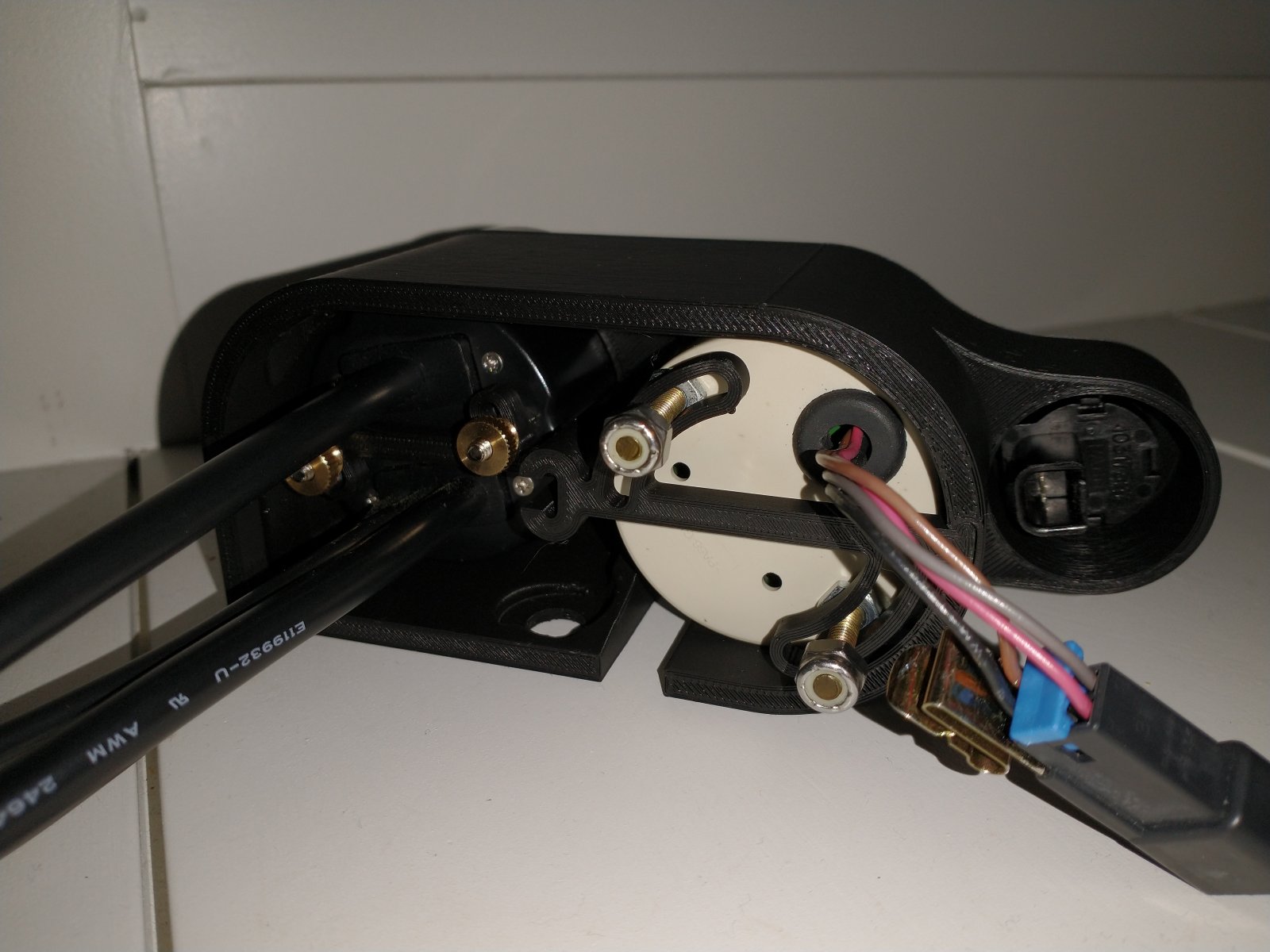

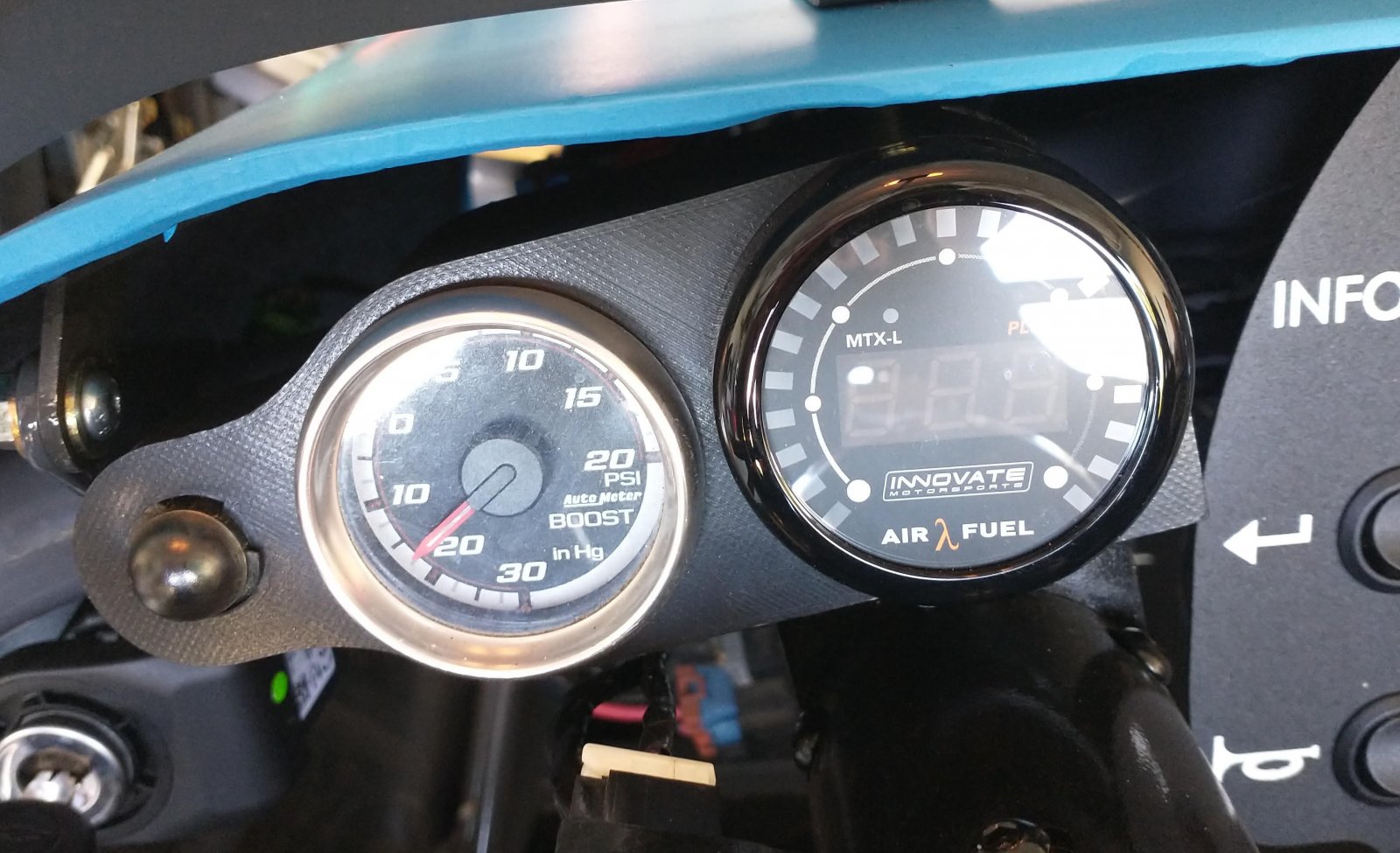

Figured it was time to share this with the world. Here's my 3D printed gauge pod. I want to redesign the location of the ambient light sensor. Right now it's centered in height to the gauges but it kind of gets in the way of the hood bolt in the very left of the picture. It looks a tiny bit goofy with the lines running parallel to the steering column mount instead of the hood line, but whatever.
There was a little tab on the side of the ambient light sensor that I snipped off prior to install; besides that, it slides in and locks into place with 1/4 turn just like it was installed in the dash, I guess.
The pieces that the mounting studs are screwed down onto are removable, so I could actually swap the gauges from side to side if I wanted to, or reprint just that piece if I swapped out a gauge. I've got it in my mind that I could make more than 20 psi one day so the stock boost gauge would have to go. Then again, reprinting a part is a drop in the bucket compared to installing engine parts, but whatever. They also (obviously) allow for the gauge to rotate so I can lock it in at the right rotation.
The PLA has held up just fine so far. The thing mounts with the steering column mount bolts (which I replaced with the same hardware about 1/4" longer). I sliced in Cura with 100% infill in the areas under the bolt heads, standard settings everywhere else. I cranked down on those bolts pretty hard and they seemed to torque just fine (and there's thru holes on the top of the gauge pod for easy wrench access!), so I'm not worried about the steering column mount going anywhere. I considered printing around a metal insert but so far I'm convinced that would've been overkill.

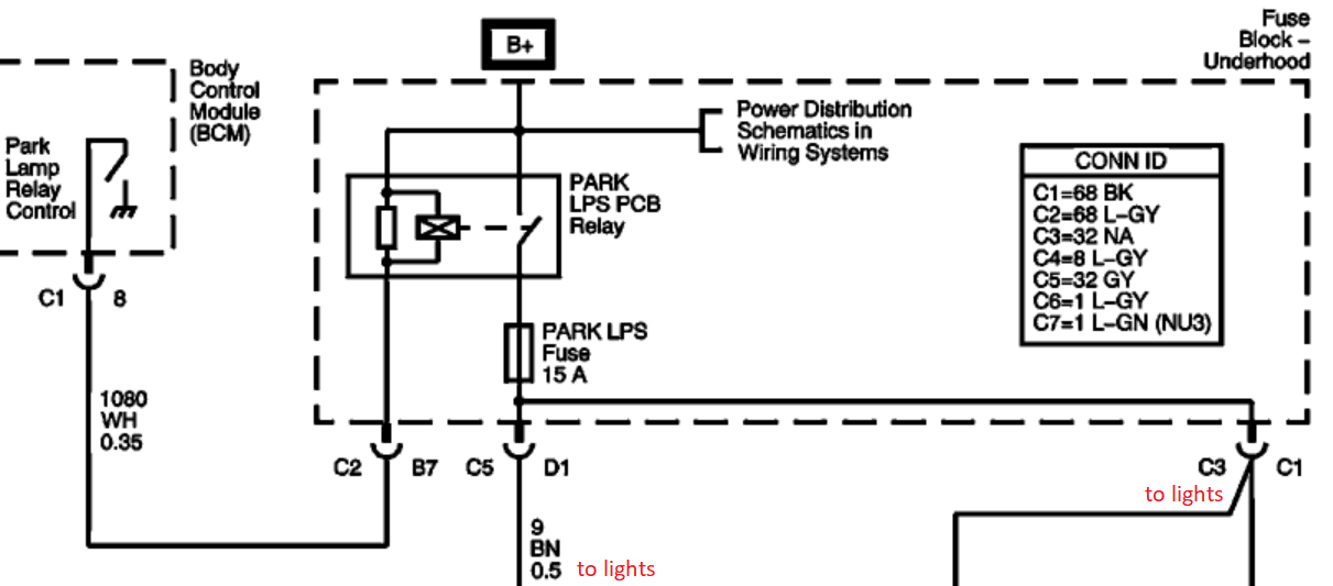

Strange electrical issue. Three times now separated by a few days each I've hopped in the car to go for a drive and had no parking lamps, aka running lights. Every other light works on the car- low/high beams, turn signals front and rear, brake lights. I don't have tail lights, license plate light, backlights in the cluster, or the marker lights in the mirrors. There's a fuse for all of these lights, but the fuse is not popped. With a multimeter, I have no power on either side of the fuse with the lights turned on. From the diagram there's a PCB relay in the fuse box that sends power through the fuse and then to the lights, but it's non-serviceable. The real kicker is, though, if I flash a tune, the lights come back. Disconnecting the battery or pulling the PCM fuse does not bring the lights back. Anyone have any ideas?
The only taillight stuff I might be missing is load resistors for the actual lighting elements. I do have the hyperflash turn signal going on, but I don't think the turn signal circuit has anything to do with the park lamps. I do also have the load resistor in the third brake light (not sure if we ever confirmed it's actually necessary on an '06), so cruise control works just fine, but again, as far as I can tell, the CHMSL shouldn't have anything to do with the parking lamps circuit.
I will try getting a multimeter to the backside of the fuse box to see if the PCB relay for the circuit is being triggered by the ECU.
I think the two biggest pieces of info here are that there's not even power coming to the fuse for this circuit, and flashing a tune brings everything back online.
You mentioned a fuse box PCB relay can turn the circuit on. That is how the software can turn the lights on and off.
Is it a fusebox issue, or a software issue? I thought we can take the fusebox apart to the circuit board... as people have fixed copper traces when they incorrectly jumped the fuel pump relay.
I can and probably will take the fuse box down to the circuitboard but for starters I figured I'd see if I can get my multimeter to C2 (from the BCM) to see if the BCM is sending any signal to the relay to turn the lights on. I suspect it's not, and the issue is software, because flashing a tune seems to fix things.

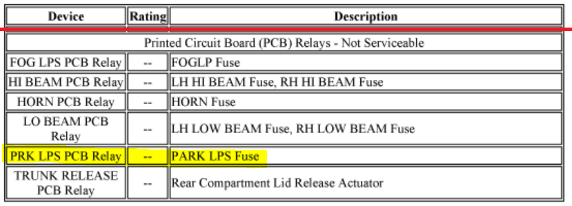

The park, tail, and marker lamps, including the license lamps, are turned ON when the headlamp switch is placed in the PARK or HEADLAMP position, or anytime the headlights are requested. The PARK LAMPS fuse in the rear fuse block supplies battery positive voltage to the PARK LAMP relay switch contacts. The PARK LAMPS fuse in the rear fuse block also supplies battery positive voltage to the PARK LAMP relay coil. When the park lamps are turned ON, the body control module (BCM) energizes the park lamp relay. Current flow is from the PARK LAMP relay to their respective park and marker lamps and to ground. Ground is provided at G101, G102, G401, and G403.

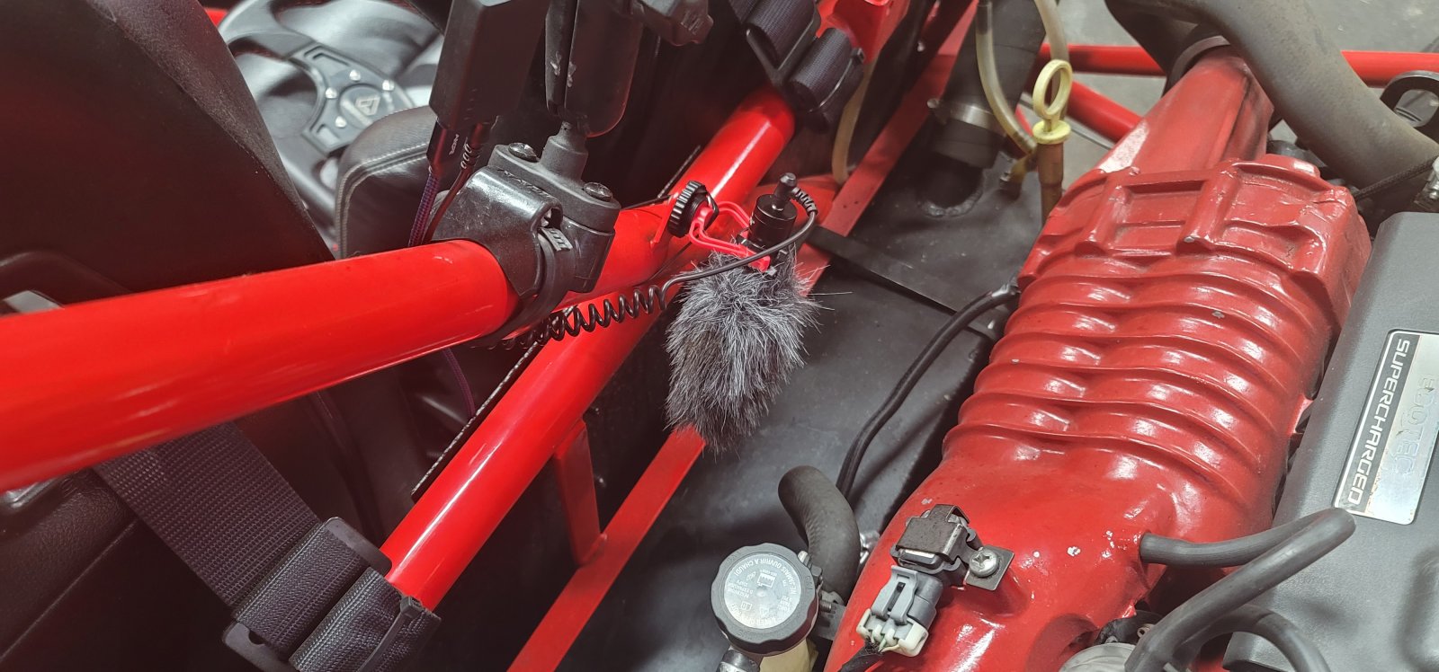

Video quality was ok on my old GoPro, but audio is garbage. Not sure if I'd be better off running an external mic and syncing later or getting a newer/better GoPro, but I'd rather not get a newer/better GoPro if it's still going to require some external mic setup. I've come across recommendations for running lapel mics but I'm not sure that's going to sound much better at these volume levels.
DCMoney
Autocross playlist
My last run was the second fastest of the entire event, 55 cars total... until my codriver went immediately after me and bumped me down to third.
Go external mic. Hero 7 black with the below external mic, mounted to one of the engine cover brackets.
