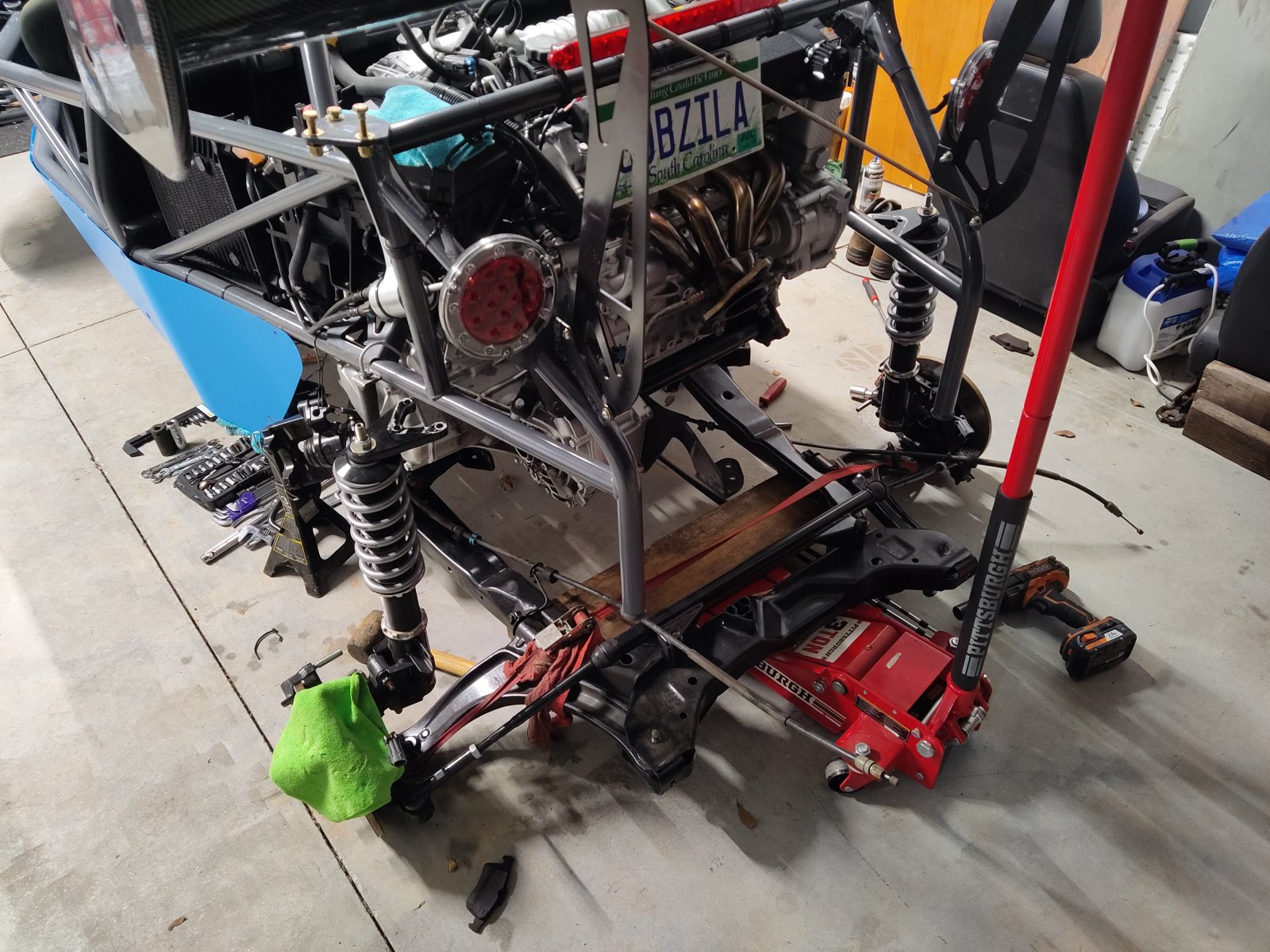

The teardown begins...

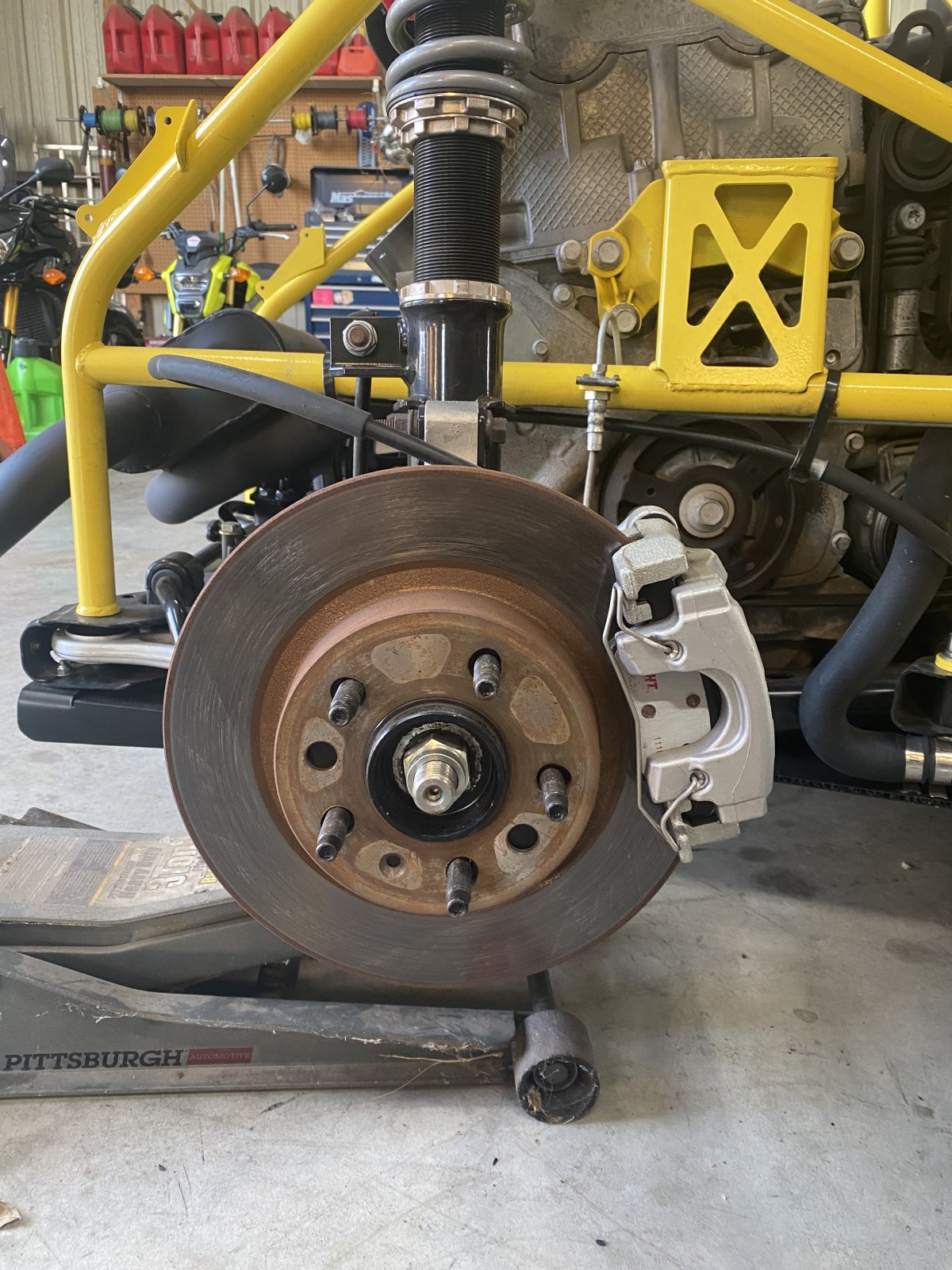

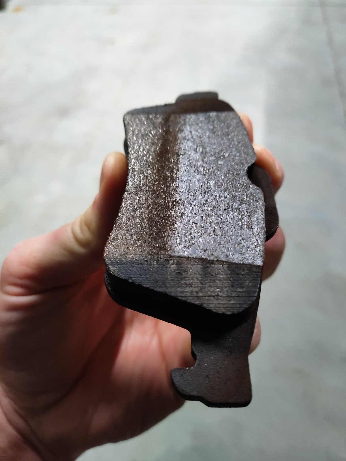

Looks like the outer brake pad on both sides of the rear is sitting a little less than flat. I have the Solstice parking brake setup. Could the spring that sits on the outside of the caliper influence this? They weren't sitting quite the same on the left and right sides of the car, although the pads wore about the same.
I too have this issue, but only on the drivers side that I recall... Up until very recently I was on completely stock brakes running w/o the vacuum assist to the booster.
Brake bias and vacuum regulator are on my list of things to do after I get the car back together, then I might worry about it a little bit more. Currently working on an F23 swap and the new DF shifter among a few other smaller things.

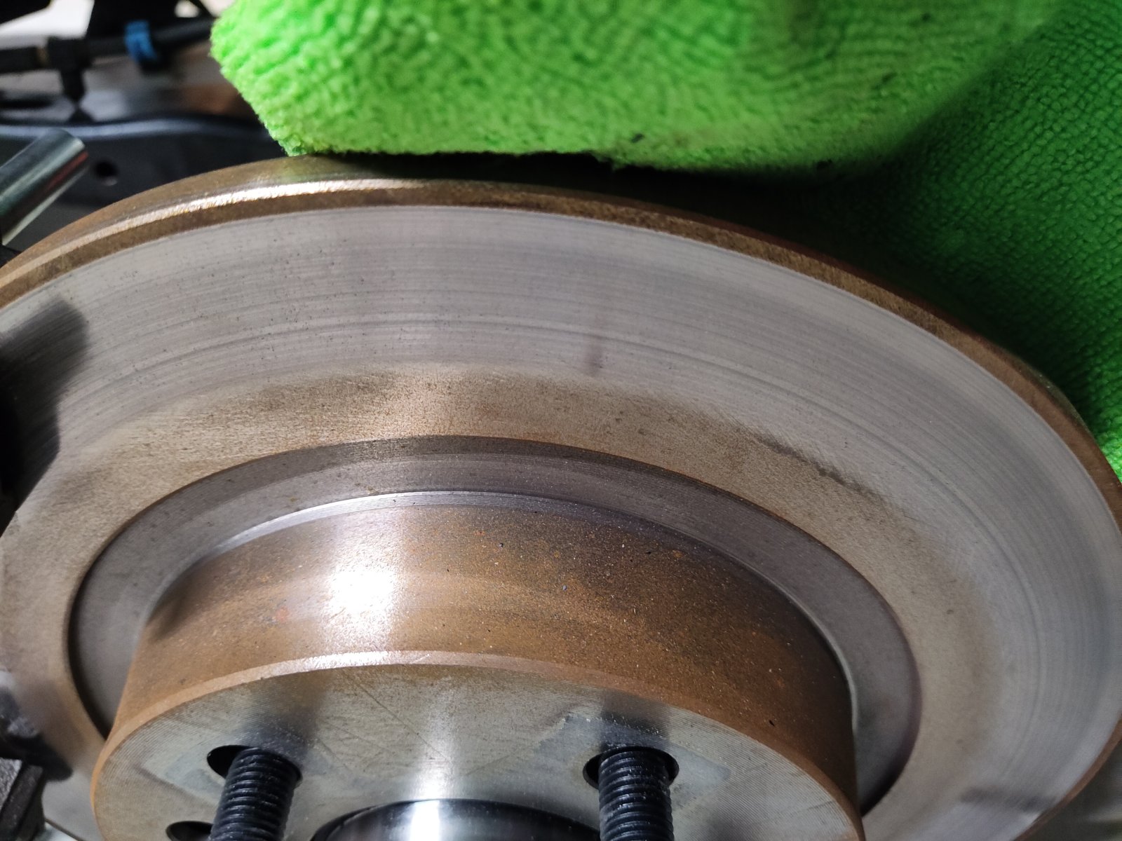

It’s happening because there is almost no pressure back there. Look at the rotors. They have never been hot or burned in. Here’s what mine look like, with brake proportioning.
KSLunsfo
That could simply be it. Perhaps I'll know more when the weather improves a bit. I now have the wilwood manual master setup with a proportioning valve in the front line to dial them back. I just have not made any adjustments with it yet.

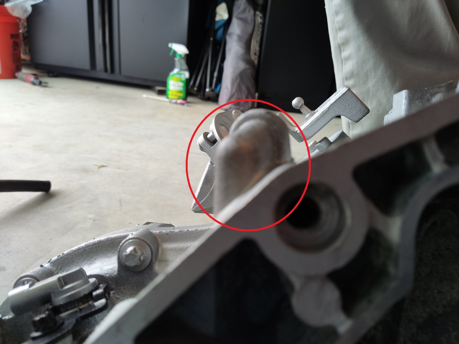

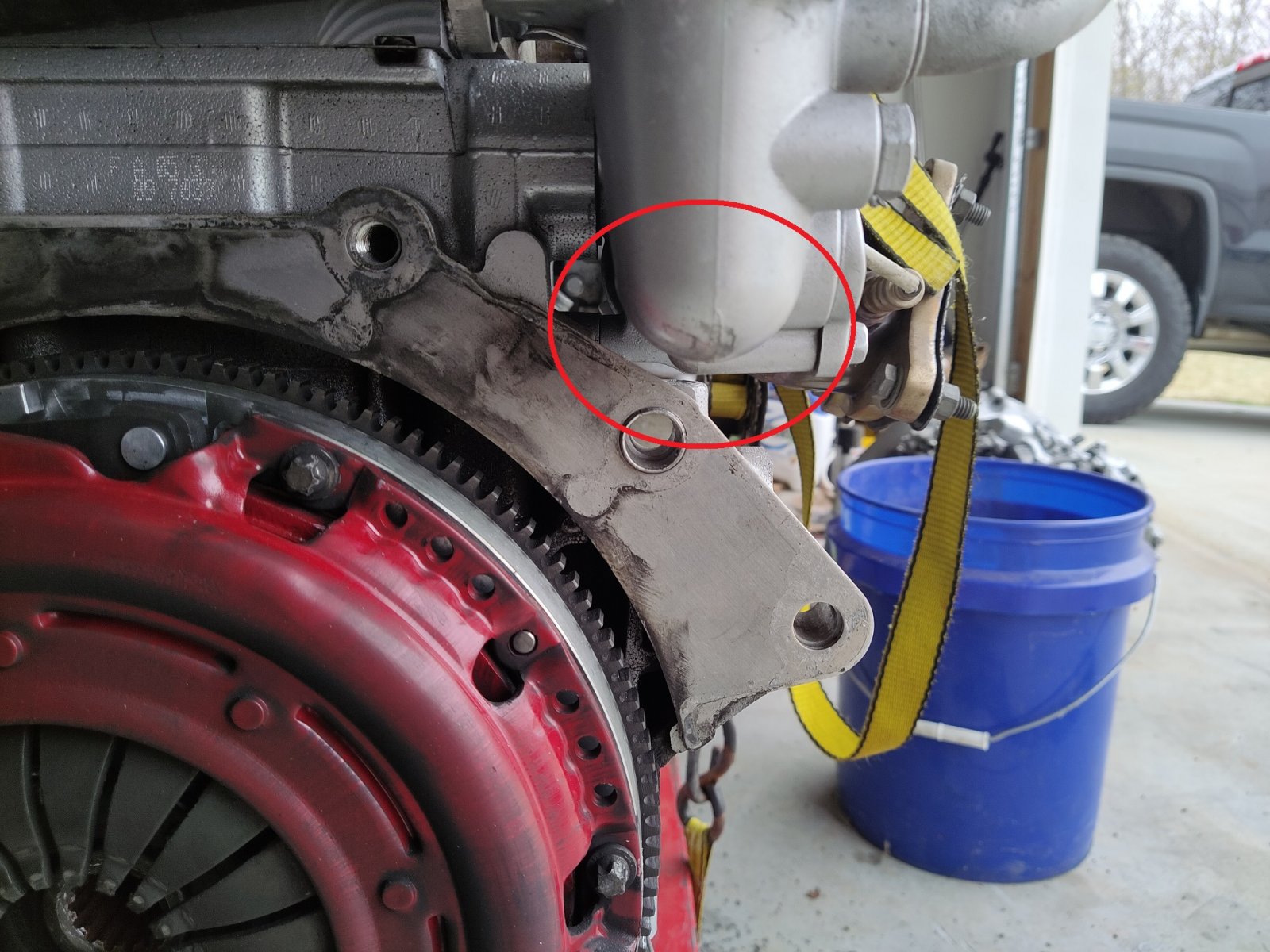

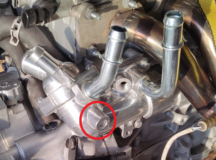

Working on my F23 swap, the shifter cable bracket mount boss is colliding with the thermostat housing. I believe this is an LSJ specific issue. I've read in a few places that grinding can take care of this, but I'm not sure that enough grinding to clear is going to leave me with a solid mount for the cable mount. Has anyone come across pictures or documentation affirming that enough clearance can be created without compromising the cable bracket?

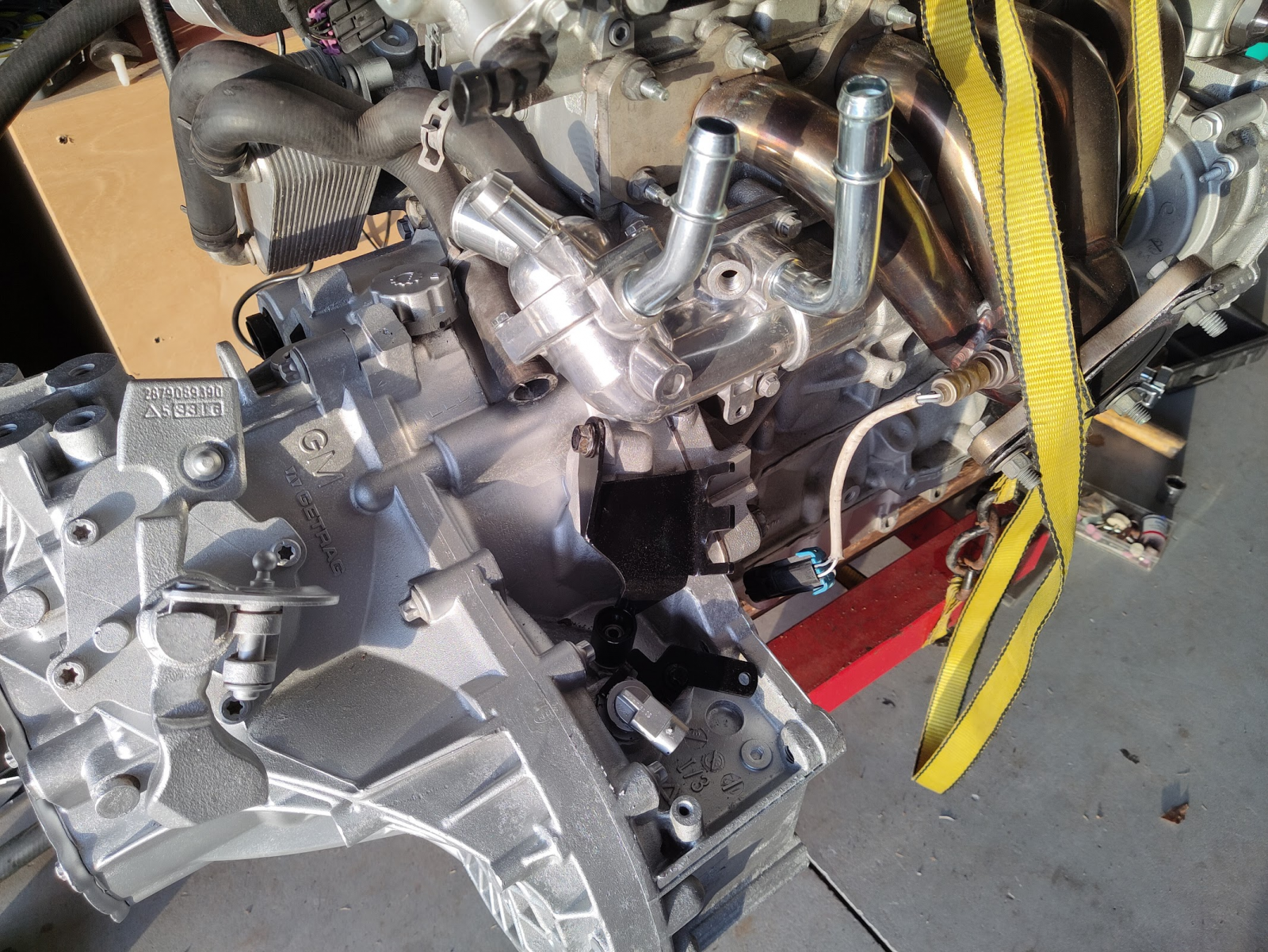

Alternatively, I could swap the thermostat housing to any other Ecotec thermostat housing. An LNF would require re-plumbing the coolant lines to the oil cooler, whereas I believe any L61, LAP, or LE5 thermostat housing will not have provisions for an oil cooler. Is that correct? I'm not sure if running the heater core lines to the oil cooler is advisable. If running an NA thermostat housing, I could swap out the OEM oil cooler with an external. My only reservation is that's putting more distance to getting the car back together. Eh, I could deal with it.
Base model thermostat housing installed, F23 installed. Still have a little work to do to get the oil cooler plumbed back up, but I have LNF-esque tees for the radiator return line and the line from the neck to the overflow tank.
32032
The rightmost heater core tube in the photo is really close to the header tube, any plan to remove the heater core tubes and tap the t-stat housing for plugs or alternate fittings?
The LNF t-stat housing looks similar and putting a looped hose on those tubes is something that I'm looking to get rid of when I get to that point (someday). :cool:
I'm pretty sure the only difference between a base model NA thermostat housing and the LNF is this boss is tapped for the coolant line that goes to the turbo. I never had issues with coolant temps with the looped line on the stock LSJ thermostat housing so I doubt I'll bother here. I'm sure the coolant isn't picking up radiant heat from the header, and the aesthetics don't bother me much. If picking up heat from the exhaust were an issue, the crossover pipe would be a bigger contributor by far.
As far as I understand the heater core connections can't be plugged.
