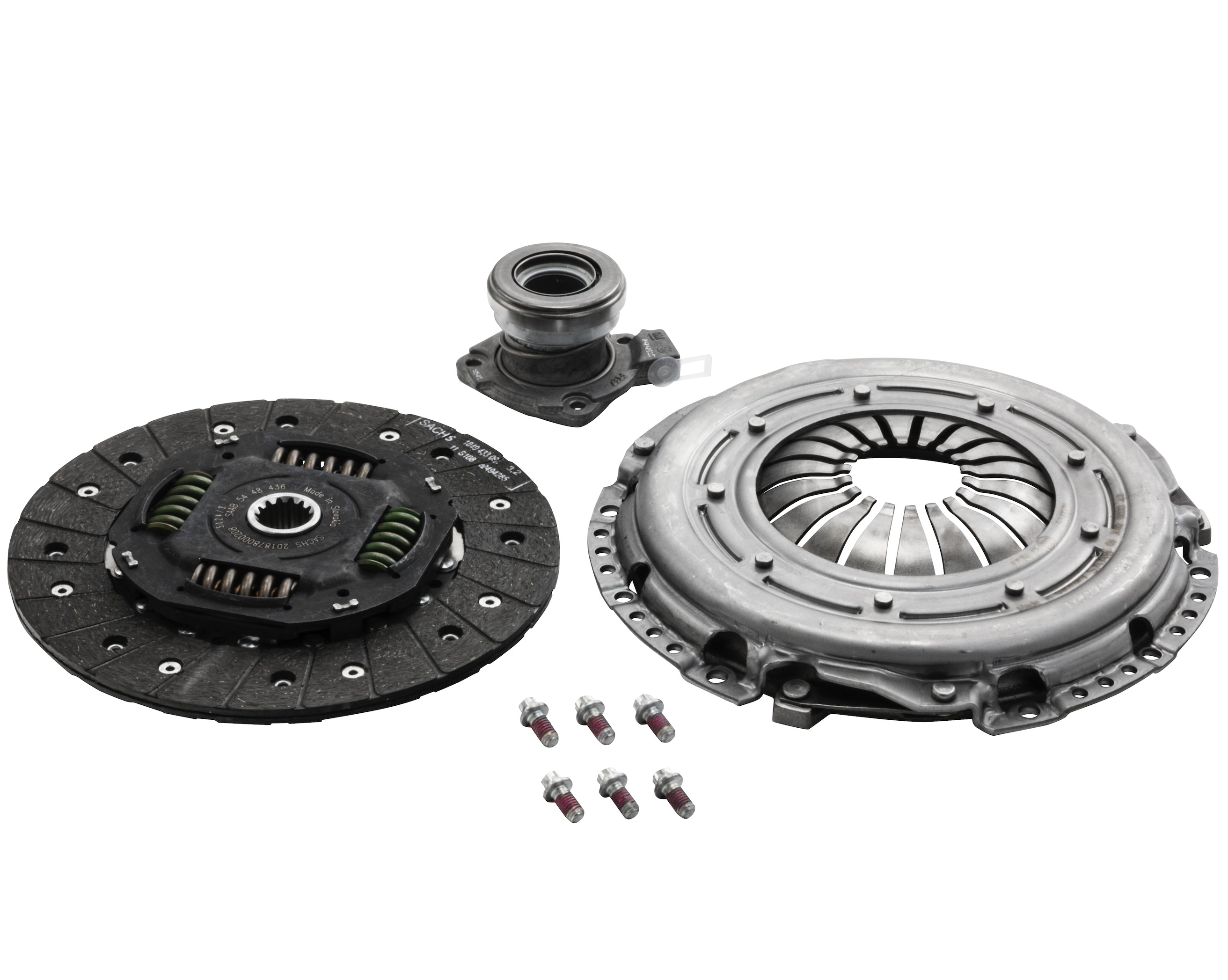

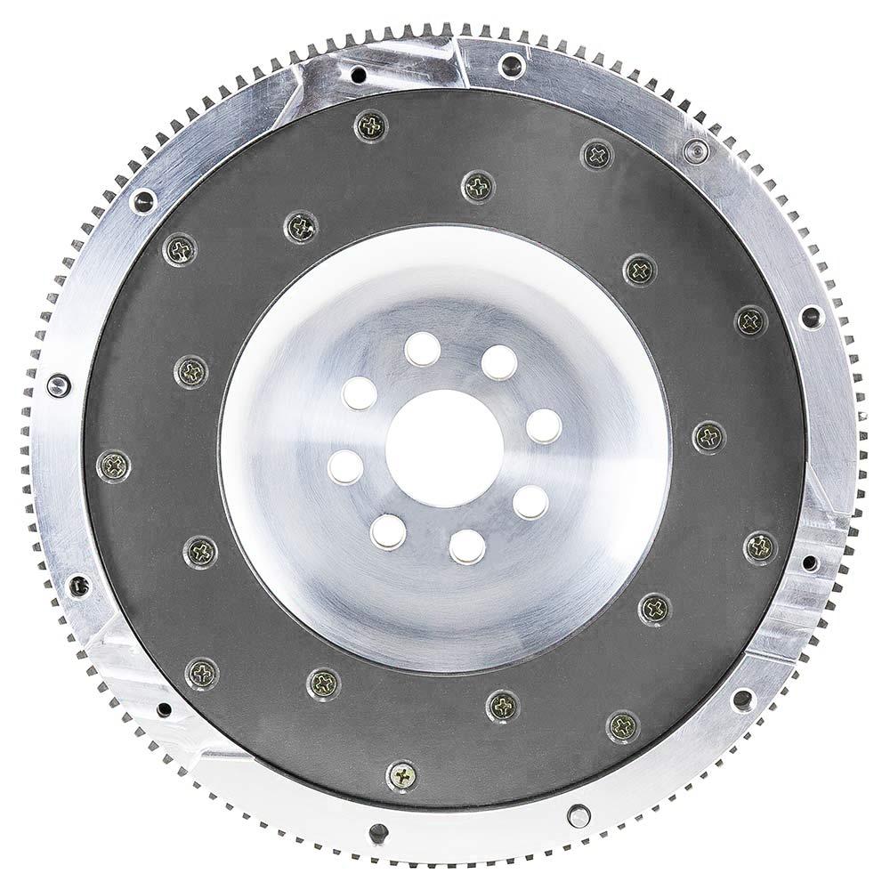

I just had “ZZP GMPP and a ZZP Aluminum Flywheel 2.0” Delivered last week, this will be the first clutch that I’m replacing so I’ll make a video of my attempt, the process seems fairly straightforward?
Anyone have any tips I may not be aware of?
Nothing to note except it can be difficult to find a way to secure the flywheel while torquing. Oh, the flywheel only goes on one way. The holes only line up right with one hole configuration.
Be sure to fill the trans fluid while on the ground. If you do it with the rear in the air you’ll overfill it and it’ll throw fluid everywhere.
When you put the whole thing back together and go "oh no I forgot to replace the pilot bearing!" ... there isn't one lol
ZZP threw a clutch alignment tool in my order when I bought a clutch and flywheel from them. If you don't get one, they make things a lot easier. I think there's an .STL if you have access to a printer.
No particular catches with regards to the clutch or pressure plate on this powertrain, though, aside from the usual catches regarding clutch hydraulics.
One item to be aware of, the spacing between the pressure plate fingers and the TOB. To much space and the piston in the TOB could leak or even fall out. I would assume since you are buying a matched set this should already be taken care of by ZZP. You are getting a new TOB?
Jareth
Yes, comes with new TOB but not alignment tool, I bought that separately.

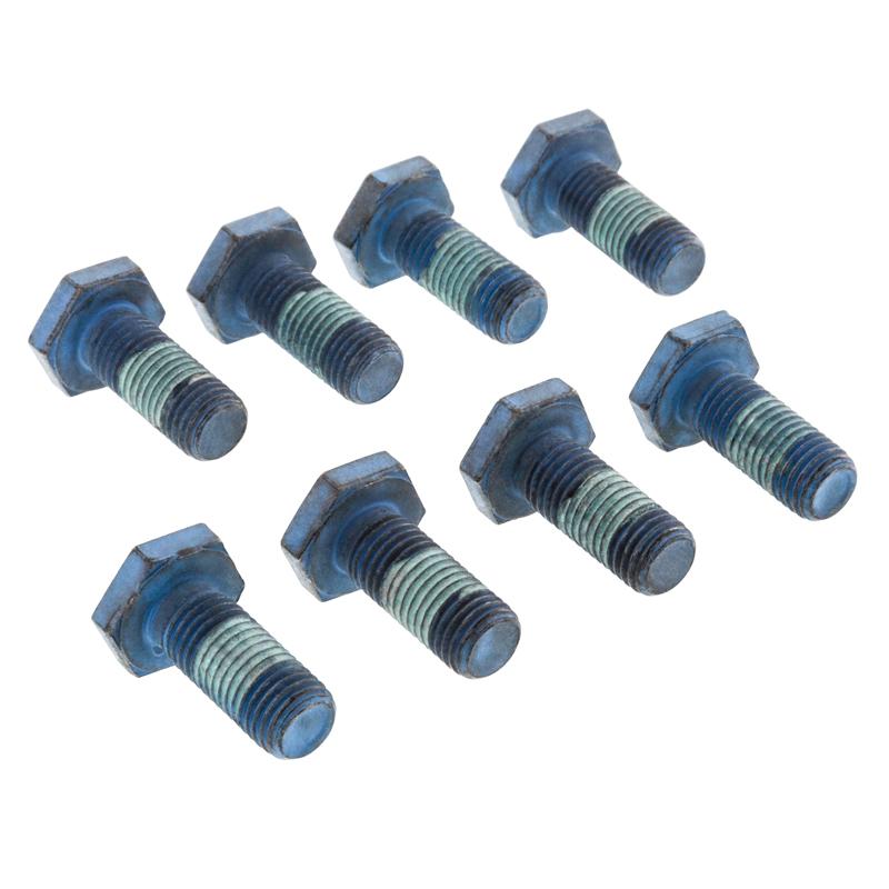

These may be the most expensive Bolts I have ever purchased.
poZAdVuWj
The flywheel bolts on the Ecotec are stretch to torque, so they can't be reused (at least they shouldn't be), so everyone gets to pay double what other platforms pays for these bolts. I'm in the wrong business - should be selling bolts and raking in the big $$$!!!
