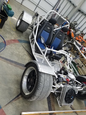

I cut the fenders in half, and set them roughly in place.
Going to have to fabricate my own mounting hardware.

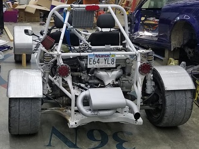

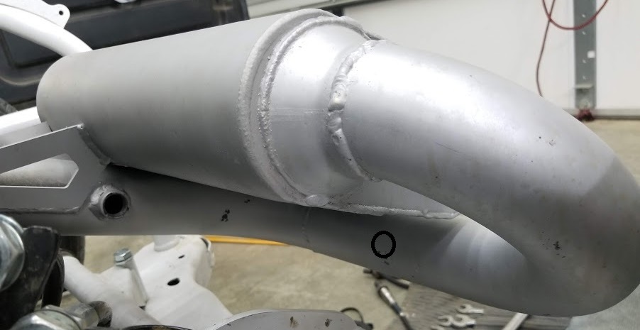

I wonder if the 2nd O2 sensor could be welded in a new location, to serve dual purpose.
Since our cars don't have catalytic converters, I don't think it needs the signal from the second O2 sensor,
but the threads are the same as a wideband O2 sensor, which is useful for tuning engines.
The current location for the second O2 sensor is not optimal for an AEM wideband. They suggest at least 18" away from the exhaust port (to keep it from overheating), and at least 10 degrees from horizontal (so condensation drips off), but not vertical.
So my suggested location below is where I plan to weld a bung on the exhaust. Hopefully I have enough room to weld it there.

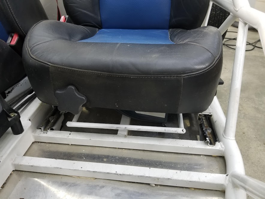

The front slips thru the slots in the aluminum floor. The stock seat hooks need to be filed at the front to get rid of the front bump.
9763

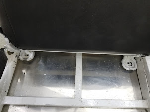

The rear uses 2 bolts to hold it in (No bolts shown in my picture). I did have to grind the outer sides of the seat's bolt support bar about 1/4" to make it narrow enough to fit between the frame.
9764
Great info, thanks. I'm contemplating keeping the Recaro's from my donor, they look pretty nice but the driver side one is a little "frumpy" on the edge.

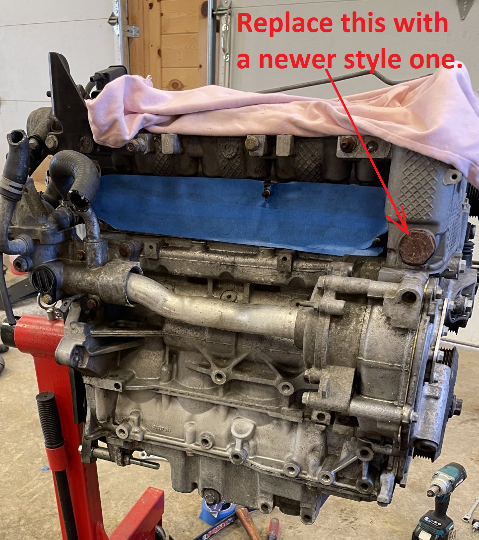

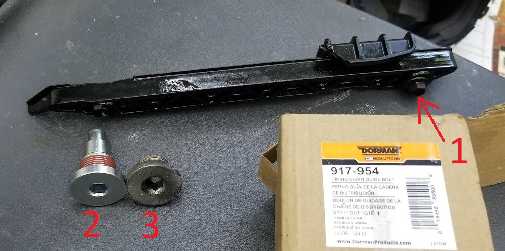

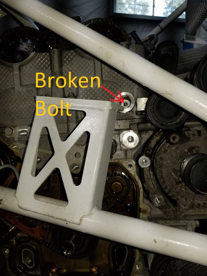

I bought a new timing chain tensioner, which should be an easy replacement,
but I found a half a bolt in my head, that should be holding a timing chain guide.
Drill, (never) easy out, wish me luck. (Update: Don't remove the broken bolt, just buy the updated Dorman part to fix this)
Looks like the chain guide has no wear marks on it, so it either broke right after it was replaced, or the last owner left it this way.
I don't see the other half of the bolt anywhere... but I'll run a magnet in the oil pan.
All this, and a autocross that I want to go to on Saturday...
9766
Wait, you've been driving the Goblin haven't you?? Did you just really luck out and the timing chain hasn't skipped at all?
DCMoney
Not a lot of risk of it jumping timing because of the bolt missing, that guide isn't putting pressure against the chain keeping it in time.
Sorry, shades of my own motor problem got me there. That's the guide that was completely destroyed in my old motor, laying around in 4-5 pieces behind the timing cover.
Yes, Ark :D, your engine pics inspired me to replace the timing chain tensioner. After removing the old tensioner, my chain skipped a few teeth on the sprockets, so I removed the lower engine cover, to reset the chain markers. Then I discovered the guide bolt issue. Luckily, Dorman has already made a better part, as this bolt was breaking on lots of EcoTec engines.
9768
Originally the LSJ had bolt 1, and bolt 3 covered up bolt 1... but bolt 1 broke. Bolt 2 is the new Dorman 917-954, and is a lot bigger and beefier, and replaces both #1 and #3. Best of all, I didn't have to remove the old broken bolt threaded into the head. Just install the new bolt 2 thru the black guide.

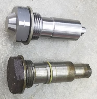

Apparently you need a soft bump with a hammer to set the timing chain tensioner.
9775
38132
Today I purchased my 2nd tensioner, as the first one broke.
