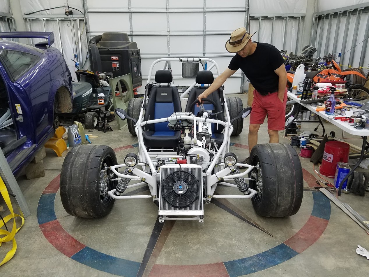

but they are Nitto NT05R Drag Radial Tire - 315/35R17
Barely street legal, useless in the rain, noisy, poor gas mileage, all the qualities I want!
I don't know about the NT05r but the NT01 is an awesome tire if its the NT01 compound its bound to be great. Care to share your backspacing measurements ?
You bet! Page 5 mentions:
Backspacing: 173mm on the wheel, and a 39mm spacer.
I'm getting a wheel alignment on Monday, and I need to tell them the specifications.
Do I have all the info I need? Would you do anything different?
So far it is:
Ride heighth: Make the bottom swing arm horizontal when loaded with 2 passengers.
Camber: 1.5 degrees, front & rear
Caster: 9 degrees +- 0.5
Toe in: 1/8" per wheel width (26")
I am wanting the wheels aligned for driving on the street, not aggressive track.

Sounds good.

Looks good ! Is 9 degrees caster normal for the Goblin ? I think normal in the corvette is between 5-7 I know if you go too high it can make it harder to steer.
Have you studied any oversteer understeer charts ?
Our mr2 Spyder can be very darty at times it takes some getting used to the different yaw points. We run 0 toe all the way around. If I drove the car on the road I would likely toe it in at least 1/16 to 1/8 on all four corners to stabilize it.
I just use string line, toe plates and camber caster gauges at home because I got tired of having to redo alignments. Once you get used to it it’s hard to trust an alignment shop to get it where you want it.
I think they do so much caster because the car is so light on the front - only 600 pounds with a 200 pound driver in it.

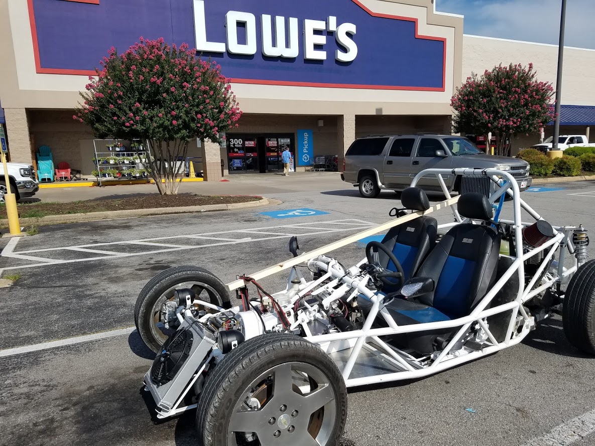

My Goblin has been on the road a week, and my daily driver is getting serviced.

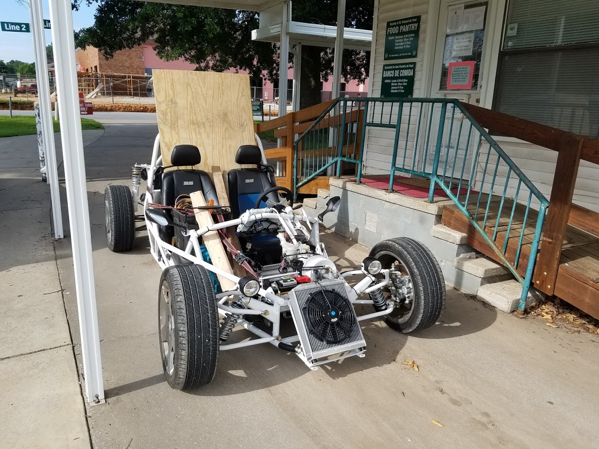

Time to test if it can be used as a truck.
9325
3'x5' sheet of plywood, check.
5 2x4s, check.
Box of tools, check.
Skill saw, impact driver, drill, power planer, extension cords, check.
I needed another 2x4, so off to the hardware store.
9326

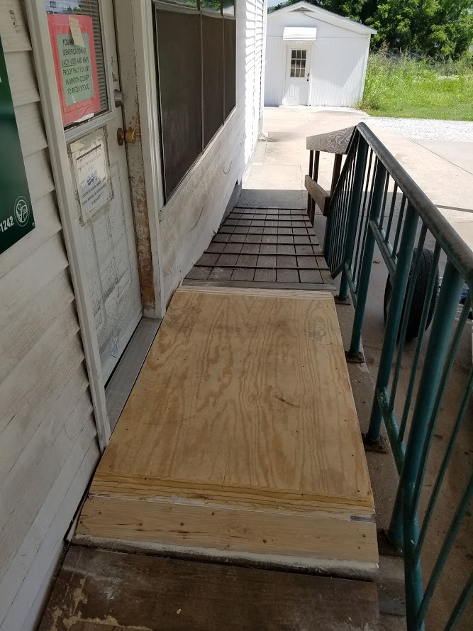

And in the end, the local pantry got a newly raised front step, that is grocery cart friendly.
Priceless.
Goblin truck, check.

Today I put on the wide tires, and took it out for a test drive.
The power steering cut out after 5 minutes of driving. It turns back on when I restart the engine, but cuts out during the first turn.
Bad power steering motor? Maybe thermal cutout? It didn't feel hot to the touch. It worked well on the 215mm tires, but doesn't like the 315mm.
It is a lot more stuck down to the road.
Brakes still able to easily over-power the available traction, but it will put you on the seatbelts.
First and Second are a lot more stable, power induced wheel spin only under heavy usage (/abuse) of the controls.
Cornering is going to take some more learning - it is quite a turning machine.

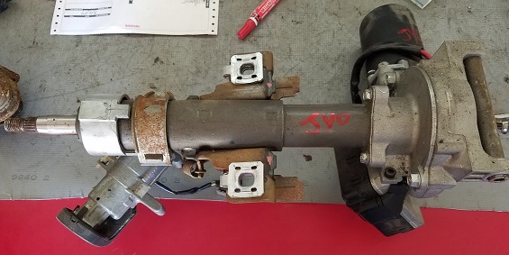

Bought a used power steering unit from a local auto recycler for $60
9439
Put the motor on, and it worked better.
Test drive with the small tires, and it is working.
Test drive with the big tires, and it is working!
Problem solved. Not sure if the big tires will wear it out early, but I will find out.

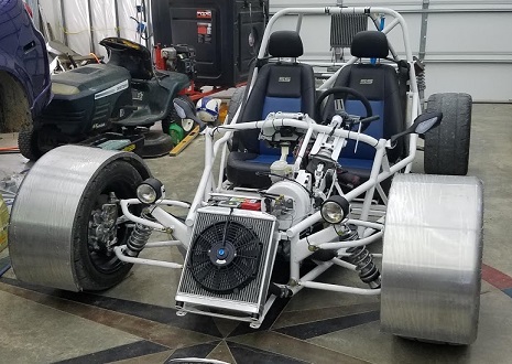

My custom 13" wide aluminum fenders arrived.
I ordered 2 extra long fenders so that I could cut them in half, and make 4 short fenders.
But I placed the long fenders on the front to see the "mad max" look.
