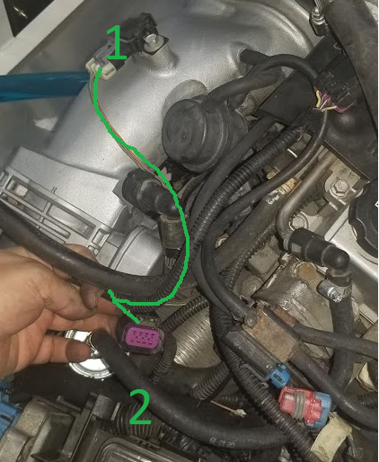

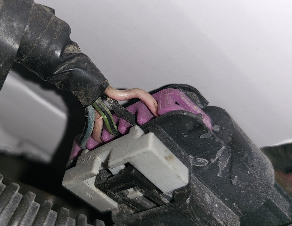

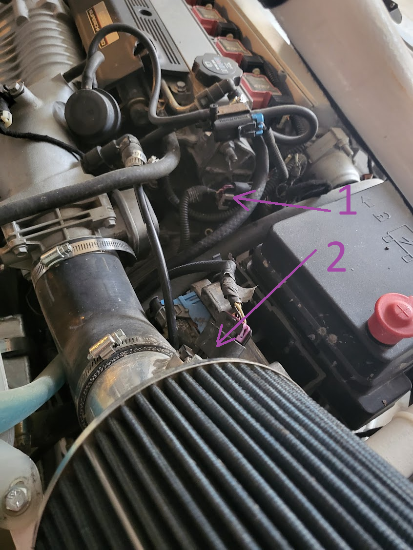

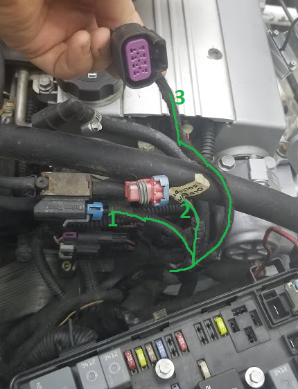

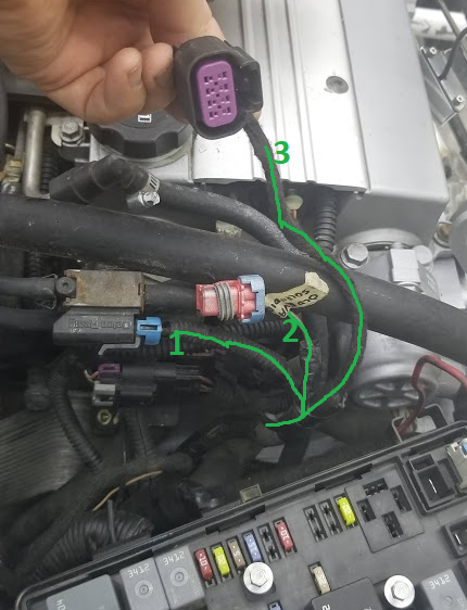

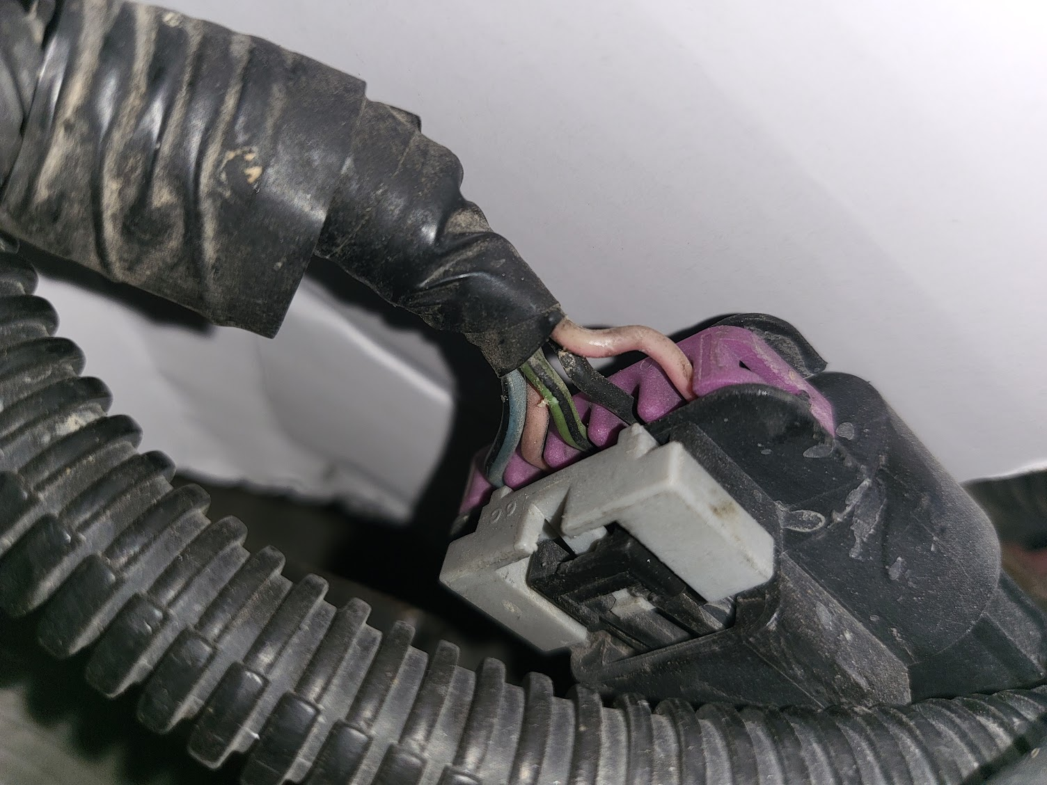

Putting the engine back in my Goblin, and I have lost track of where connector #3 goes.
The wire goes to #1 which is the supercharger bypass vacuum hose solenoid thingy,
then #2 which is labeled "Old Evap Solenoid" and then #3, the 8 pin purple connector that goes where?

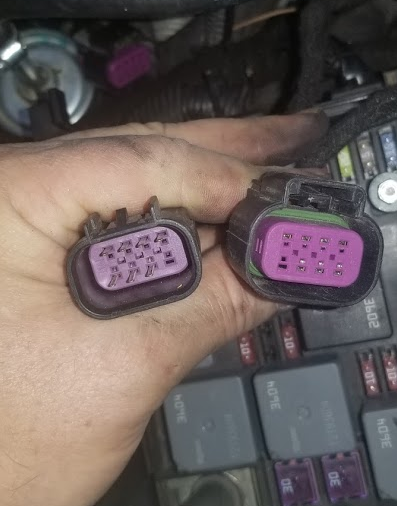

Isn't that the connection that's the same as the coil packs and the headlight harness? You can get them turned around? At least I can.

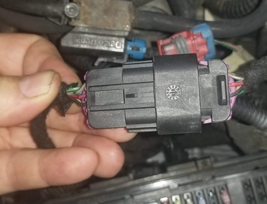

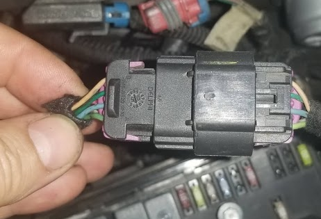

Swappable electrical connectors
The LSJ engine harness has 3 purple 8 pin connectors, that can accidentally be swapped, also 2 purple 5 pin connectors that can be swapped. All within short proximity of each other, leaving you with a non running goblin. Yikes!
The secret is to pay attention to the color of the wires that enter & exit each purple connector.

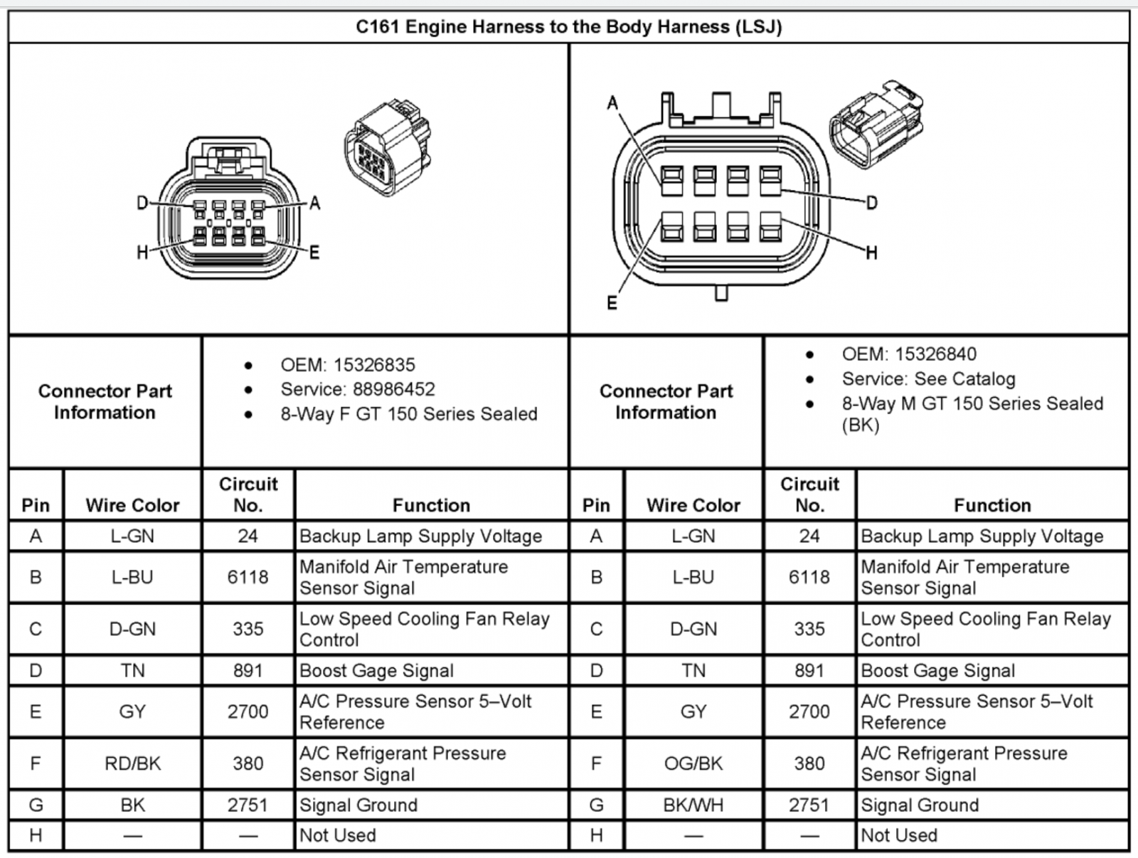

Swappable 8 pin connectors:
1. Engine to Body harness
has a purple 8 pin connector:
The female 8 pin purple connector that is on the same cable as the supercharger bypass solenoid (described in post 316) goes to
the male 8 pin purple connector that is on the same cable that goes to two underside connectors on the fuse box. This connector only has 7 wires on it.

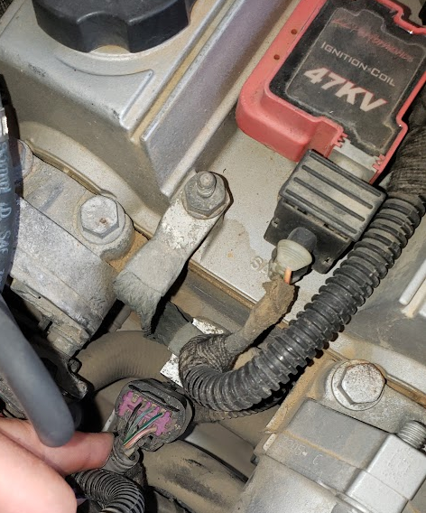

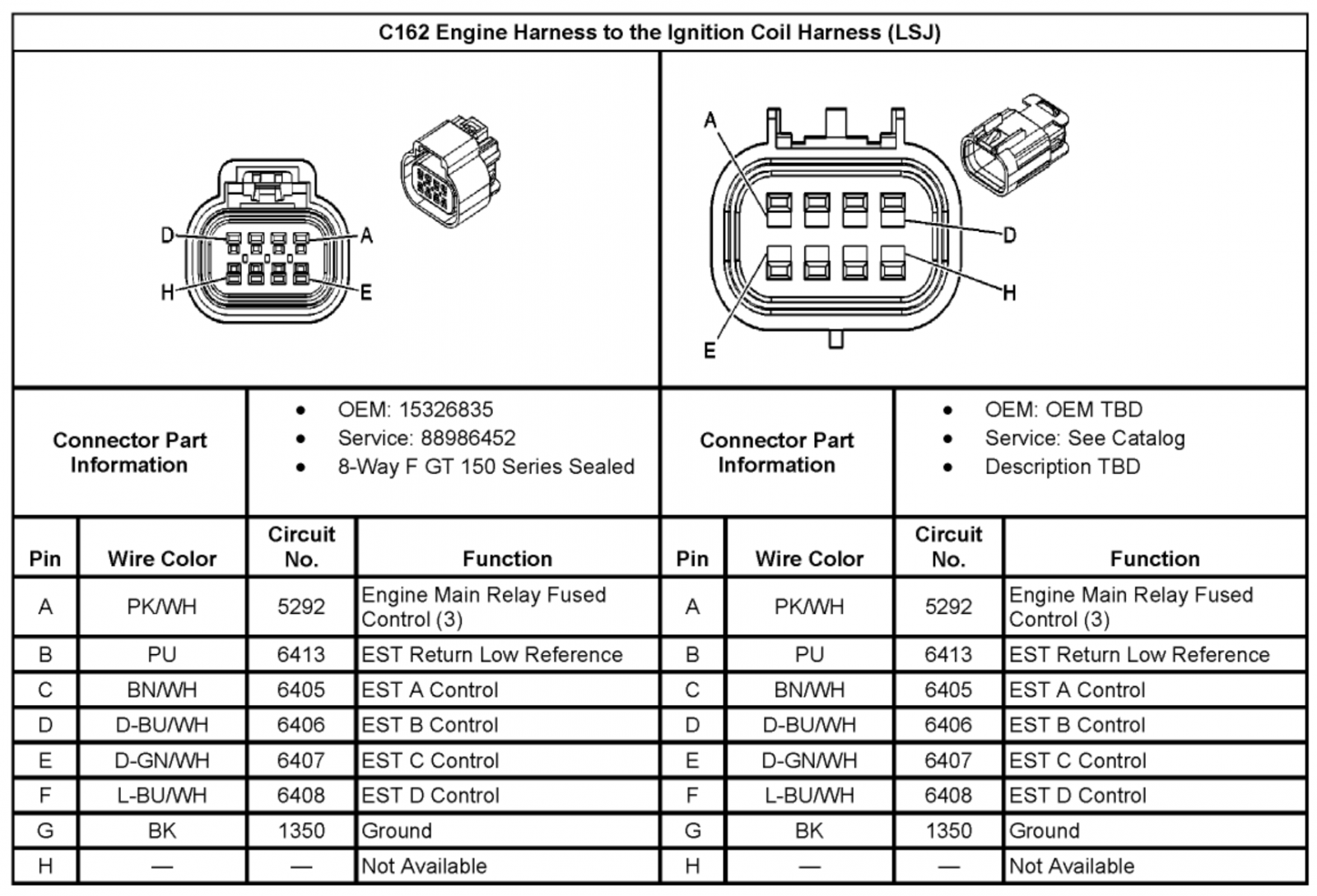

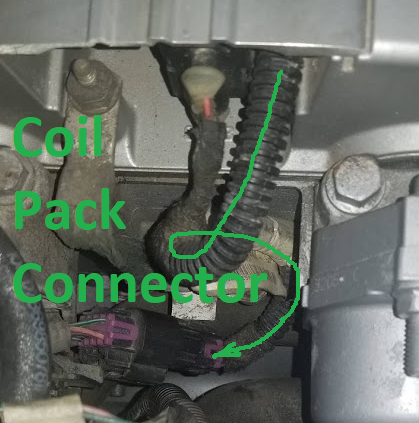

2. Coil packs cable also has this same 8 pin connector.
26931
26933
36574

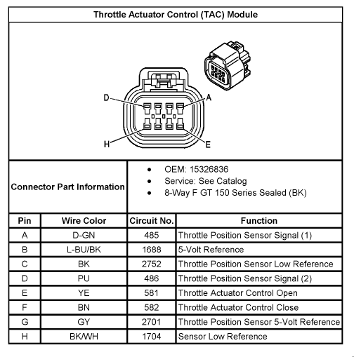

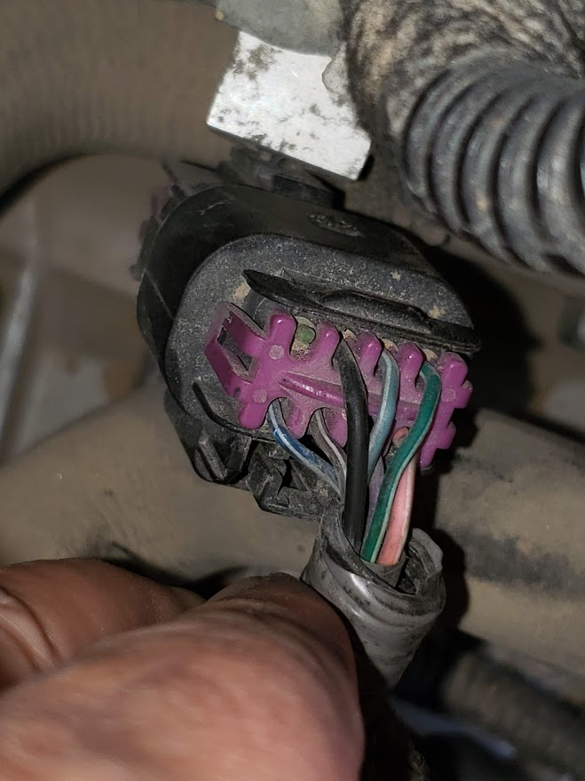

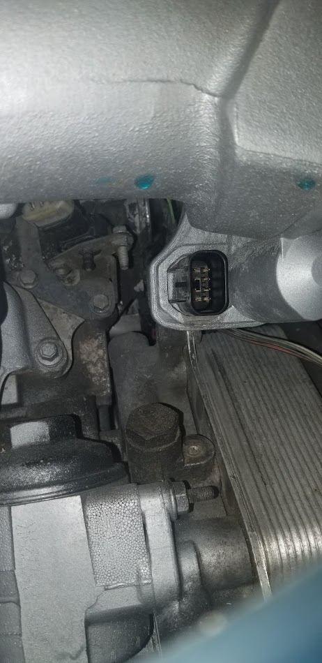

3. Throttle body has a purple 8 pin connector:
The throttle body connects to the female (2 below) that is on a cable that also goes to the MAP sensor (1 below).
The underside of the intake throttle body has a hard mounted male 8 pin connector.
14149
14152
26927

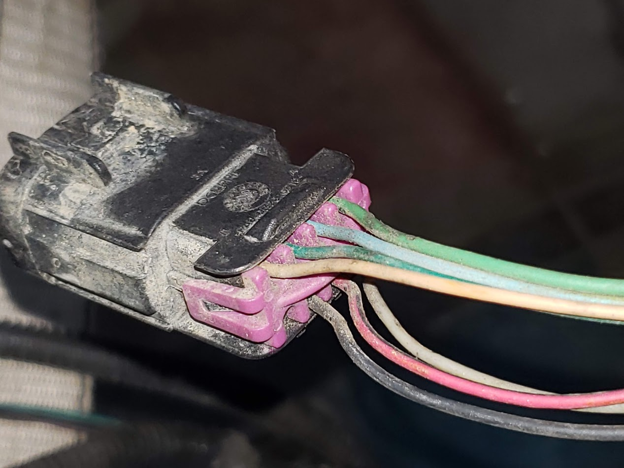

Swappable 5 pin connectors:
36581

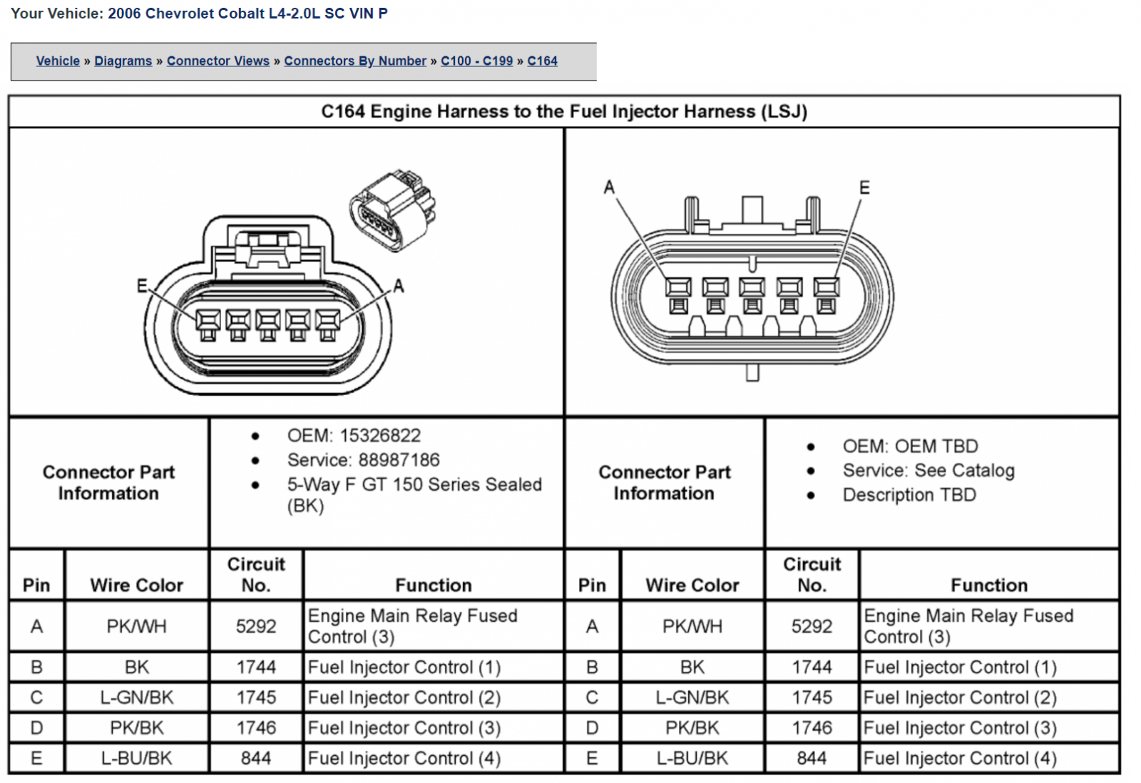

1. Fuel Injector
harness a purple 5 pin connector:
36576
36582

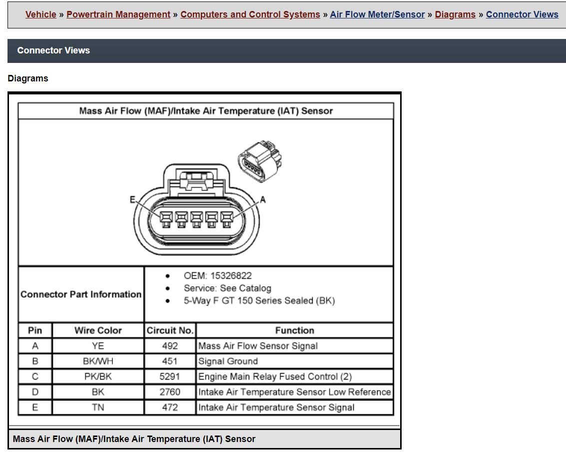

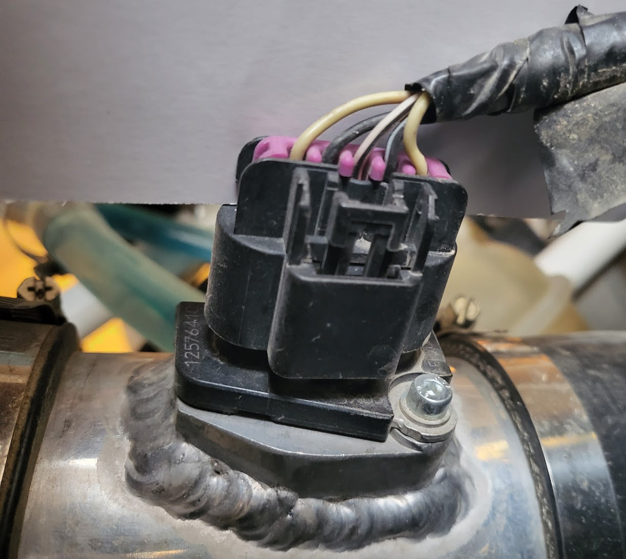

2. Mass Air Flow has a purple 5 pin connector:
36583
36580

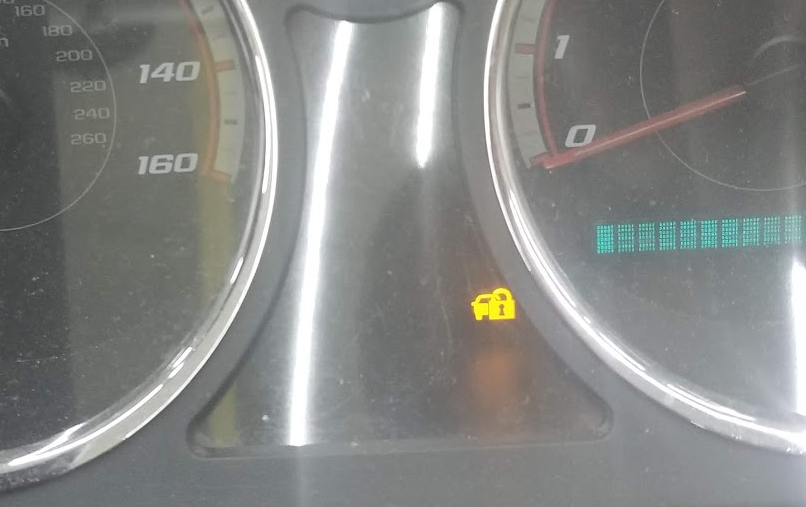

I am getting this on the dash. The battery has been disconnected for a few months, the engine was pulled, and now is back in.
Did I miss an electrical connector somewhere? Is this normal after disconnecting the battery? How do I reset it?

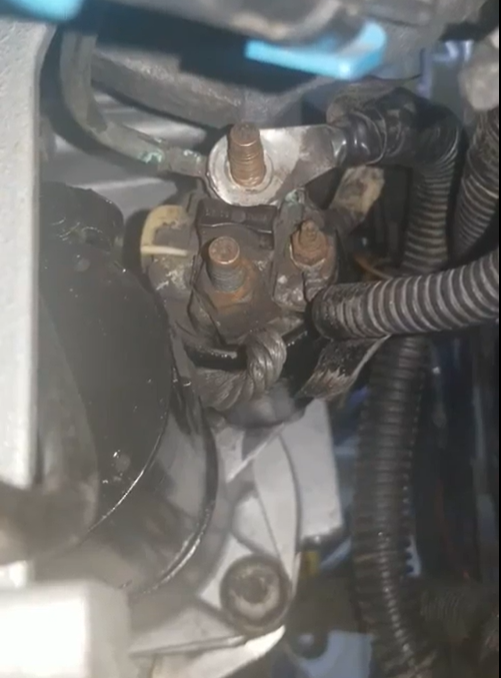

14223

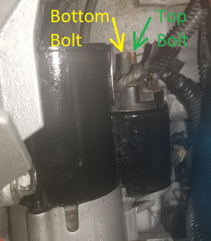

From under the car, the starter motor looks like this. Does the top bolt on the solenoid get the battery + and then goes to the fusebox +?
I think the bottom bolt goes to the starter motor. The second picture I found on my phone has a better view... I can see the wire going to the starter.

First is the “pass key” light. So something is up with the key/ignition system.
second: yes. The top bolt that goes to the fuse box. The bottom one goes from terminal to the starter motor.
I just swapped ECU's and did the "30 minute re-learn".
Try this:
Turn key to accessories on. Wait ten minutes, then the lock light turns off.
Turn the key off.
Again, turn key to accessories on. Wait ten minutes, then the lock light turns off.
Turn the key off.
One more time. Turn key to accessories on. Wait ten minutes, then the lock light turns off.
Turn the key off.
Now this time when you turn the key on, the lockout should be gone.
It is alive!
I did the key relearn 4 times (40 minutes) but the tightening of the 7mm bolts in the fusebox fixed a few issues.
Took it for a 6 mile drive, burped out most of the radiator air.
Engine is running rich, so tomorrow I will hook up HP Tuners and see what it going on.
Probably missed a sensor.

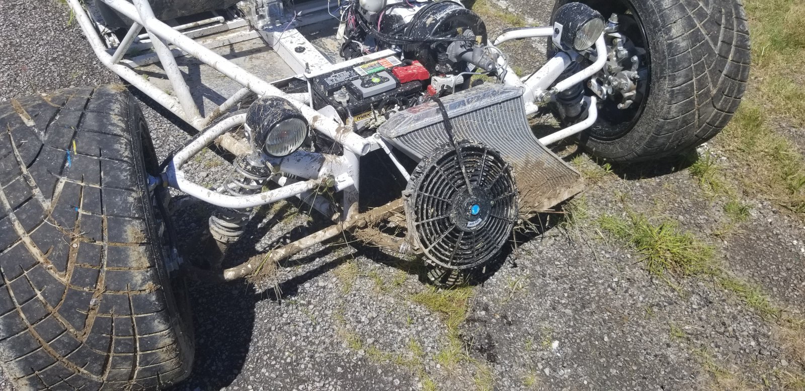

Learning how to drive hard at an autocross event can have consequences. Good thing the Doyle Fabrication made the front/radiator support as a stand alone unit, for easy replacement in case of.... this. I guess I will find out if they stock it and new radiators, just in case I have a midwest spring meet in two weeks.
14379
Oh, my 19 year old who is discovering how well drag radials stick after driving thru a puddle. Luckily it was only his pride that got hurt. Well, that and my Goblin.
14378
Oh man... I hate that for you. Sorry.
I guess pushing the limits of a machine and operating at the limits of physics has its costs.
I hope it is all easily repairable.
